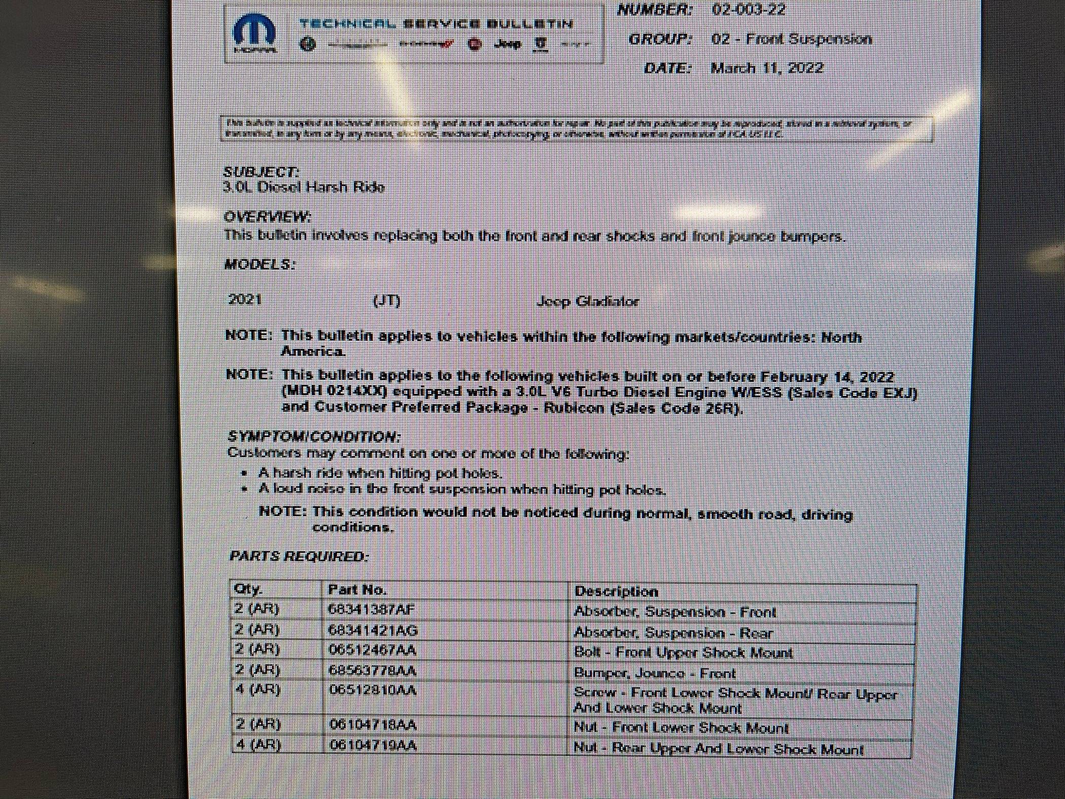

If you are just looking for a better ride quality you should look at getting the TSB done for the suspension if it qualifies.
More info in this thread:
Your stock Rubicon diesel JT bottoming out? Here’s the fix!!

Need some guidance. 2021 Jeep Rubicon Diesel. What’s the best way to improve the diesels ride over washboard and bumps without lifting? I feel like I have to crawl over bumps currently. At most I want is a level. This is my daily driver. I would like something composed on the bumps but not too stiff like a diesel 2500.
The TSB definitely helped others.

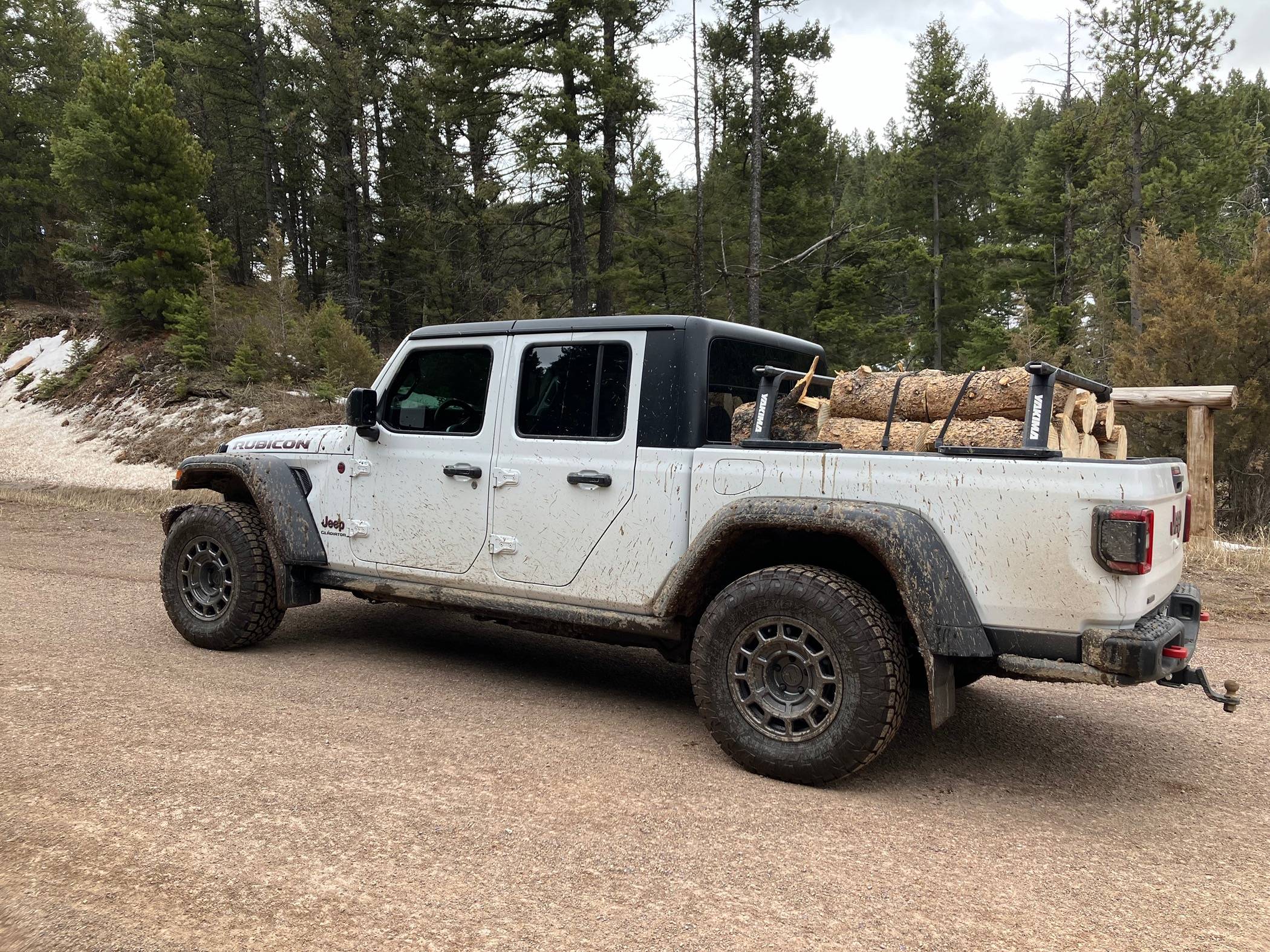

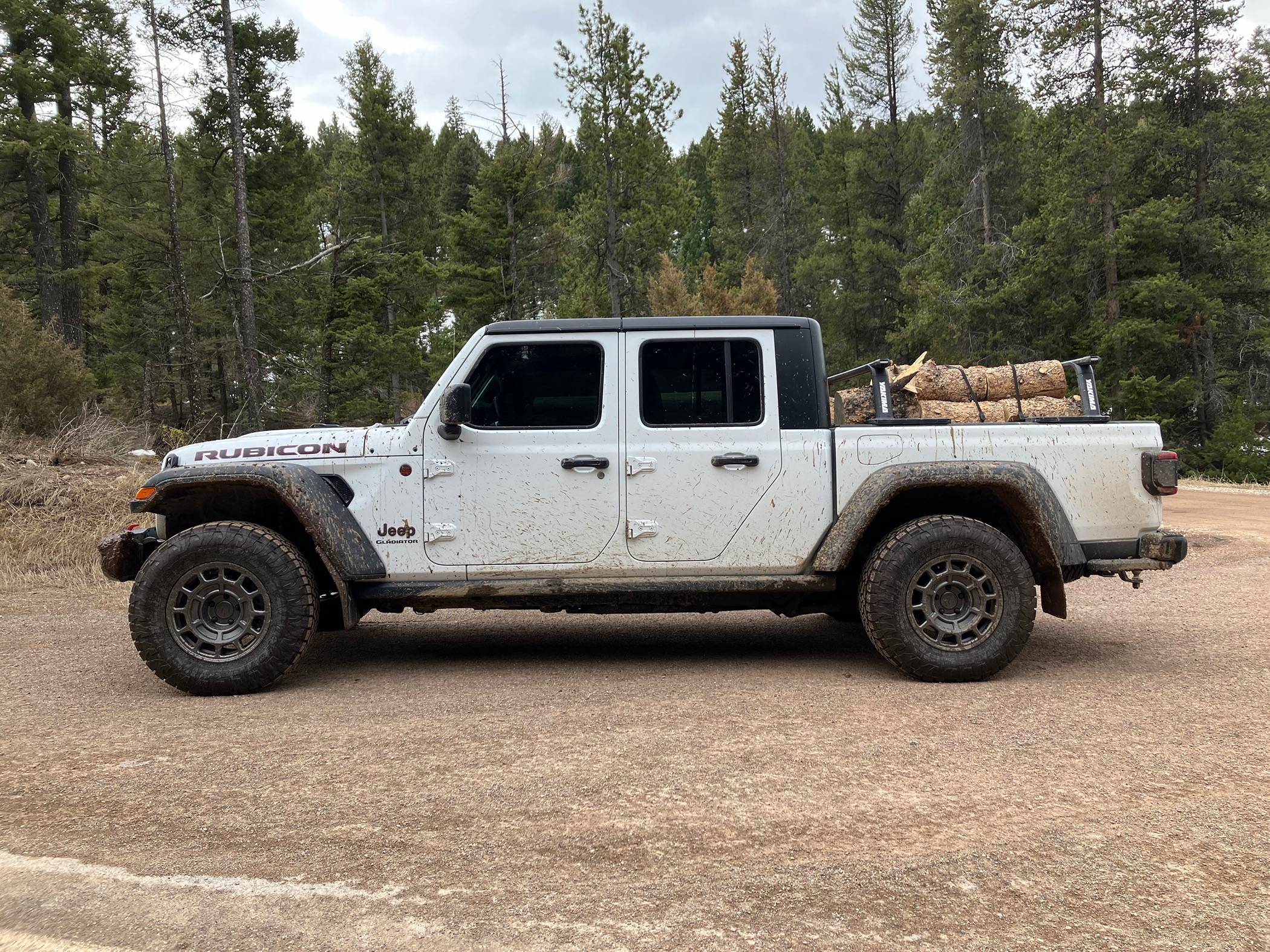

Weight in the back helped smooth the ride with stock suspension. More than I was expecting. The diesel thrived with the heavy load btw! In love!

As a fellow diesel owner in the same situation, what springs would we pair with low lift Claytons in the front for the rear?
I tossed a few sand bags in the bed and it settles on road suspension significantly.
