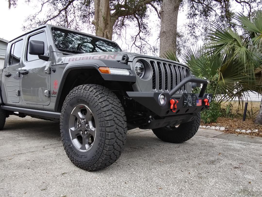

The key to driving in Florida and the soft sugar sand we have is airing down. I can go further with street tires at 12psi than anyone with M/T or A/T type tires at 30psi. The wider contact patch airing down creates is only half the process. The other half is less air in a tire creates flotation and less digging down into the sand.
A good quality A/T tire will serve you well. You need one that can withstand roots and shale and not get easily punctured. Wide or narrow, properly aired down, either will work. I prefer to keep my tires inside the fenders.
are those the 35x10.5 tires? I’ve been looking at those.
Yes sir, they are the Kendra Klevlar 35x10.50x17. I was hesitate about buying an off brand tire that doesn't have a long term review yet. No other tire brand makes this size and it is perfect for my application so I took a chance. So far, no complaints. They ride/feel/perform just as good as the Falken Wildpeaks AT/3 that came on my JT. You can't beat the price either.
