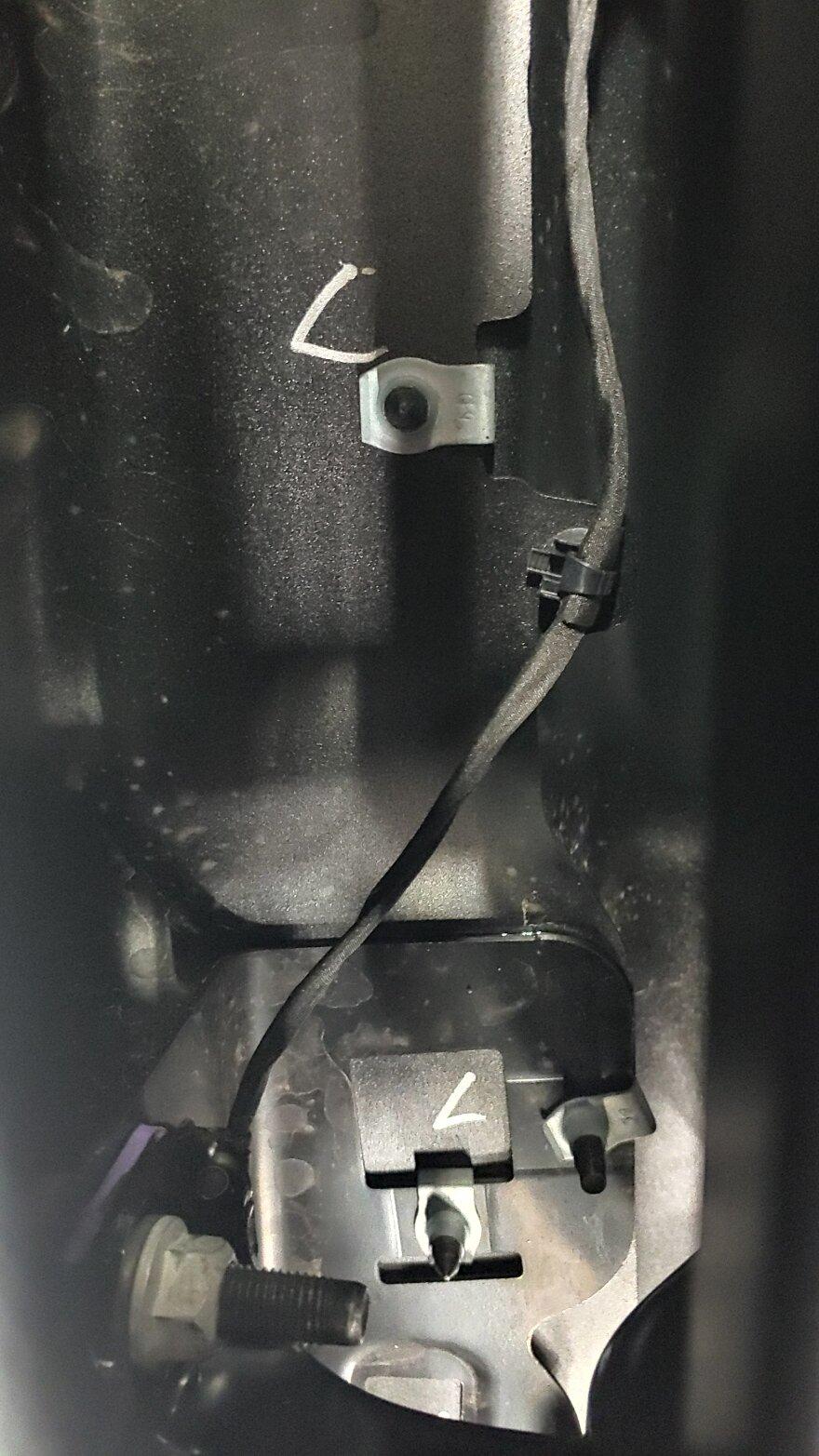

I ran the fog light wiring from the right side frame connection over the top of the frame horns and then to the left fog light and used a lot of ties. They are water proof connections so the biggest thing is to keep stuff like mud or ice/snow pack from hanging from the wires.

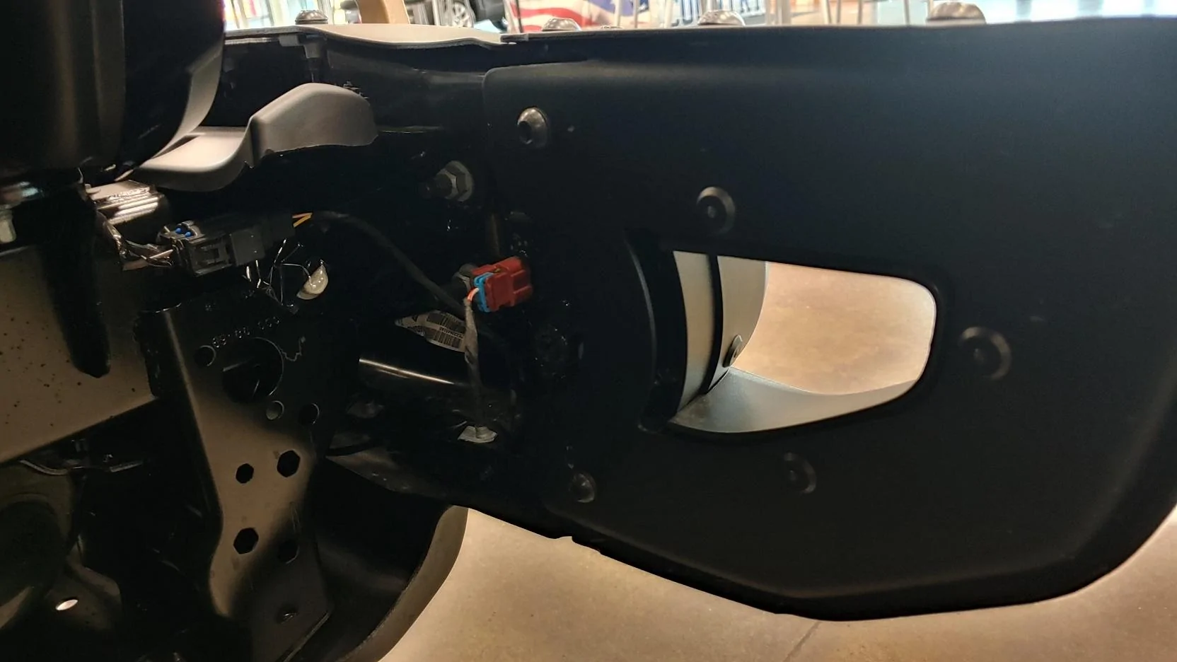

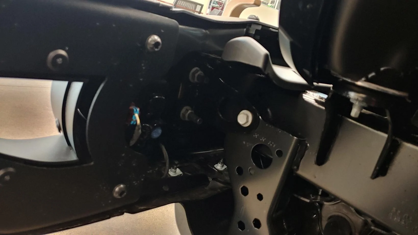

These are pictures from a factory Rubicon with the factory steel bumper - dark, sorry, I was trying not to draw the attention of hovering sales people.......
Jeep Gladiator Fog light wiring on el cheapo Rubi bumper reproduction 20210915_072413_HDR
Jeep Gladiator Fog light wiring on el cheapo Rubi bumper reproduction 20210915_072436_HDR
Jeep Gladiator Fog light wiring on el cheapo Rubi bumper reproduction 20210915_072656_HDR

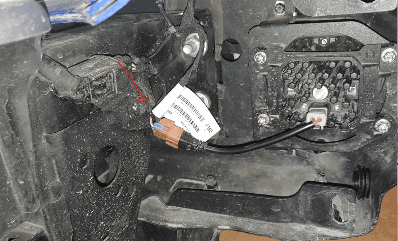

And this was mine after taking the bumper ends off in prep for going back to factory for the trade -
Red arrow points to one of the tie straps -

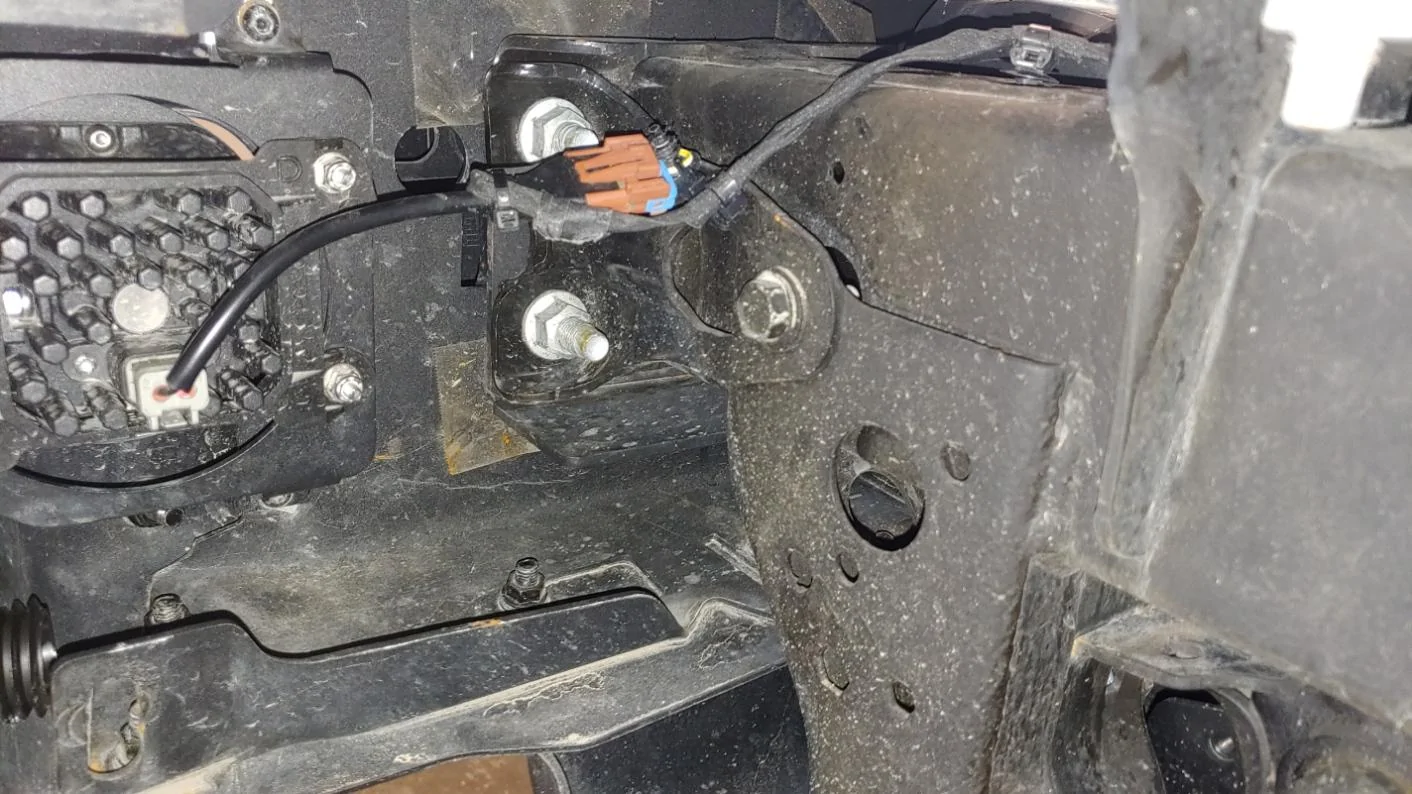

Left side - one of the straps going through a frame bracket hole, and wire going up over frame to the right side.
