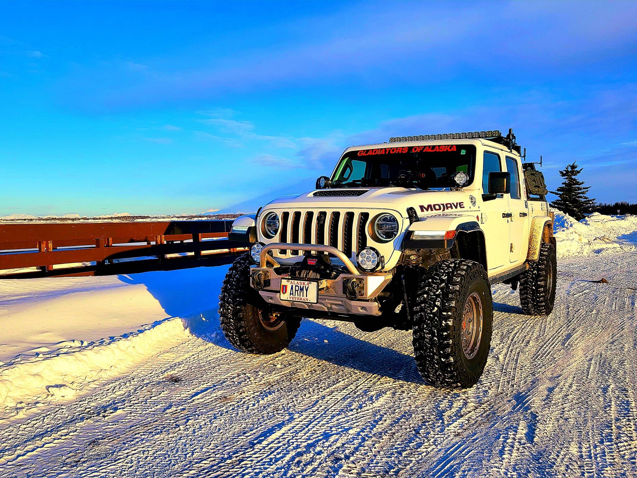

Regarding the Genright Ultra Clearance bumper; would it be possible to modify the bumper rather than cutting off the frame horns? I like my factory Mojave skid plate and would like to keep it. I saw a photo and I'm pretty sure its the ultra clearance bumper and they're using the oem skid but I'm not exactly sure how they accomplished this. Thanks.

That has a nice clean look to it. Too many of the aftermarket front bumpers stick out so far, that they look like some kid’s jaw with a major underbite.
I agree! I'd like to keep it light, tucked in and clean.

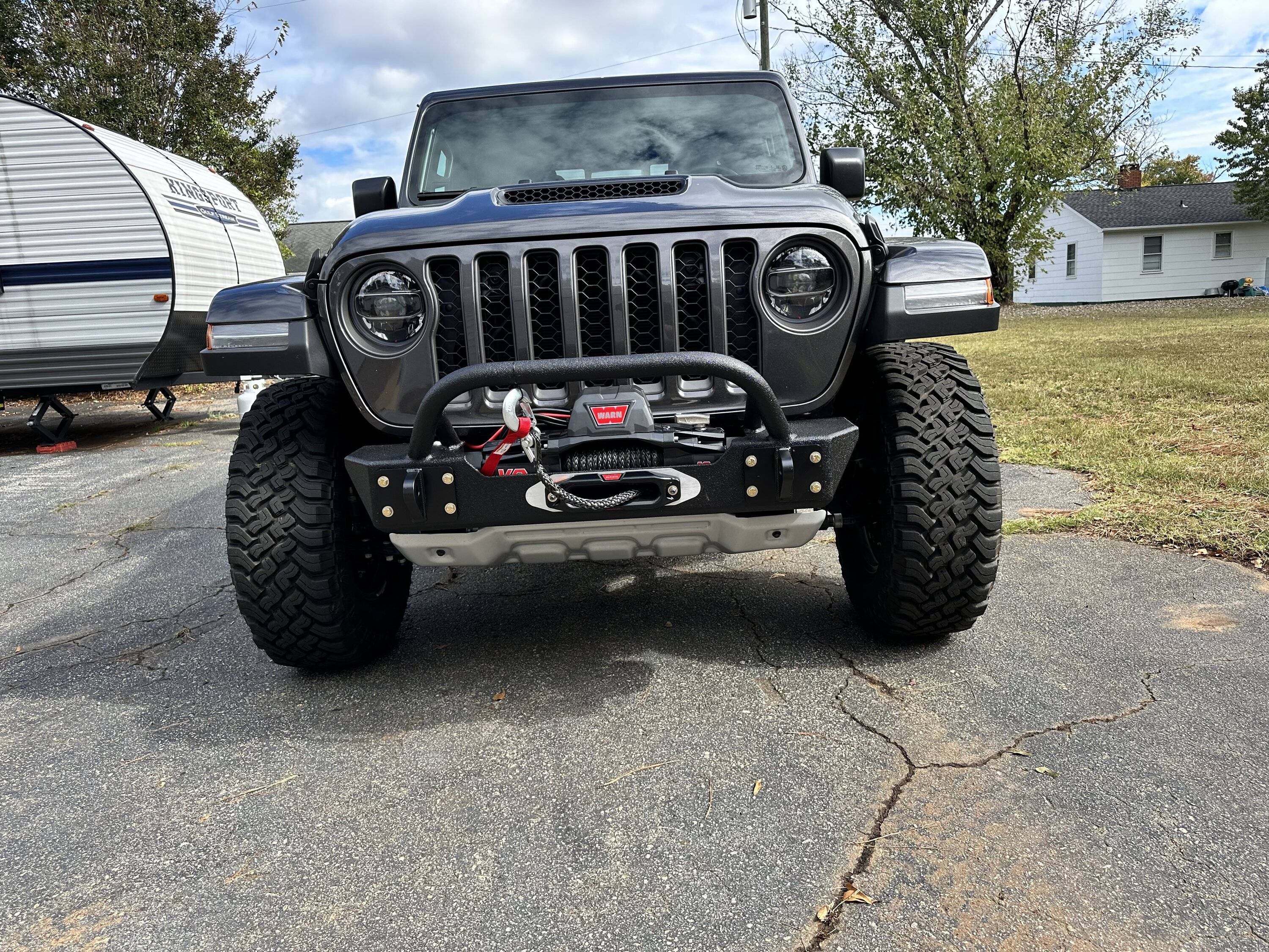

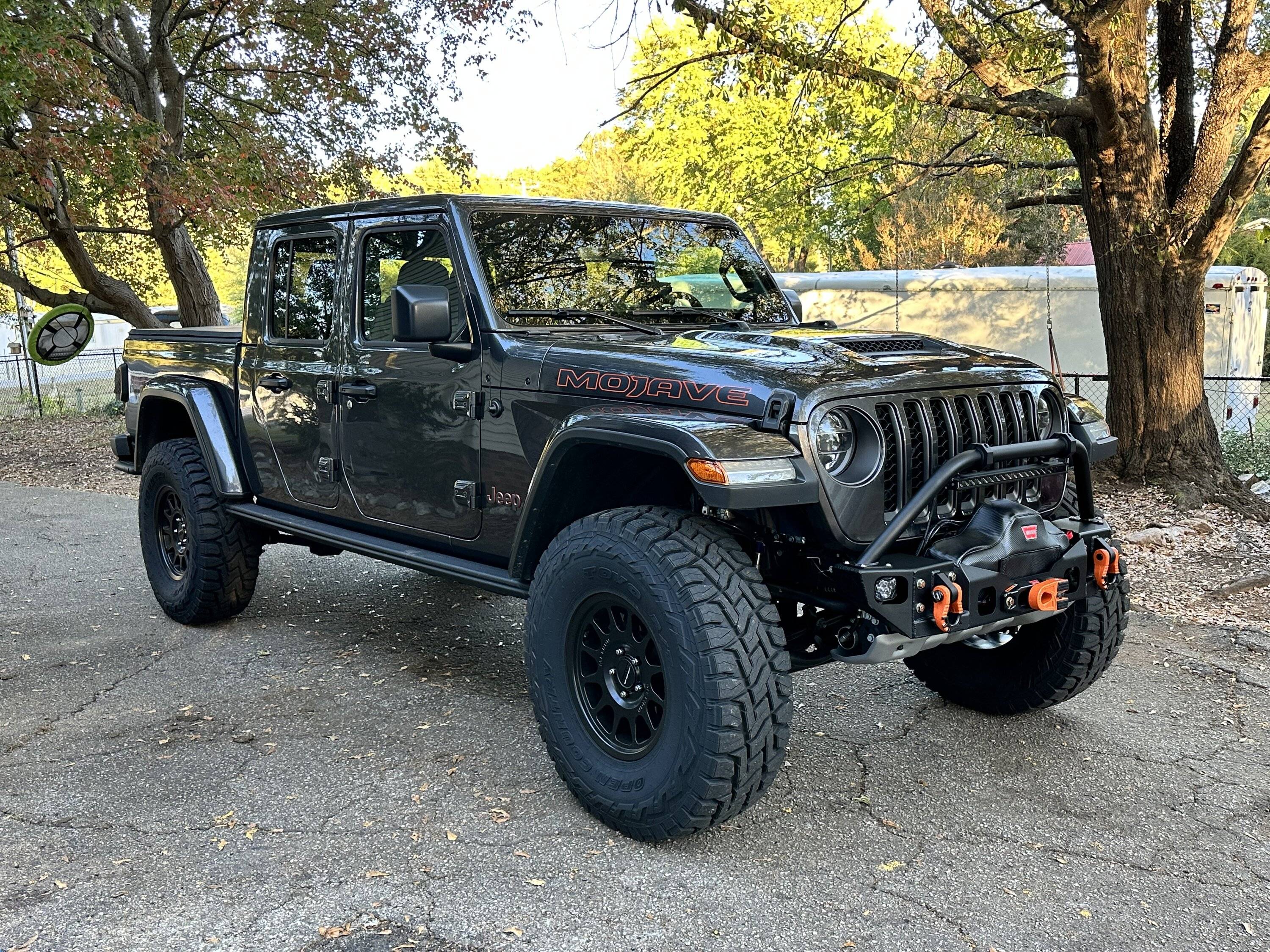

I ordered the Genright ultra clearance bumper. It does require cutting off the frame “horns” “tusks” “skid mount” or whatever you want to call it. Instead of cutting on my brand new jeep frame, I notched out the bumper and it worked perfectly! Unfortunately, I didn’t care much for the look and went with a different bumper all together and sold the modified Genright bumper to a local jeeper. First picture is the Genright, second is the Hefty Fabworks bumper.
