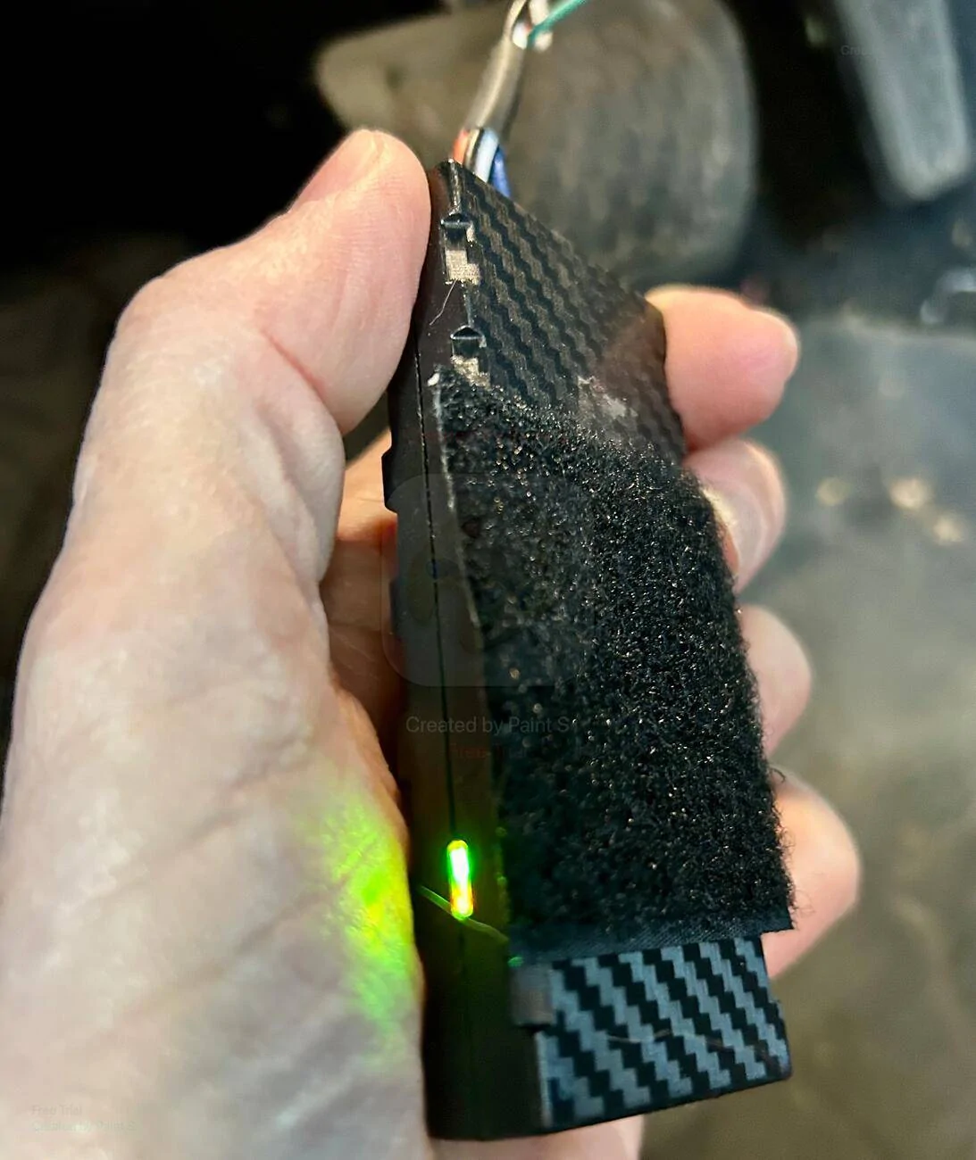

I found a tracking device installed under my dash. I was looking for something else and noticed an odd bundle of wires zip-tied to the OBD port wires.
I followed the red & white wires coming out of this bundle and it led up to a device Velcro attached to an OEM component.
I googled it and found it is a Spireon EDGE-M / LoJack tracking device.
i bought my Gladiator used and it is paid off, so I am guessing this was either installed by the dealer for their own tracking purposes or the original owner had the LoJack service. The unknown port in the first pic, I think is the OBD-II pass through connector. I haven't uninstalled the device yet. Wanted to post here first to see what others think.

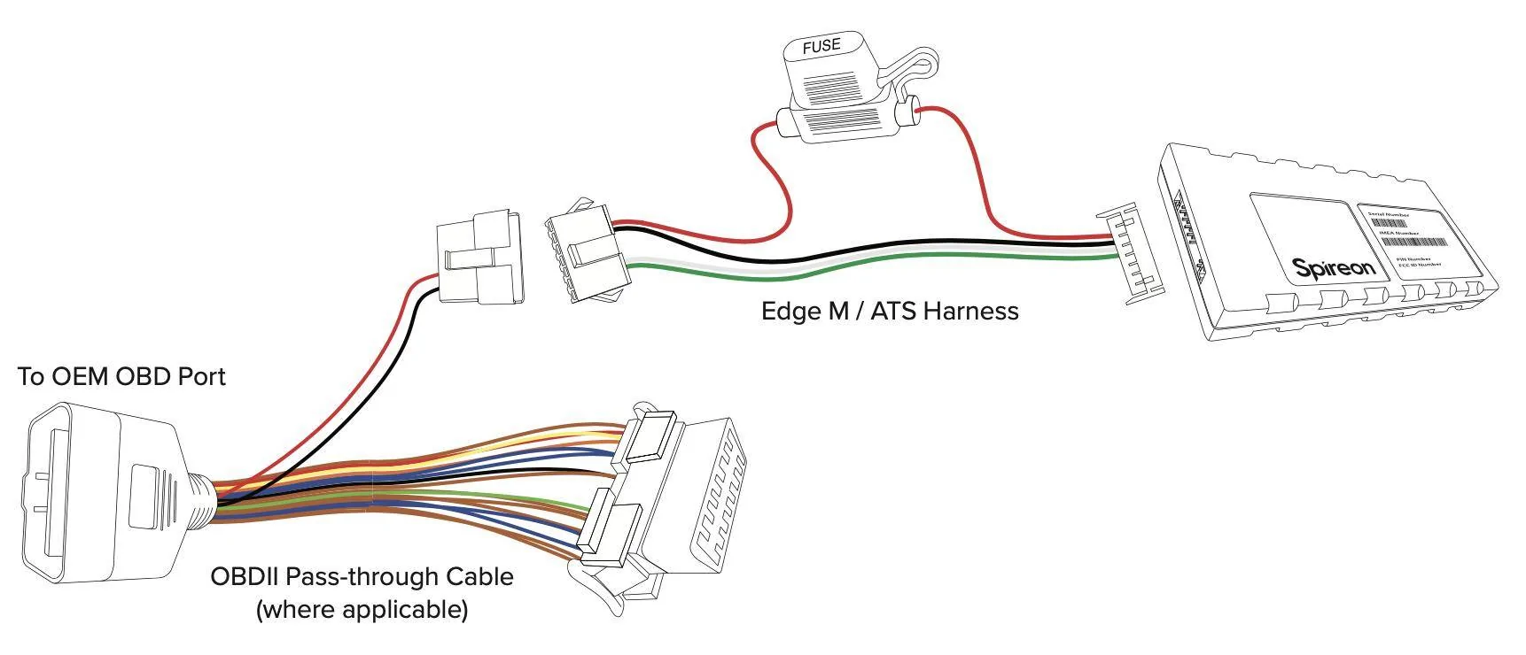

I've attached PDFs of manual from both Spireon and LoJack. Here is a clip from the LoJack manual which appears to show exactly what I found on my JT:
Optional OBDii Pass-through Cable Installation Instructions:
- Unclip or unscrew the vehicle’s stock OBDii plug from its mounting location.
- Plug the OBDii pass-through cable into the stock OBDii port and clip or screw the opposite end into the
stock plug’s original mounting location using the supplied bracket where necessary. - To install the Edge, mount the device as instructed in Step 3 of the standard installation before plugging the quick disconnect on the device harness into the one on the passthrough cable.
