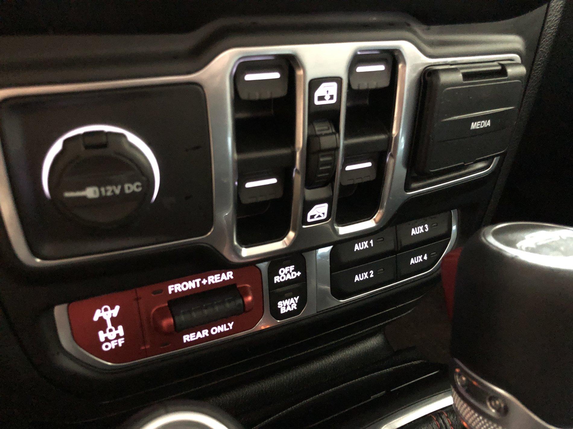

Installed AUX switches on my JTR
Itzzchrisss
Jul 31, 2020
2020 Stingray JTR
If you are on the fence about installing the switches, don’t be afraid! I have no experience with electrical stuff and was able to get a clean installation without any problems. A lot of people report issues with the orange wire not seating correctly, but I noticed that none of the instructions/tutorials say that you have to pull the safety plastic up on the female side. After doing that the orange wire was able to seat perfectly in the connector. To get the wires through, I snipped the end of my oem antenna; its strong enough and dull enough to get through firewall without damaging anything. I can’t believe this isn’t a standard option. If you have any questions lmk...

Jeep Gladiator Installed AUX switches on my JTR 561DF185-CB97-4F29-96D0-2887D3626A6F
How long did it take you
