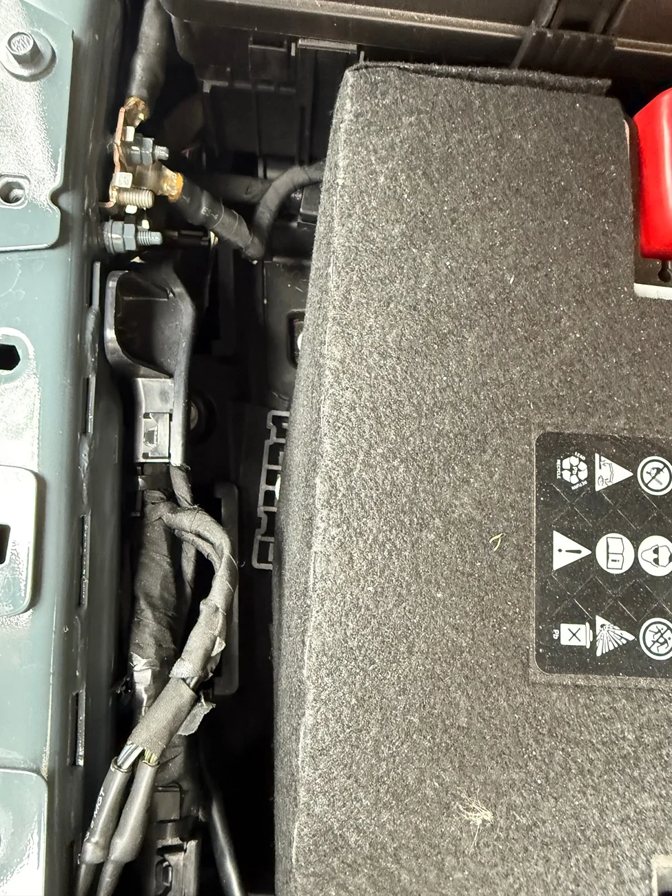

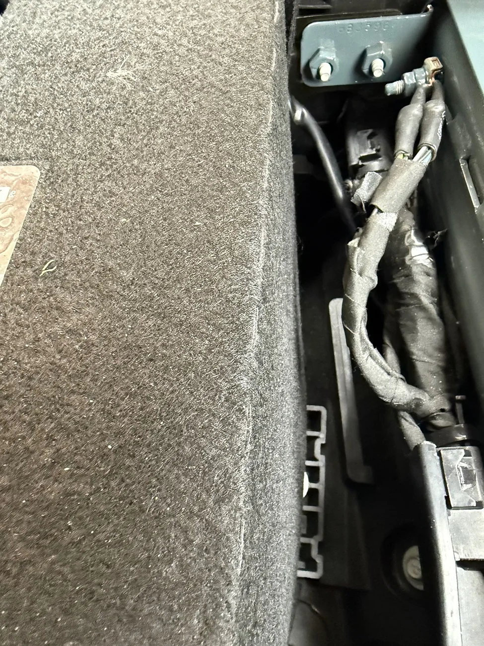

Hi all, i have a 2025 Rubicon and it came with the aux switches. I went to install lights and couldn’t find the wires under the hood. I’ve owned a couple of jeeps with the switches and the leads are always in the same place (including my 2024 JLU). Does anyone know if something changed in 2025? Any advice is greatly appreciated!
Jeep Gladiator Question on 2025 vs 2024 aux switches IMG_8327
Jeep Gladiator Question on 2025 vs 2024 aux switches IMG_8328

Both the '25 and '26 owner's manuals still show the underhood Aux wires in the normal location next to the battery.

2025 Willys here. Mine were in that bundle in your photo. Had to peel back a feel layers of the fabric tape.

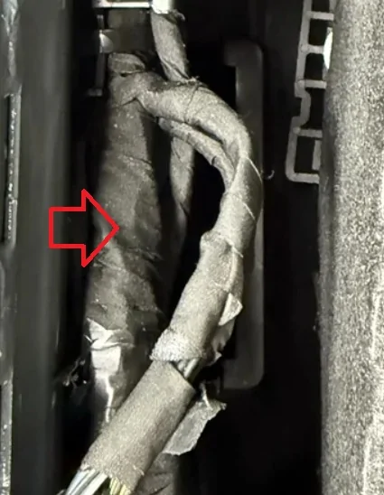

The bulge is tell you something.
Jeep Gladiator Question on 2025 vs 2024 aux switches Pregnant Snak

Thanks - I’ll peel that back and check. It threw me off because it runs into a plug. My other jeeps just had just the 4 wires wrapped together and laying in that area.
