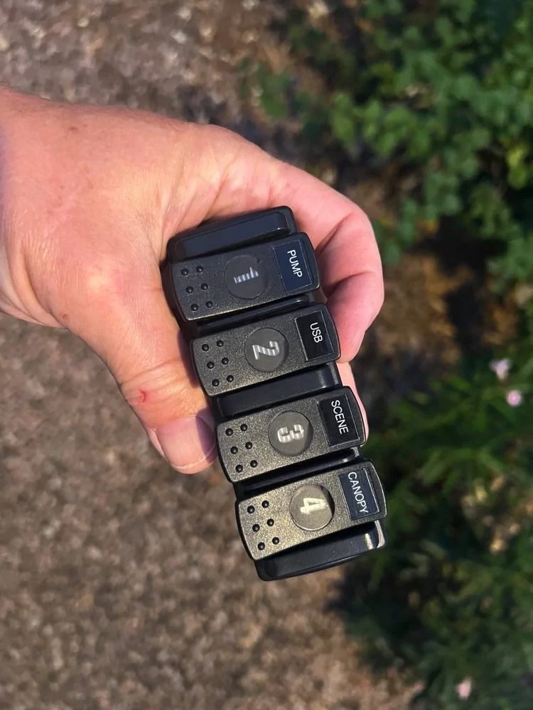

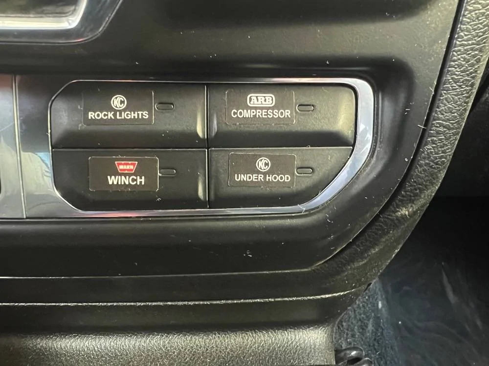

Factory Aux Switch line-up:
Jeep Gladiator Aux Switches - What are you putting on them? 03_DashAccessories_3

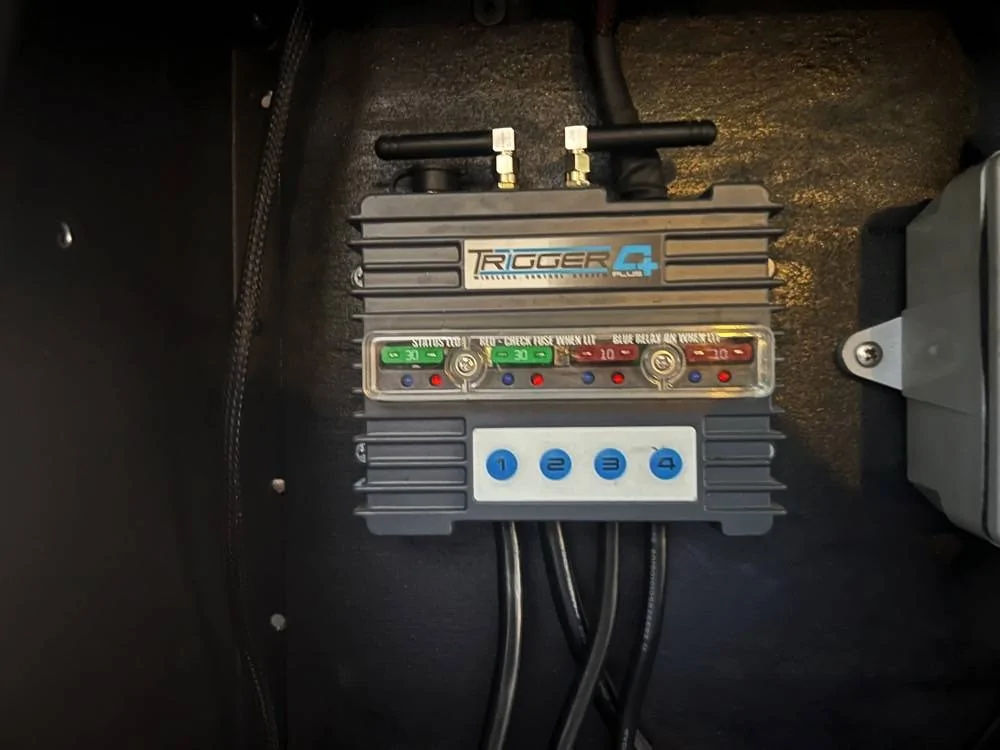

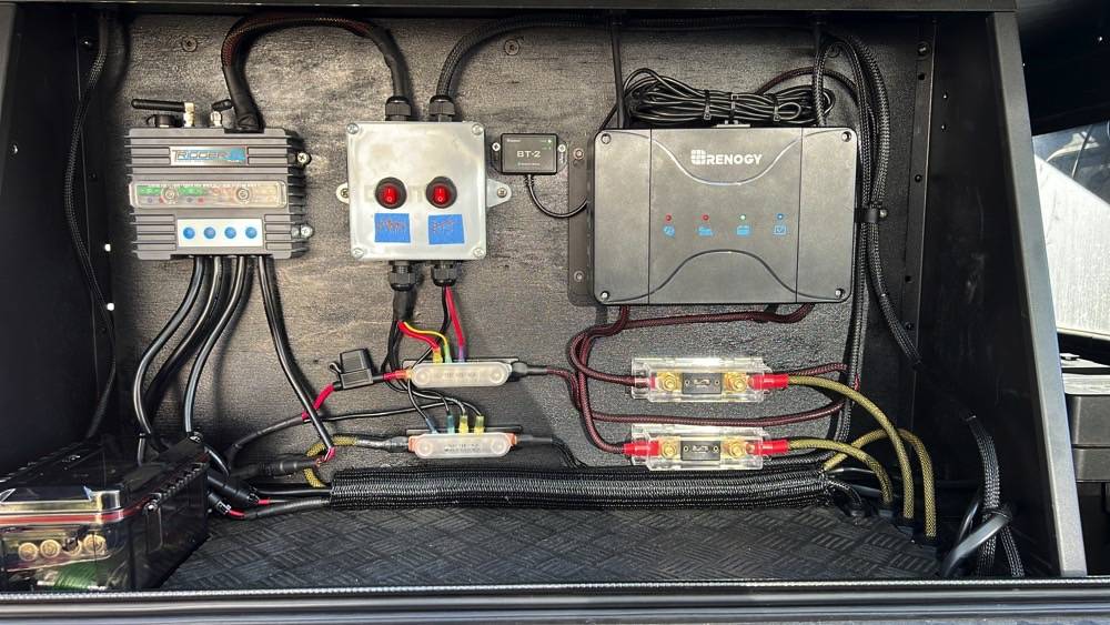

And then my House Loads:
Jeep Gladiator Aux Switches - What are you putting on them? 15_HouseElectricalPanel_1
Jeep Gladiator Aux Switches - What are you putting on them? 16_Trigger4PlusController
Jeep Gladiator Aux Switches - What are you putting on them? 17_HouseLoadRemot

Hey where did you get those labels? And do they by chance allow the light to shine through so you can read them at night?
HooliganActual
Robert
Jun 27, 2020
1,067
2,367
10 miles from the Sun
The labels were made by @pixeldecals
If you look close at the pic you'll see that the light on the switch is just to the right of the label...no need for them to shine through. Labels that allow the light to shine through, might be out there (in fact I'd bet my wife could make them on her Cricut) but at the time, I was ordering some hood decals and they said they could make these, so I didn't bother looking for the other. Personally, I don't mind that they don't shine through...they clearly identify the switch and the light is visible when I hit the button.
Yeah I see the indicator light is not covered but for me it's nice to see the name of the switch when it is dark - just to reduce chances of pushing the wrong one.
@pixeldecals - you able to make a 'see through' sticker so the name illuminates?
Sorry don't mean to hijack the thread.
pixeldecals
Rock Sponsor (Level 1)
Apr 3, 2017
193
349
Chicago Area, IL
www.pixeldecals.com
Yes I have made them from white vinyl that allows light thru more recently. The switches aren’t generating a huge amount of light but it seems to work ok.
