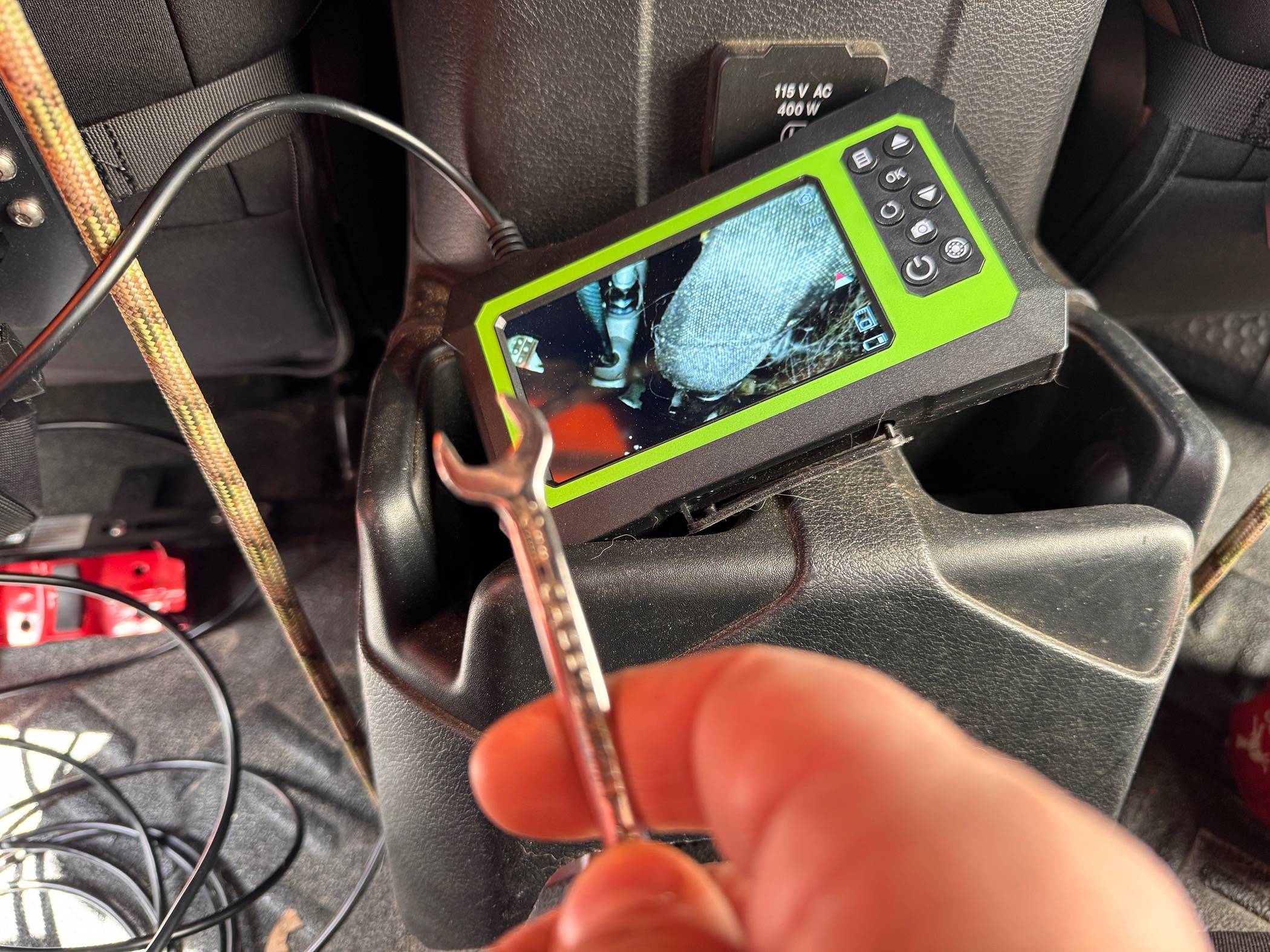

Just did my quarterly adjustment today. I will say that the sloppiness of the handle is a factor of 3 possible, not mutually exclusive, factors:
  1. Cable stretch which is normal for an e-brake, especially when you wrench it up hard holding the truck off road, and requires maintenance on other vehicles too.
  2. A defective handle, for which there’s a TSB (I’ve had this “addressed” by my former dealer)
  3. A crappy design that is inherently prone to sloppiness when not under tension.
Thanks, bit of rope, Chinesium inspection camera and micro 10mm wrench.
Jeep Gladiator Freaking E-brake broke loose again... IMG_3786
Other older Jeeps I’ve owned also had to have their ebrakes adjusted. On none of them, did the handle get laterally sloppy loose. This exercise always triggers my cognitive dissonance over having my favorite marquee being owned by a company I consider to make the worst junk cars in the industry.
