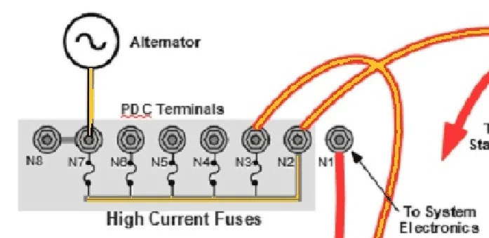

You likely blew part of the high current fuse when fussing with trying to disconnect the aux battery. The high current fuse handles the cooling fan. That's a $175 item by itself.
Ya gotta be careful and not start just doing things because you read something or heard something - and when working with these batteries, they aren't always disconnected fully when you think they are. If you didn't take the ground cable off the main battery then separate the two black cables from each other and isolate them from touching anything, could have very easily taken out a fuse.
Look up "high current fuse". It's the big honker on the end of the PDC where the other fuses are. All those studs sticking up - that's where the high current fuse is. It shows multiple but it's all in one fuse array so if one is bad, you replace the whole fuse array.

Looks like mostly everything is good once the Aux battery was put back in. The mechanic is looking it over, but looking like the Aux battery powers more than just the start/stop as many mention. I must of not tighten the right things down or what you mentions by not separating wires that went to the Aux. They are checking the fuse. However driving for 30 mins (longer than yesterday) and the Coolant Temp stayed within 180-210 degrees
That's a great coolant temperature range.
VERY possible that something wasn't tightened down or was out of place a bit.
This is a schematic of that fuse array - the radiator fan is N5. It's powered via the alternator and main battery.
N1 is from the pos terminal of the aux battery.
N2 is from the main battery positive.
So either the fan is powered from the main battery through N2 over to N5,
or
with the alternator charging, the fan is powered through N7 fuse from alternator output over to N5 fuse.
N3 goes down to the PCR (a relay for the aux battery) and to the aux positive to charge the aux battery.
If N3 is blown, the aux battery can't charge.
If N7 is blown, there's no alternator output to either battery or much of anything else.
If N5 is blown, the fan won't operate.
N6 powers the EHPS - ElectroHydraulic Power Steering.
or
Yeah, I think i know what happen, I was doing this at work with only a adjustable wrench and know for sure I didnt tighten everything down. However it was making contact to the botl but maybe that was not enough.
