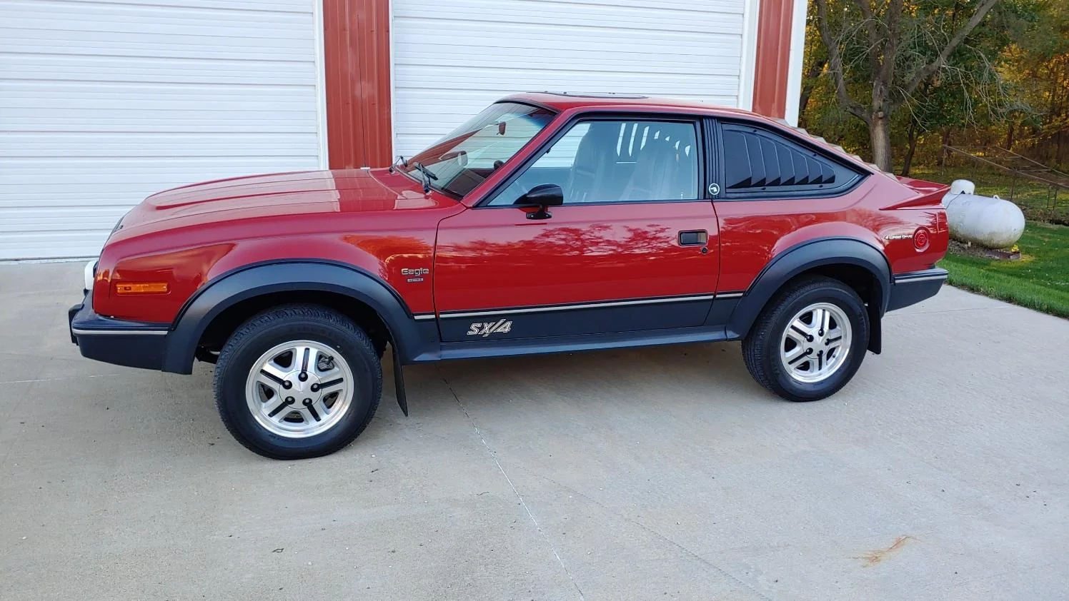

NO PANELS were replaced. The whole car is original sheet metal except for part of the right fender because I killed a fair sized doe with the car and destroyed most of the fender. I was not able to find a replacement I was happy with so took two fenders and made one.
This is proof that you CAN stop rust if you know what you are doing.

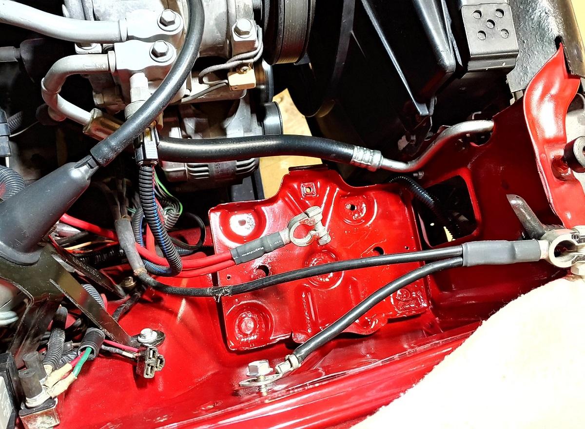

How do you remove rust from and sand a battery tray that's 30 years old? I did it - and it's still fresh looking -

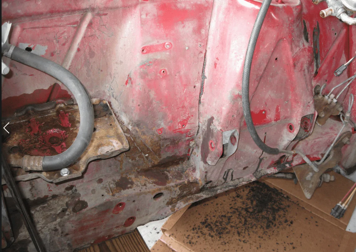

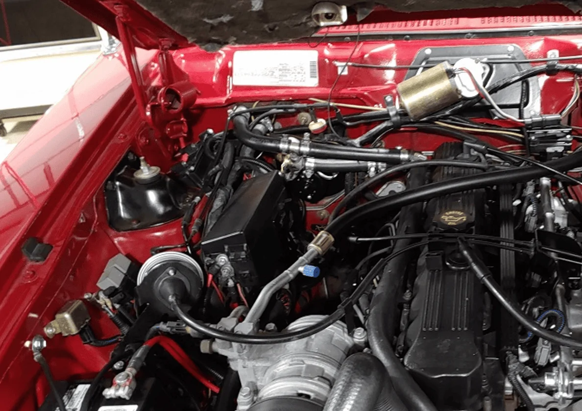

All of this red - including the underside of the hood which has a complex frame and a skin crimped over the frame and spot welded in places. I cleaned, sanded, prepped and painted the firewall, inner fenders, hood underside, you name it. Even the door frame and door jamb areas I sanded and prepped and painted. If it was red from the factory, I prepped/sanded/painted it.
Don't think for a minute that because it's not flat that it can't be fixed, sanded and painted.

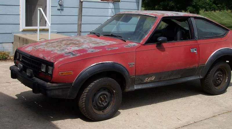

Hood, roof, hatch, the CA sun baked all the paint off. No rust today.

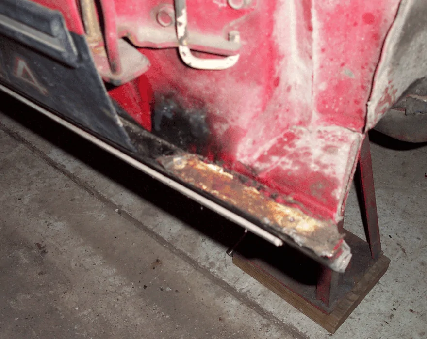

There was rust starting where the fender bolts to the rocker area - I treated it, and painted, and there's no rust there to this day.
