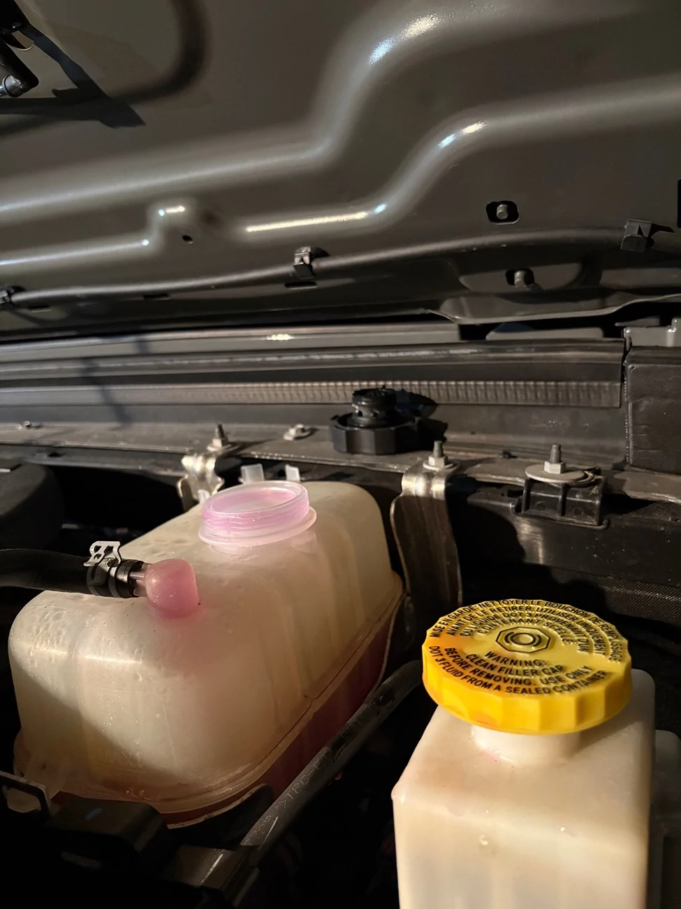

I’m new here, I have a 21 gladiator sport s with 58k on it. I need some advice the dealership replaced the intake camshaft and the lifters due to the cam being worn down. First red flag for me is they seem to have re used the old gaskets and did not replace the rocker arms. Second red flag when I got it back I drove it home and lo and behold the temp gauge starts rising, they didn’t fill it back up with coolant and left the cap off the reservoir. The motor still makes the dreaded ticking sound on cylinder 1 and has a p000A code now, what angle can I take on this to get it fixed correctly? Or am I going to just have to do it myself? Thanks!

Also, looking at your coolant reservoir pic, the coolant is below the low mark but still has coolant up to the seam. So it did not run low within the engine circulation system itself, just the cap was not on and could not build pressure that would keep the boiling point at a higher temp.
