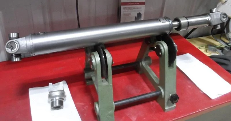

Checking rear driveshaft for my 82 Eagle after rebuilding it....... checking for true, balance.................
