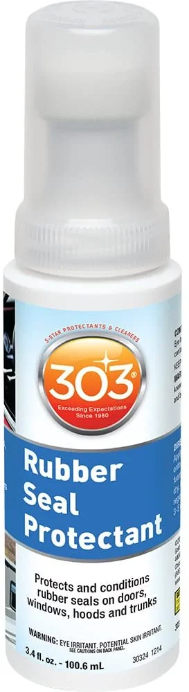

Probably flexing. See what the dealer has to say.
Or try, https://www.amazon.com/gp/aw/d/B00T44D1R2/ref=ox_sc_saved_image_2?smid=ATVPDKIKX0DER&psc=1
Jeep Gladiator Freedom Panels Making Noise 51QK8YaFB8L._AC_SL1500_

Here's my clicking noise. I've used the 303, but to no avail.
