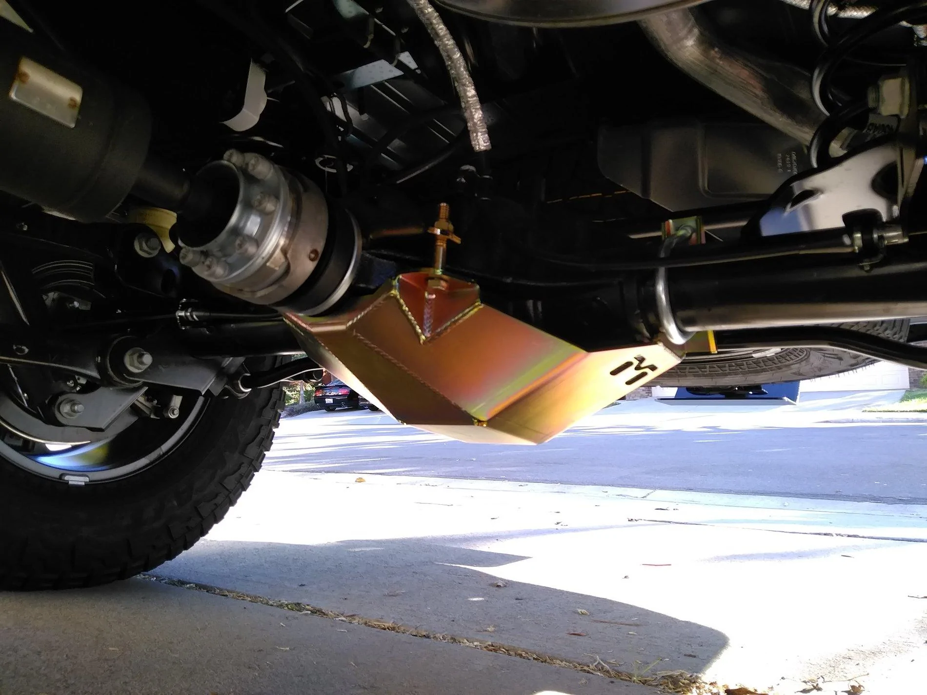

For this reason, I went with Metalcloak for the diff covers and skids... The front skid has separate bosses on the diff cover for attachment. the bolts are separate from the bolts that screw into the axle... Of course, this skid can only be used with the Metalcloak cover... The rear metalcloak skid is excellent and can be used with any diff cover. Both skids are tucked in nice with minimal clearance losses.

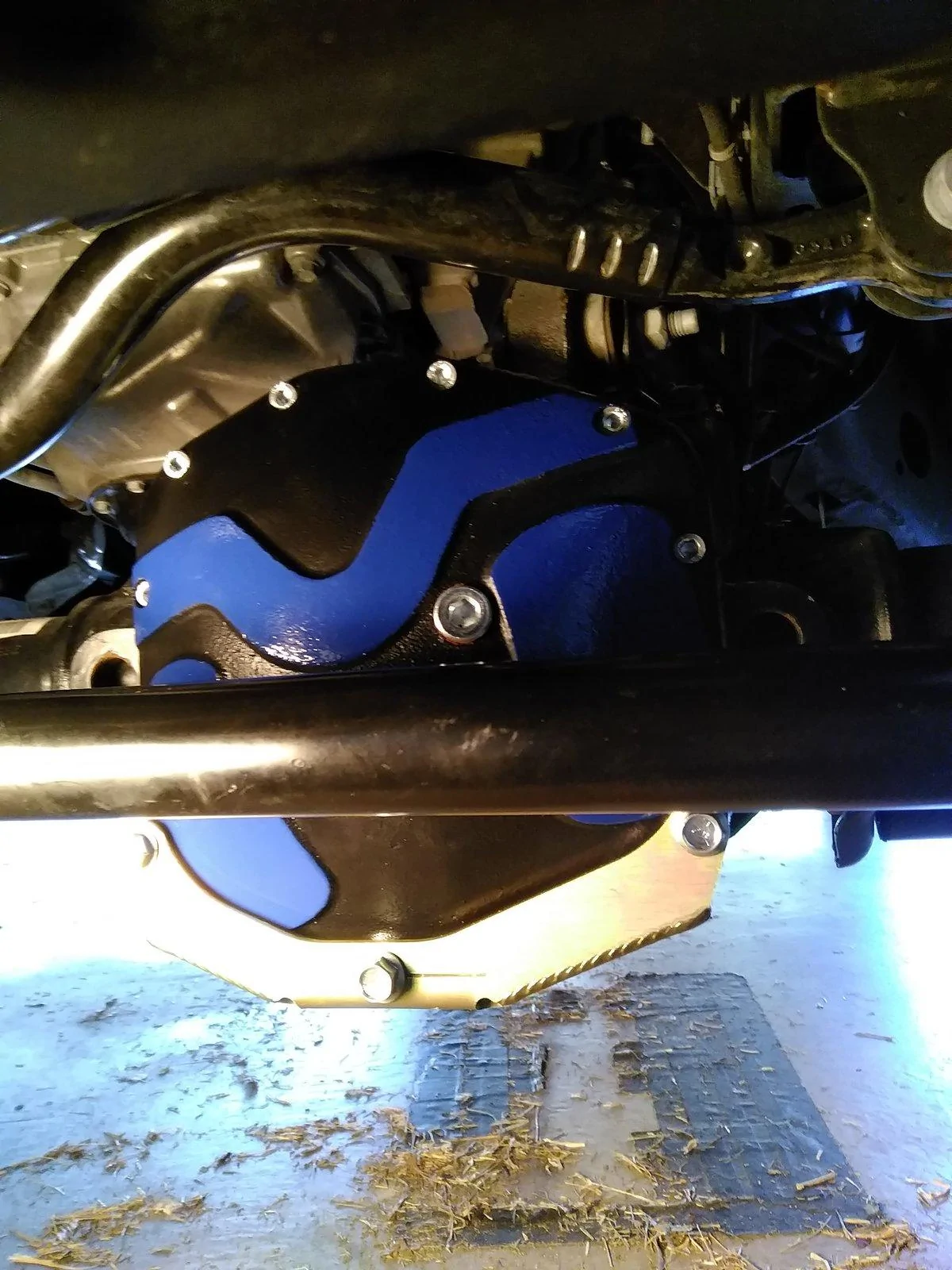

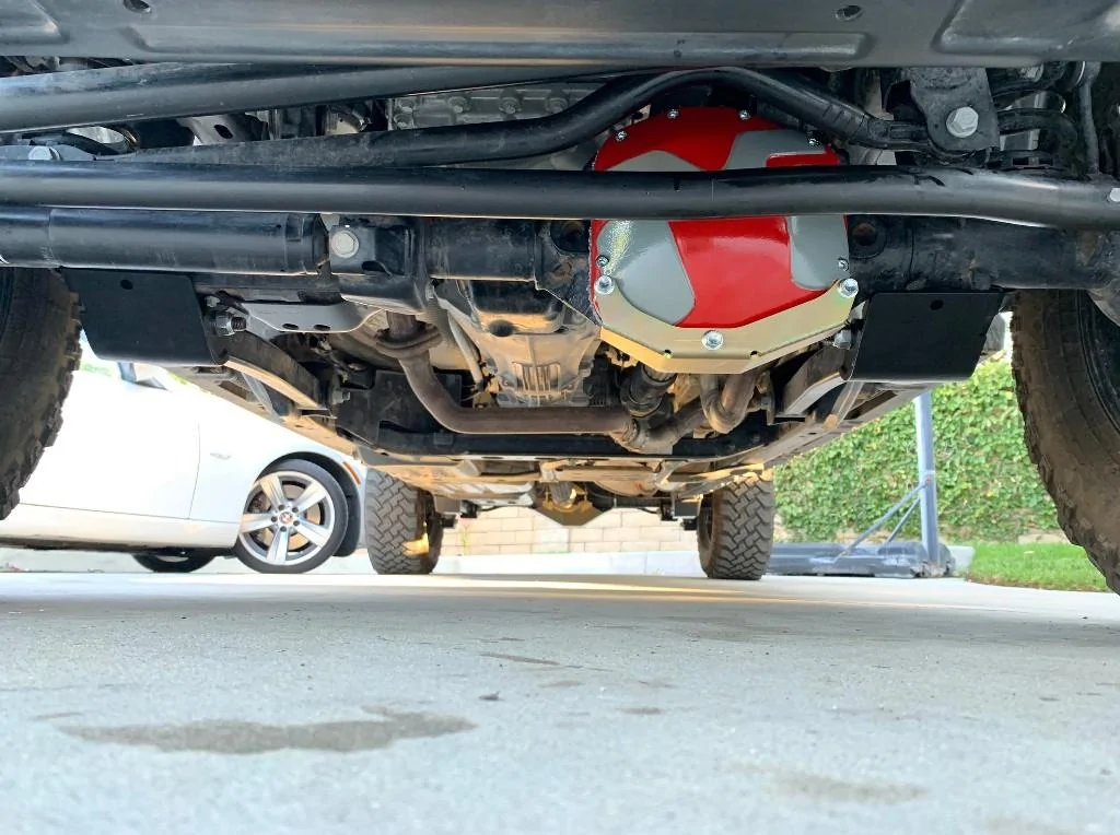

Finally got time to install my front differential cover and skid. More work than expected, it was like the factory used locktight on the cover bolts. Now front and rear are protected
Jeep Gladiator Front and rear differential skid plates that don’t bolt to differential cover. IMG_20200920_130949
Jeep Gladiator Front and rear differential skid plates that don’t bolt to differential cover. IMG_20191109_082708

I put Metalcloak front and rear diff covers and skid plates on a stock JT Rubicon with manual transmission with no track bar interference issues. I used the supplied silicone for the diff cover instead of the reusable rubber gasket on the stock cover. This practice will insure that you have plenty of clearance.

Wished I had read more closely the Permatex was supplied in the kit, I ordered that and synthetic gear oil from Amazon when I ordered from MC. Chris called me up to let me know the rear skid might be a week and a half out, I've NEVER had a head's up from a vendor like that!
Jeep Gladiator Front and rear differential skid plates that don’t bolt to differential cover. HGLXNi
