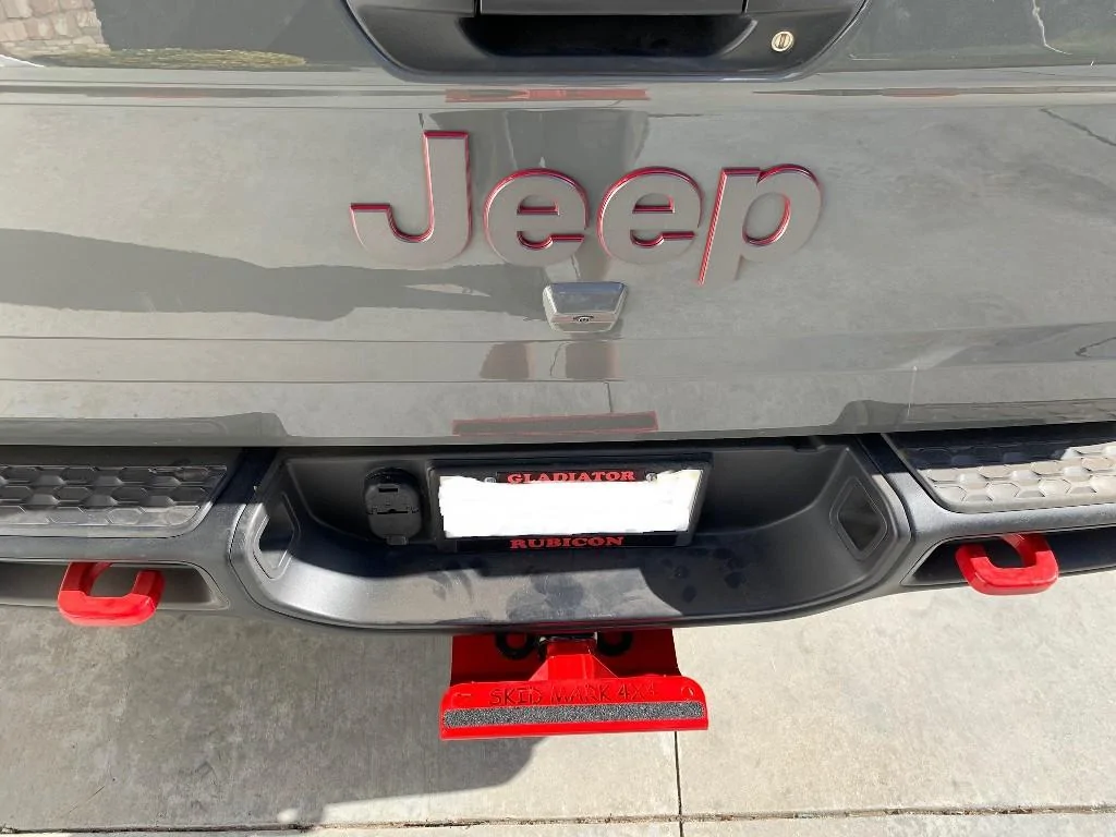

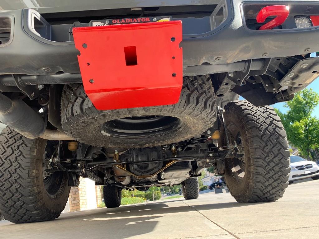

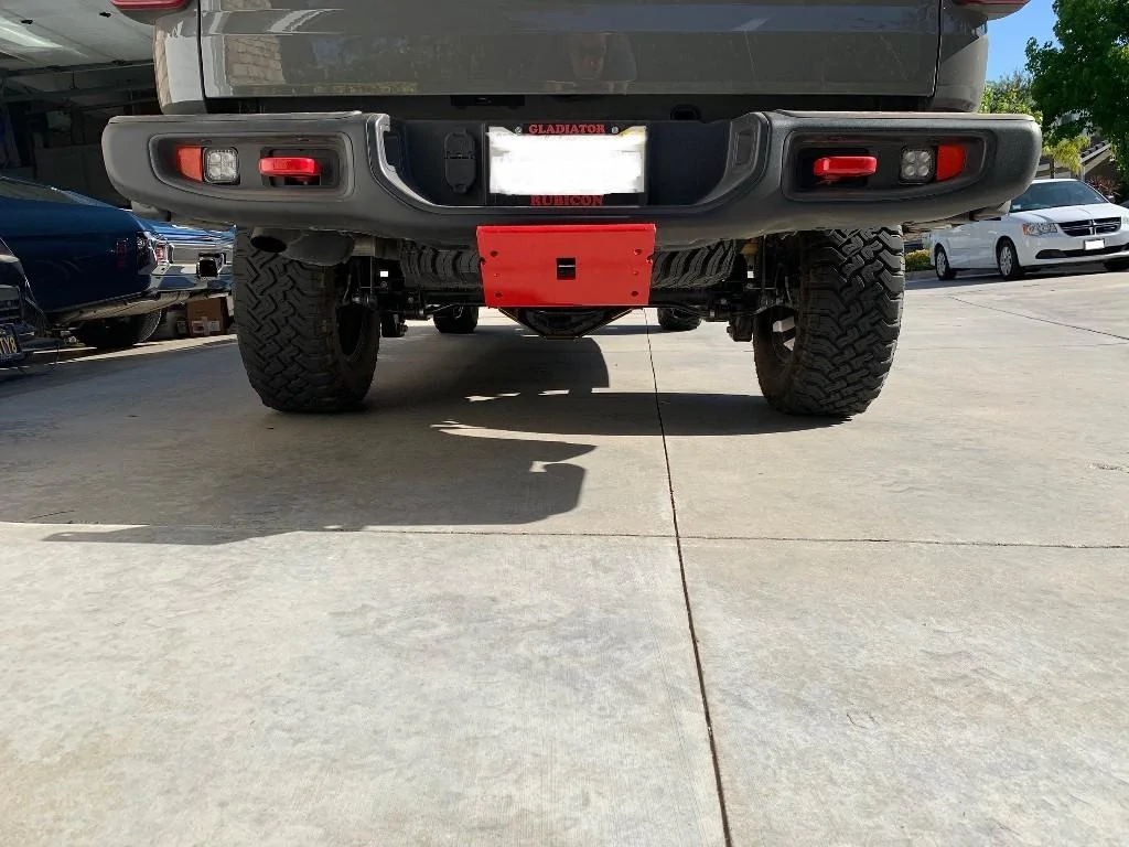

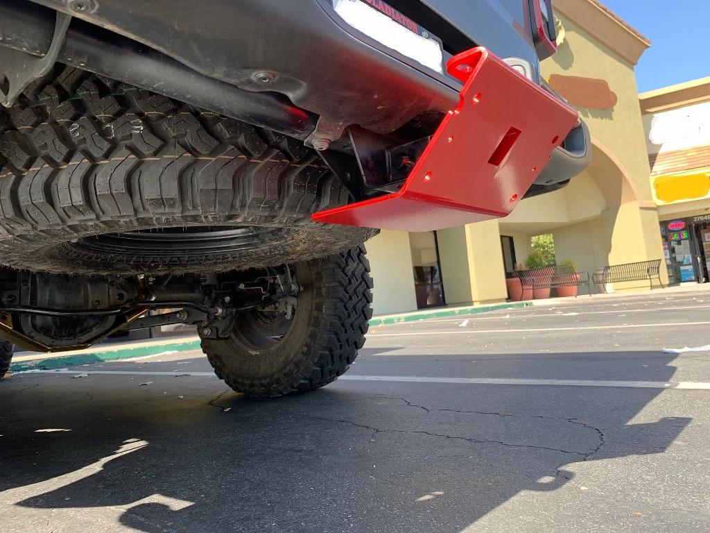

You can run it all the way in to the last hole with no issues.

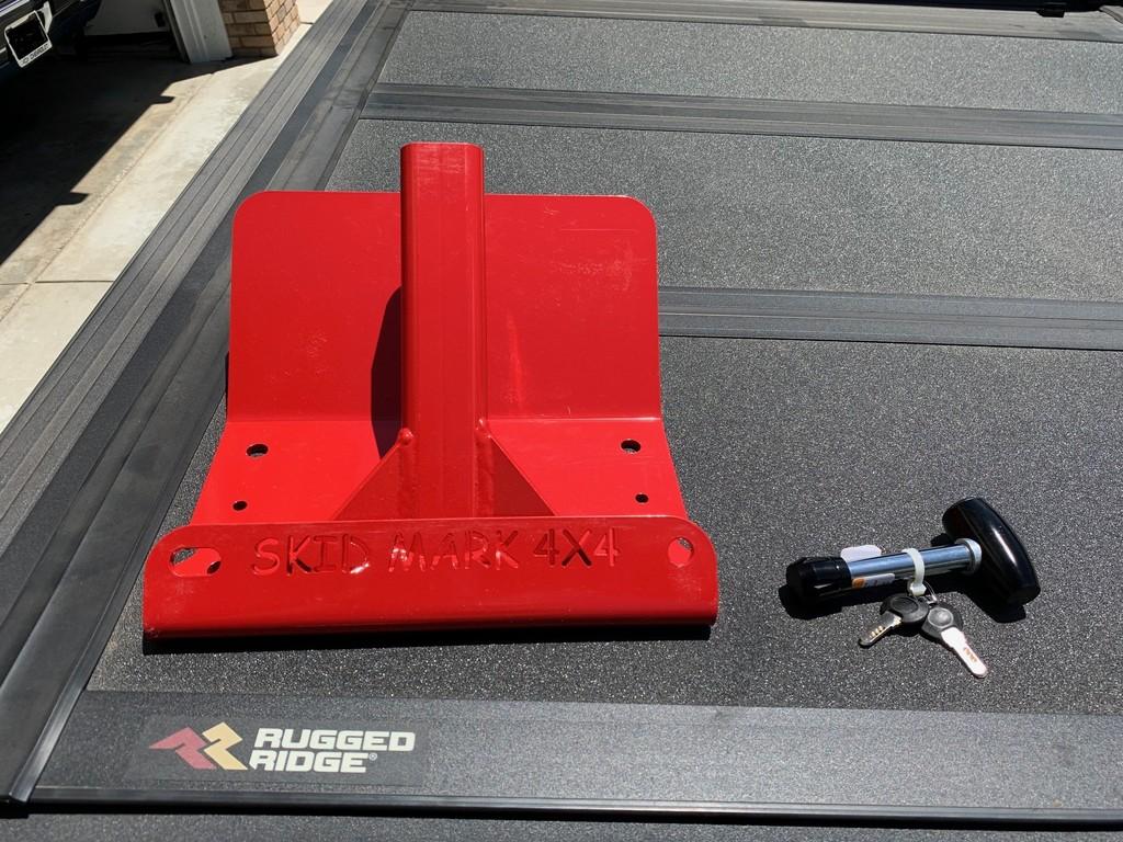

I Just received my Skidmark. What a Great tip ! Addresses the most common scrape spot and everyone thinks it looks great. I will leave mine on permanently. Thanks again.

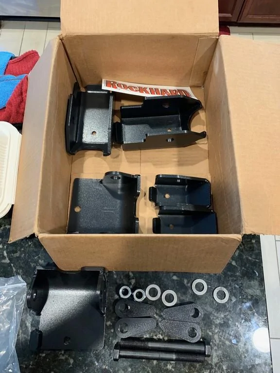

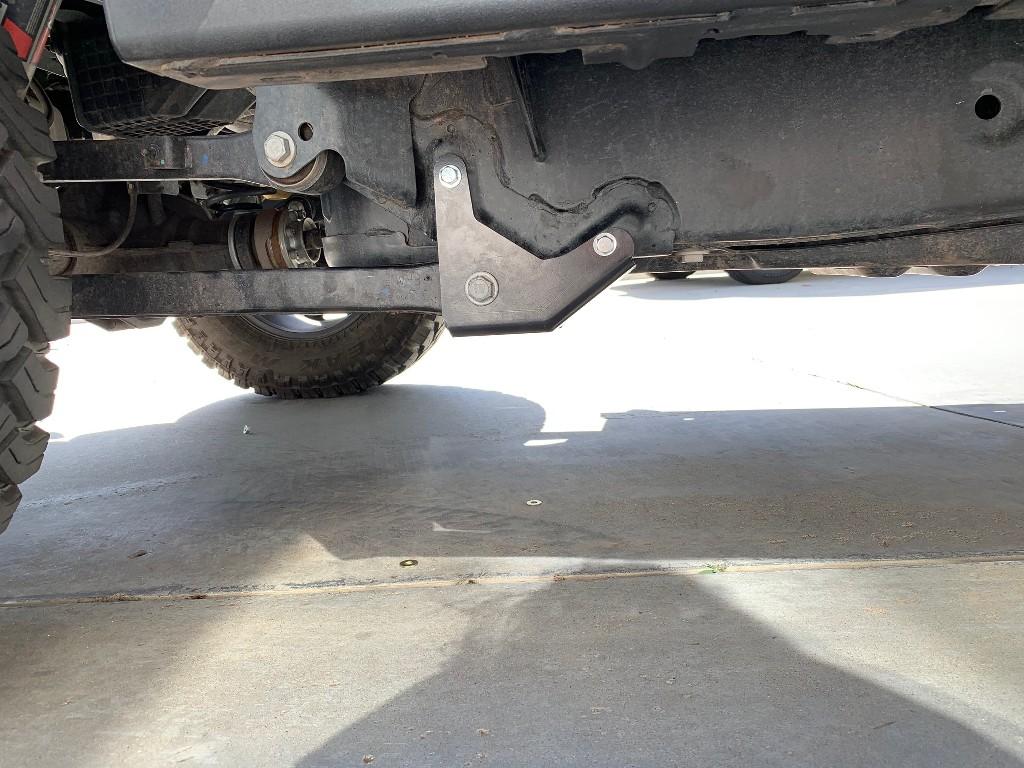

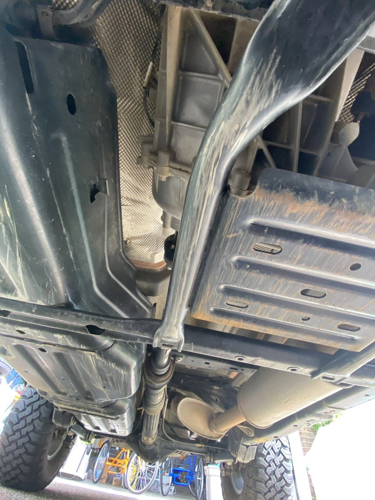

I received my 6 Rockhard control arm/shock Skids to go with my 2 Rusty's rear control arm skids. I should have time to install them tomorrow. Black powders coating and welds are really nice. Packaging was excellent.
Here is a pic of the Rusty's rear control arm skids I already installed. 8 total skids when done. I will probably also get the RockHard FAD skid.
For Diffs, I ordered Metalcloak front and back diff covers and skid plates, those will not be here for a few weeks.

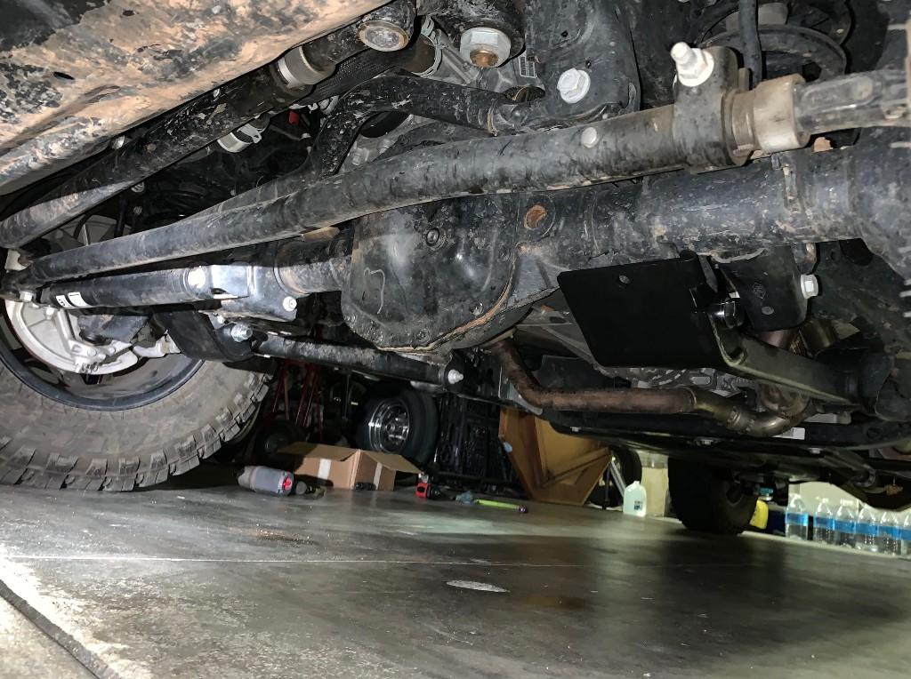

I installed the Rockhard front and rear control arm armor and the Metalcloak rear diff slide. I only have the Metalcloak diff covers and Metalcloak front skid left to install. I will have the diff covers powder coated.
I like the armor, seems to be stout and just in the right spots.
Front Rockhard control arm skids
Jeep Gladiator So, how much do you really scrape the belly while off road? Lifted. icddTR
Metalcloak skid, Rusty's rear control arm armor (front part), Rockhard rear control arm armor & shock armor.
Jeep Gladiator So, how much do you really scrape the belly while off road? Lifted. BCbvi6

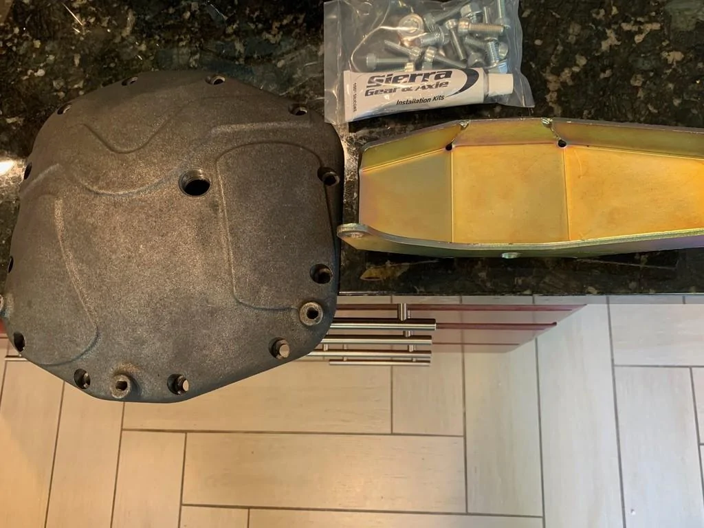

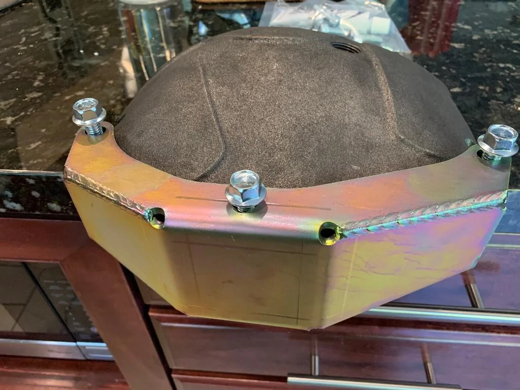

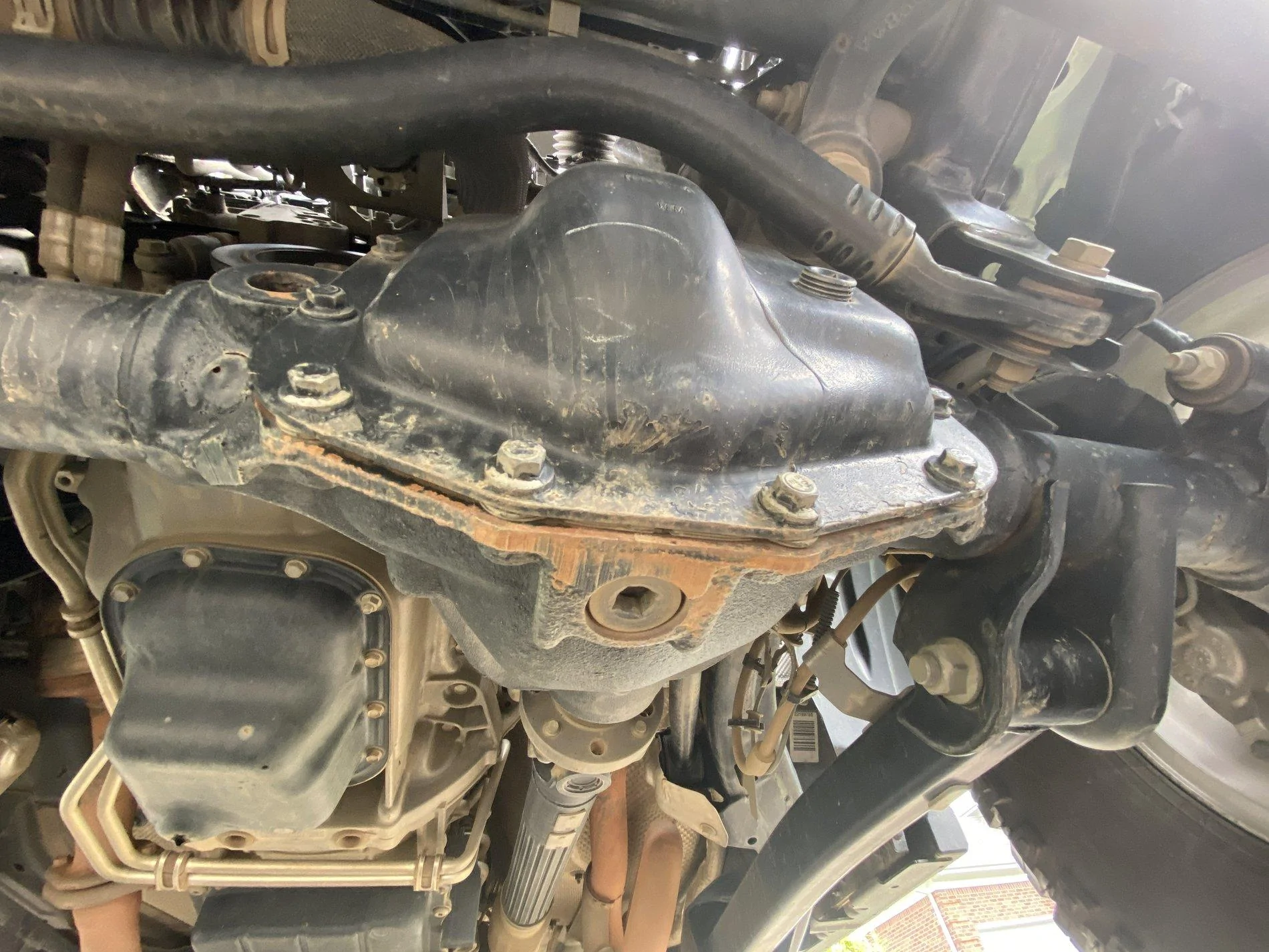

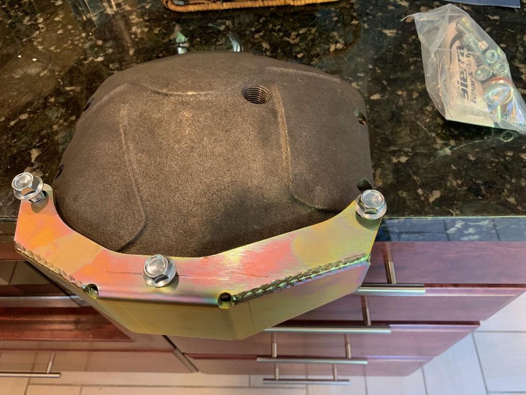

The Metalcloak diff covers came in. Here are some pics of the front diff cover and integrated skid system. Pretty cool that the bolts are separate from the diff cover bolts. Hex style so you can get them off with vice grips. I am getting the bare diff covers powder coated before installation.

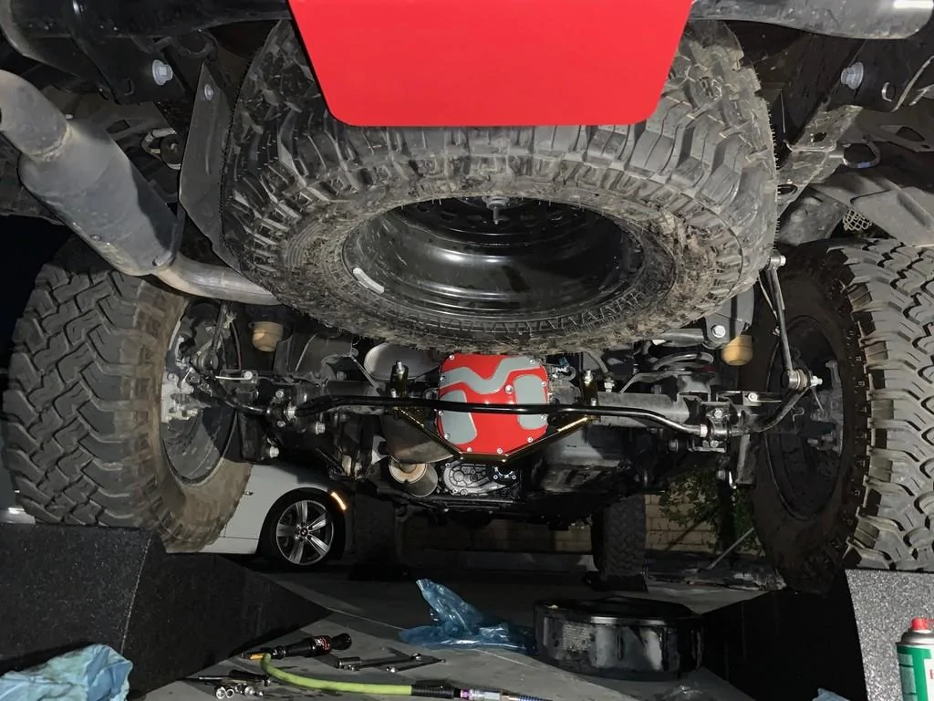

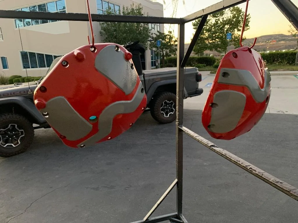

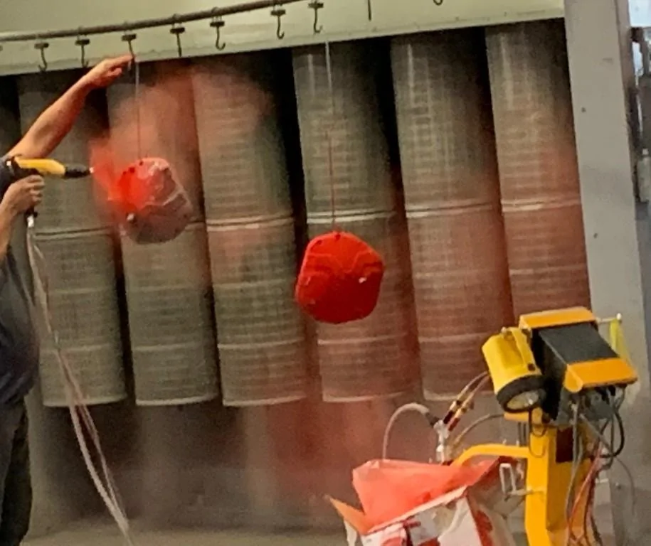

Metalcloak Diff covers powdercoated, ready for install. 2 Color - grey first, then red. Here you can see the second red coat going on with tape over the grey. I am hoping it will look good with our sting grey JT and the gold skid plates.
Jeep Gladiator So, how much do you really scrape the belly while off road? Lifted. 9D9Wbk
Jeep Gladiator So, how much do you really scrape the belly while off road? Lifted. xptSgi

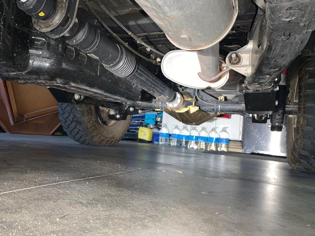

MetalCloak rear diff cover and Metalcloak skid installed

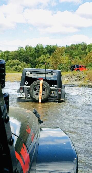

I was with a few JLs and JKs . I was the only one who scraped getting out.

Was that badlands? Looks like where I filled my JK floorboards (doors off) going the other direction a few years back. LOL

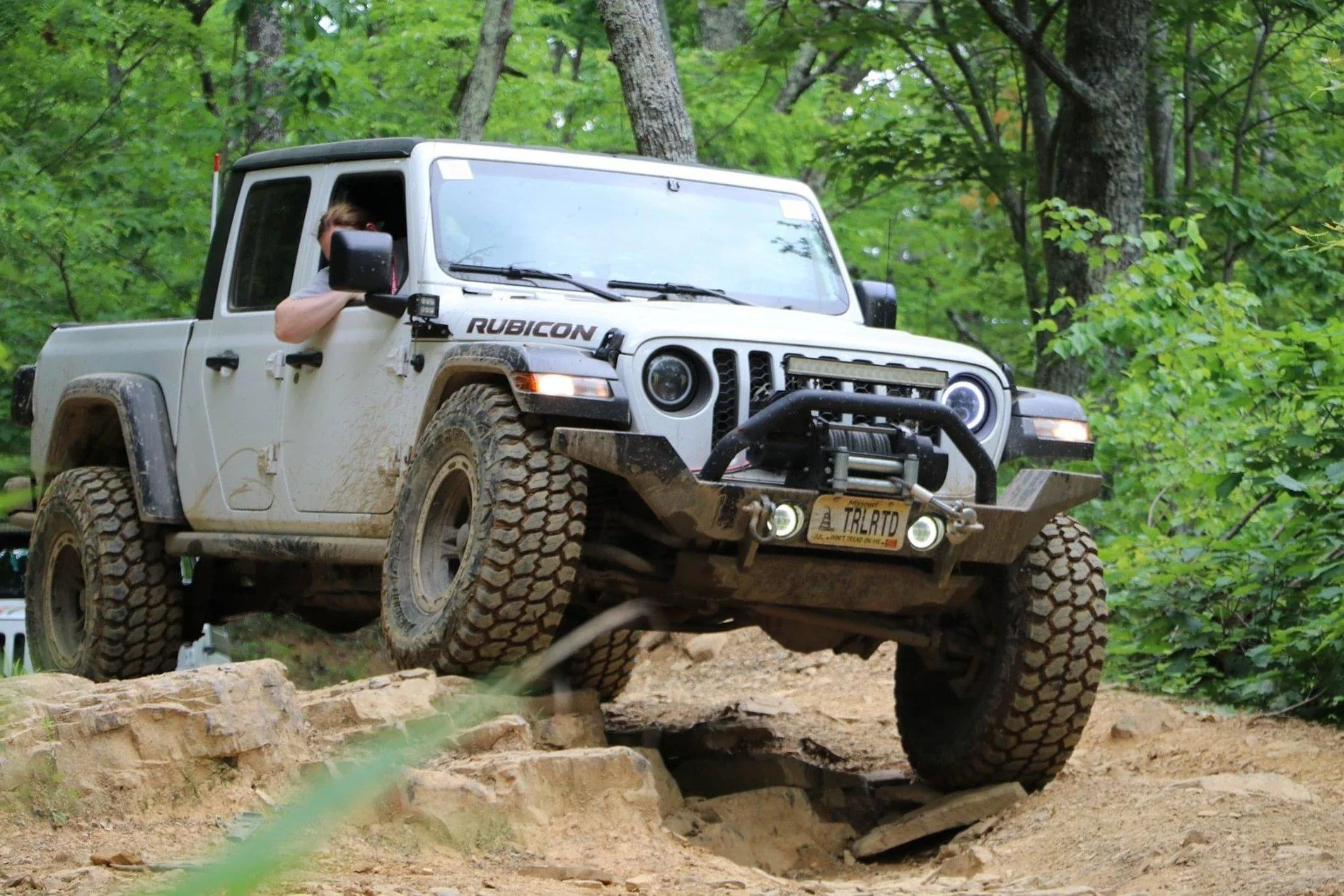

Anyway, the stock JTR is the same height as the JLUR but the long belly makes a difference. Went to a Jamboree last month and both of us with JTs just had to pic our lines better. Going over a rise like that, the 2&4 doors were able to ride in the ruts and not scrape (barely). I moved over a hair and kept my tires out of the ruts and didn’t drag. Other JT followed my line and didn’t touch either. Tail end landed on a few ledges but knew it was coming so creeped down until I set the receiver on the rock and used it like a rock slider. Not really damaged at all. Just a couple scrapes to the sliders where the wranglers were able to weave between the big rocks and I had to take a tire over at least one. Again, set the truck softly onto the rock and drug it slowly until the rear went up and over. Just a few scratches underneath but no real carnage. Of course, I crawl the rocks, not “drive it like I stole it”
watching your video, I’d bet if you had went a little left or right and taken a tire over the rock in the middle you probably wouldn’t have scraped. All a matter of picking lines to make up for the long belly :like:
Jeep Gladiator So, how much do you really scrape the belly while off road? Lifted. 7757F625-A70F-43C3-8A71-E40CC731826E
37’s with 3/4” of lift

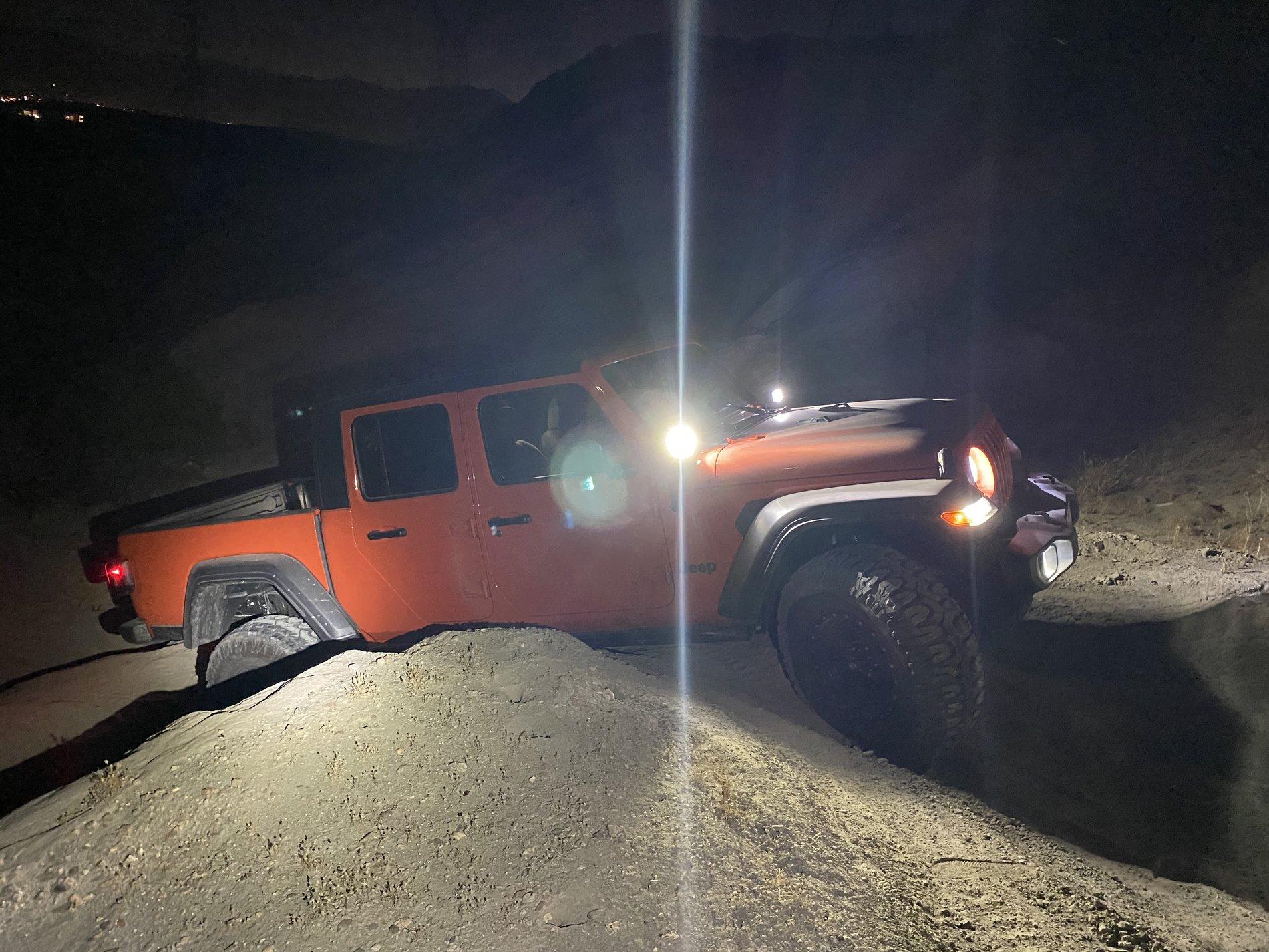

Jeep Gladiator So, how much do you really scrape the belly while off road? Lifted. 5A3EC151-9CE9-45BB-871B-CA90F777F0FA
Gas tank skid with a slight scratch. I will say this obstacle proved how important lockers are, and it’s driving me crazy that nothing besides ARB is on the market.

Great Pic ! Nice truck ! Yea... get that passenger front tire off the ground and one of the rear tires in the air and your done. Try feathering the brake with the accelerator depressed and traction control on, and turn the wheel. That will usually get all the wheels turning again for a few moments.

I still am getting used to wheeling in an auto. I just figured out the 2 footed technique to not roll backwards from a stop. Been wheeling in a stick my whole life ha!
