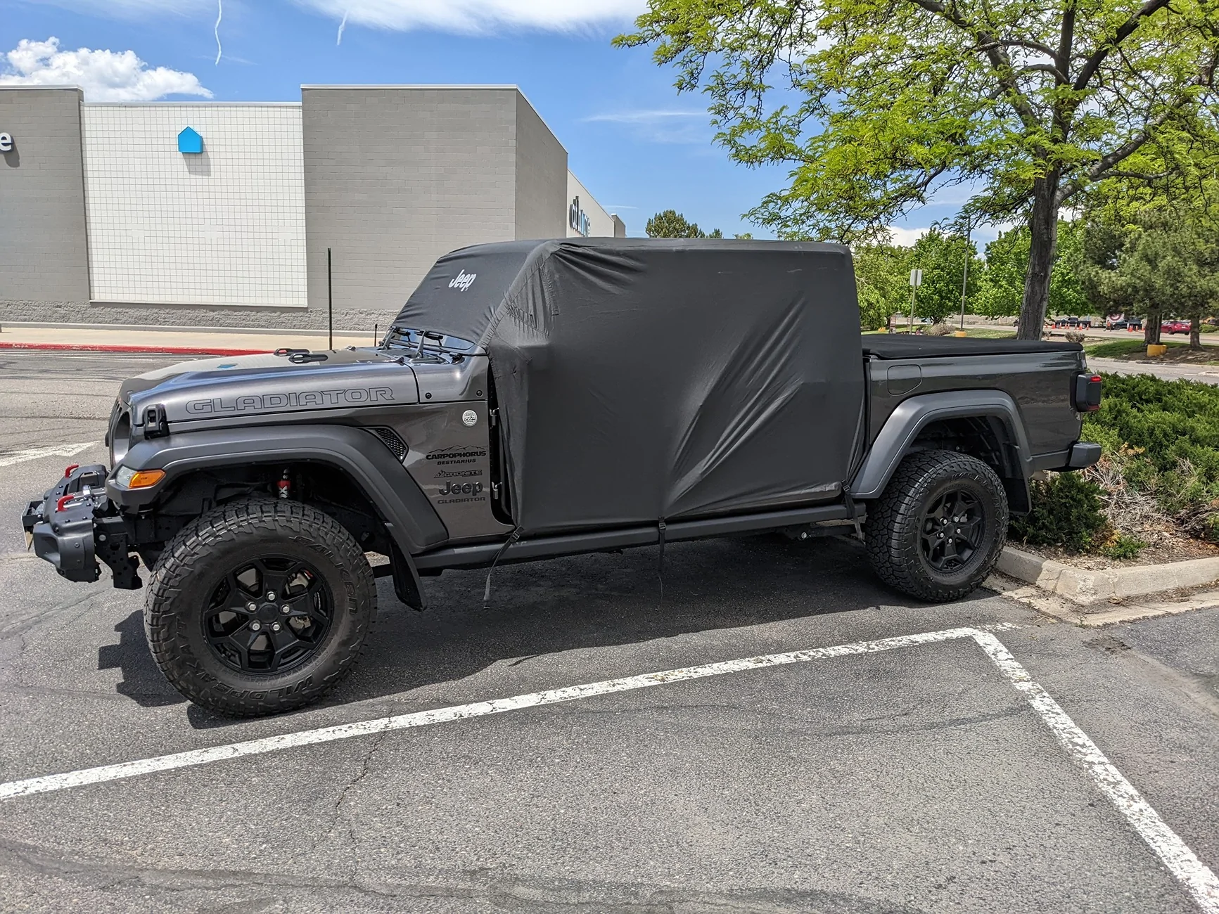

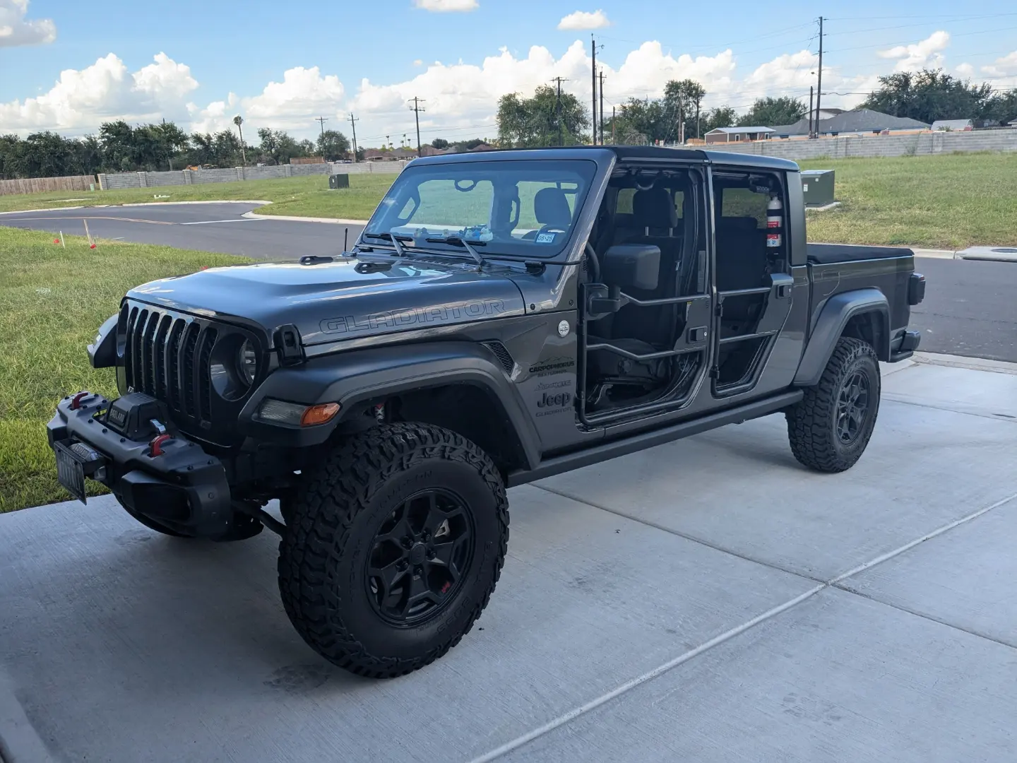

Lock the things that can be locked. Don't make it appealing to sticky fingers. Cab covers make it less visible to passers-by. My tube doors stay locked, I just use the inside handle to unlock. I do have a 360° always record dash cam

Granted I'm not yet doors off but I do tend to leave the Sunrider and windows open.
A determined thief is going to get in no matter what but most grab and go's are crimes of opportunity so don't give them anything to grab.
-No valuables in sight
-Lock the rear under seat bins
-Fuzzbuster goes in the Console Vault
-Locking hood latches
-Always arm the alarm with the fob.
I do plan on getting the Tazer No Limitz in the near future as an added level.
