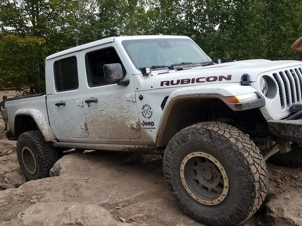

I am running the NItto Ridge Grapplers in 37x12.50x17 with the Mopar 2 inch lift and have only had a couple of issues. I smacked the Bejesus out of the FAD skid plate somehow and one of the lower control arm mounts in the rear. I replaced the FAD skid with a RockHard 4x4 skid and also added the lower control arm skids from them on the front and rear as well as the lower shock mount skids on the rear. Otherwise The only clearance issues I have had has been with breakover angles on some hills that even the JKU's struggle with but ya just gotta send it sometimes . The picture is from Drummond Island Michigan at the Marblehead trail. It is on the Jeep Badge of Honor page if you want more info. I did not even come close to scraping here.

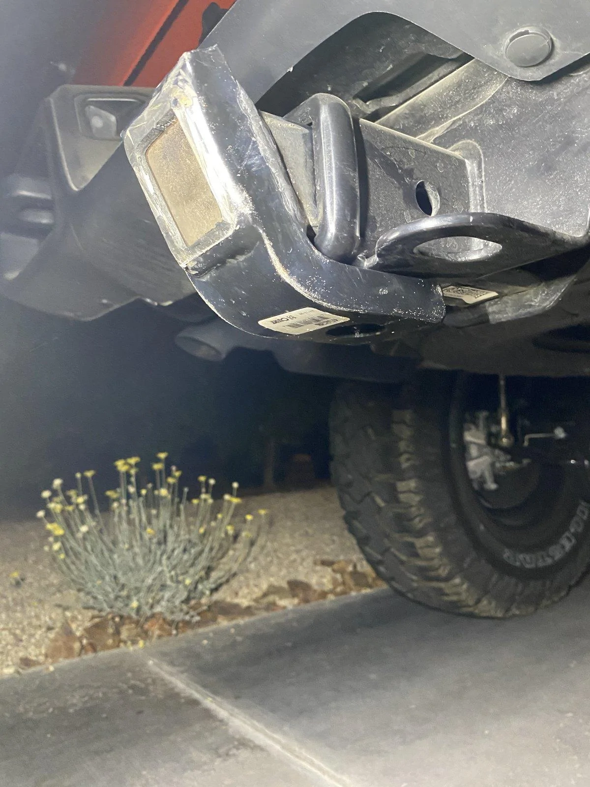

I received my 6 Rockhard control arm/shock Skids to go with my 2 Rusty's rear control arm skids. I should have time to install them tomorrow. Black powders coating and welds are really nice. Packaging was excellent.
Jeep Gladiator So, how much do you really scrape the belly while off road? Lifted. GWyKd3
Here is a pic of the Rusty's rear control arm skids I already installed. 8 total skids when done. I will probably also get the RockHard FAD skid.

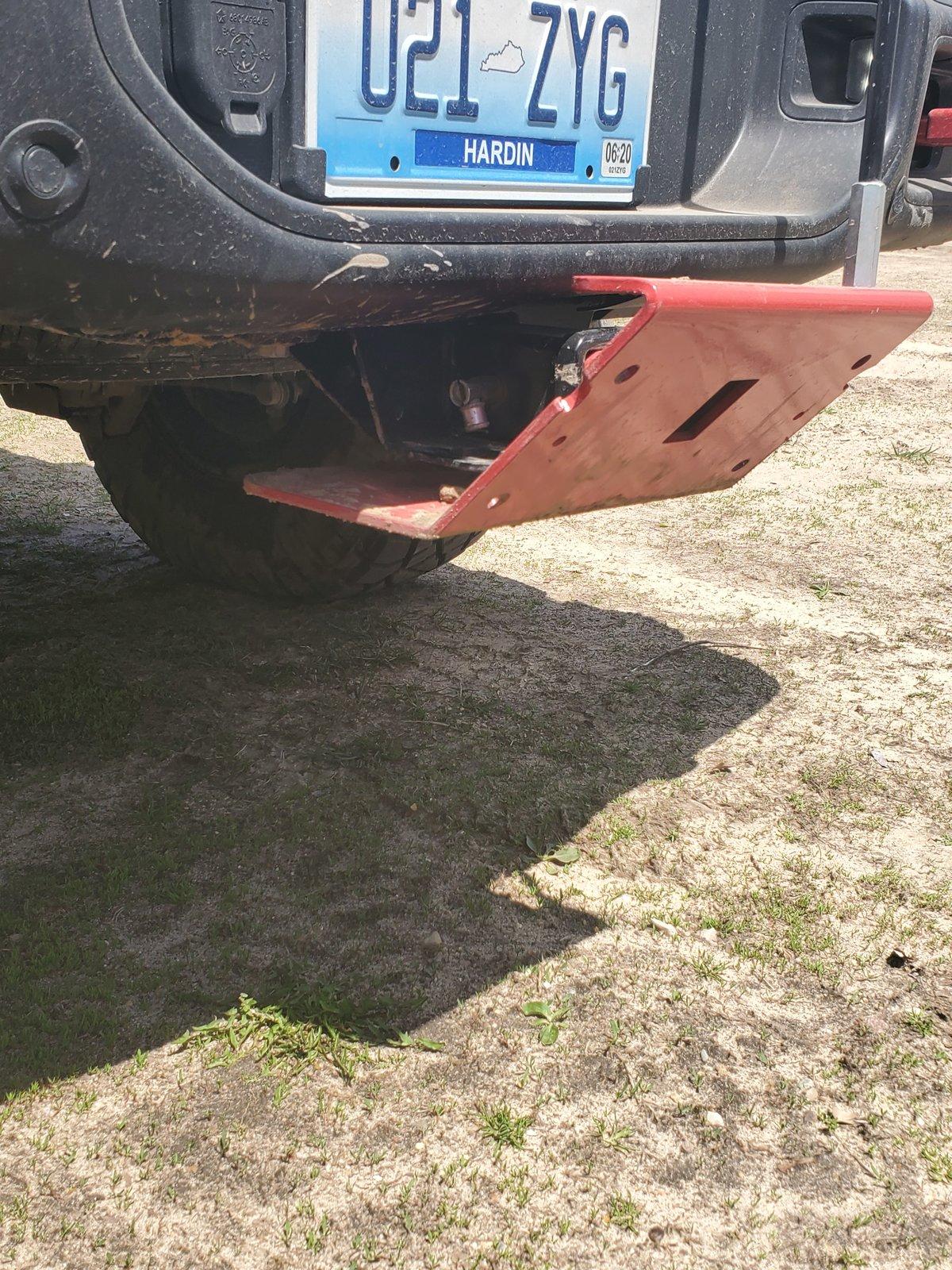

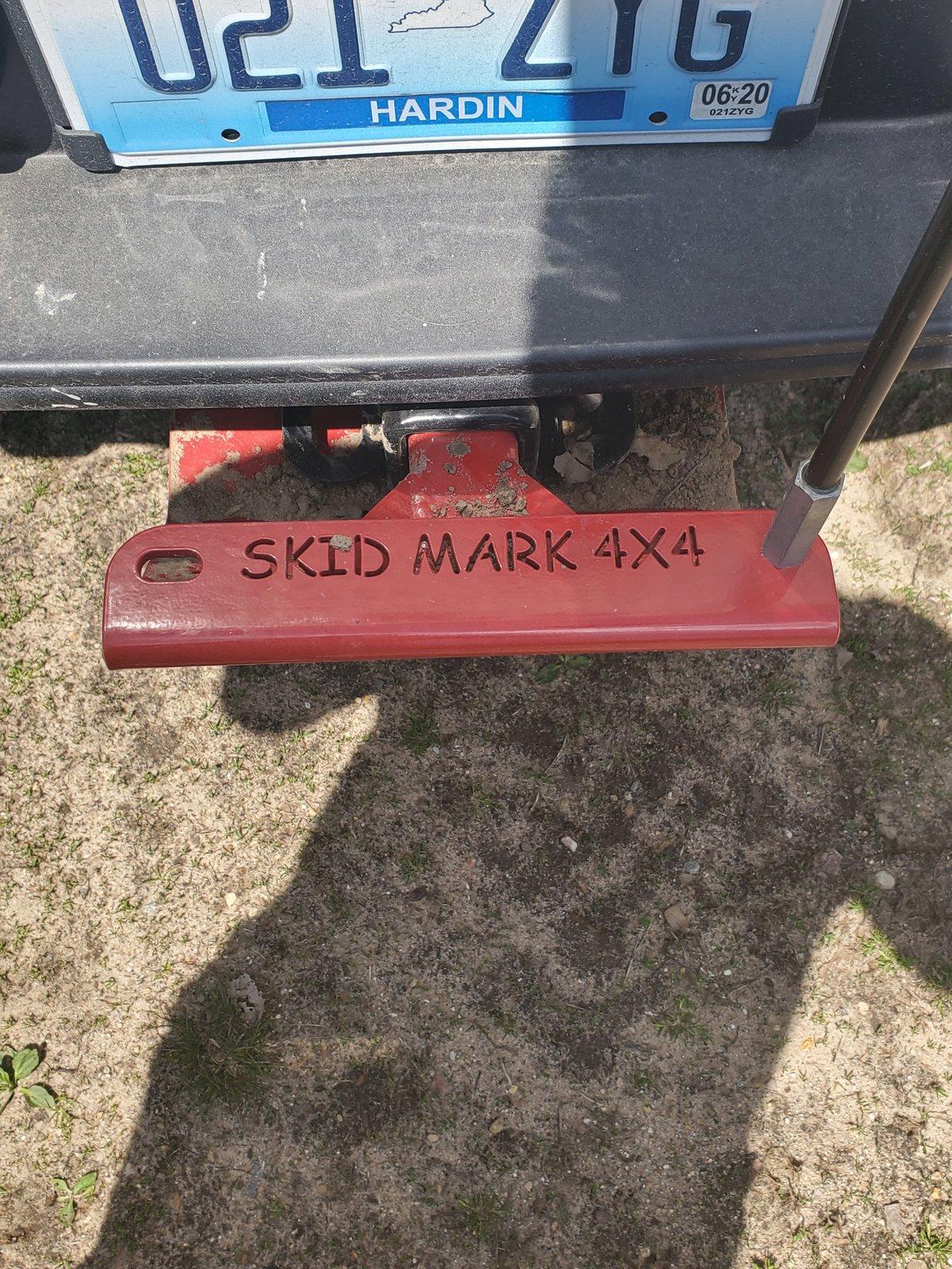

See my pics above

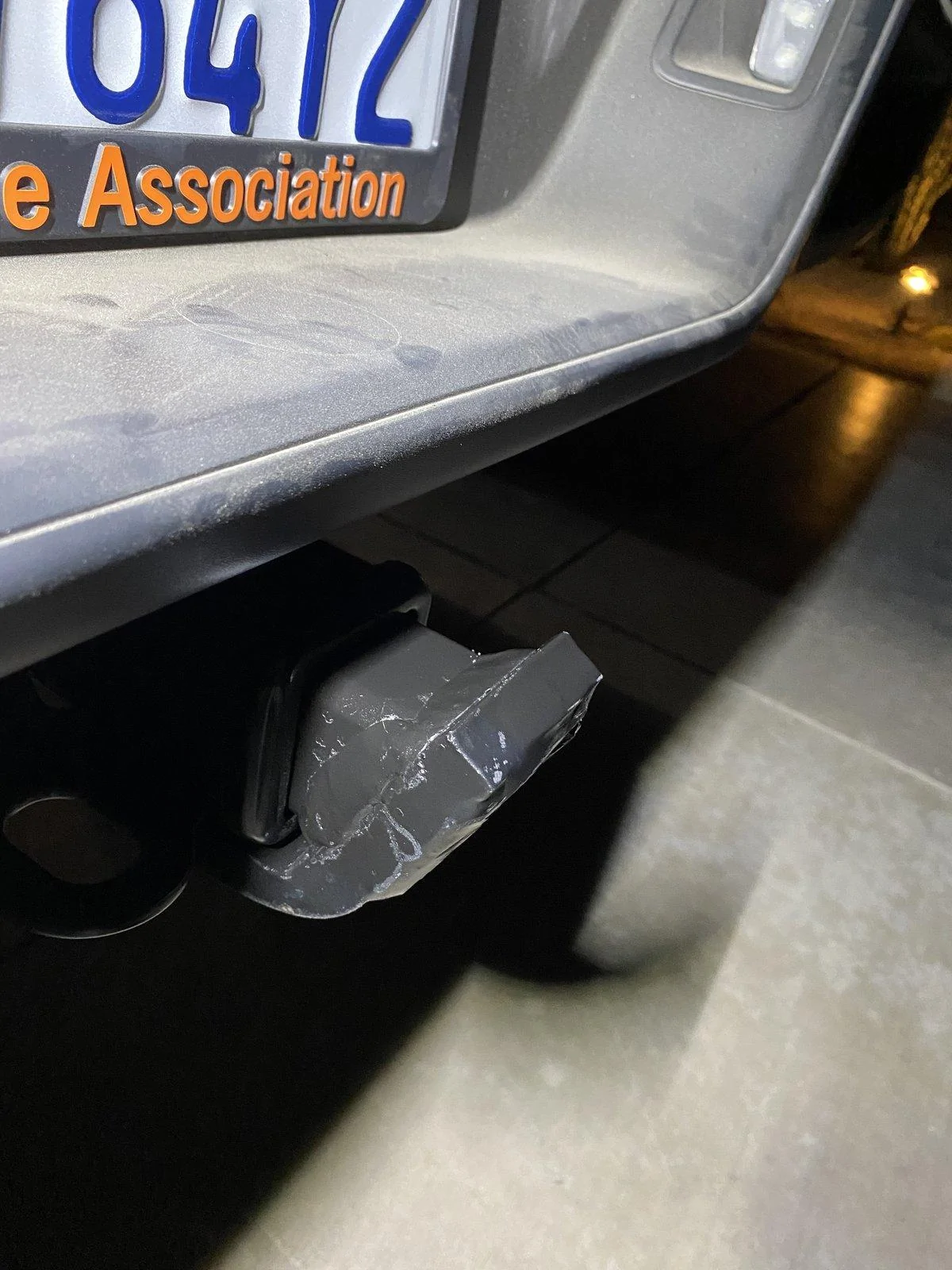

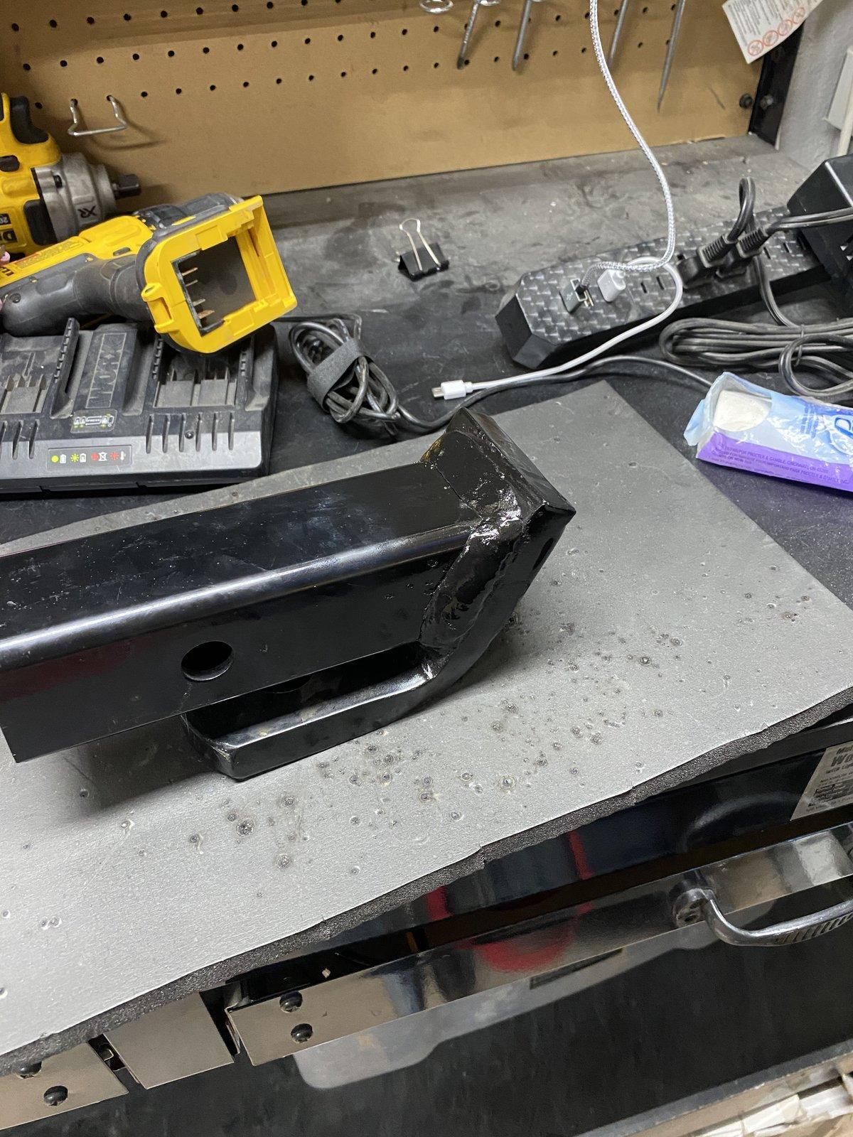

Yeah, I don't care for how far back that sticks. I want a permanent solution and neither want to run my knees into it, nor my kids heads. I'm going to make a super-low profile skid, as with a wheelbase this long, every inch farther off and below the back is undesirable.
I almost wanted to take the hitch completely off, but since the bumper ties into it I deemed it too much trouble. My idea is having a skid so flush it would appear to simply be welded to the bottom of the receiver. We'll see how it turns out, ha!

Thanks ! That looks perfect. I just ordered the same red one. Were you able to use the last hole to tuck it up as much as possible ? or does the receiver hit the spare tire ?
You can run it all the way in to the last hole with no issues.
