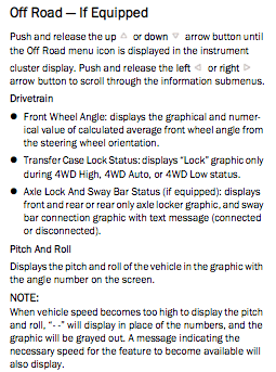

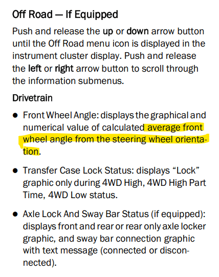

Where’s this graphic located? I can’t remember seeing that. All I can think of is the front camera view.
I'm not sure if this is available on every model/year. My 2020 JTR has it. It will display in the area of #3:
Jeep Gladiator Front driver side wheel sticks out more than passenger side ? Screen Shot 2023-08-02 at 4.35.56 PM
Toggle your control buttons to the Off Road Display
Jeep Gladiator Front driver side wheel sticks out more than passenger side ? Screen Shot 2023-08-02 at 4.37.34 PM
Jeep Gladiator Front driver side wheel sticks out more than passenger side ? Screen Shot 2023-08-02 at 4.38.43 PM
40,445
53,880
Use the up/down steering wheel buttons, then left/right to get to it
From this you can see why it's not accurate - it calculates the average front wheel angle based on steering wheel angle so it's really showing wheels, not steering wheel, and won't be accurate for the steering wheel.
