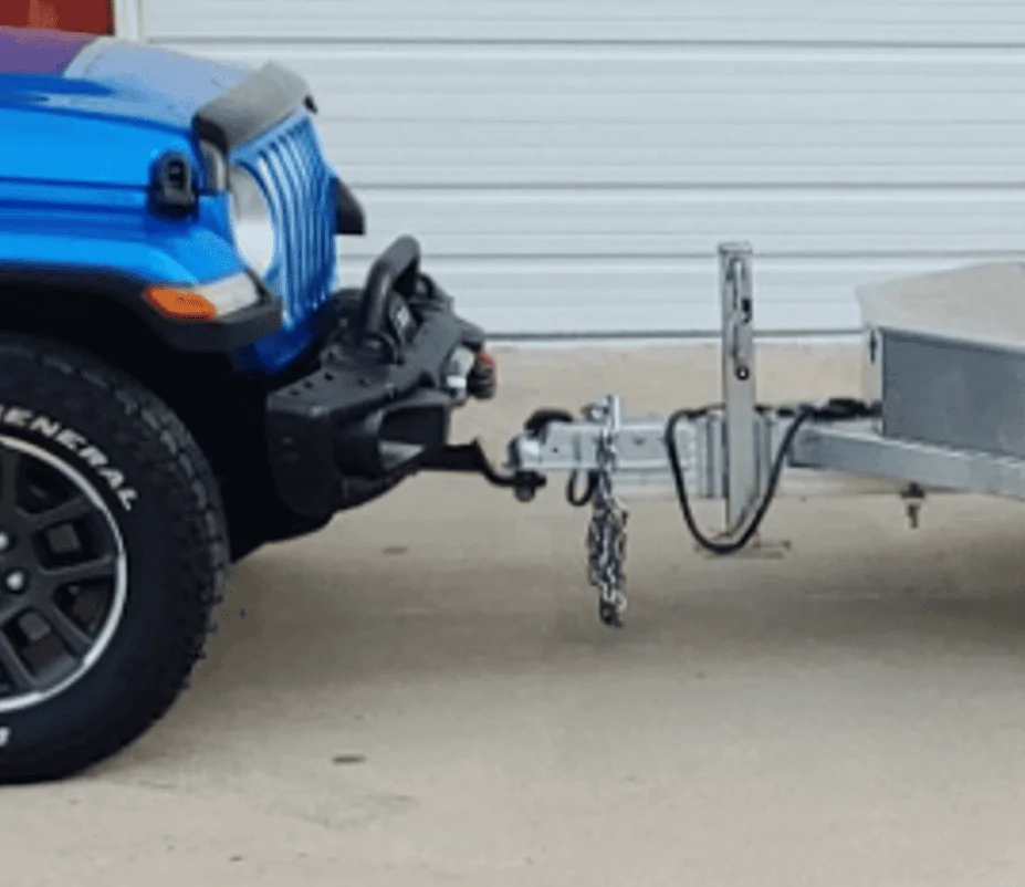

I have a front receiver and it's a pain to get the trailer lined up with the ball and not run into the bumper or the winch, etc. (pic below)

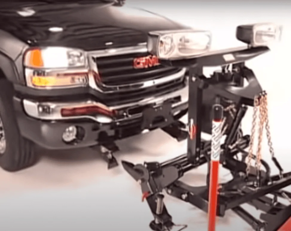

Now with a snow plow, I need to drive up to the plow and line up the mounting points of the plow with the receivers on the front of the truck (pic below)

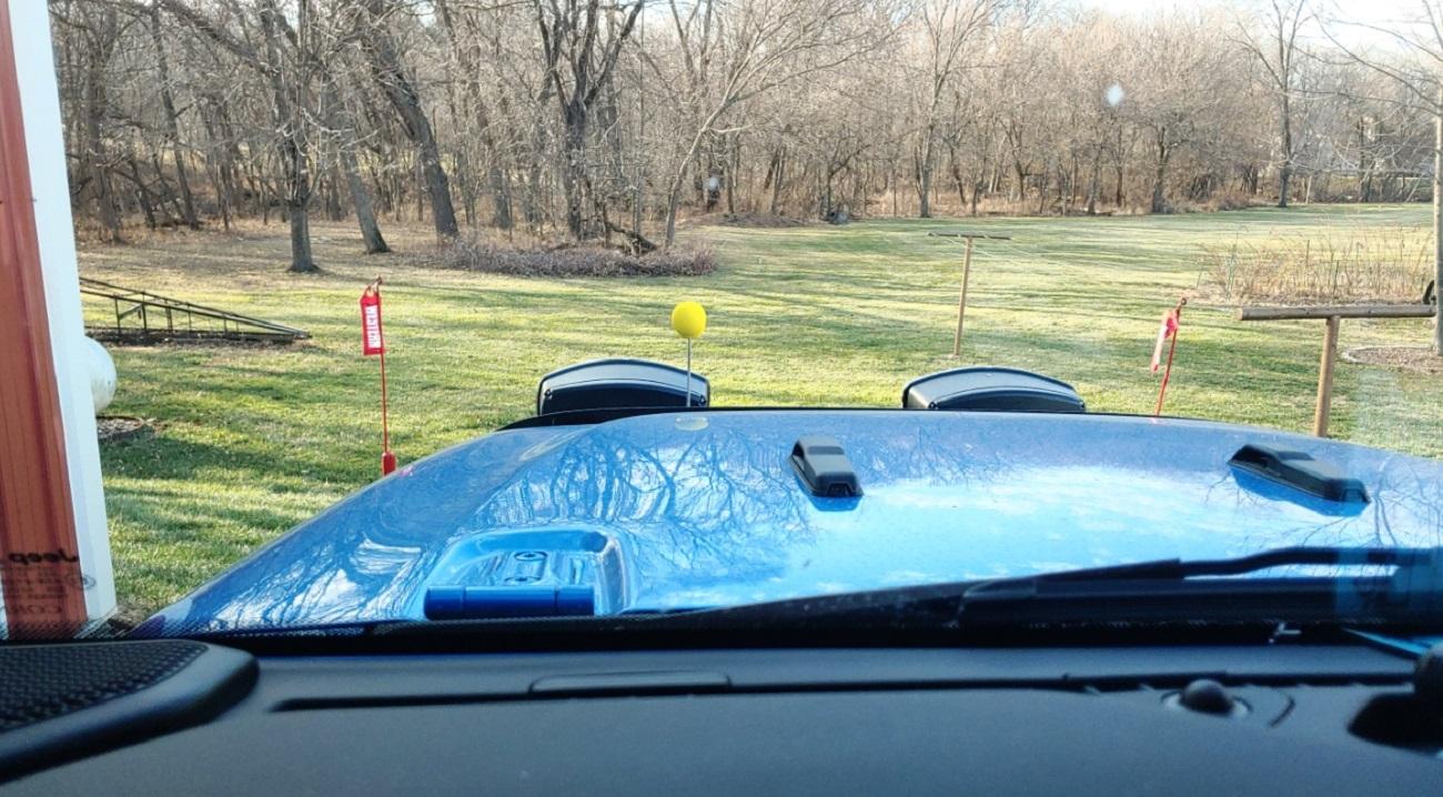

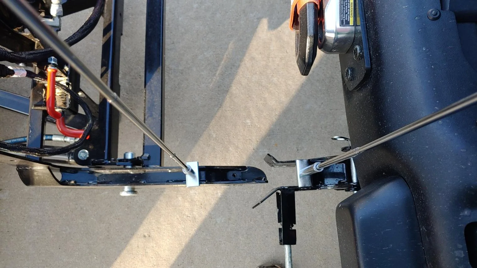

Solution (as suggested by members) -
Jeep Gladiator Front hitch/plow cam questions 20221206_143135
Result -
Jeep Gladiator Front hitch/plow cam questions 20221206_143204
It was the easiest I've ever pulled up to the snow plow and had it line up.

....the rest of the story........
Result -
That is how my Grandfather did it back in the 1980's with his Dodge and hooking up his Bass boat.
Simple but works

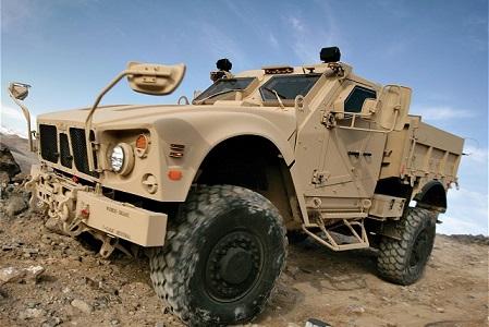

@ShadowsPapa - This may be a bit much, but, I spent a lot of time behind the wheel of a MAT-V which had these convex mirrors on a stalk. The visibility was so poor these mirrors were a godsend because they made it possible to see the front wheel track and if positioned correctly, the front bumper.
I’d always thought they would be super useful off-road for choosing lines and checking clearance. Something similar, with a magnetic mount perhaps might be the ticket.
