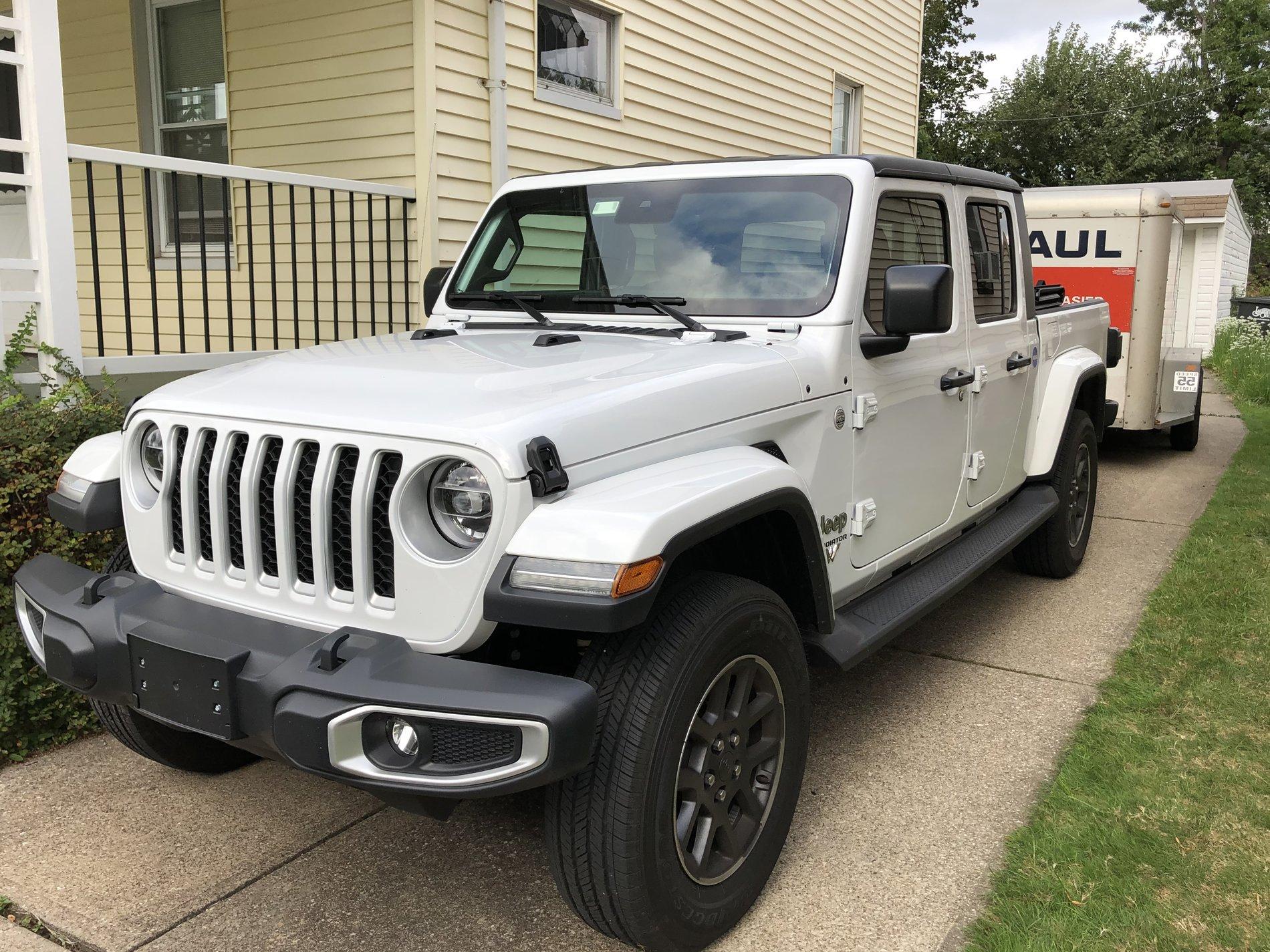

Your bumper is different. Look at the photo in post #6 of this thread.

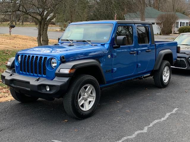

Sports don't have a front bracket. There are dimples in the bumper you drill out and attach the plate.
Yep. Two self-tapping screws go through the plate’s holes into the bumper.

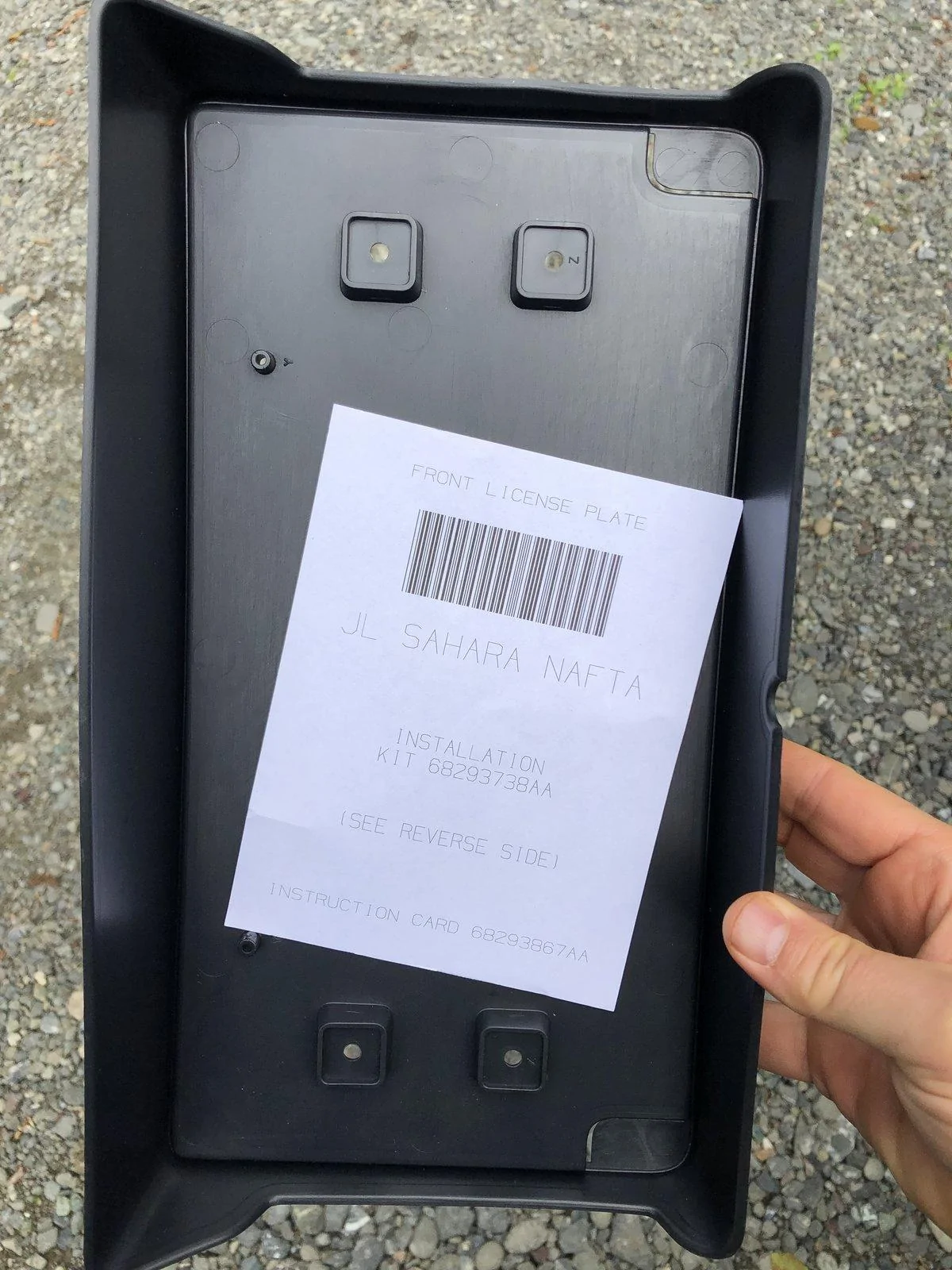

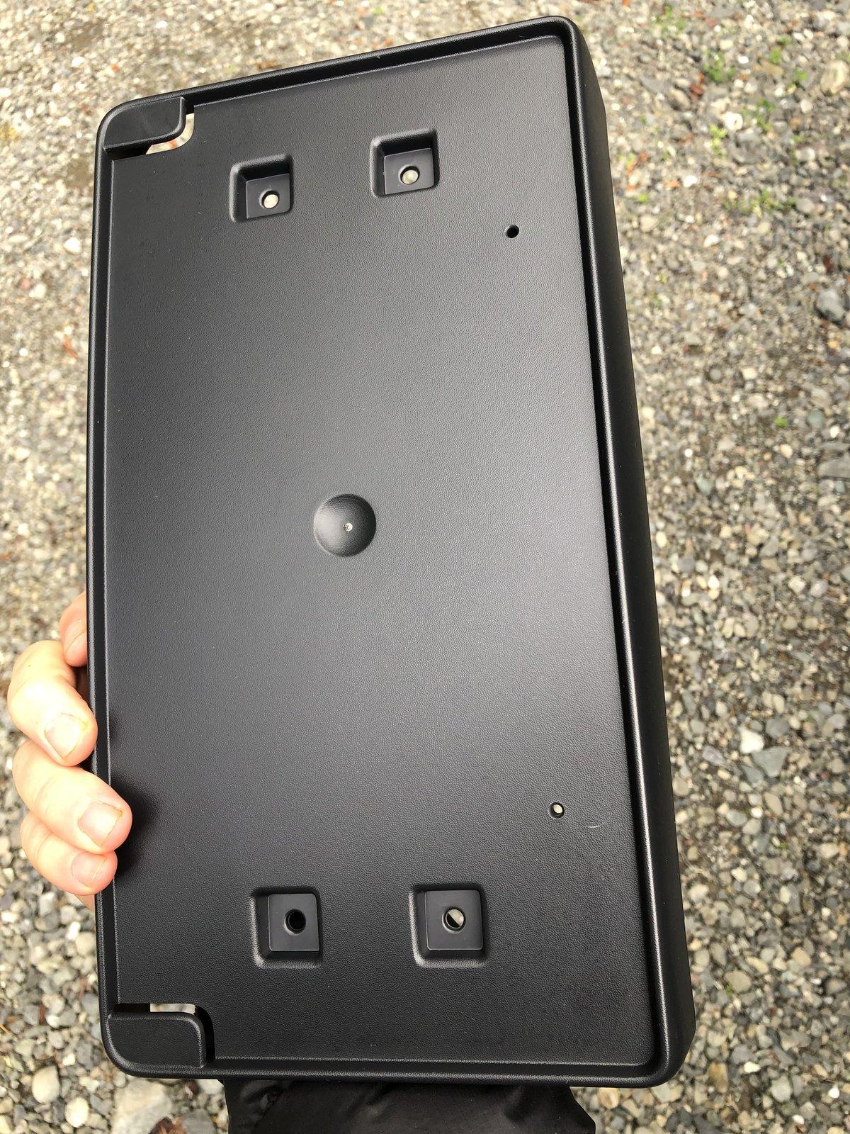

68293738AA is the correct part number for the front license plate bracket kit and should fit all the JTs and JLs with the plastic bumper. The part number for the steel bumper license bracket is 68295610AA.
