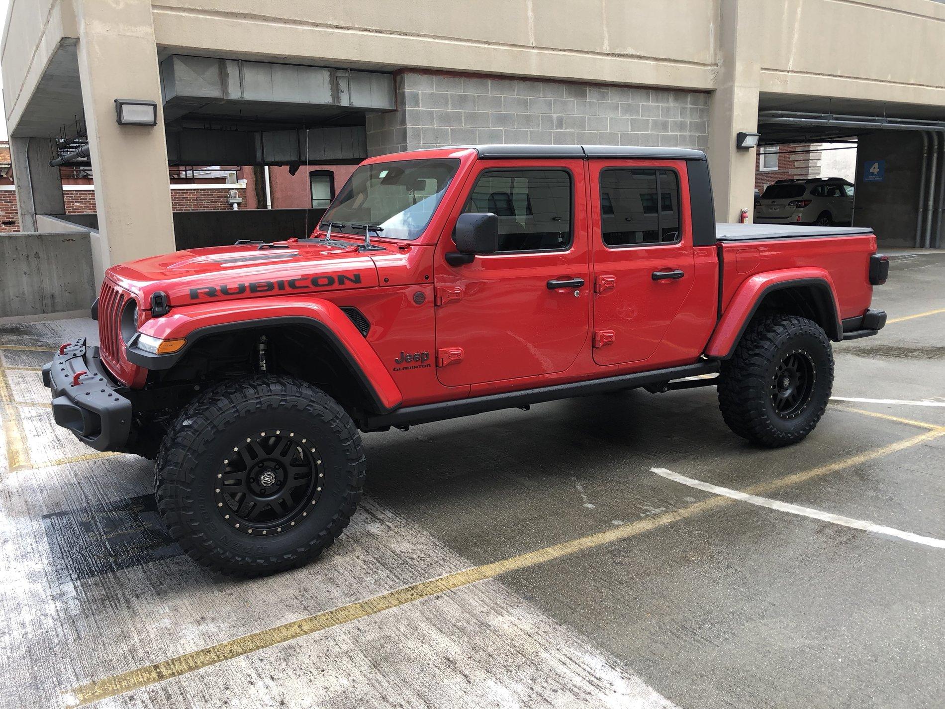

I put the JKS lift on this week. The JKS guys said that the lift would be 3" if put on a Rubicon and closer to 3.5" if put on other models. I went with the Fox shocks option that JKS offers. I also put Toyo OC M/T 35's on and I think it looks great.

That looks great, how does it ride now? Is it a firmer ride than stock was? I see there is a Heavy Duty spring option, which did you go with?

The ride is better than stock and it feels a lot more responsive to steering inputs. The steering also feels tighter. I went with the standard dual rate spring that comes with the lift. This is the first time I've had a lift with dual rate springs and I really like it so far.

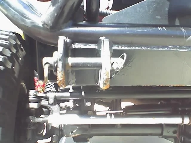

I would add these to my build...IF you expect to spend some quality time beyond the curb and like to run 3.x and above trails these would be a wise investment. My concern is the Fox Steering Stabilizer with the external reservoir. When I do a build my goal is and 'secret' is to parallel as much as possible all my steering components, track bar etc with the axle and I like to raise them as high as I can to get them out of harm's way. Takes a lot of work and some special components to do that but it will make a major difference in handling and of road performance.
I have not seen the JL/JT Rubicon axle sets, but I would hope that Jeep has designed the new and improved D 44 to allow a Hi Steer setup. See the last pic and NOTE the Trackbar, Tie Road, Steering stabilizer, steering link and axle are all on the same plane and set high. The axle ends have to be made for this and the parallelism makes for great handling on and off-road and is tucked up and out of the way. I also used a 6061 Alum Tie Rod but if I had it to do over again I would have gone with 7075 T-6 Aerospace grade. My 6061 performed well but I was able to finally bend it slightly.

High Steer setup the Track Bar is directly behind the steering linkage, the attachment bolt is just above the Steering Stabilizer bolt center of pic
Great, thanks. That is pretty much inline with how I felt about their lift on my JKUR and still do 3 yrs later. Did it firm up the ride or is it still pretty plush?
I wish they offered it without shocks altogether but oh well..

The ride is great. I wouldn't say it's firmer. I just feels like it is stuck to the road better. The steering is tighter too.
