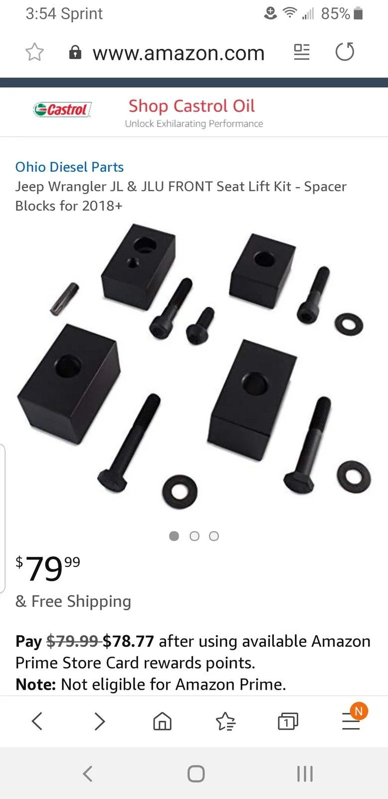

Jeep Gladiator Front seat risers? screenshot_20190519-155419_samsung-internet-jpg
@billyjk7 This kit will work to raise the front seats. To add incline I installed spacers 1/2 the size of the ones in the kit at the rear of the seat rail, gained about 1inch of incline. Hope this helps

Hmmm lot of money, think I will stay with my body mount spacers at half price or less...
