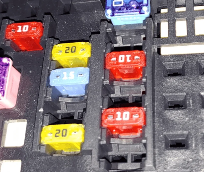

Found some great websites with descriptions of each location in the fuse box. Does anyone have information telling the "on-state" of each fuse? Ignition, lights, all the time, etc.?

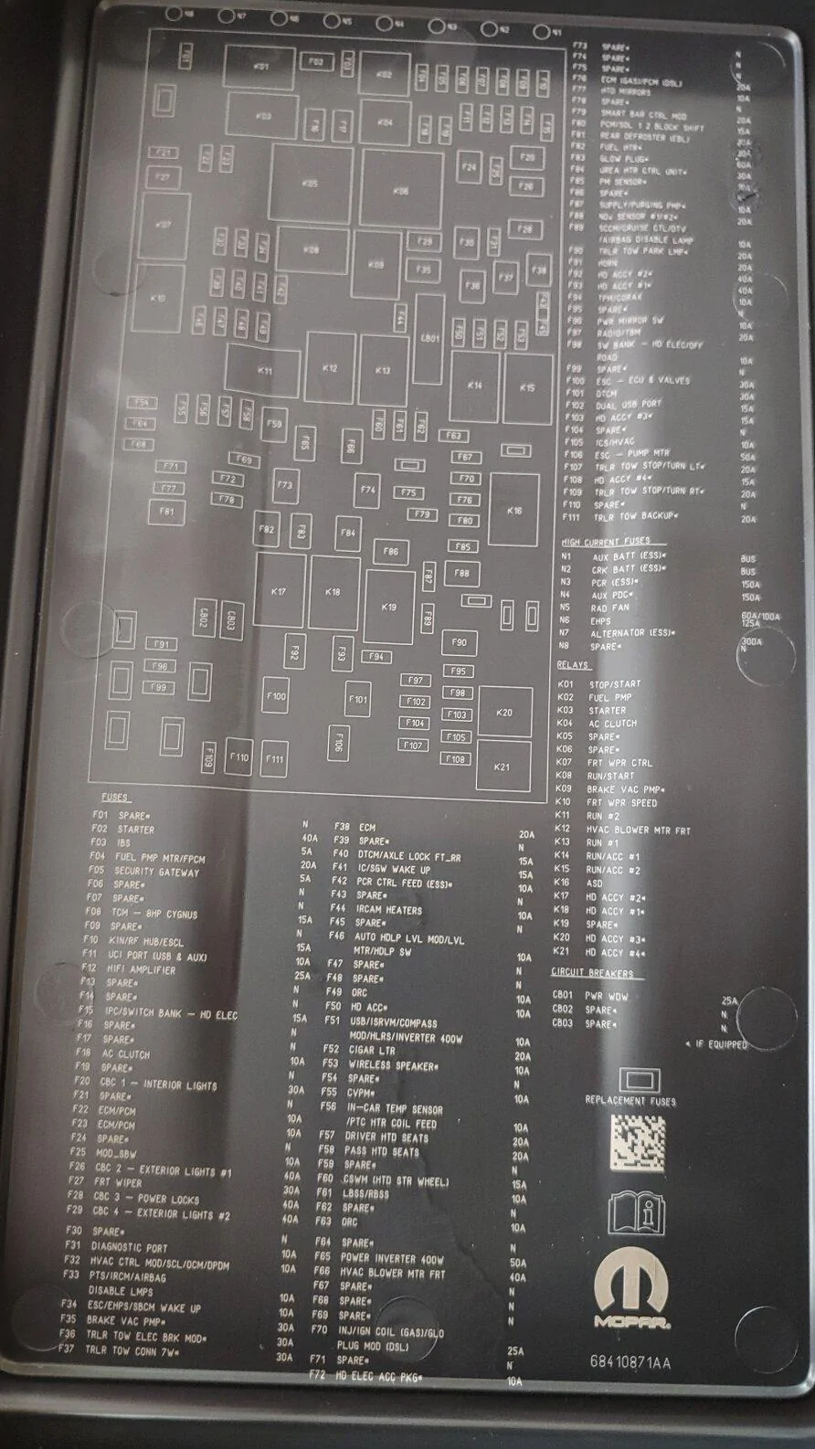

Why bother looking online or at web sites?
Your truck has the purpose of each fuse right on the lid.
You can tell for most of them when they'll be "hot" based on what they are for. Lights for example - live or hot all the time. HVAC blower, for example - ACC.
Does it matter?
Bottom line - you can test a fuse by checking to see that if one side is hot, the other side is hot, too.
You can push the button without holding the brake pedal and that puts the switch in ACC mode and check those fuses that way, and so on - push it twice without pressing the brake pedal and the switch goes into run mode - then you can check those fuses.
Anyway, most fuses you know when there will be power there based on the key in the cover of your fuse box and looking to see what the fuse is for.

I'm adding some accessories that need power for a relay trigger. Adding a piggyback fuse is the easiest method. Some need power when ignition is on and some need power when lights are on.

I'm looking for an empty spot that is powered with the ignition for a dash cam. Got my reading glasses on and am still struggling to read the diagram on the lid.
It'd be great if someone said, "It's F50" or whatever it might be. Lol.

I can't figure this out. Anyone want to suggest which fuse hole would be good for powering a dash cam with the ignition only?
I know very little about electrical stuff, so any help is appreciated.

Do you have the factory installed AUX Switches? If so, there is a switched hot wire in the bundle of six under the glove box.
I do, but I wanted to stay under the hood. I gave up and went inside with it and connected with the aux wired.
