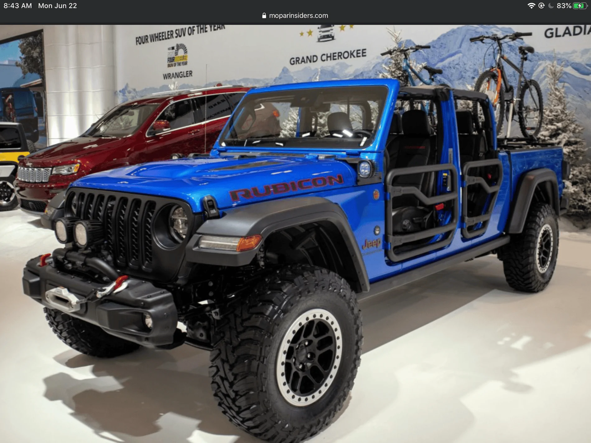

Dang! I kinda like that look. I was gonna go with the Mopar winch guard but now you have me second guessing.
He does have the mopar front bumper correct? The guard is the little tube going above the bumper?

Yah. He has the Mopar bumper. The guard aka bull bar is what I meant.
this is pretty much the build I have in mind. I ordered colour matched top and flares. I’m going with the Mopar wheels as well.

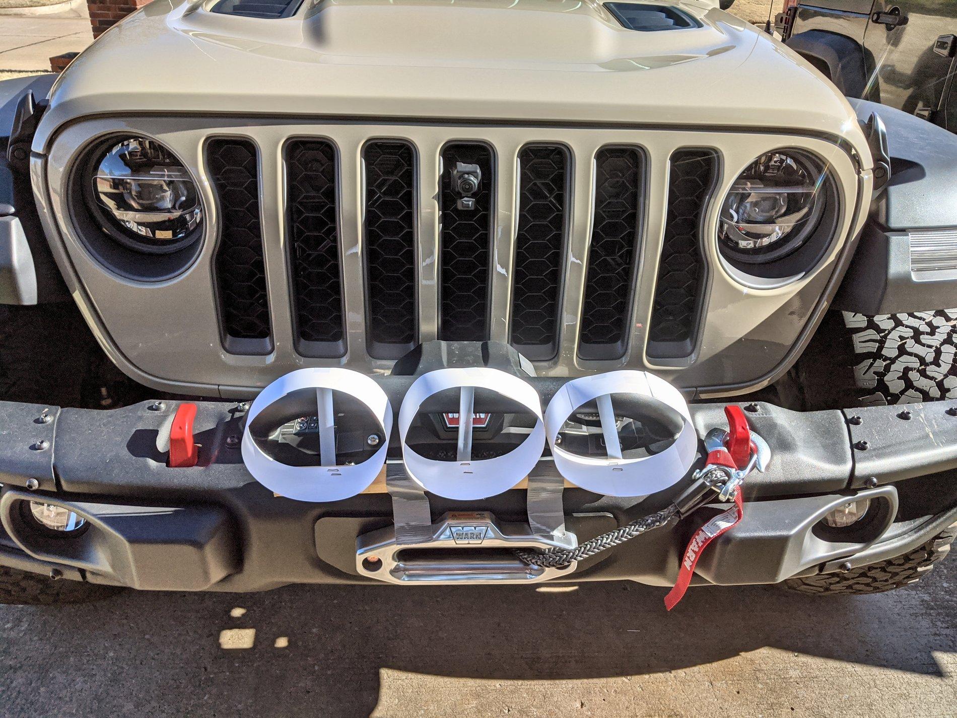

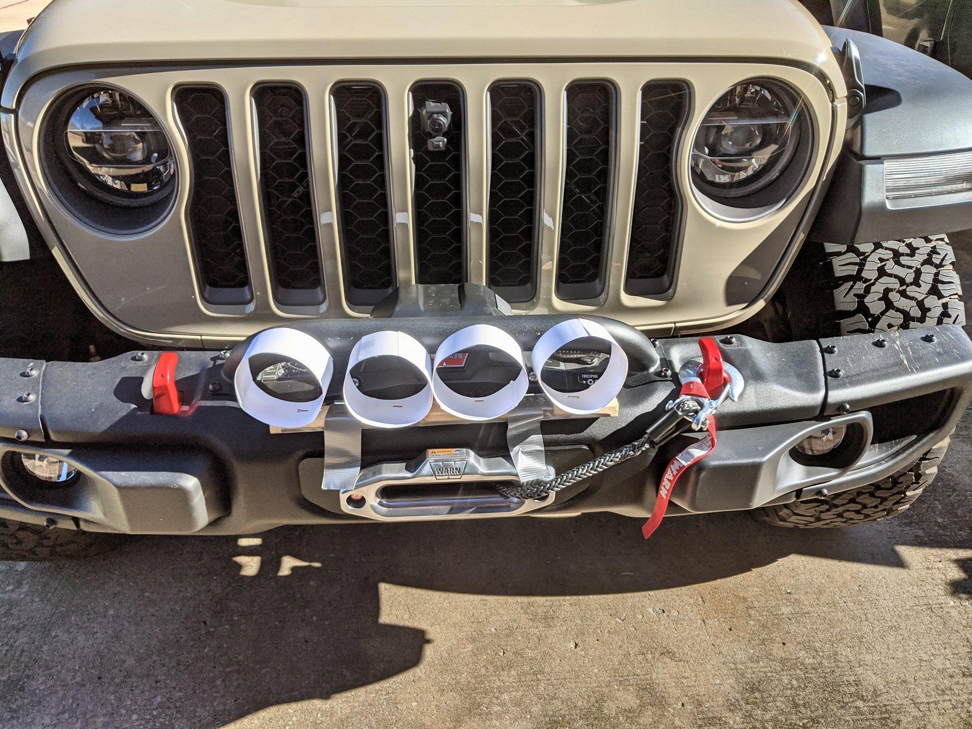

I wonder how two 6” flanked by two 4” would look....

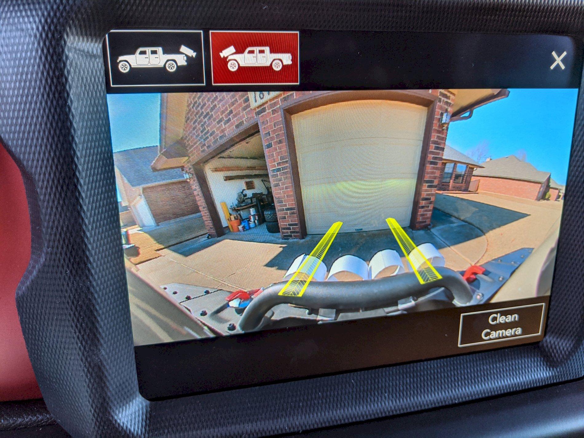

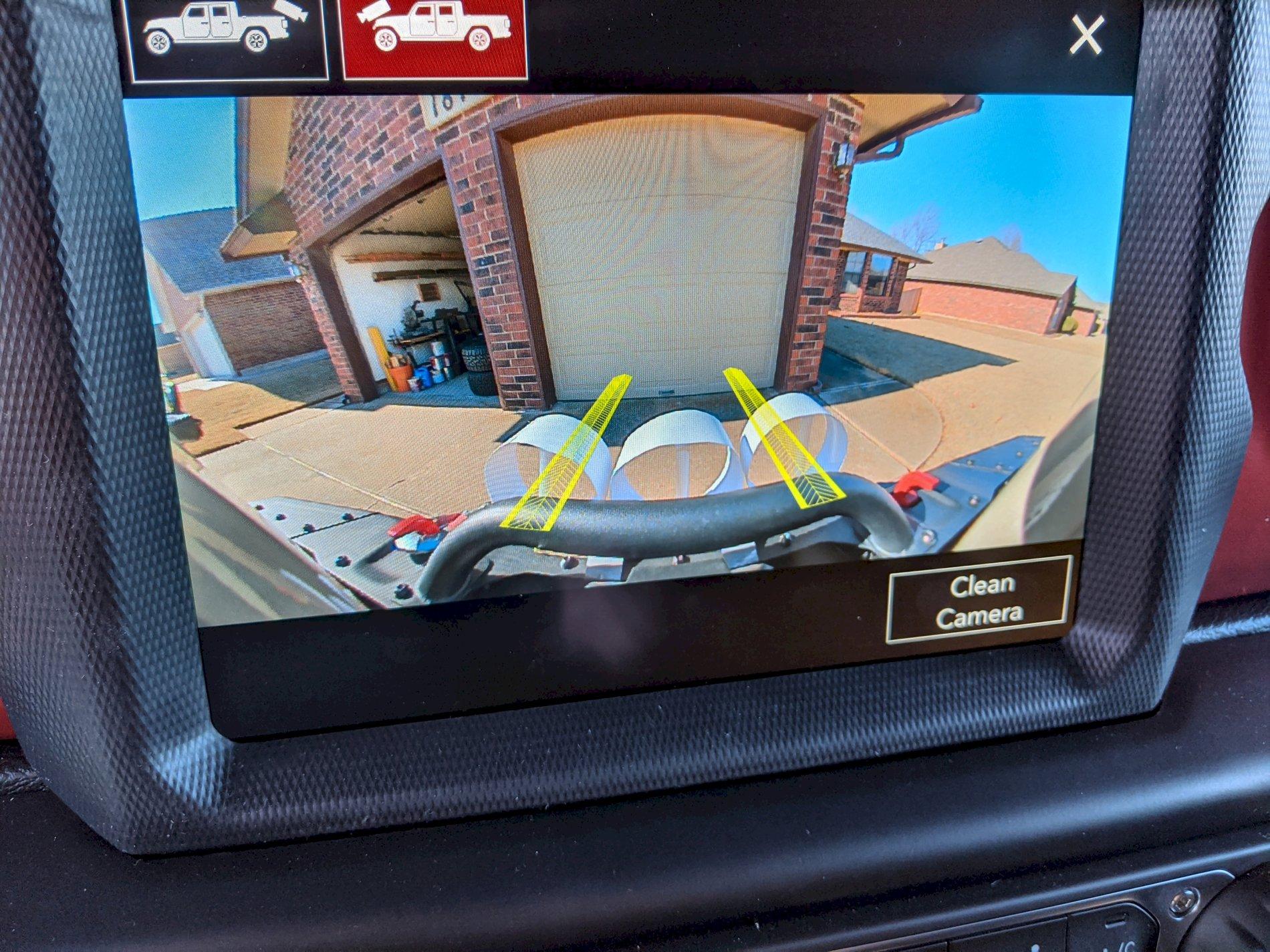

Before I bought all of this I compared four 4" and three 6" with a mockup, mostly to check the effect on the TrailCam view ...
Jeep Gladiator Gator Green really does change color during the day. Gladiator, Jan 20, CP_124322, Three Mock LZR Lites (Front View)
Jeep Gladiator Gator Green really does change color during the day. Gladiator, Jan 20, CP_124354, Three Mock LZR Lites (Trail Cam View)
Jeep Gladiator Gator Green really does change color during the day. Gladiator, Jan 20, CP_122442, Three Mock SlimLites (Front View)
Jeep Gladiator Gator Green really does change color during the day. Gladiator, Jan 20, CP_122630, Three Mock SlimLites (Trail Cam View)

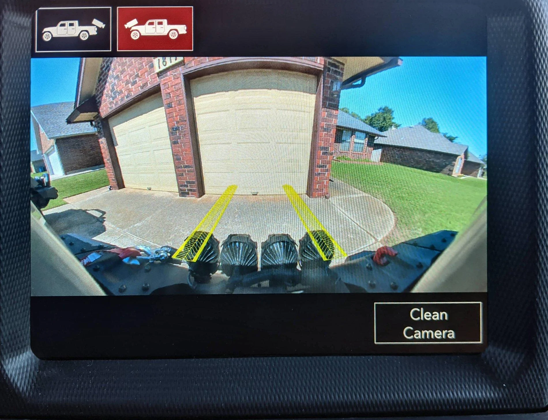

You'll note I had the Mopar winch hoop back then--came with the bumper I bought off of Craig's List. Had to remove that because there wasn't clearance for the lights I selected. To be honest, the 4" look a bit small on the bumper. But I was mostly interested in minimal impact to the trail camera view ...
Jeep Gladiator Gator Green really does change color during the day. Gladiator, Jun 20, CP_105203, Trail Came View
I bet two of each would look pretty sweet. You might do as I did and mock it up and see what you think. I used two existing holes for the outer two lights, which you'd have to give up, but drilling the OEM bumper was pretty easy for the inner two. Access to the mounting hardware with the winch installed was a little tricky, but I have a stubby flexible wrench set that made it barely possible.

Not likely to get the 6” between the 4” if the existing holes are used.

No, it definitely would not fit. I think that's how I described it.
Yeah, "I used two existing holes for the outer two lights, which you'd have to give up, but drilling the OEM bumper was pretty easy for the inner two."
