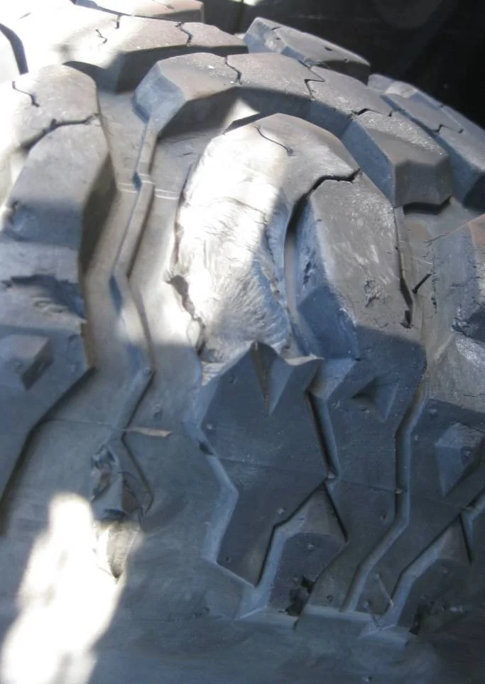

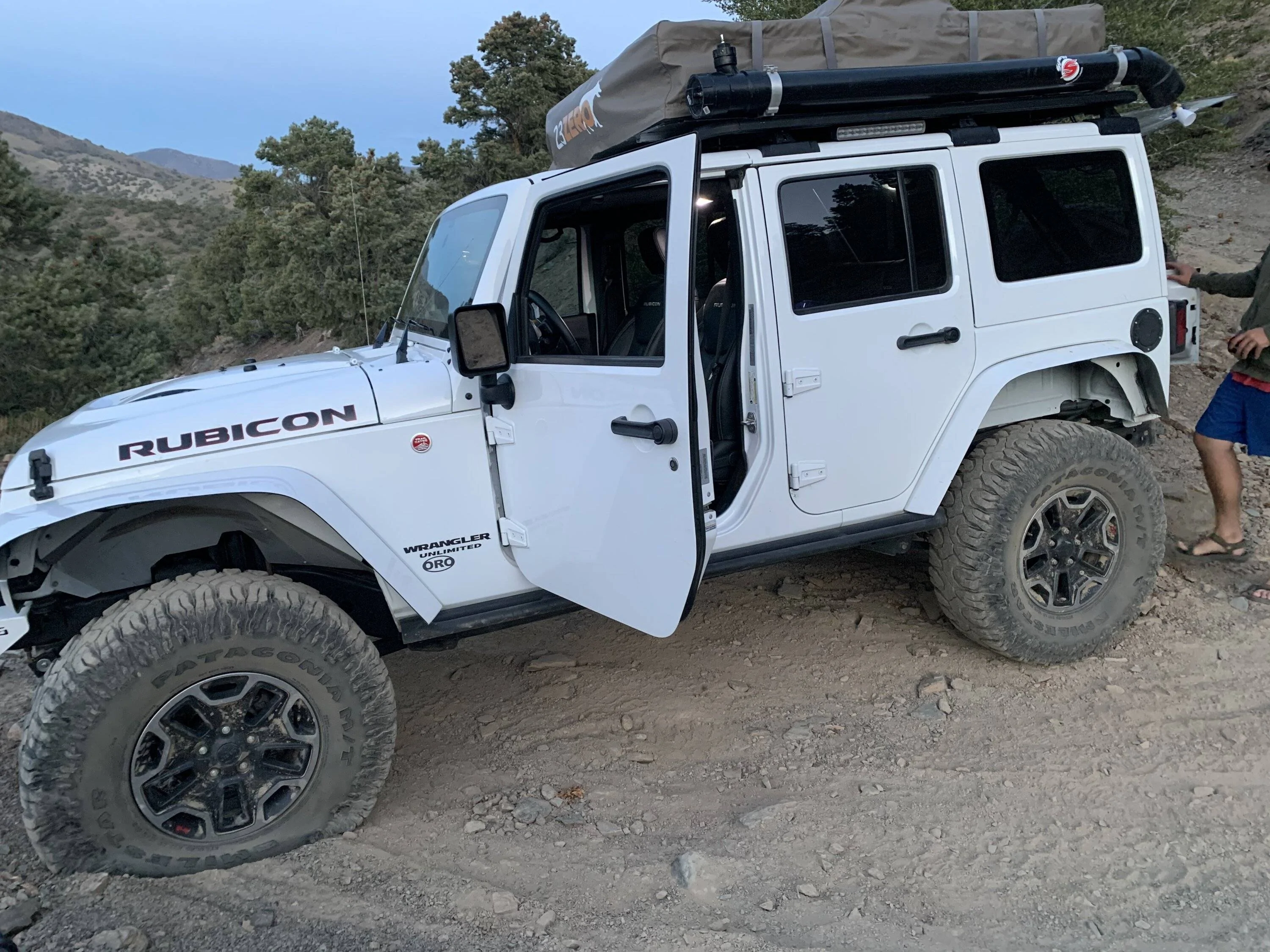

They get holes…
This was on a dirt road going up to papoose flats (east of independence/big pine California) maybe baling wire, a 9” patch?, or a tube could have gotten us back down to hwy 395??
Just going camping- dirt road, really sharp rock- just right. Swear this areas cursed- camped 3 times all three trips scored a flat. ? (different roads, different parts of the flats… ) photo is of the first trip- which we show horned the spare in the back…. Wife green lighted the poison spyder carrier after having to unpack everything to get to the tire…. ???

They get holes…

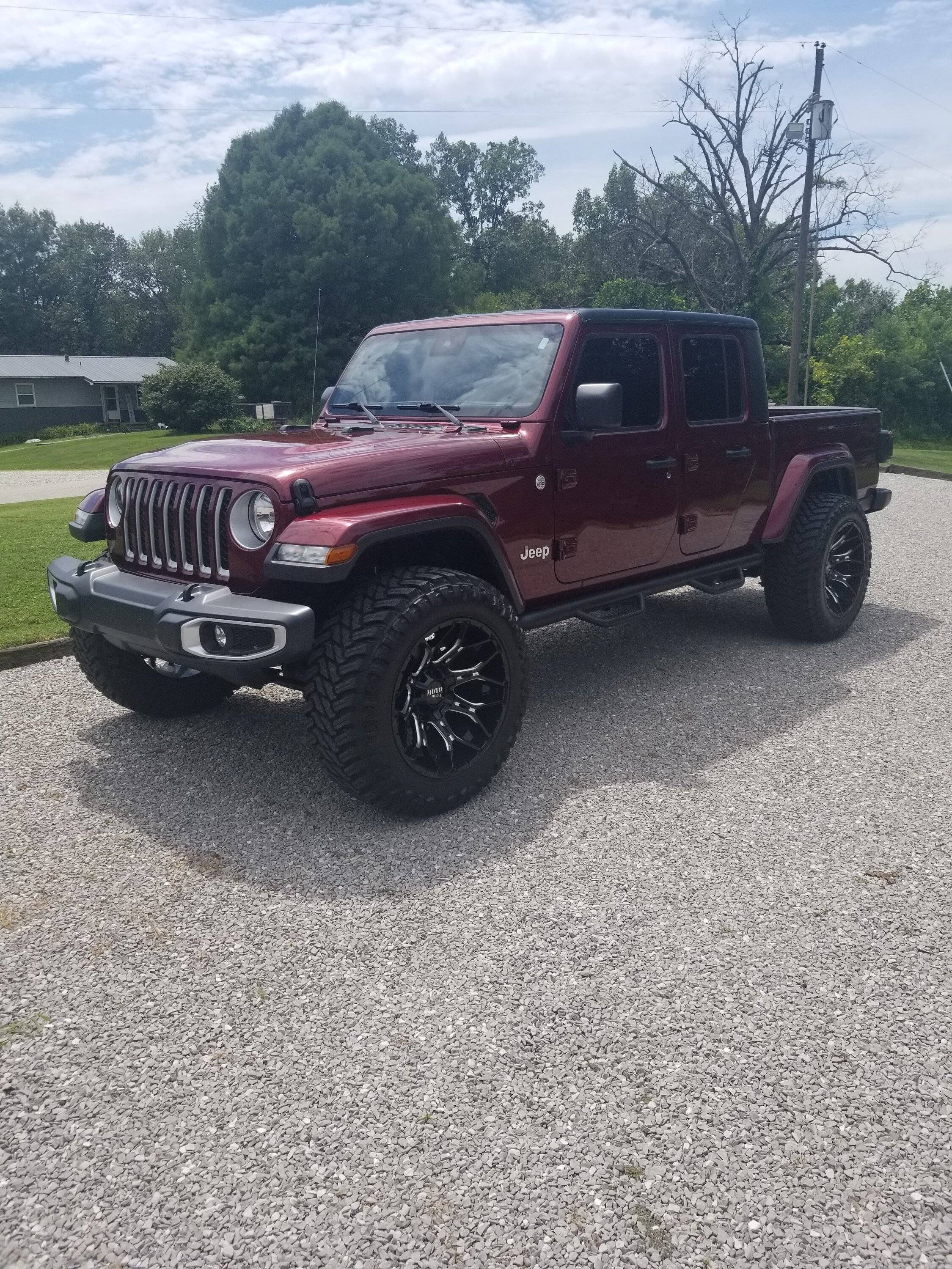

Similar question to what Guntrust's question was-
I used a hydraulic jack to raise the rear end of my 'new to me' 2021 Overland with 37's. I turned the passenger rear tire and the driver side turned in the opposite direction. If what I've read is correct, I do not have a limited slip differential. With that said, can I use a 35" as my spare and use it on the front or rear if needed to putt home? I'm reading that it may need to go on the front even if I have a flat on the rear. In that scenario, it seems like it would be very difficult to try and change the tires around on the side of the road. For example, remove flat in rear and somehow remove the front tire and put it where the flat was and put the spare on the front.
Just trying to determine if I could actually put the 35" spare on the rear to limp home.
Thanks in advance for taking the time to reply an certainly appreciate your help.
My take is, If you're in a jam...you do what you gotta do. Just remember...that spare is a temporary fix. Treat it as such and make the proper repairs as quickly as possible. Don't wait.
I've seen quite a bit of damage done because someone decided to blow off the repair for extended periods. Nice rig BTW!
