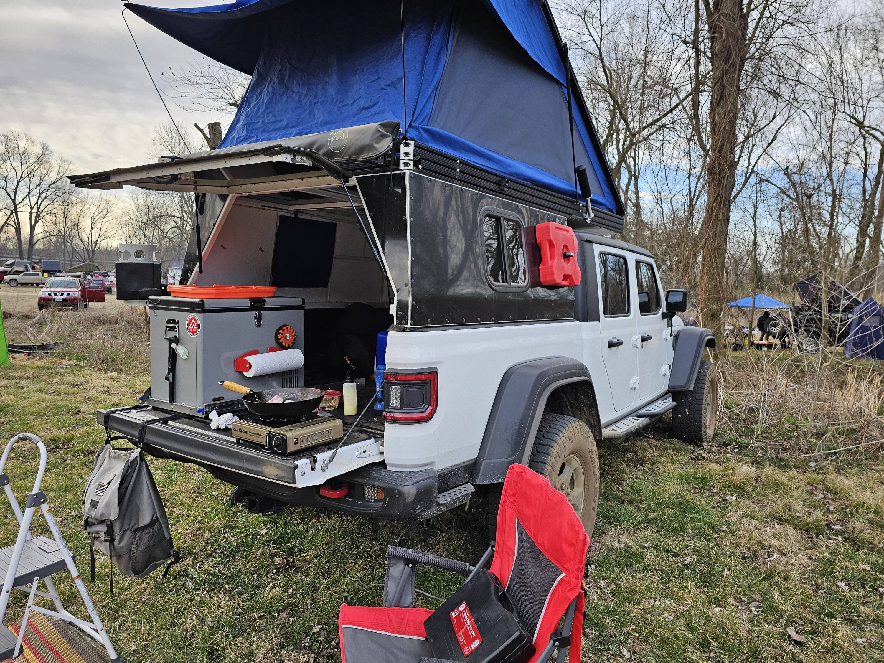

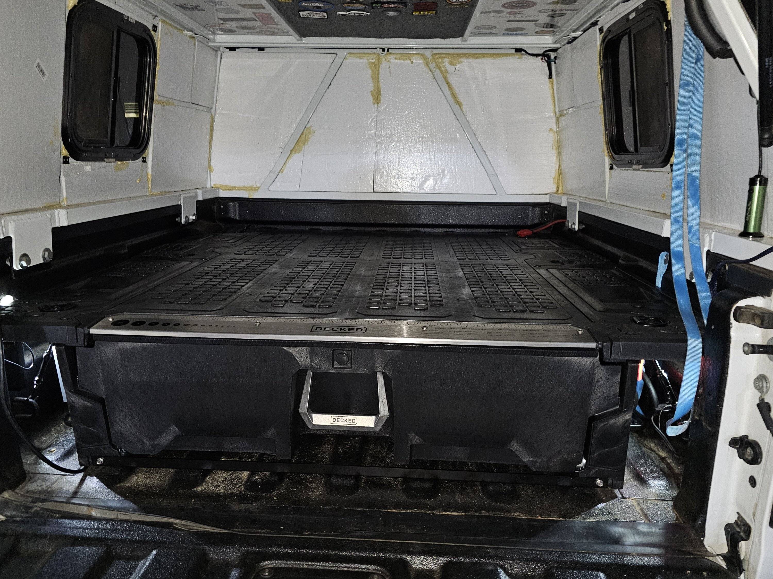

Been planning and piecing together the stuff needed for a solar system install and now comes the fun part of finally getting to put it all together.
A bit about my rig. I have a home made (friend built) camper/RTT with a Decked drawer system. I currently have a Genesys dual battery system running AGMs but since I like to run my fridge 24/7, I noticed that during some of the hot days my aux battery would struggle to keep up, hence the solar array.
I have used the flat, flexible solar panels on previous rigs but noticed a decent drop off in performance when it gets hot and that is when I need my power to be as high as possible, so I am going with 2, 100 watt Renogy hard panels. This will allow some space underneath to help with cooling a bit. I will be using a Renogy controller as well.
Plan is to run the panel cabling down into the camper bed, connect to the controller and then connect the output to remote power distribution block that I already have installed in the bed connected to the Genesys system via 4 gauge wire. Will be connecting my diesel heater, tent lights, fridge and air compressor to the distribution block to power everything.
Hopefully will be able to start on it this weekend barring any "honey-do's".
Pics below to show my current set up. Camping pic is before I installed the decked drawers.

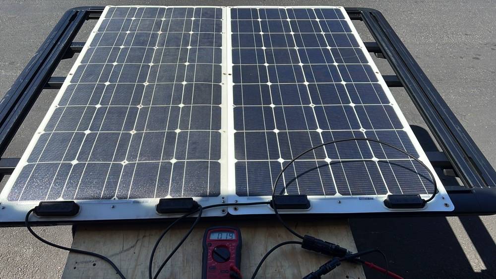

Have you consider just using a roof rack? I didn't want the weight on my RTT making it heavier to manipulate and making the overall height taller.
Jeep Gladiator Getting ready to start the install on a solar system on top of my hard top RTT. 14_NewSolarPlatform_4
Since you aren't talking about a lot of weight, it would be safe to just use a rain gutter mounted roof rack.
I started with that but ultimately went to a RhinoRack BackBone when I installed my CoverKing Topliner.
Jeep Gladiator Getting ready to start the install on a solar system on top of my hard top RTT. 14_NewSolarPlatform_6

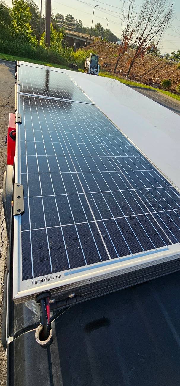

Solar panels installed, went back and forth over a few different configurations but decided to run them both on the passenger side to make running the wires a bit easier. Output is strong and pretty much keeps my alternator from having to do much work at all.
Am still doing some wiring for my diesel heater and water pump system so haven't put the fridge back in but I anticipate they should help extend my off-grid stays by quite a bit.
