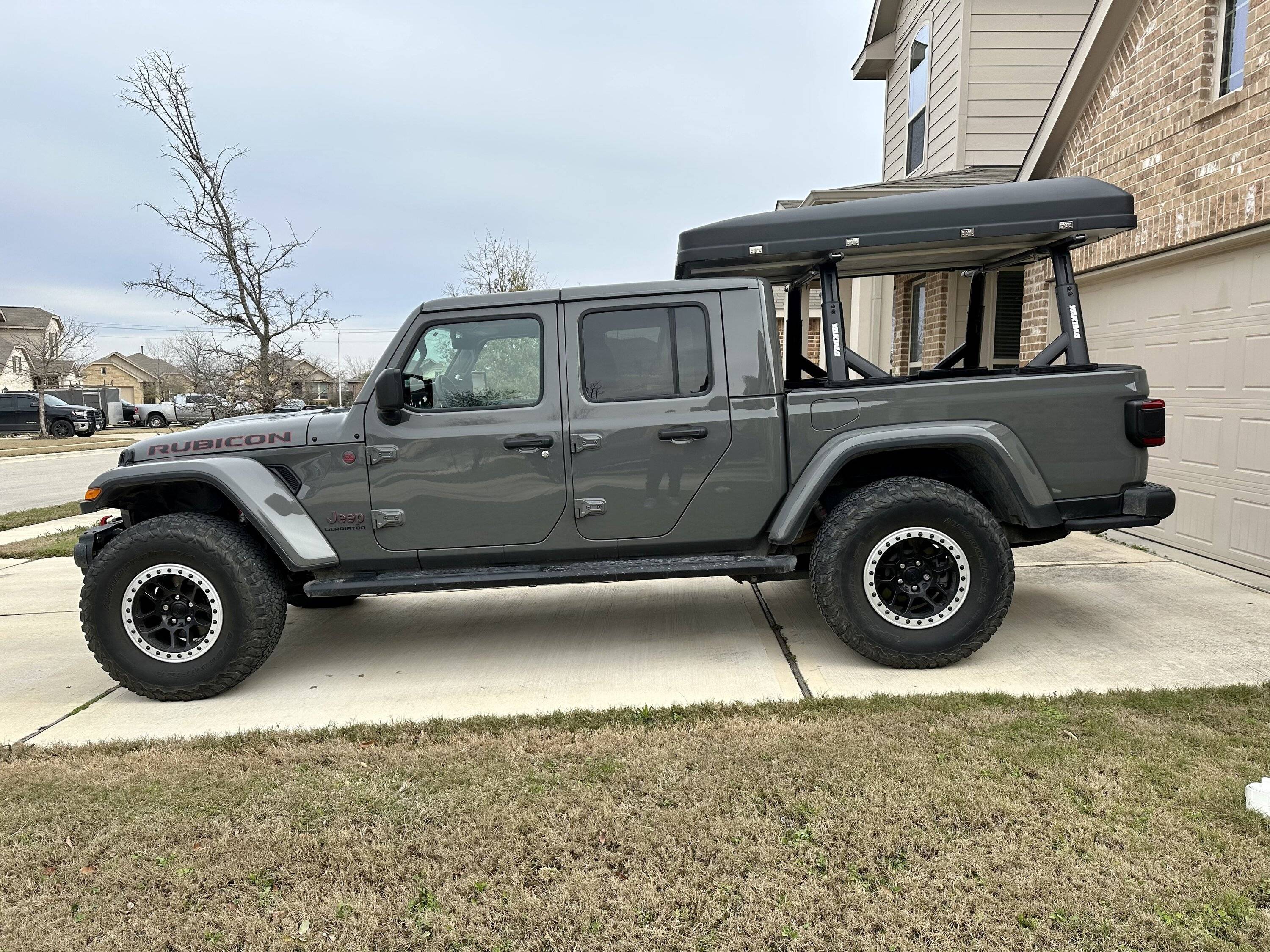

I have a full size ikamper 2.0 on my truck that extends over the cab so my truck doesn't fit in my garage. I've been searching for a hoist system that can go up high enough safely, where I can use it to install and remove 165 lbs tent by myself but having no luck so far. So, I would like to ask anyone that is in the same shoes as me... how do you guys solve this issue without having a friend or two helpers? Thanks in advance

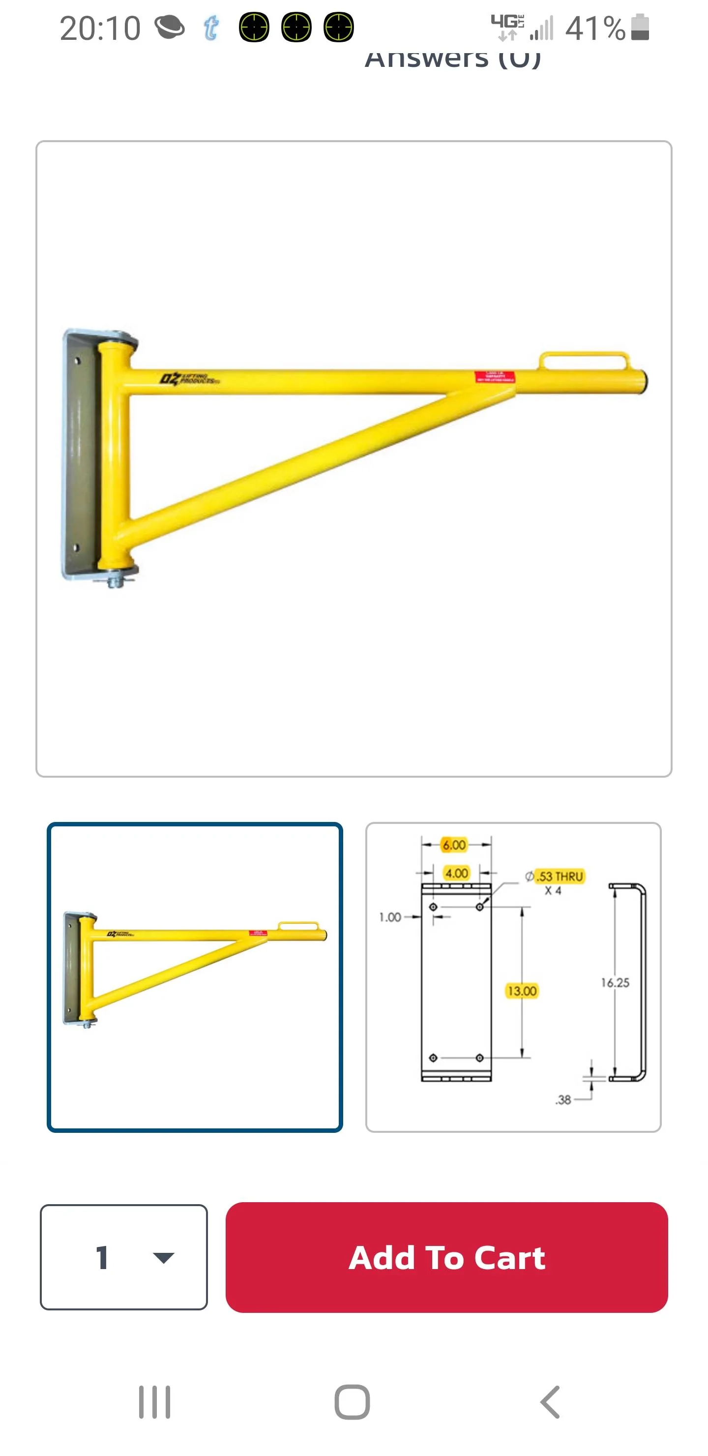

Just above that garage door is a header. You can drill two holes and install two bolts. Attach your home made "L" bracket with a hoist. When finished, remove the bracket and reinstall the bolts painted to match the brick.
Wall hoist, the bracket has 4 mount holes but you can drill 2 in the center to make it easier to install. You are kind of limited where you are in the driveway.
