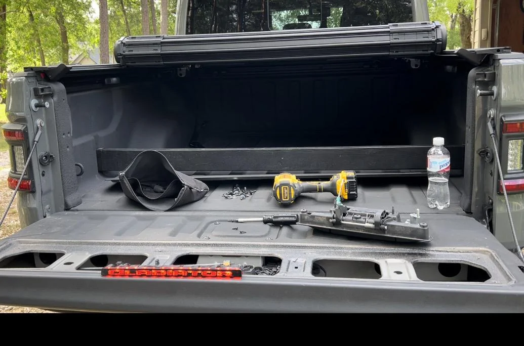

I appreciated your video very much. Just finished replacing mine at 5,248 miles. Your video was very helpful. Thanks

I had my 3rd taillight replaced under warranty last month... And boom thr new one is already SOL. anyone have this issue? I have another appointment on Tuesday. I took the tailgate panel off and wiggled the connector and nothing. Put the multimeter to the plug and I was getting voltage... So it's telling me the light is shot

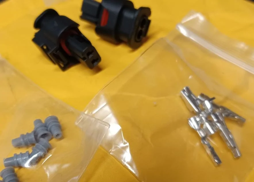

So I pulled everything apart to see what I needed to do. Checked light with 12 battery it worked. Moved to the connector wiring, powered. Plugged light in tested no light. Disconnected fiddled with it tried again no luck. Disconnected and bent pins together in plug with needle tested again worked.
