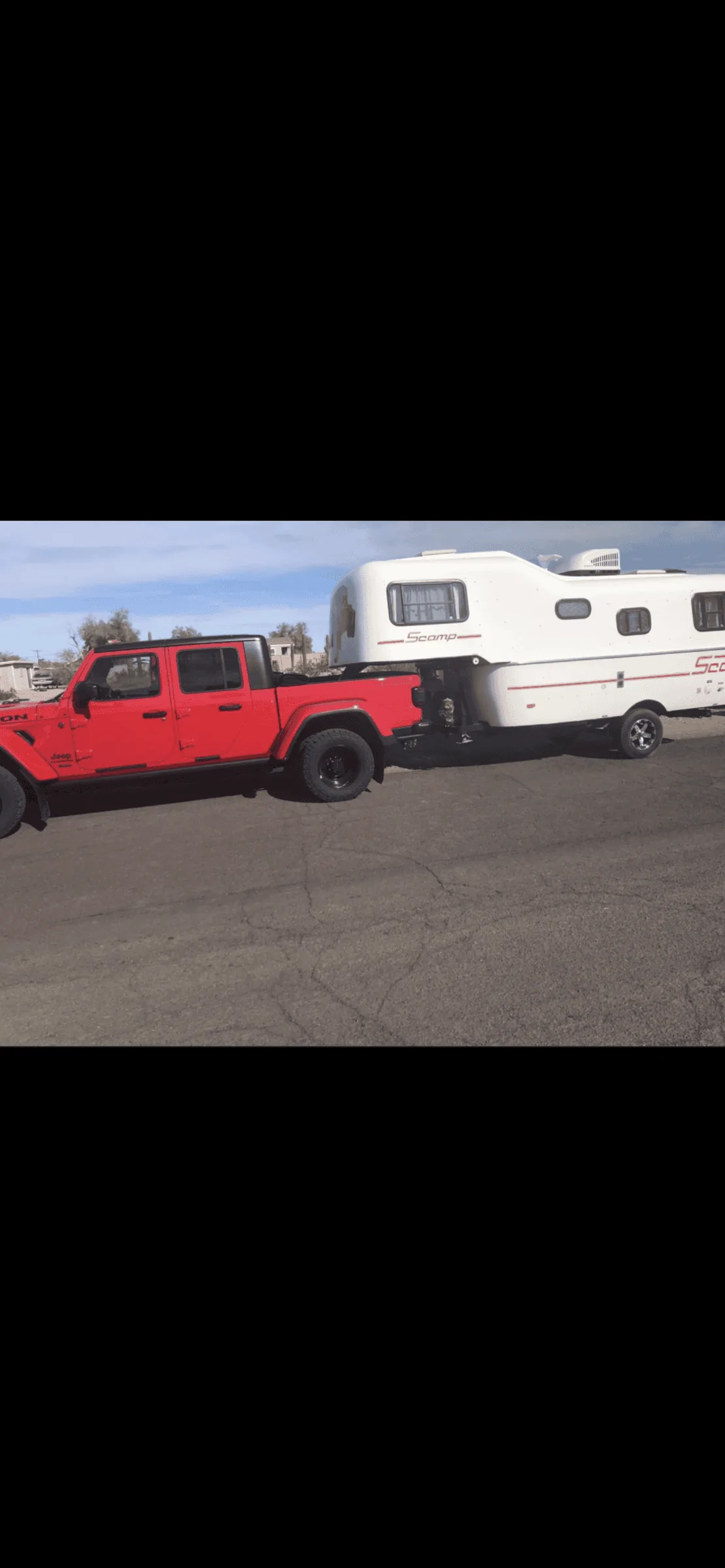

Ok guys so someone did it already, i found it on one of the scamp fb groups. I asked about his set up and this was his reply “I have the removable one with the plates that stay in the truck. Mounted with 12 bolts through bed and attached to frame in 4 corners”. I asked for pictures but got no reply...
