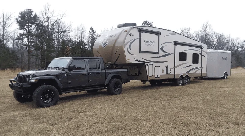

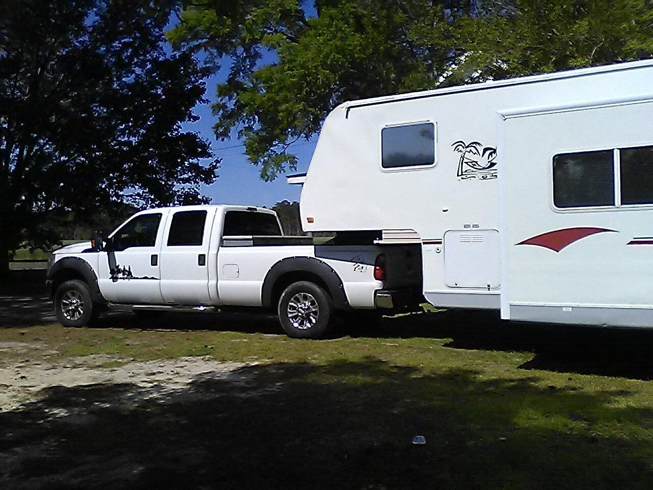

yes over the axle or the pin is a few inches behind axle . you must use slider hitch to back the the RV . im going to use inbed 5th wheel rails with L brackets bolted thou the frame . this is the wifes truck i have it just as a back up for my tow vehicle . the gladiator mirror are way to small to tow with , this is what i normal tow with
Esh… I just figured with how far forward the rear axle sits, and how short the bed is, that once slid forward you really cut down on your box front to cab clearance for turning….. kind of negates the purpose.

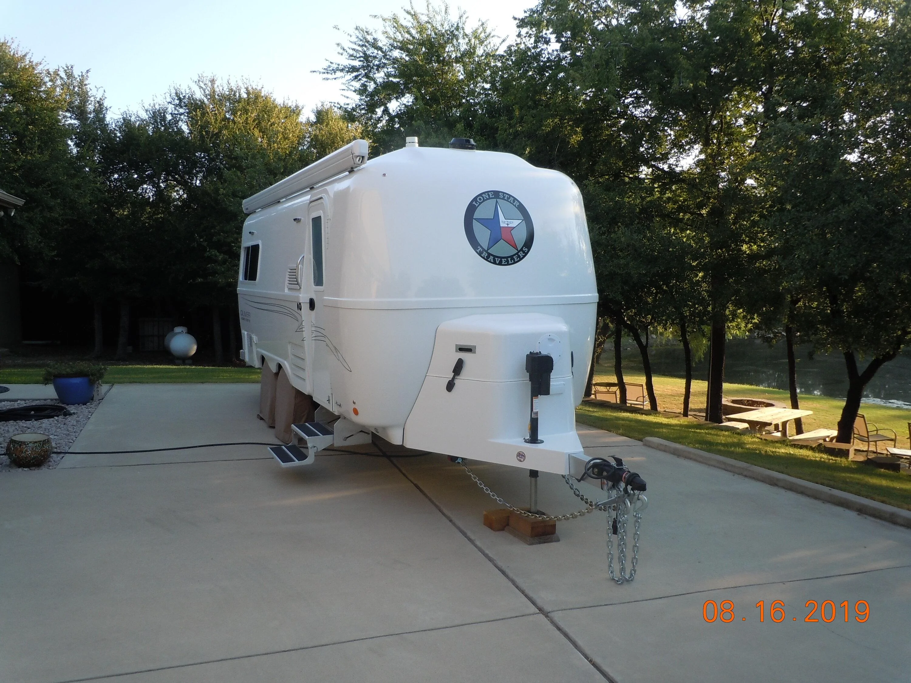

I've spent the last two months looking into pulling an Oliver travel trailer, weight around 4800 lbs. and a tongue weight of 500 lbs. Those are empty weights so adding more weight is a given. After watching many YouTube reviews on towing with a Gladiator I have decided it would be a big mistake with the V6 gas engine, but with the 3.0 diesel it would do a good job. All being said if you did go with the V6 be ready to be running your gas engine around 4000 RPM just to keep pulling, a lot of engine noise, and the trans shifting up and down through the gears a lot. I think you will be very unhappy with the results of the V6.

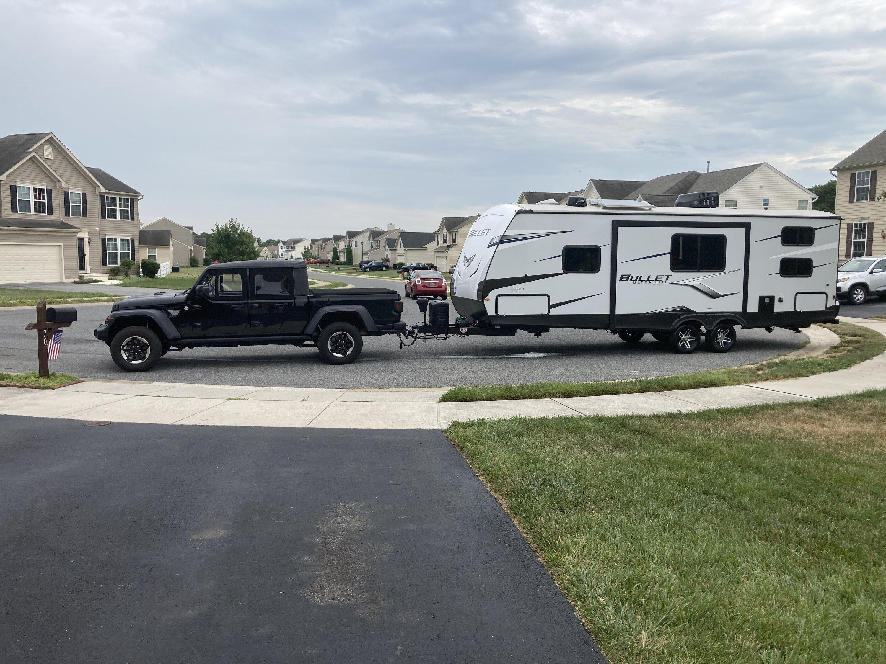

Meh…5,600lbs dry with a hitch weight of 715lbs. Just pulled through the Appalachians to a KOA in central PA.
The ONLY place that was a slow down was a steep grade climb where Even the tractor trailers slow down. I ended up doing about 25- 30 mph in 2nd and 3rd gear, 2nd just at the top of the grade. Aside from that one spot though I was able to maintain highway speeds and stay in sixth gear, and even sometimes seventh, the entire trip. The engine is definitely NOT screaming the entire trip. Uphills is down shifts a bit then goes back to normal.
i gor 11-12mpg most of the trip. And 9-10 on the last leg with the mountains.
2020 JTMT 3.6 engine
i was VERY nervous about the heavier camper, and found that the web is just full of naysayers and party poopers. If the numbers add up id trust the truck. The only caveat is consider where you live. Im mostly at or near sea level and only tow through the mountains occasionally.

I’m pretty sure I saw someone on this forum, maybe in the what are you towing thread, that was pulling the fifth wheel scamp. Not sure if that’s the same as what the OP he’s talking about or not though.
DesertGladiator
Derek
Aug 16, 2021
118
244
Mesa,AZ
2021 Gladiator Mojave
If you search "2 Girls Garage Jeep 5th Wheel" they did an episode where they made it happen. Beds gotta come off obviously, I believe someone makes a kit.
