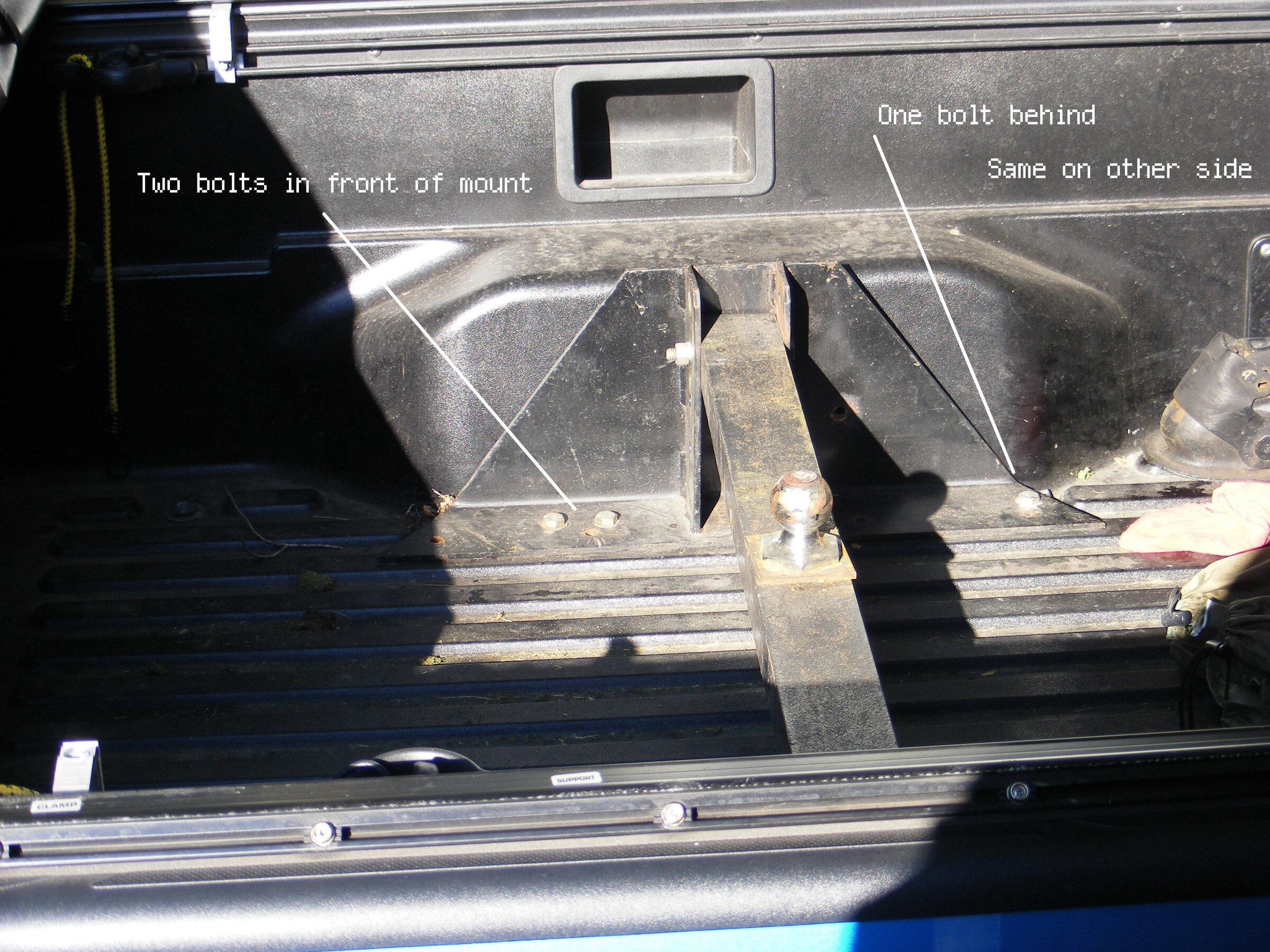

I'm pushing for an Opus and she's looking for both, so it's cool! I'd like to see how you mount the hitch in the bed - are you going with a removeable type, I hope?

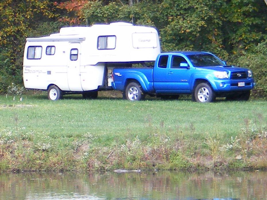

I have a 21 Gladiator Overland V6 3.6 with tow package that im wanting to use to tow a Scamp 19 "5th wheel" fiberglass trailer. Has anyone done this yet? Im thinking of installing curt #16200 universal rails and curt #16055 bent plate with ball in it. Trailer weights under 2900 lbs and has a hitch/tongue weight about 400lbs or so. I see Tacomas and frontiers to them all the time so I figured why not a gladiator.

I had a Scamp 19 Deluxe which is what your photo is showing. The deluxe model, Identified by the gold graphics, has wood interior and weighs a little over 3000#. Mine had closer to 500 # tongue which takes a bit of the load rating of the truck. The weights from the manufacture are as bare (no AC or other options). If your truck is lifted or your off-roading you can lift the camper some too. The JT will pull it. I was pulling mine with that Tacoma 4.0L, the leaf springs were too soft and needed suma-springs to help.
Scamps are not 5th wheel trailers, they are modified goosenecks using a 2" ball on an elevated post or frame. The standard model without wood paneling is much lighter.
