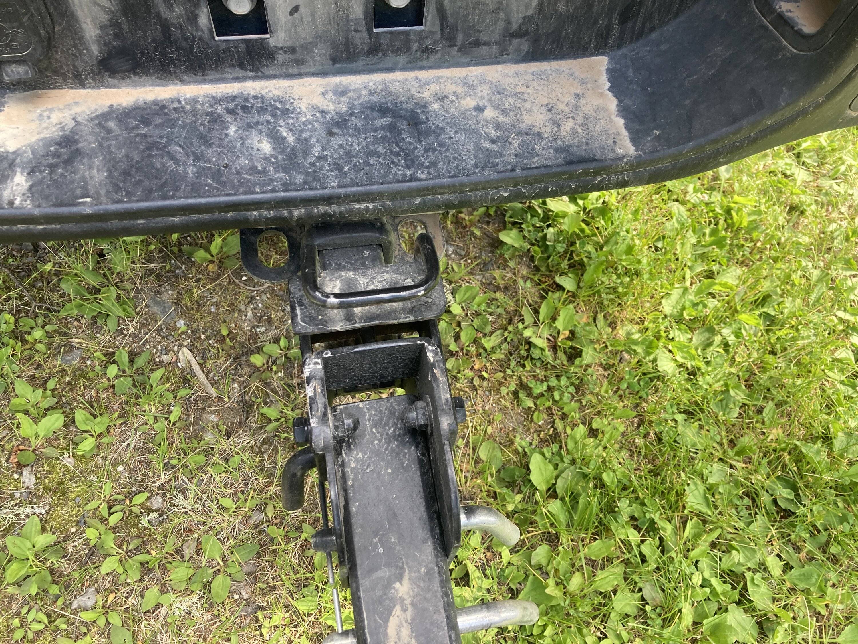

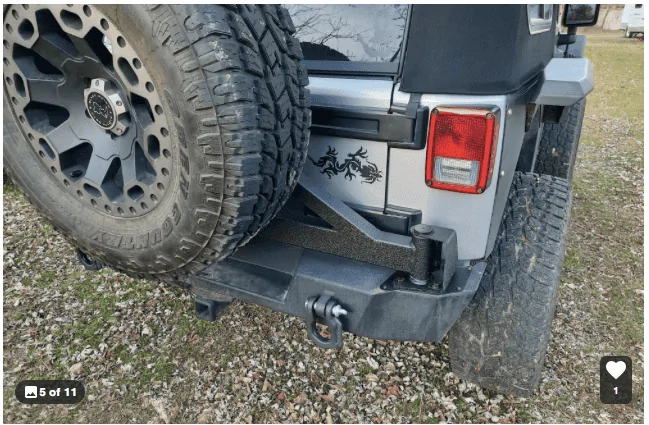

@Redruby, you've got me thinking about doing something similar. Do you think the Rubicon's steel bumper is strong enough to mount this swing spare tire? I looked at my stock bumper and it looks like it is 10 gage or about 1/8" think. I don't think that would be enough to hold the swing out arm without bending. This Barricade spare holder is $400 and looks like it can be mounted to any flat, strong surface, with some holes/bolts added.

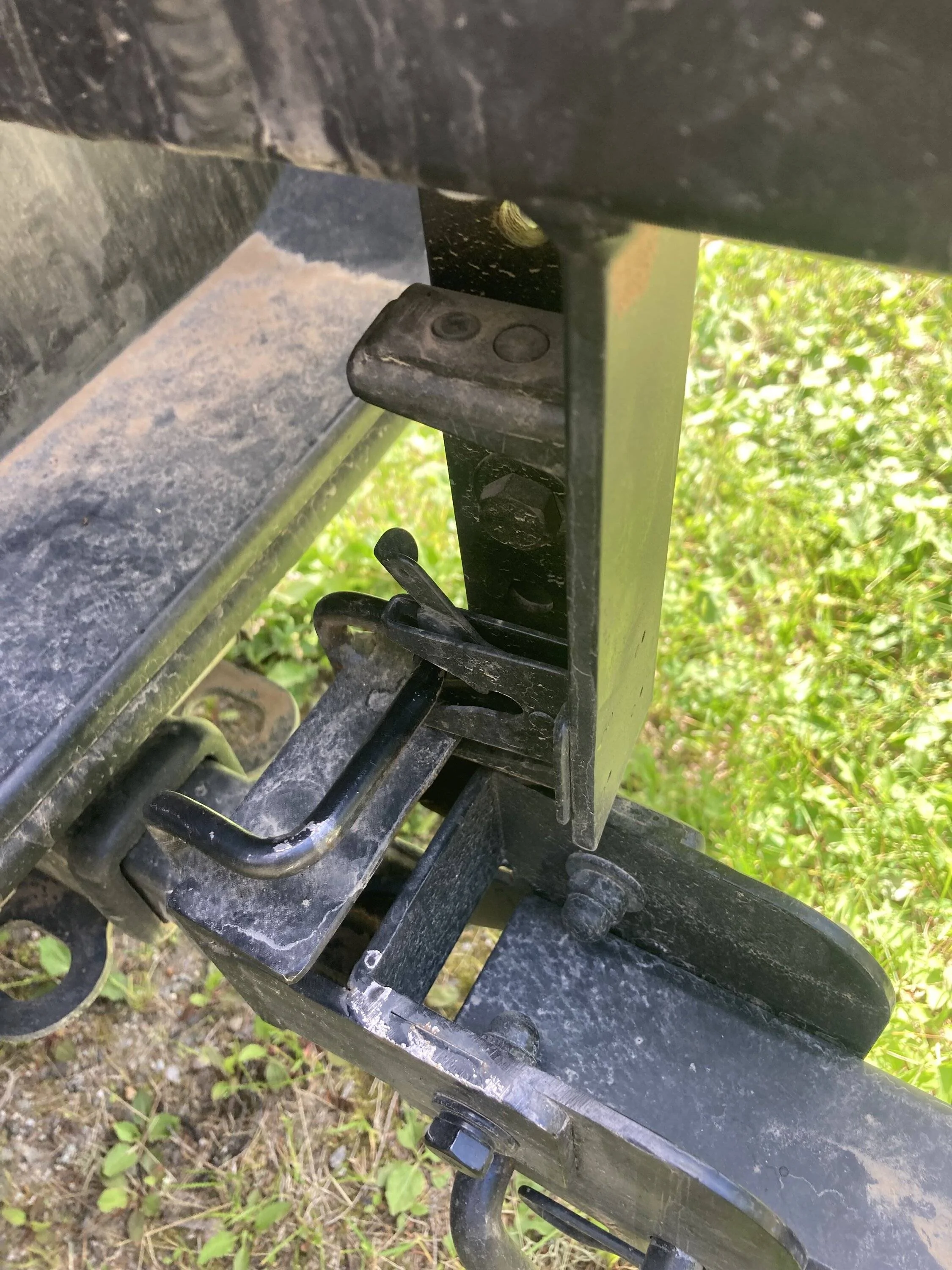

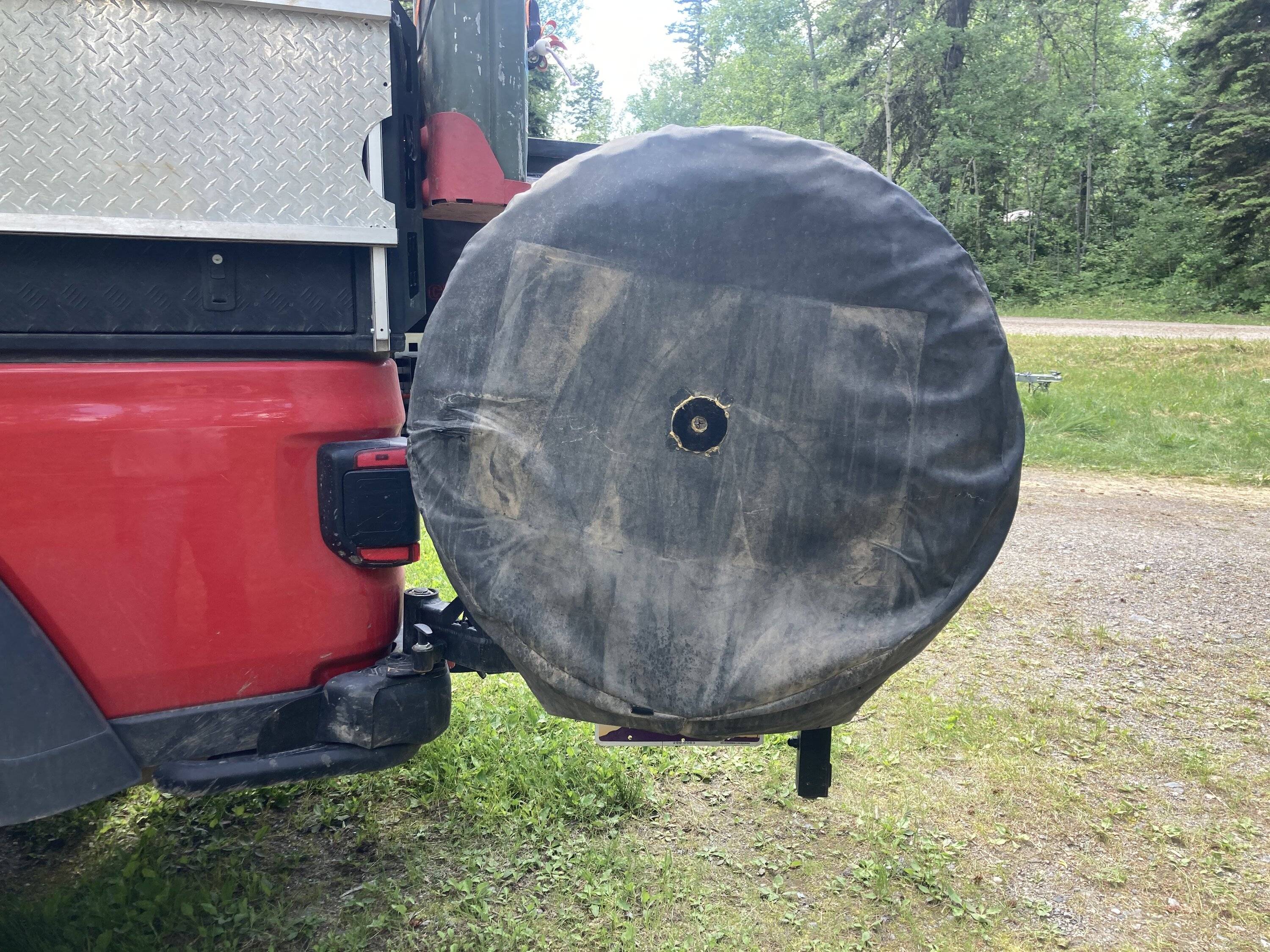

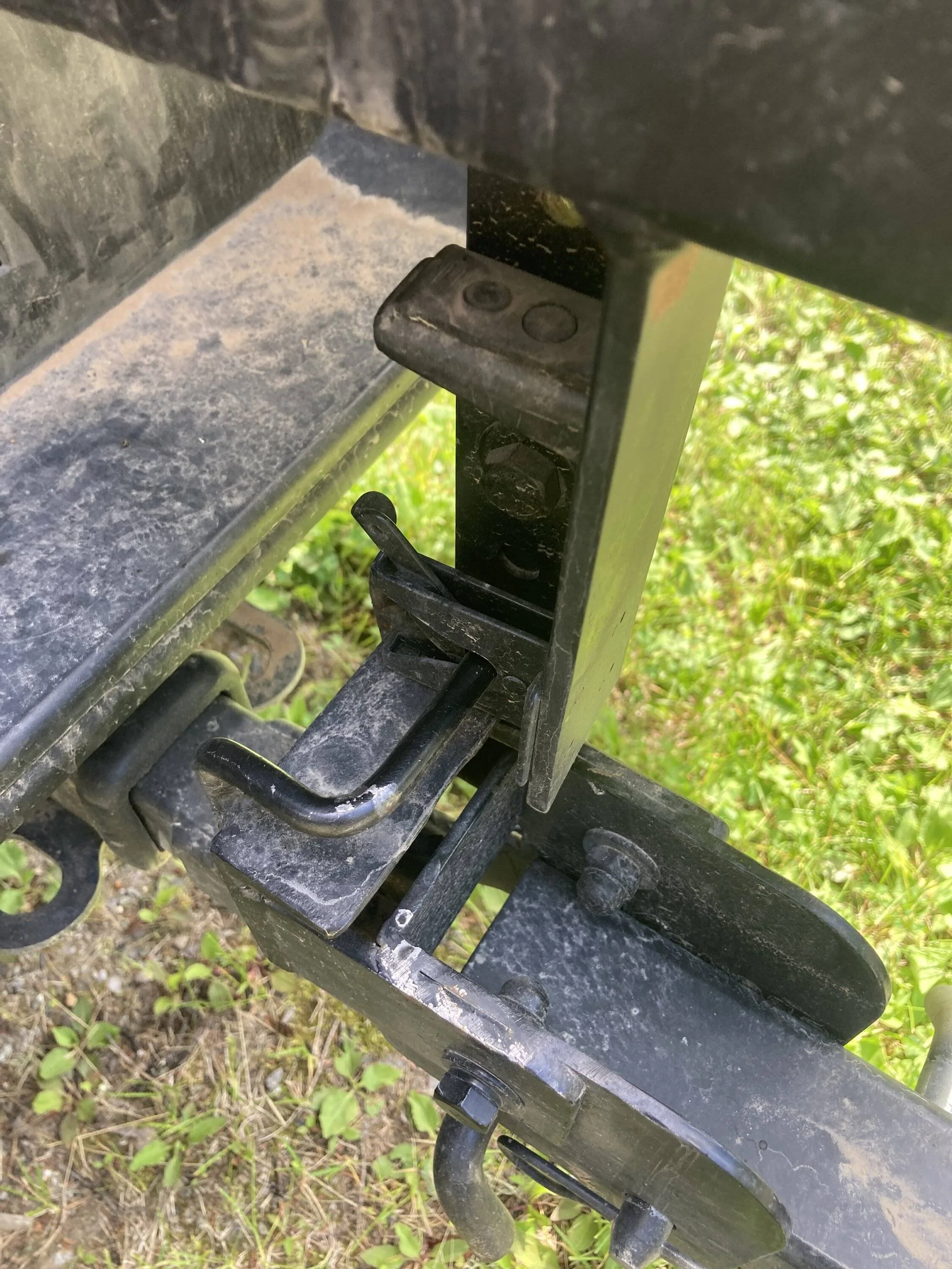

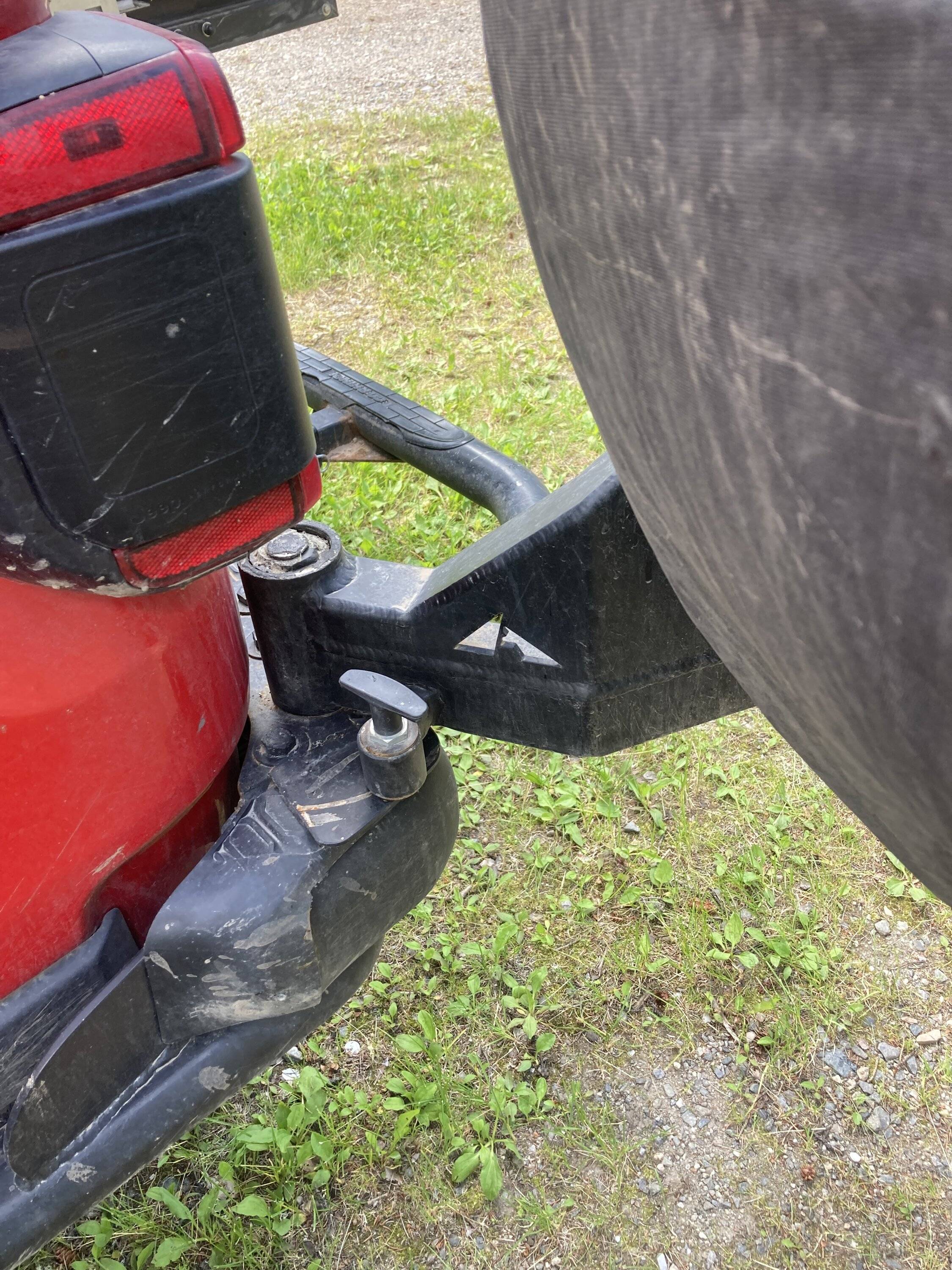

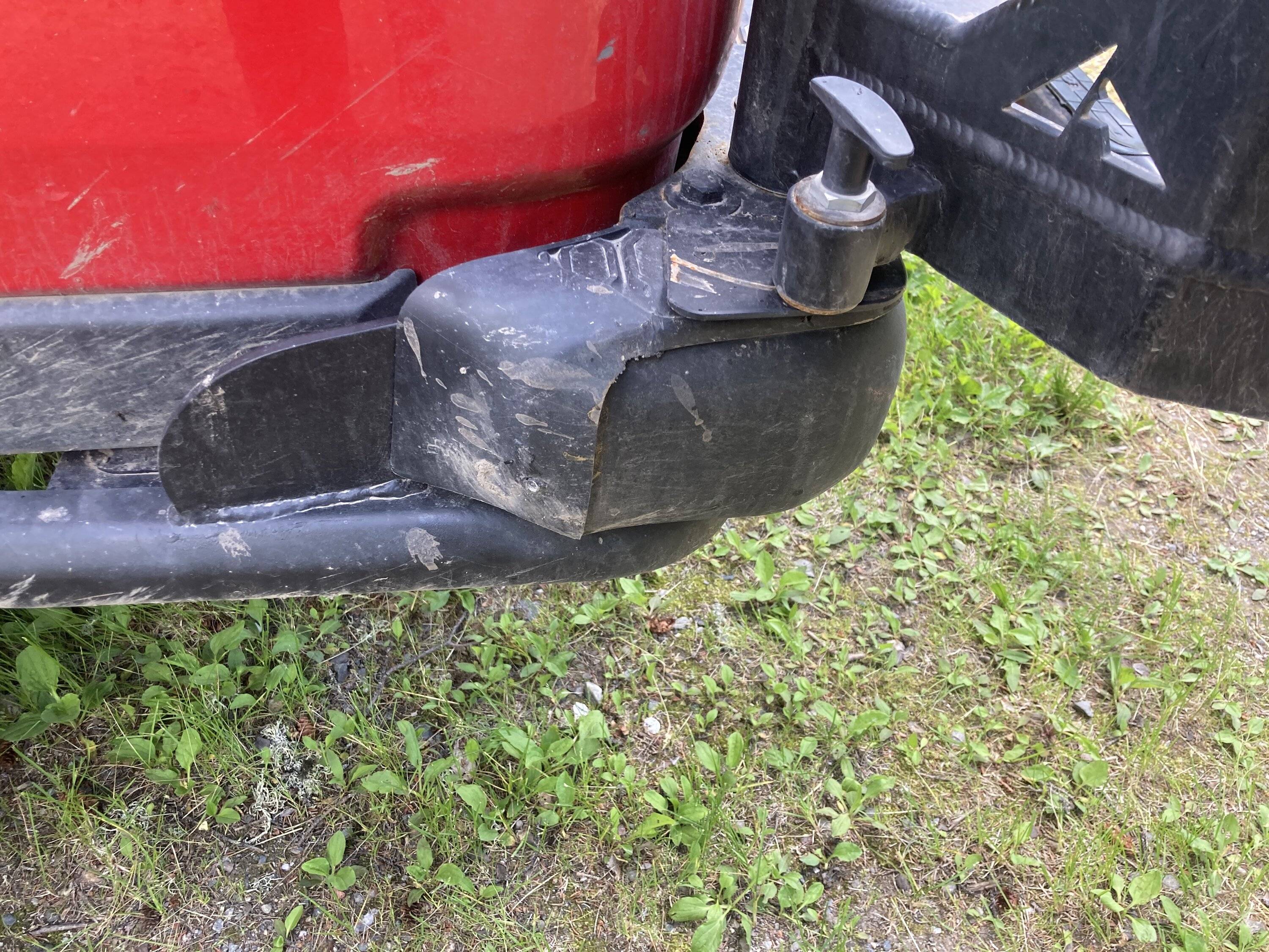

Mike I drilled the bumper then attached another steel plate then attached the swing away arms and bolted it all together. Did have some sway when opened so I welded some plates on the end of the bumpers see attached photo and I also made a latch that’s bolted to the door and comes down to grab the tire carrier and hold it snug against the rear door
So you went belt and suspenders! I like it.

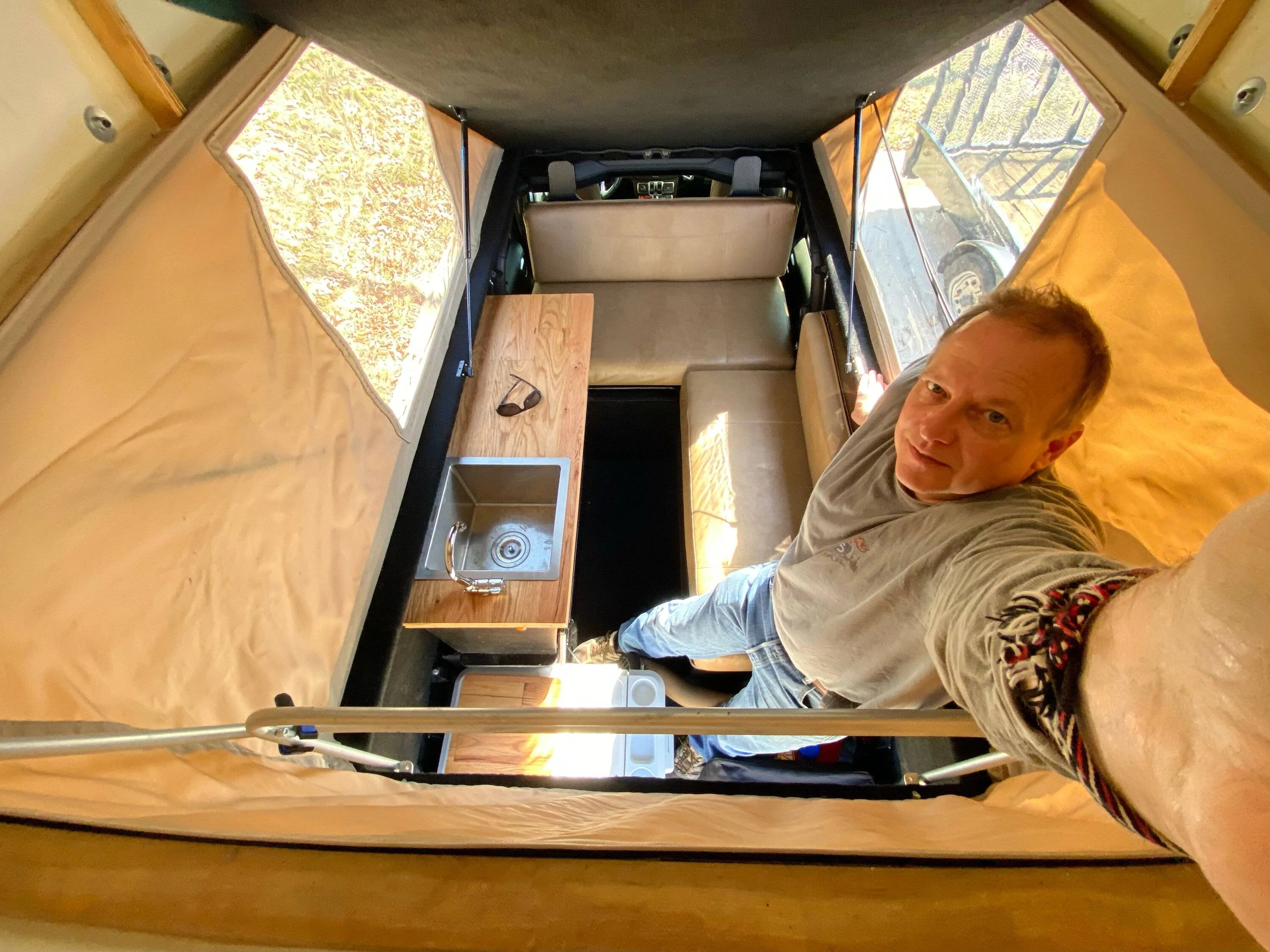

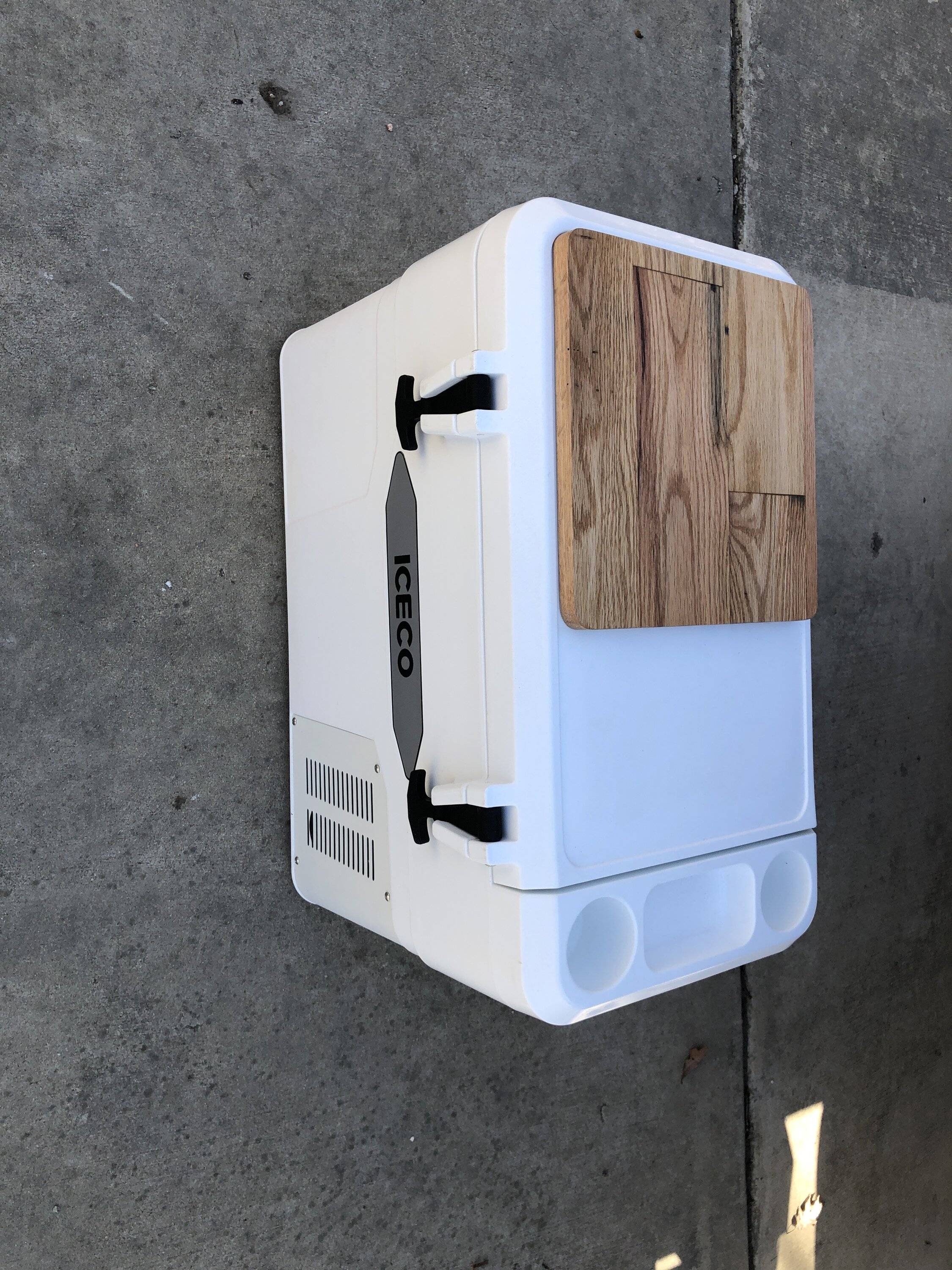

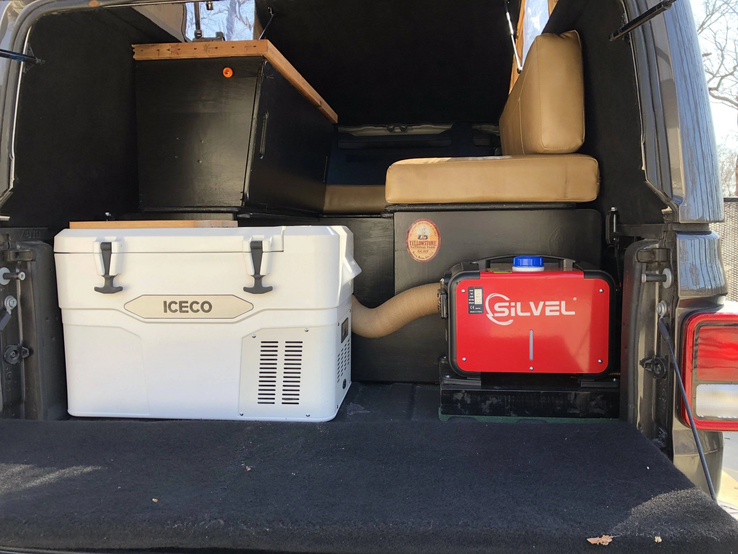

I took this nice day to blow some of the winter cob webs out of my rig and get ready for some camping. I made a small cutting board from the sink counter top cutout.

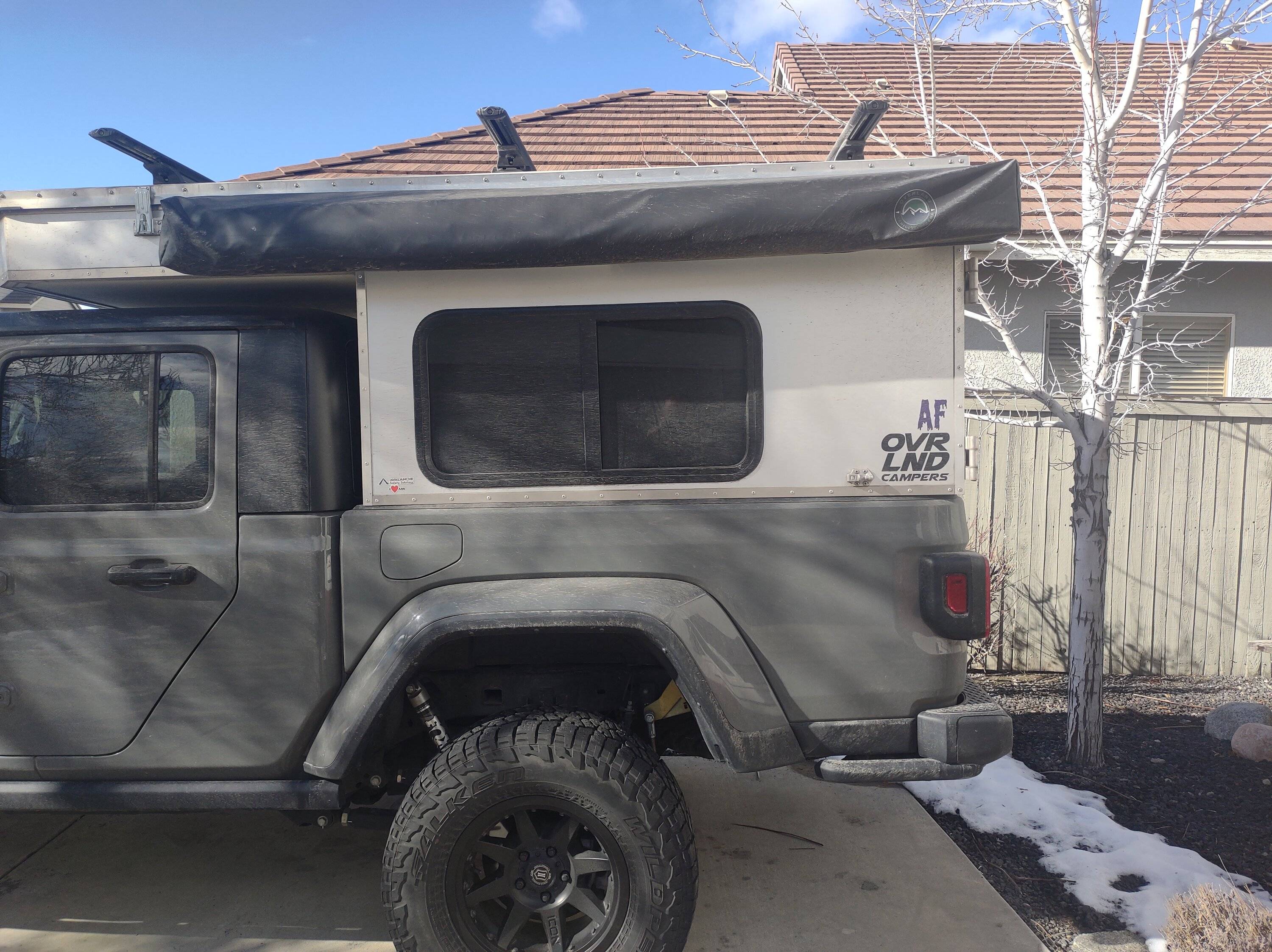

Nope not a project M. OVRLND Camper from Flagstaff AZ. Hand built. Weighed it before they put it on. Even if it's 300lbs it's still half the weight more or less.
