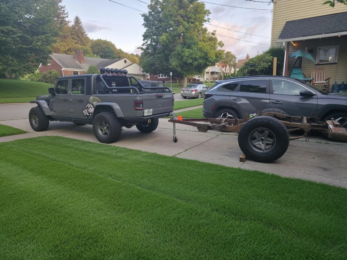

I'm starting my build now that I have the base trailer ready to start building on. Main use will be for those weekends its just me and the dog. (The wife won't camp without the RV) so this is for me when I'm out off-roading and she's not wanting to go.
The trailer is built from a '74 Chevy LUV frame and, for now I'm sticking with the stock axle, 35" tires and wheels matching the truck. Overall length is 12' hitch to bumper. The frame is 40" wide and counting the tires it is 69" wide. As it sits right now, the trailer is almost 55/45 weighted. lifting the tongue could be done by a baby. So I'm going to watch my build to ensure its heavier up front. I may remove the stock bumper but for the moment its staying. It will see some fire road and double track but I doubt it will see any real OFF road trail use. I'm 6'1" and I'd like to have the ability to have the tent above my head so I can also have a mounted overhang above my head while cooking and the sort. I'm thinking about a multilevel sliding drawer and I'm hoping to find a decked drawer system for the back to adapt for the back of the trailer, (but that will add weight to the rear so I got to be careful)

Got any pics of the trailer? For sleeping space. I've got the biggest version of the CVT Pioneer (they say 2 adults and two kids) but I think I'm going to have a truck bed tent for times that I have a need for more than myself and the wife and German Shepard.

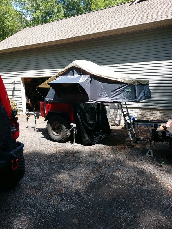

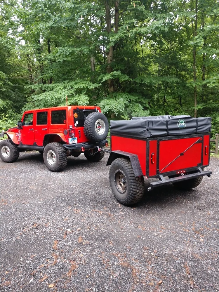

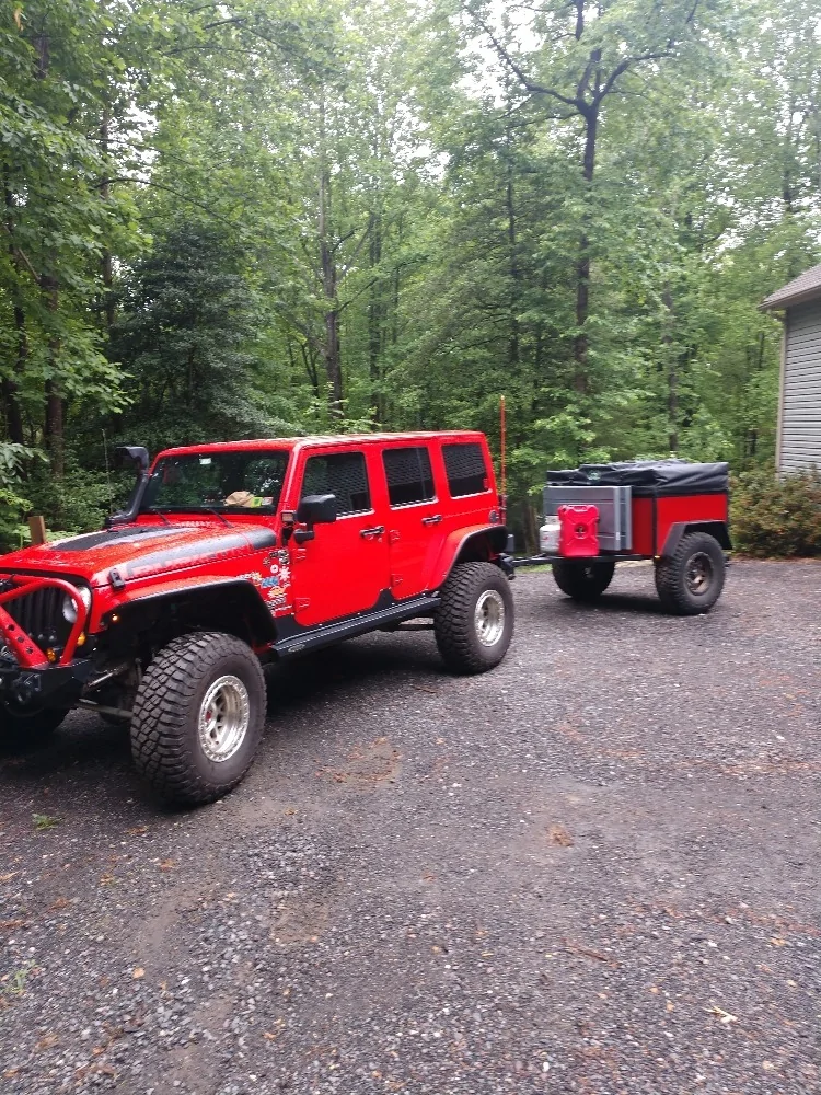

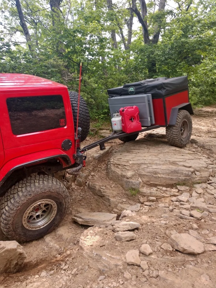

Need to dig up pictures from my other computer. Will post some tonight or tomorrow.
Power I have one of these units.
https://goalzero.com/collections/portable-power-stations/products/yeti-1000x-open-box
Fiberglas panels, I made them from home foam insulation panels and glass mat. 12 inch foam and a layer of glass mat on each side.
Trailer frame. .120 wall 2.5 square tube frame with 0.080 wall skeleton frame.
Suspension is a custom made 4 link on air bags with gas shocks.
Hitch:
https://www.sylvansport.com/shop/ma...h2wd17nbuGmRtA-399mZZRZanyEdkjdB-5GPHJV8wbE0w
Wheels and Tires standard Jeep JK wheels with Milestar 40 inch rubber.

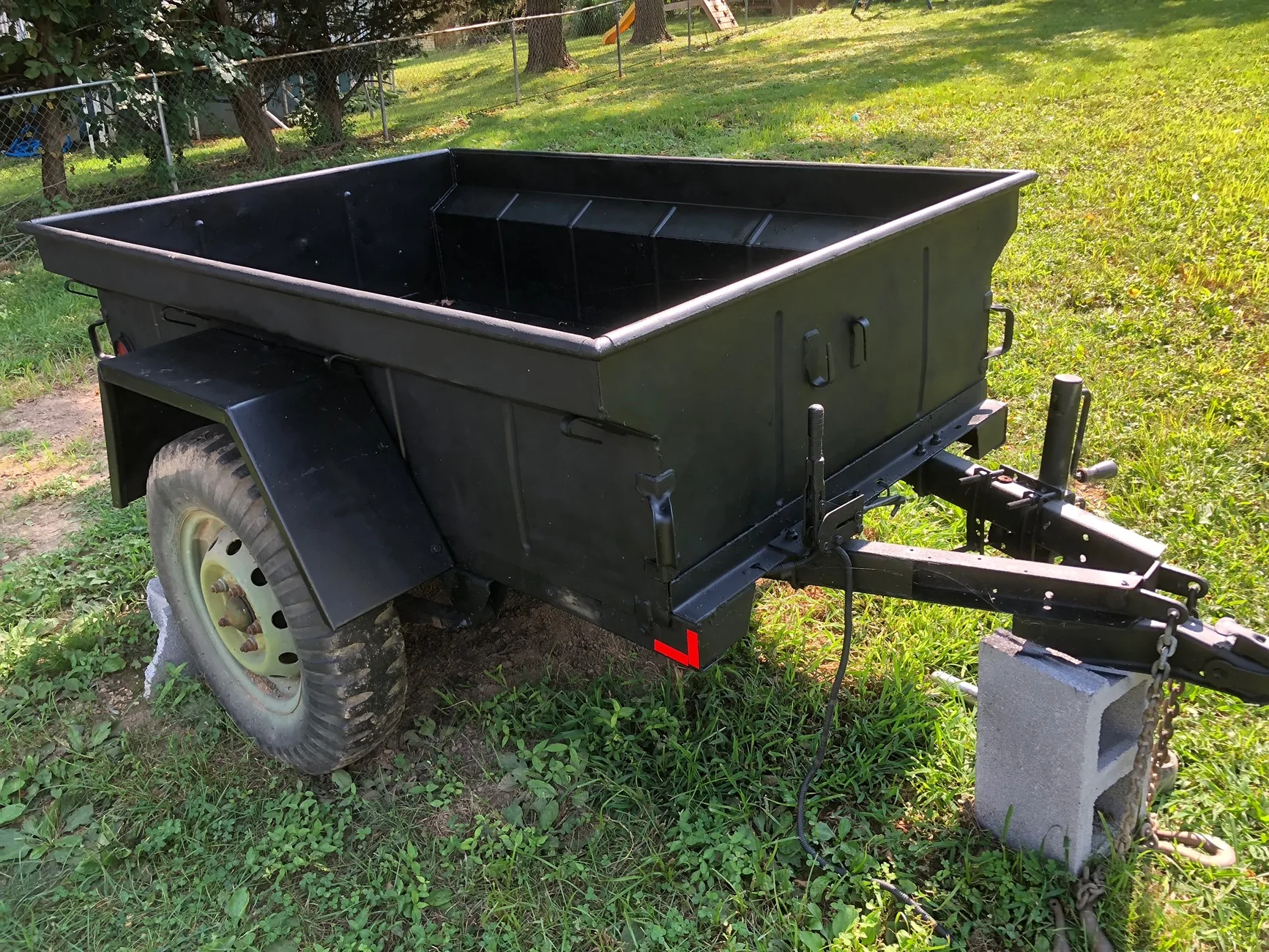

Chevy LUV frame trailer? Neat!
My only suggestion on dimensions: The proportions of the old M416 are almost perfect- except the tongue needs to be longer to track straight unloaded and back up easier (mine was a PITA because it was so short). The least amount of overhang beyond the axles you can legitimately get away with even if you’re not hard core wheeling it will make it much easier to store and maneuver.

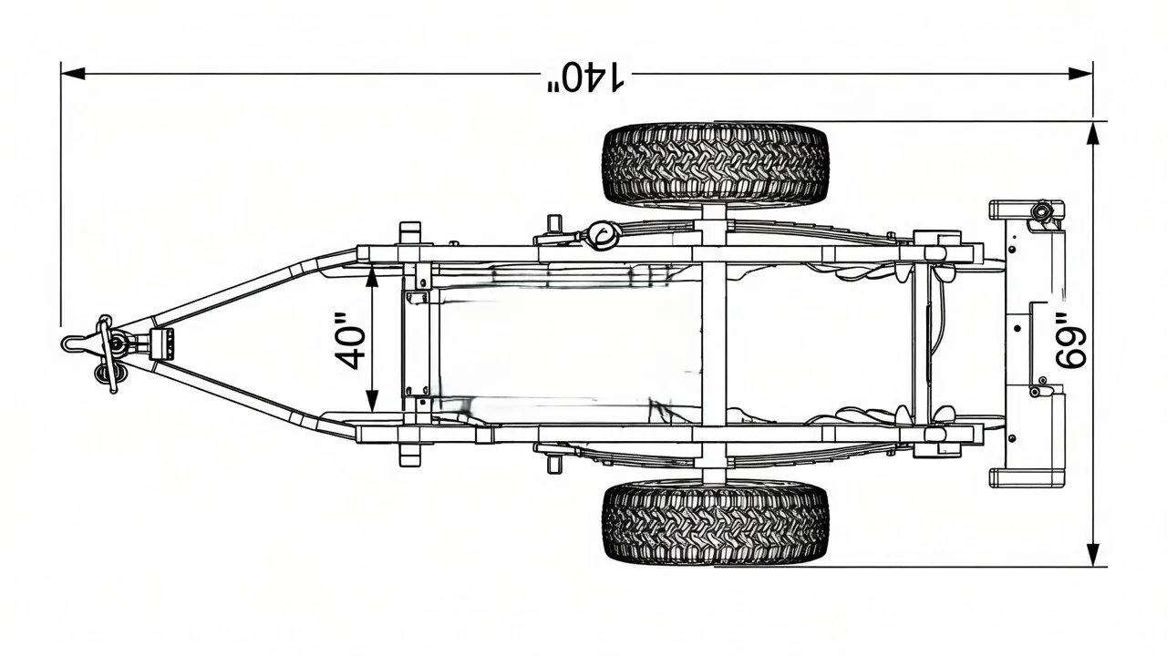

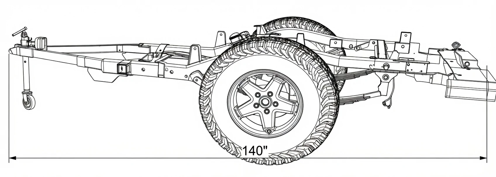

Do you remember the overall length of the M416? This trailer is currently 140" The tongue is 40".
Jeep Gladiator My Expedition Trailer build has started. Ideas wanted. EOX5A
(By the way GROK 4.5 did an amazing job converting the photo to this line drawing!)

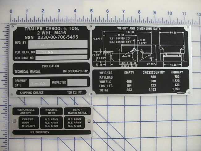

Grok keeps getting better and better. Even 6 months ago it wasn't anywhere near what it can do now with graphics especially.
Below is an M416 data plate. I sold mine to someone with a JLUR to convert into an off road tent trailer. It was just too nice for me to cut it up but it got a TON of use while I had it. They were super lightweight but could hold literal tons of cargo. Mine was circa 1966 or so and virtually indestructible.

That's helpful, Looks like I'm going to have about 20 more inches of tongue, albeit an A frame versus the M416's straight arm.
Solid. Are you planning on installing a rock-and-roll or similar articulating hitch?
My M416 was modified by a previous owner to take the lunette off and insert a 2" hitch on the A-frame behind it. I lost about 18-20" overall from the data plate. Pic below is after I stripped the rust and rattle canned the outside and Herculined the interior. I threw a HF jack on it. I really miss this thing, it was super lightweight and ultra-strong.
