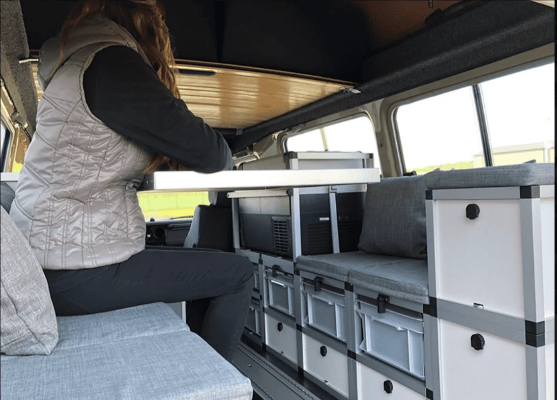

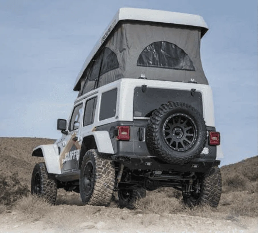

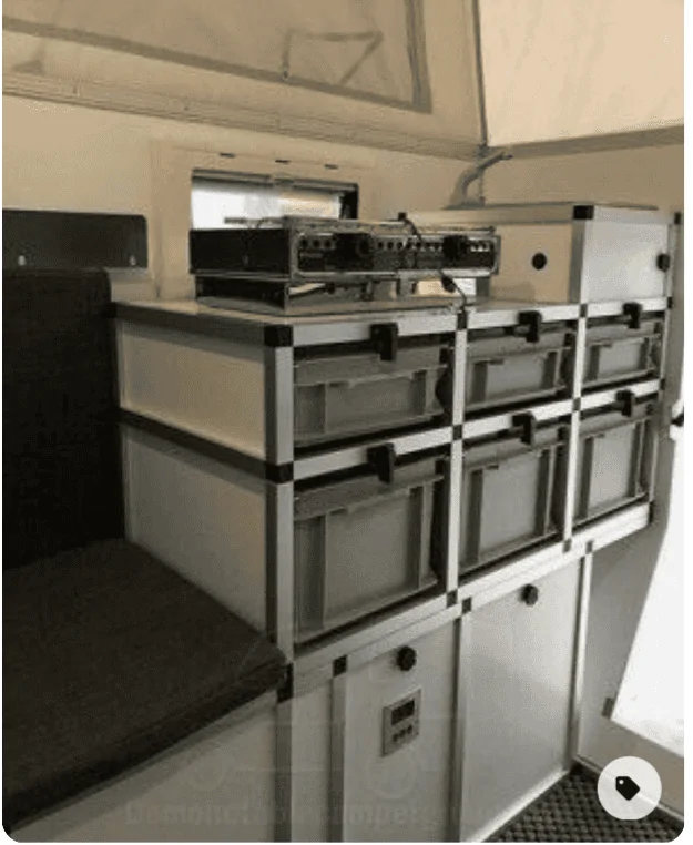

Does anyone know what these plastic boxes are? Looks like you could use 8020's square tubing, fasteners and these boxes, or plastic milk crates (I used them for cheap college furniture back in the day) to make a nice modular interior. Looks like the cubicle boxes stack. The images are from Eurocamper.

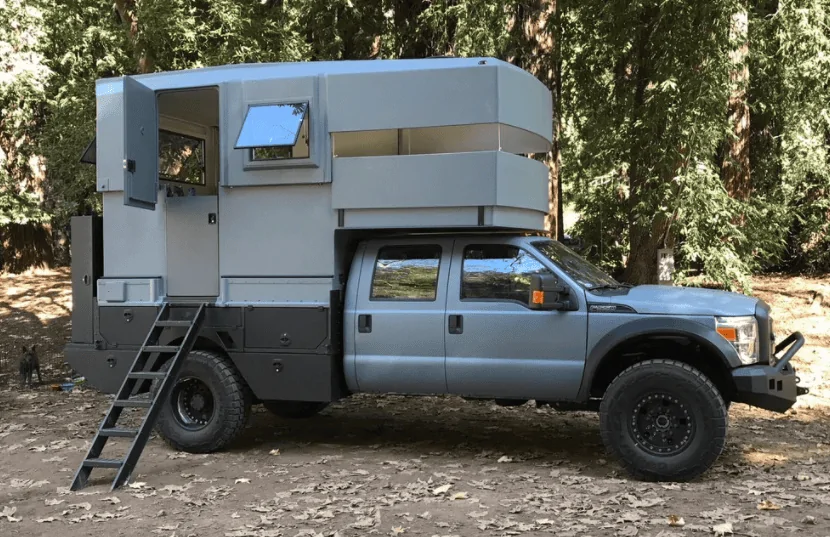

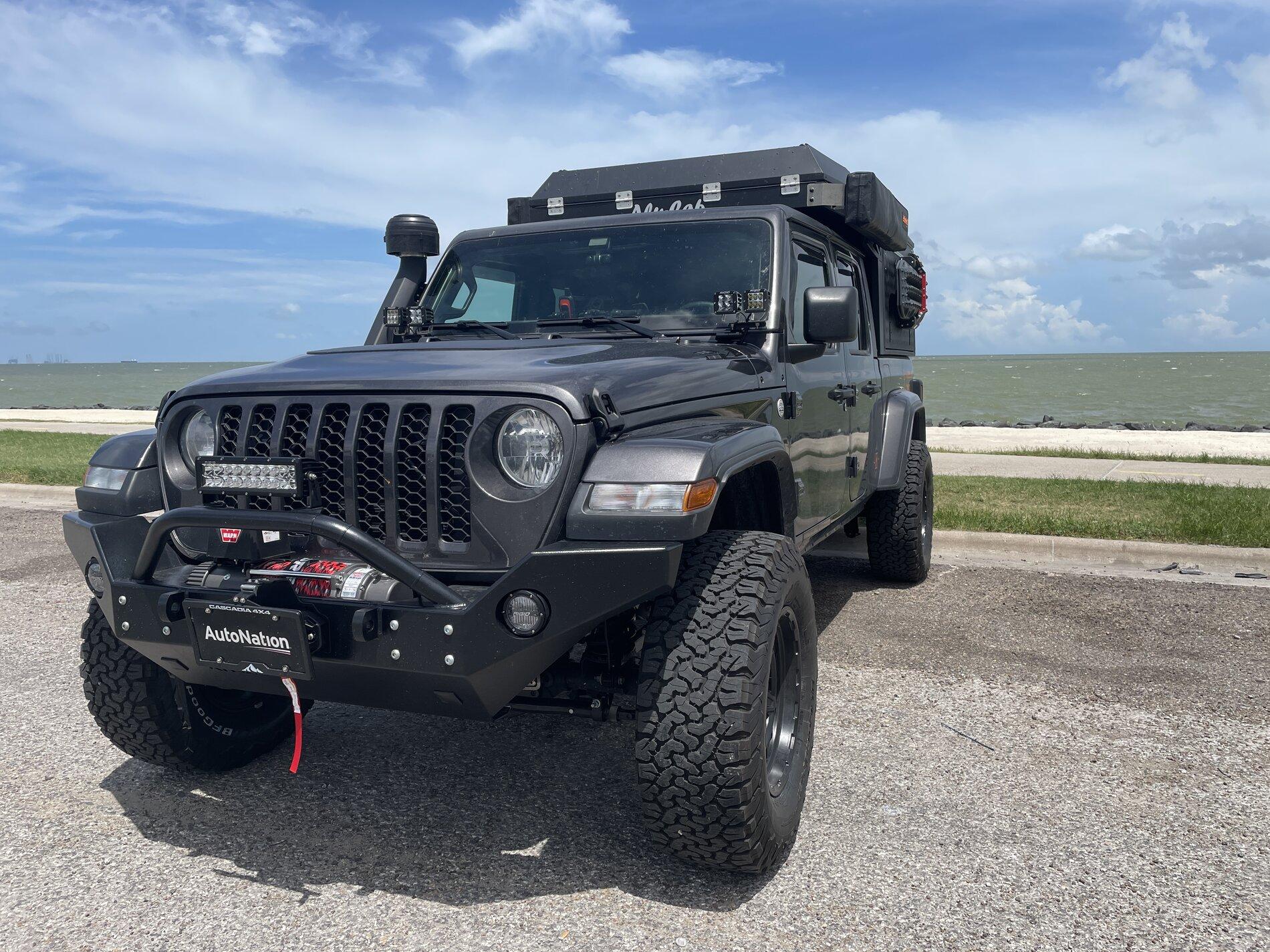

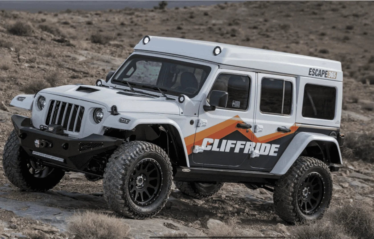

Here is a good example of square/vertical sides on a fiberglass shell which would be easier to build than curved sides. I also like the pop top split line running front to back.
Jeep Gladiator Gladiator Expedition Rigs Screen Shot 2021-07-20 at 7.07.41 AM
Jeep Gladiator Gladiator Expedition Rigs Screen Shot 2021-07-20 at 7.08.37 AM
mog
Mar 28, 2021
330
751
Southern Oregon
'21 Gladiator Rubicon, '09 C4500 Kodiak
Kodiak Buckaroo
Yup, those square/vertical sides would be exponentially easier to build and aline with both the bed and top. Plus it gives it a little more of a dedicated 'Expo Look' instead of an SUV look.

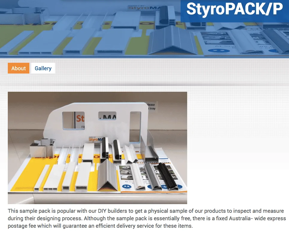

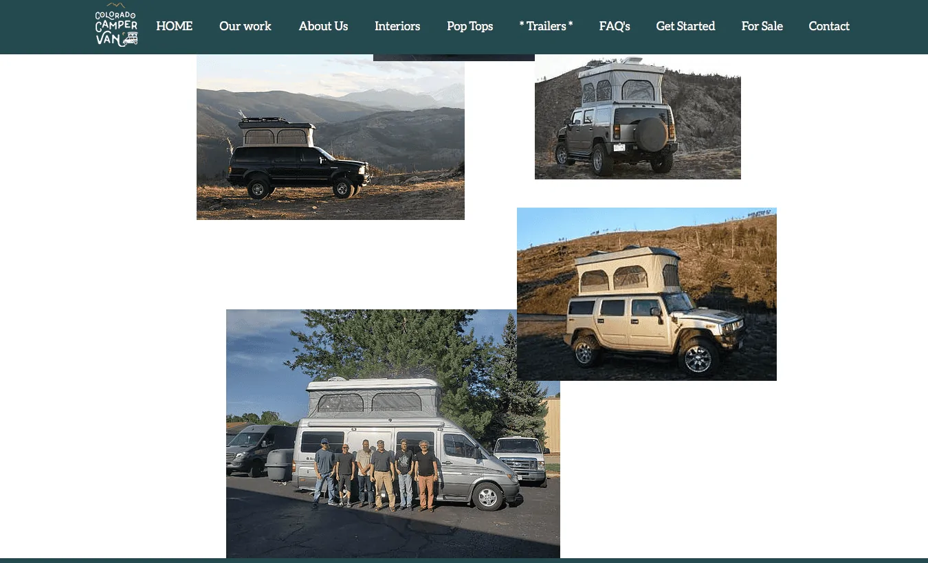

Seems like we don't have a good supply of composite parts in the U.S. StyroMAX out of Australia is a great web site for ideas.
