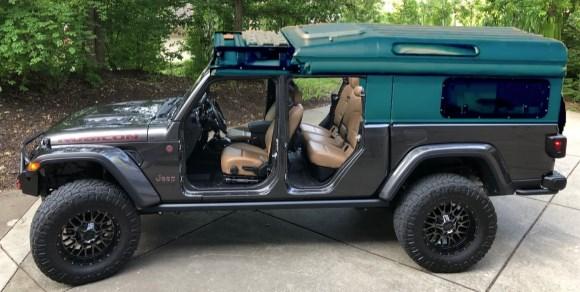

And here's the full top. I moved the window up to fit the interior layout. I'm starting to like this one, but it is pushing my 8ft. tall garage door. If it was easily removeable like a slide in, I could convert back to my stock hardtop or convertible for my daily driver, and put the camper on for expedition mode! Another nice feature is with the added head room, you can still maneuver and camp in it with the pop top down.

Looks great. I have a JKU with a j30 top and the one thing I wish was being able to open the top up over the driver for that "sunroof" affect don't know if you could shorten it to get a Sunrider or freedom style roof on?

One vote for keeping the freedom tops!
Keep the freedom tops and the pop up bed on top pulls down to cover the living area (you can sleep below, but you can't walk around when the bed is down). Loose the freedom tops, extend the bed over the driver, and there is still walking room below.

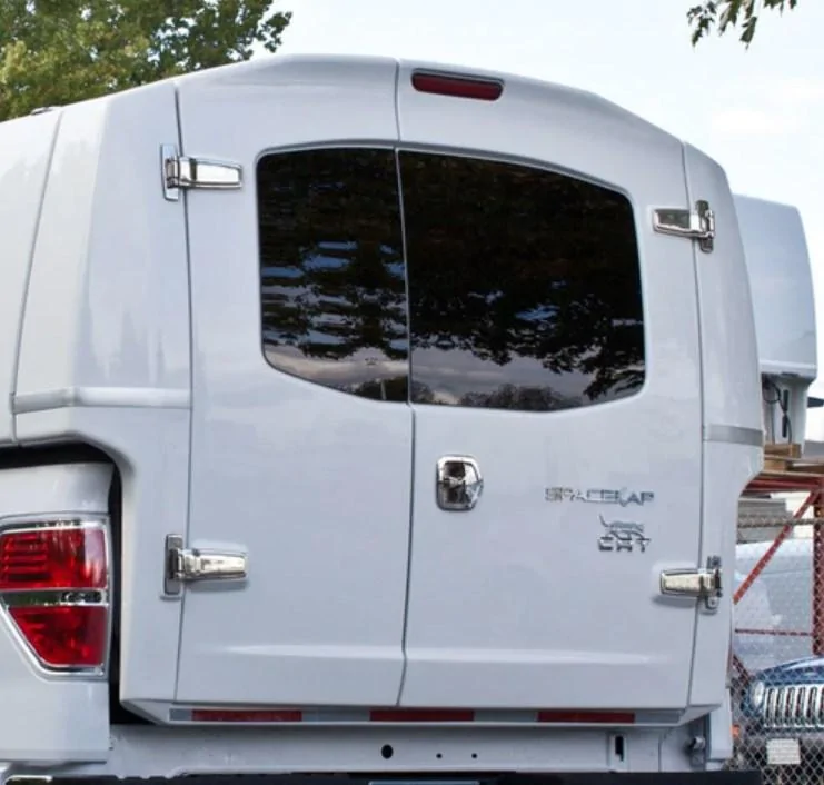

Perhaps just a bit of a 'flair' at the end to blend with the length of the Icarus? Kind of like what the SpaceKaps have.
Jeep Gladiator Gladiator Expedition Rigs SpaceKa

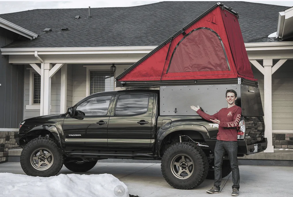

Could always do something like this:
Great video!!! Cut the bottom of an Alucab Roof top tent out and screw it to the top of your fiberglass cap. A small amount of fabrication and almost no painting. This guy did a great job.
Great video, but a bit mistitled imo. If you truly want to build it (rather than fitting a very nice fully pre-fabricated wedge tent to a Jeep), and can afford to invest substantially more time to realize substantial money savings:
https://www.tacomaworld.com/threads/how-to-diy-wedge-camper.604686/
I'm contemplating either a Wrangler or Gladiator build like this. On the JT, you could omit the hard freedom top rear glass; and have emergency direct access to the cab if needed (i.e. when you awake to a bear or the more dangerous and prevalent two-legged intruder).
Having owned many different types of RV's and associated rigs, etc.; my own target goal is a daily driver with worthy off roadability, no trailering, quick turn to/from camping mode for two adults and dog, sleep quarters above ground, and most important in socal it all fits neatly tucked inside the garage at night (crazy HOA rules or offsite storage fees that rival a second mortgage lol).

Thanks for the link. This is a great DIY article for building a steel, 8020, and composite rig. Love to see anyone's DIY rigs they built on Gladiators.
