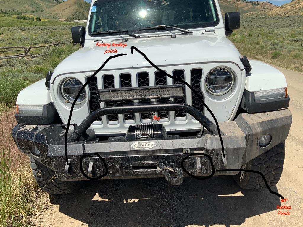

I purchase a LOD bumper rated for flat towing. I didn't like the spread of the hookup point so I made my own. The spread conforms to Blue Ox measurement, but limits your turning angle. I had it bind a couple times.

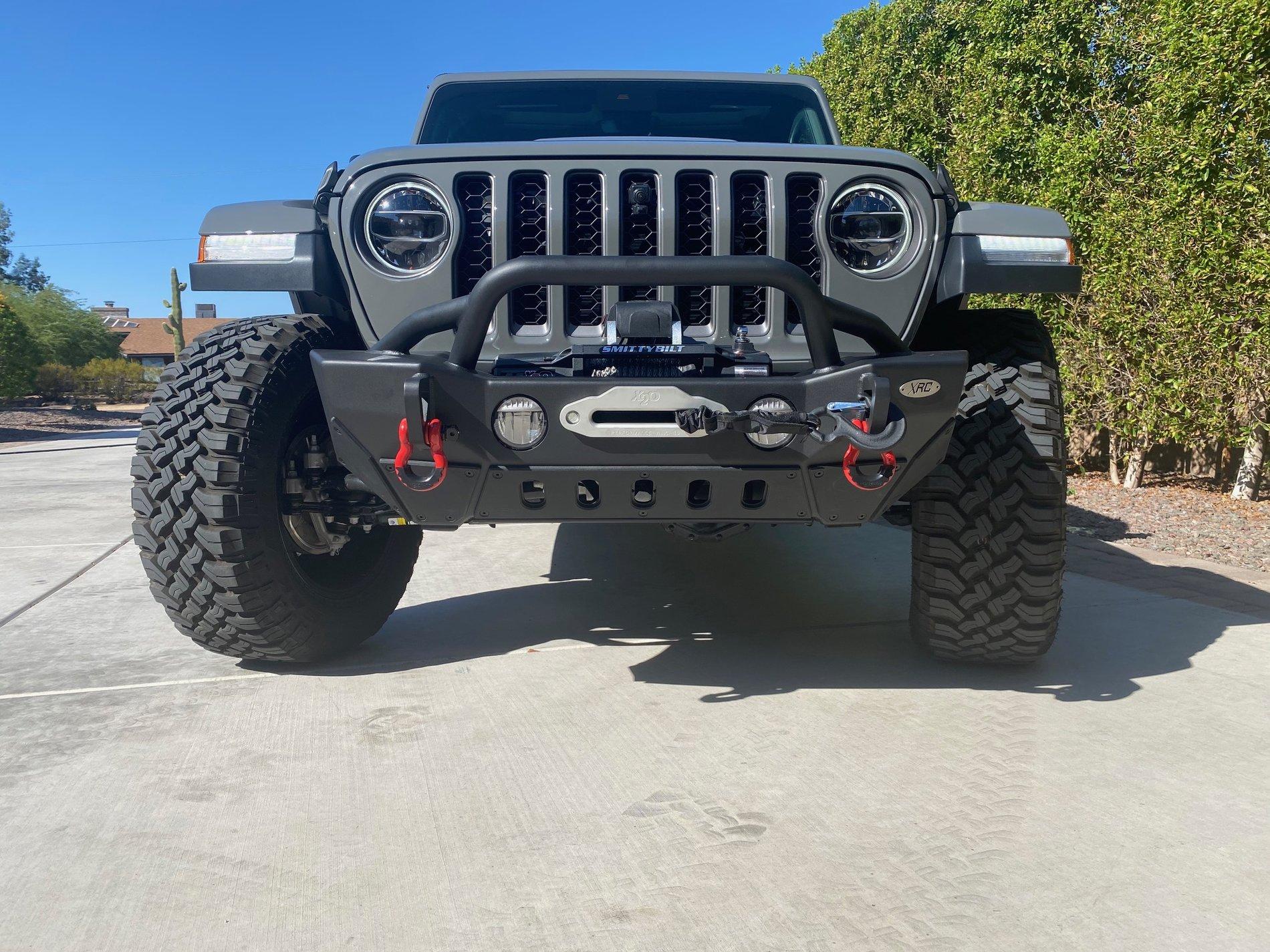

Here is a picture of my bumper.
Jeep Gladiator Gladiator front bumper with hooks to flat tow behing a motorhome IMG_2888

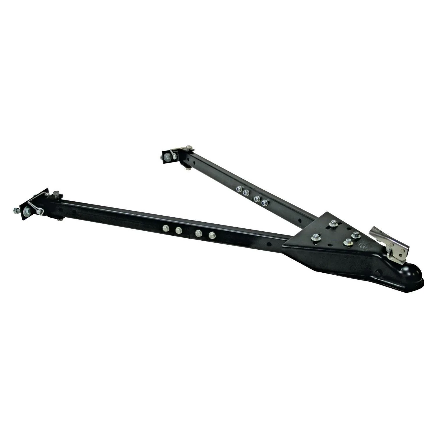

But the tow bars typically come with the brackets that you bolt to the frame. Why go through all the work changing out the bumper when you can easily just add the brackets.
Idealy speaking you would want the brackets to share space with the factory recovery hooks as they are direct and inline with the frame rails.
Why complicate it with a whole new bumper unless you want a whole new bumper and it would be helpful if it could flat tow too.

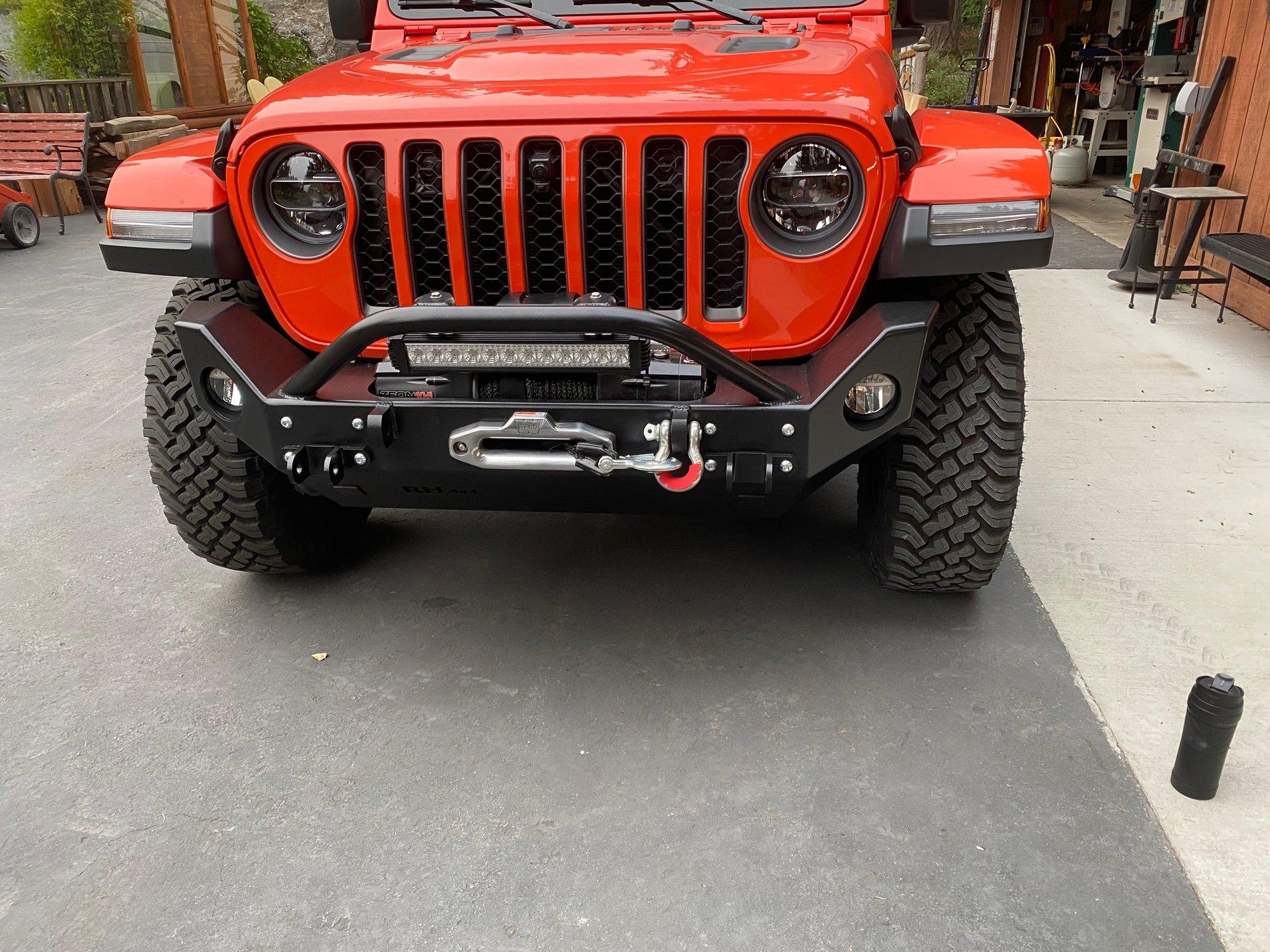

Rock Hard makes an Aluminum one, they make mounts specific to your tow bar. Really happy with the fit, finish and ability to hook up and go.
Jeep Gladiator Gladiator front bumper with hooks to flat tow behing a motorhome Jeep 3

Jeep Gladiator Gladiator front bumper with hooks to flat tow behing a motorhome 1600296936785
I didn't like the factor hookup points as too wide. Made and installed my own points closer together for improved turning radius

sorry to necromance this thread, but is that bumper using the oem halogen fog housings in it?

Yes, they bolt right in. Halogens on my JK and LED on my JL and JT. The bumper accepts either.
