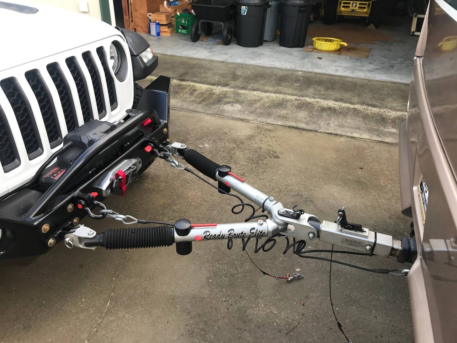

Towing 4 down is the easiest towing I have done. The Jeep stays directly in the tracks of the motorhome going around corners. Another thing is that none of the weight of the Jeep is resting on the motorhome. I bought a Rockhard Bumper along with their towing brackets (~$1600) and a Ready Brute Elite towbar with Blue OX ends (~$1250) to connect my coach and Jeep together. The Ready Brute towbar uses surge braking via cables to the brake pedal in the Jeep. It is relatively simple to install for someone who had auto tools and occasionally works on their vehicles. I use a Curt wiring harness (~$80) to operate the taillights. I've towed more than 40K miles with this setup. It works and it is probably the cheapest option.

this is the exact setup i have and it is very easy to use. with my class C the gas mileage loss was minimal (about 1mpg)
Did you disconnect the neg side of battery
both main and aux battery

nope. 99% of the time i have had no issues. only time i had a battery drain issue was when we were doing a full (like 12h) travel day. anything less than that is not an issue. thankfully those days are few and far between, but when we do those i just start it and let it run when i'm doing one of my fill ups and then no issues.

How do you like the Rock Hard Bumper set up? Debating that vs invisible base plate under factory bumper?
