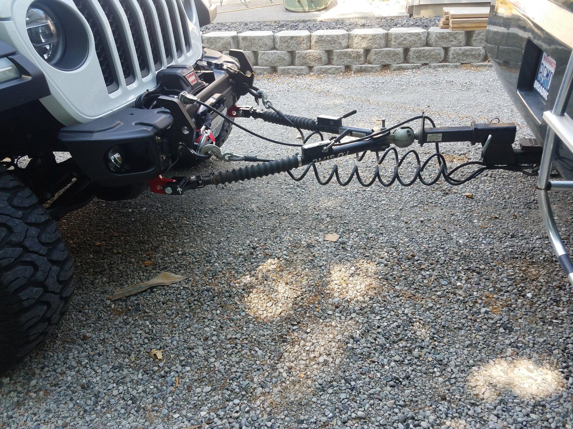

So I am thinking of buying a motor home. After spending a week in a hotel due to the creek fire. I am thinking that’s a down payment on a used motor home Tuff finding anything that will take us and 4 dogs! But that means I would have to tow the jtr I have the steel mopar bumper which will house a winch. So what kind of set up can I use?

Many base plate systems will not work with a winch and winch plate that sits low between the frame rails, such as a Rubicon steel winch bumper.
Many have been using the Maximus-3 tow loops with much success on their JTs and JLs, including myself.
