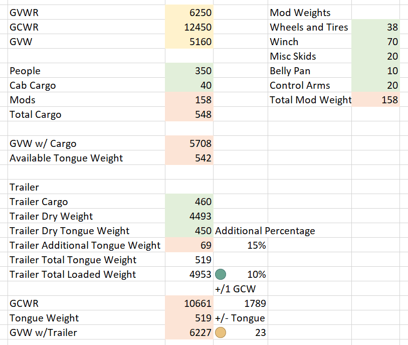

tmcarr
May 28, 2018
32
KY
2020 JT Sport S Max Tow Sting Grey
Ok... So more clarity.
I weighed my rig today at a CAT scale with a fully topped gas tank (Went from the pump to the scale, Me not in it because those scale intercoms are setup for semi's not JTs!)
The results:
Steer Axle: 2,700#
Drive Axle: 2,460#
GrosVW: 5,160#
GVWR: 6,250#
So, true cargo and people capacity with a full tank of gas of my exact rig is: 1,090#
Now, here's my math if someone wants to make doubly sure that my assumptions are all correct:
Curb weight with a full tank: 5,160#
Me and the Mrs.: + 350# (Includes clothes, purse according to Mrs.)
Crap that needs to be in the bed or cab: +40# (Laptop, camera bag, etc)
New Curb Weight: 5,550#
Available Tongue Weight (max): 700# (Well now isn't that a coincidence)
Then, there's more:
Weight of all aftermarket parts: +50# (Swaps, etc. based on experience and manufacturer conversations)
Realistic New Curb Weight: 5,600#
Realistic Available Max Tongue: 650#
GCWR: 12,450#
Realistic Available Max Trailer Weight: 6,850# (This is not realistic due to the 10% rule on Tongue)
SO, bottom line. In my specific case: I can legally tow with the above assumptions:
6,490#GTW and 649# Tongue.
I would then estimate that my comfortable towing level to be:
5,900# GTW and 590# Tongue (but with a bias toward moving the tongue weight to 12-13% of GTW)
Does that math check out? If so, I will also make a new post with the process flow here because I believe there are a LOT of new JT owners that would benefit from this very level of detail.
Cheers!
B
B, Your numbers make sense. Remember if your total trailer weight is 6490# when you connect it to your TV and put 649#'s of that weight on the hitch, you can then subtract that 649#s from your trailers total weight. In other words, if your TV curb weight is 5600# and the TT curb weight is 5900# your Combined total weight is 11,500#s. 590#s of the total trailer weight moves to the TV so the total trailer axle(s) weight will be (and always was) 5310#s.
Not sure how clear I made that but just don't make the mistake of adding the tongue weight twice, once as tongue weight on the TV and twice as being already calculated in total trailer weight.
I've attached a screen shot of my weight distribution calculator.
Good catch, I did remember to leave the tongue weight off of the final calculation for GCW. I love Excel...
Jeep Gladiator 2020 Gladiator Towing (Overland) Towing Calculator Screen Grab 1
