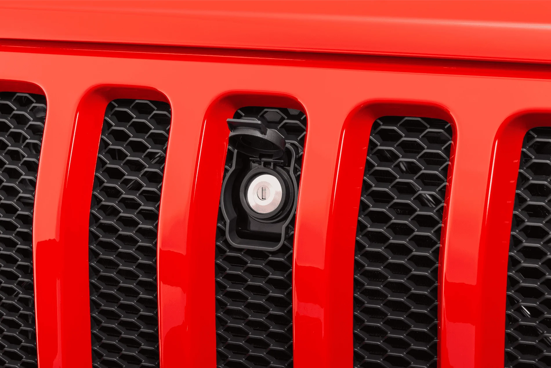

Get the BOLT Lock JL hood lock. It works well and uses your ignition key to open so no extra keys on your key ring.
I have used these on all my Jeeps beginning with my two JKs. Word or warning though, they only last about 2 years, both my JK ones went bad in two years, the cover for the lock cylinder came off and it would no longer lock. When they broke, they just didn't function so I could get my hood open.
Bolt Lock JL Hood Lock
I understand the Bolt interferes with the TrailCam, if you have one of those.

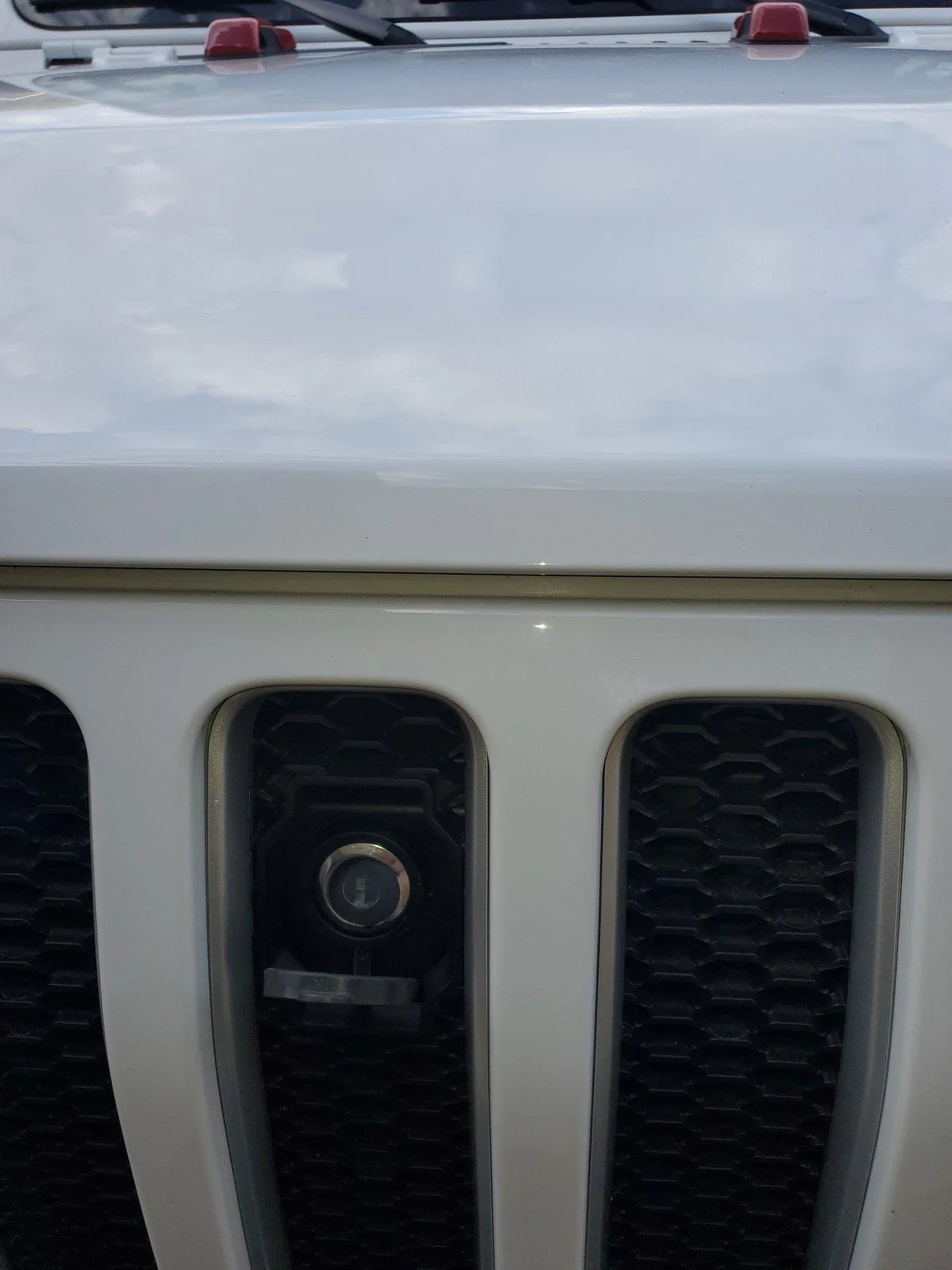

I ended up just going to the dealership and they installed a new hood lock that uses my factor key to access the hood. I also had to change the front grill for the new lock to work. Thanks guys for all your advice!

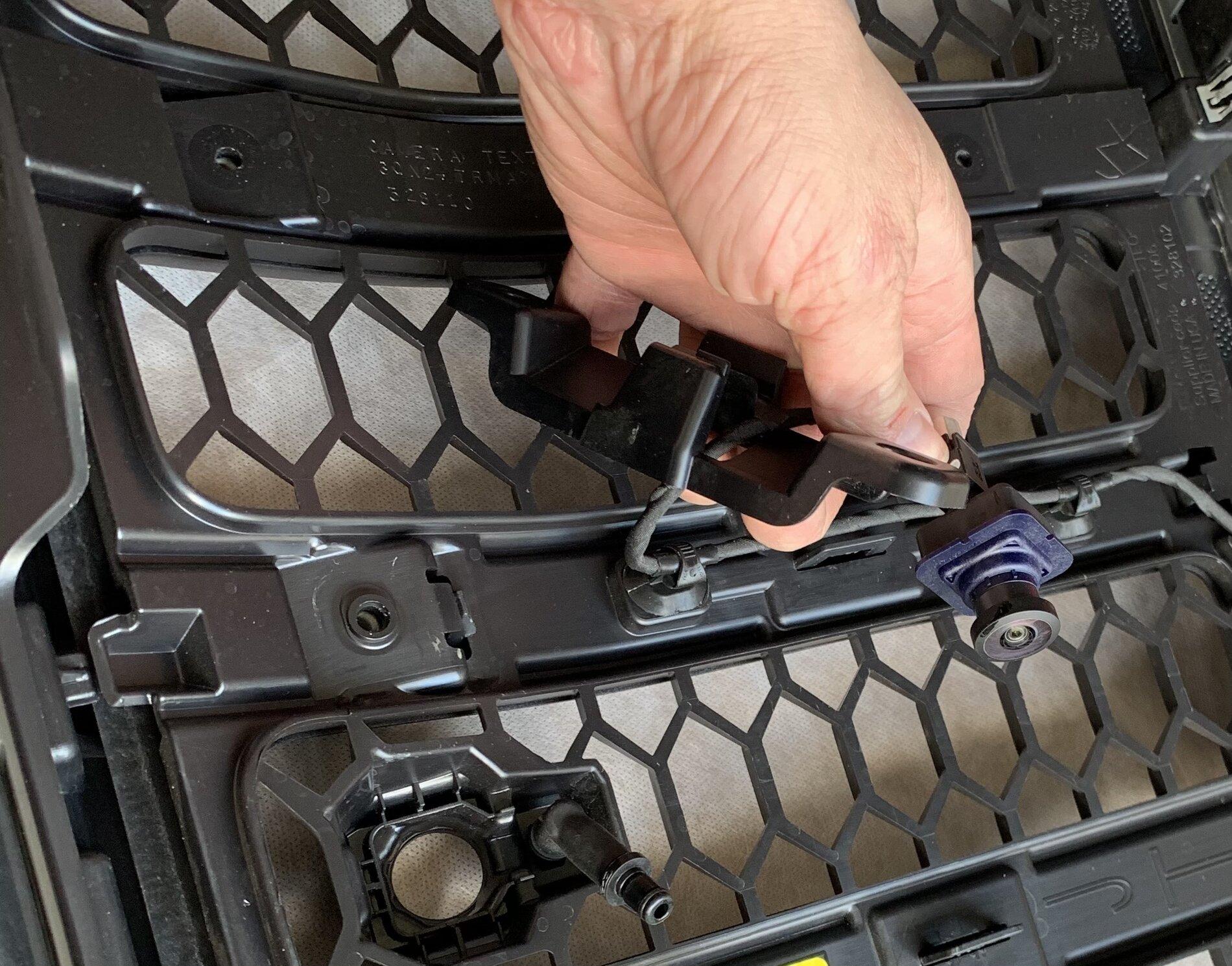

Hmm, can the factory trail cam be moved lower to accommodate the Bolt hood lock ? I have my 2021 JTR diesel on order so I can't check it out but it would seem that it just bolts into one of the grill holes.
unixxx
Dec 15, 2019
84
84
Cali
Gladiator Mojave, Grand Cherokee SRT
Engineer
The TrailCam mounts into a cradle molded into the grille mesh. You'd need to find some other way to mount it.
