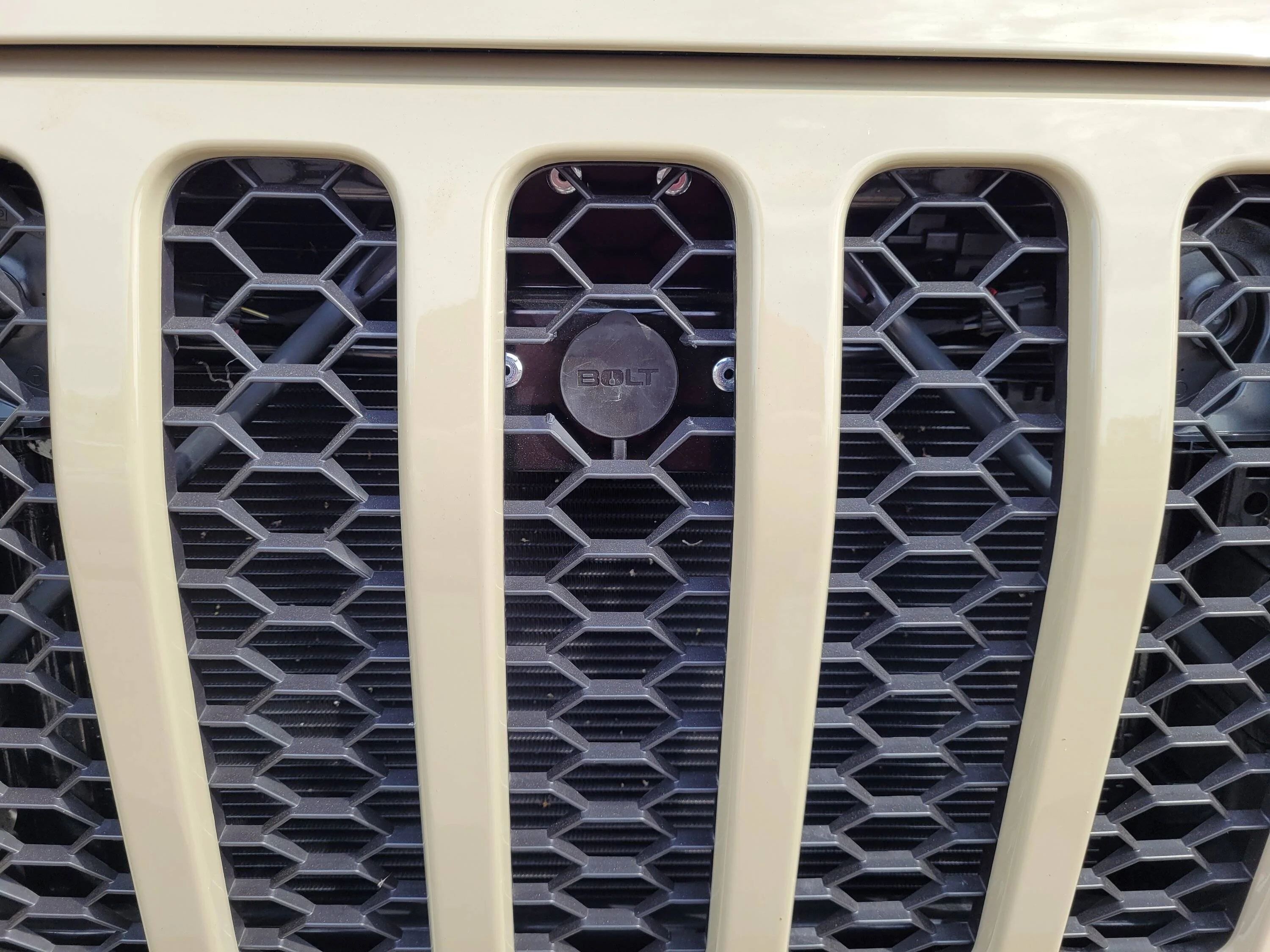

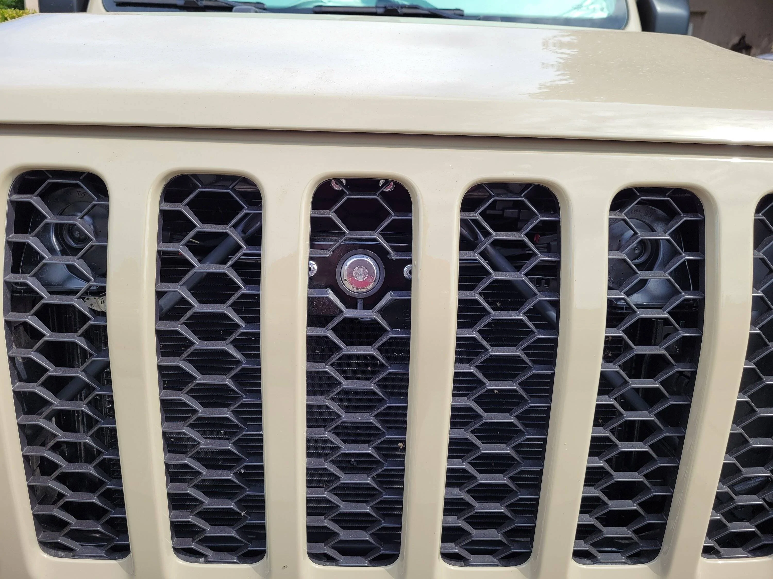

You don't have to cut as much as the instructions say. Nice sharp set of side/wire cutters will make quick and clean work. Barely noticeable from a distance unless you know to look for it.
That looks pretty good not as noticeable. Are you able to take the cap on and off easily?
It is not really that difficult. As long as I remember to make sure the cap stays forward of the grill when I take it off, it is not hard to put back. The cap is a flexible material and can be moved into place easily.

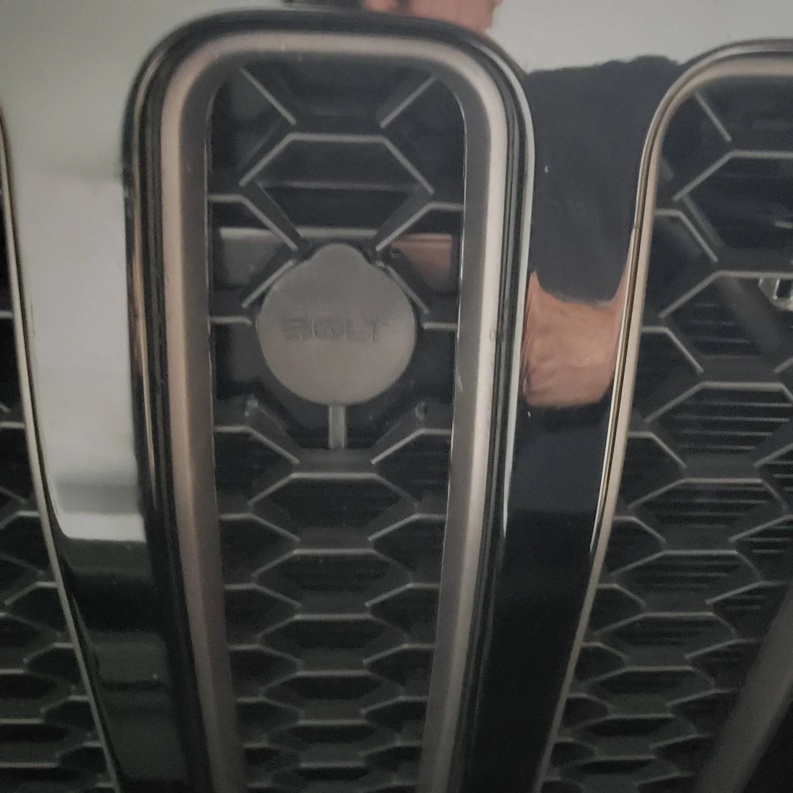

I cut the center section. It is actually a smaller hole than the one they send. Everything is black and its not something you really see.
I completely agree. I used my original, but don’t use their template. I used a sharp side cutter carefully and only removed what was needed. You don’t see it. @Mightytalldude even cut less than i did. His looks even better. He had mine to use as what not to do, quite as much. :)

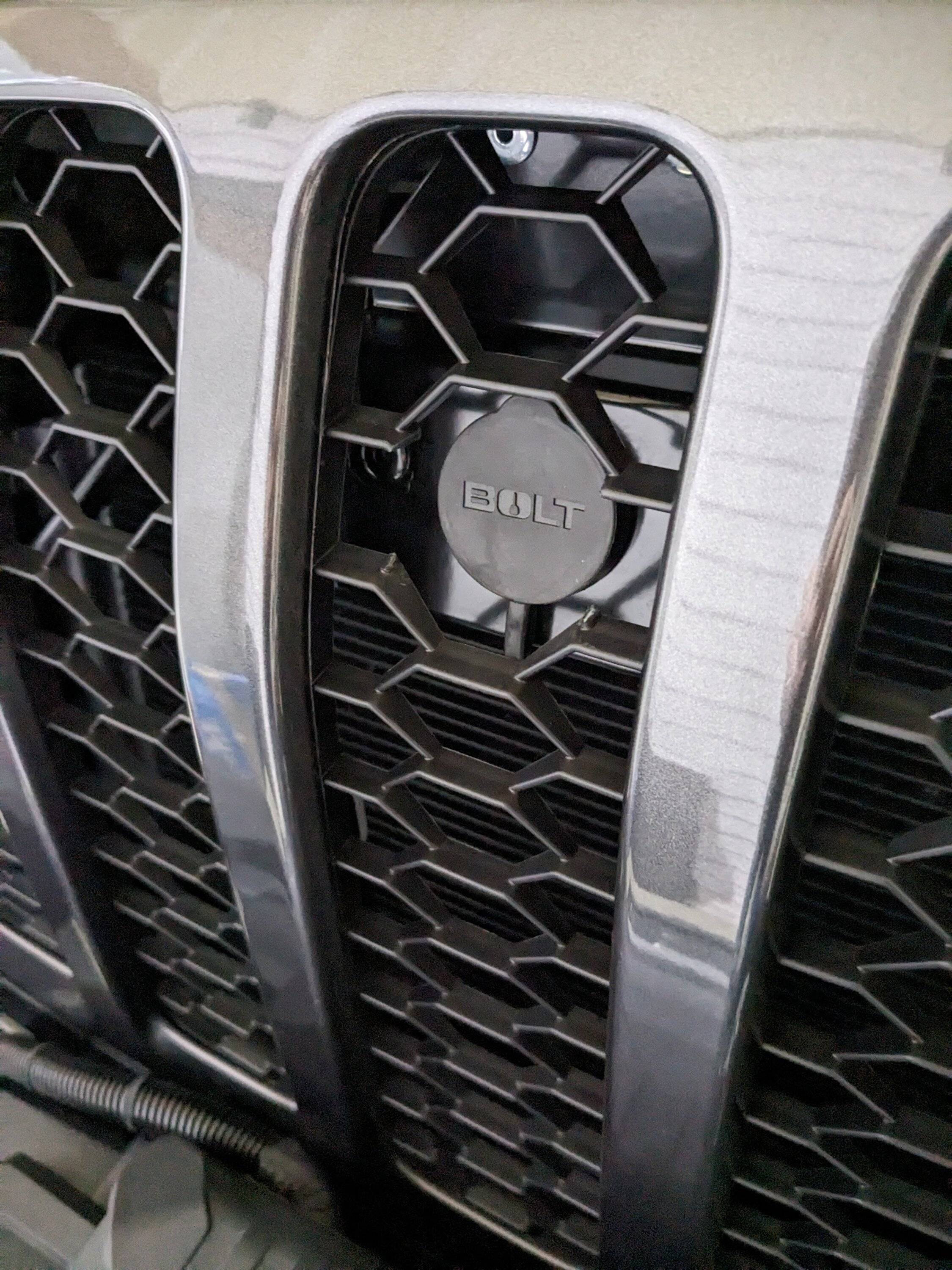

I did the original cutout per the template. Too much IMO, so I ordered a replacement center grill insert, and did the cut my way. It works and looks good.
Jeep Gladiator Bolt hood lock install PXL_20231231_024625818

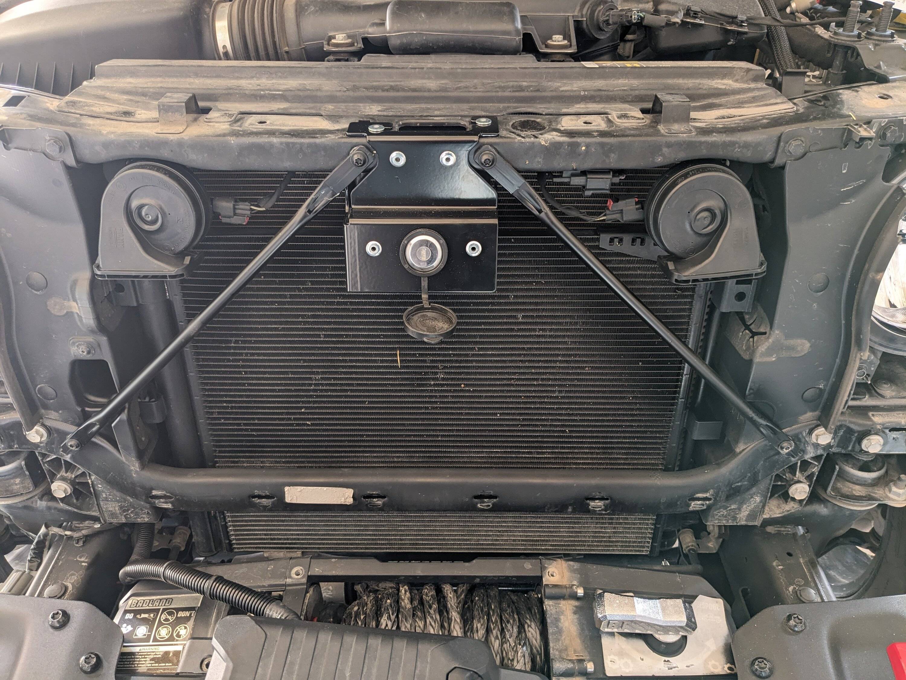

I also painted the pop rivits black, so they don't draw attention to the area. While I had everything off, I also touched up the paint on the radiator and the support bars, 4 years of use, they were a little faded and road debris sand blasted.
Jeep Gladiator Bolt hood lock install PXL_20231221_153701880

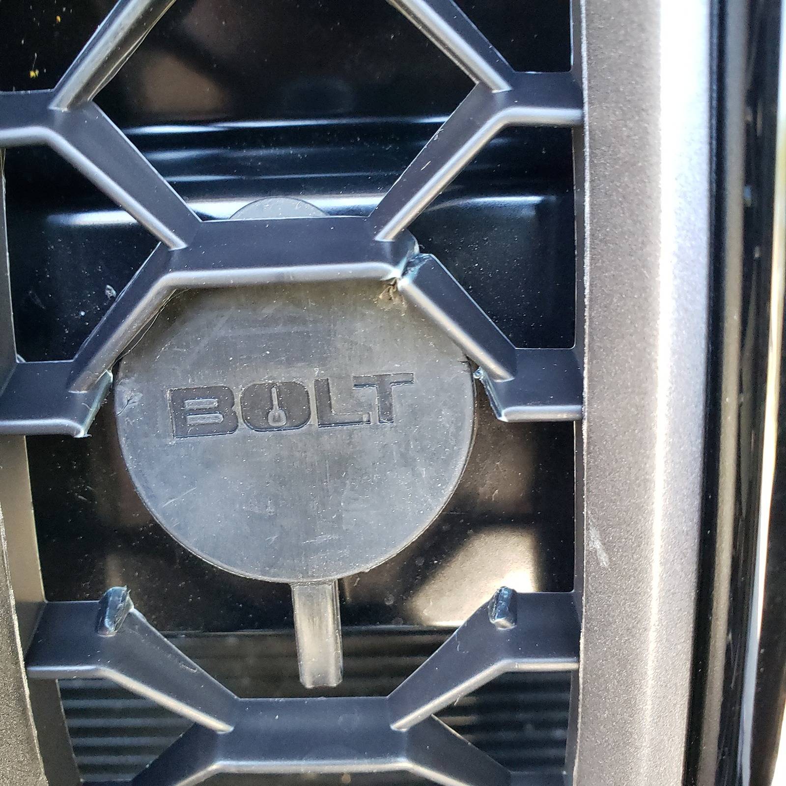

Installed the Bolt Hood lock today. No problem removing the grill, the rivets required some wheaties. Mine seems to sit a bit higher than the prior sets of pictures and I had to remove the bottom piece of the honeycomb above above and on the lock. I can get it on and off now with a little juggling. I painted the visible rivets black. It works, does what it should.
The problem how mine lines up. No way I could take the cover off without removing more honeycomb pieces. I almost cut the wrong piece, painted over the cut so it is not visible unless you are very close. I'm going to try to fill it in with some glue later.
Jeep Gladiator Bolt hood lock install 20240329_120743[1]

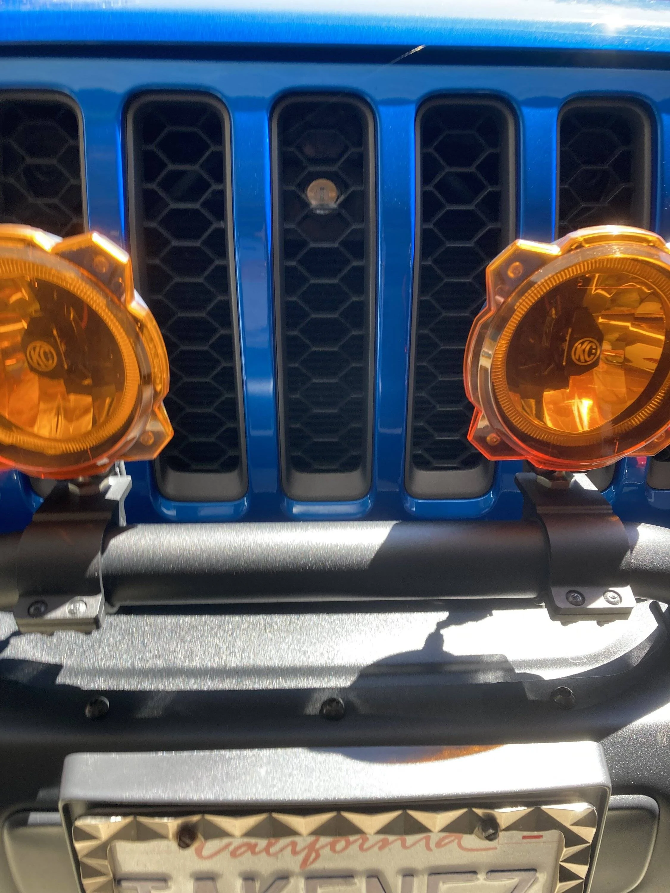

This is after I took out another piece of the honeycomb. I can now open and close the cap, although it is tight.
Jeep Gladiator Bolt hood lock install 20240329_200724[1]
