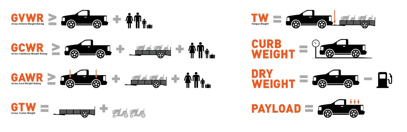

There's a couple of existing threads here that deal in great detail about trailer weight, GVW, axle weight, payload and so on. Payload is the weight on the truck itself - not what's in the trailer. Payload is the tongue weight, the driver and passengers, anything that's in the box, a suitcase in the back seat, your 8 track tapes in the box in the back seat, whatever. It's the weight you put in or on the truck - not what you pull.
The gross vehicle weight rating, GVWR is the maximum operating weight/mass of a vehicle as specified by the manufacturer including the vehicle's chassis, body, engine, engine fluids, fuel, accessories, driver, passengers and cargo but excluding that of any trailers.
Then there's gross combined weight rating - that's like the picture shows, the weight of your truck, YOU, the trailer, water in the trailer, battery for the trailer, LP tank, food, whatever. It's what the whole shootin' match weighs when you hit the road loaded.
TW here is TONGUE WEIGHT
Payload is the weight the truck is carrying - you, luggage, kids, dog, rifles, paddles for the boat, trolling motor if in the back of the truck, bucket of worms, etc.
Note the red arrows in the GAWR - gross AXLE weight rating - the load on the axles.
Gross trailer weight is the loaded trailer it can haul- weight of the trailer empty, plus water, your waste water, food, ice, bedding/sheets/pillows, mouse traps, whatever is in the camper plus the weight of the camper.
This site does a good job explaining and untwisting all the abbreviations, acronyms, whatever -

Excellent graphic Papa. A picture IS worth a thousand words.
