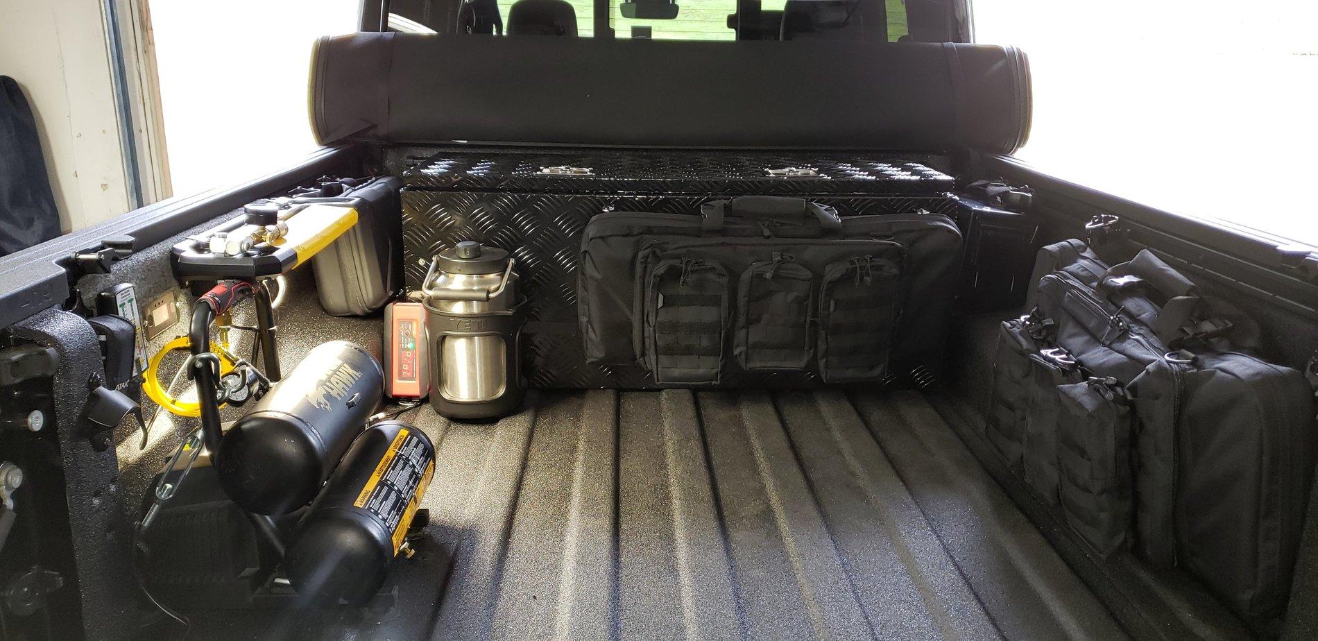

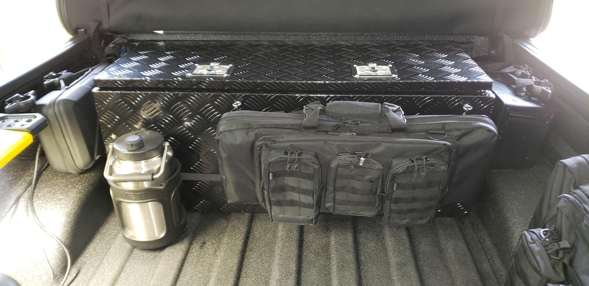

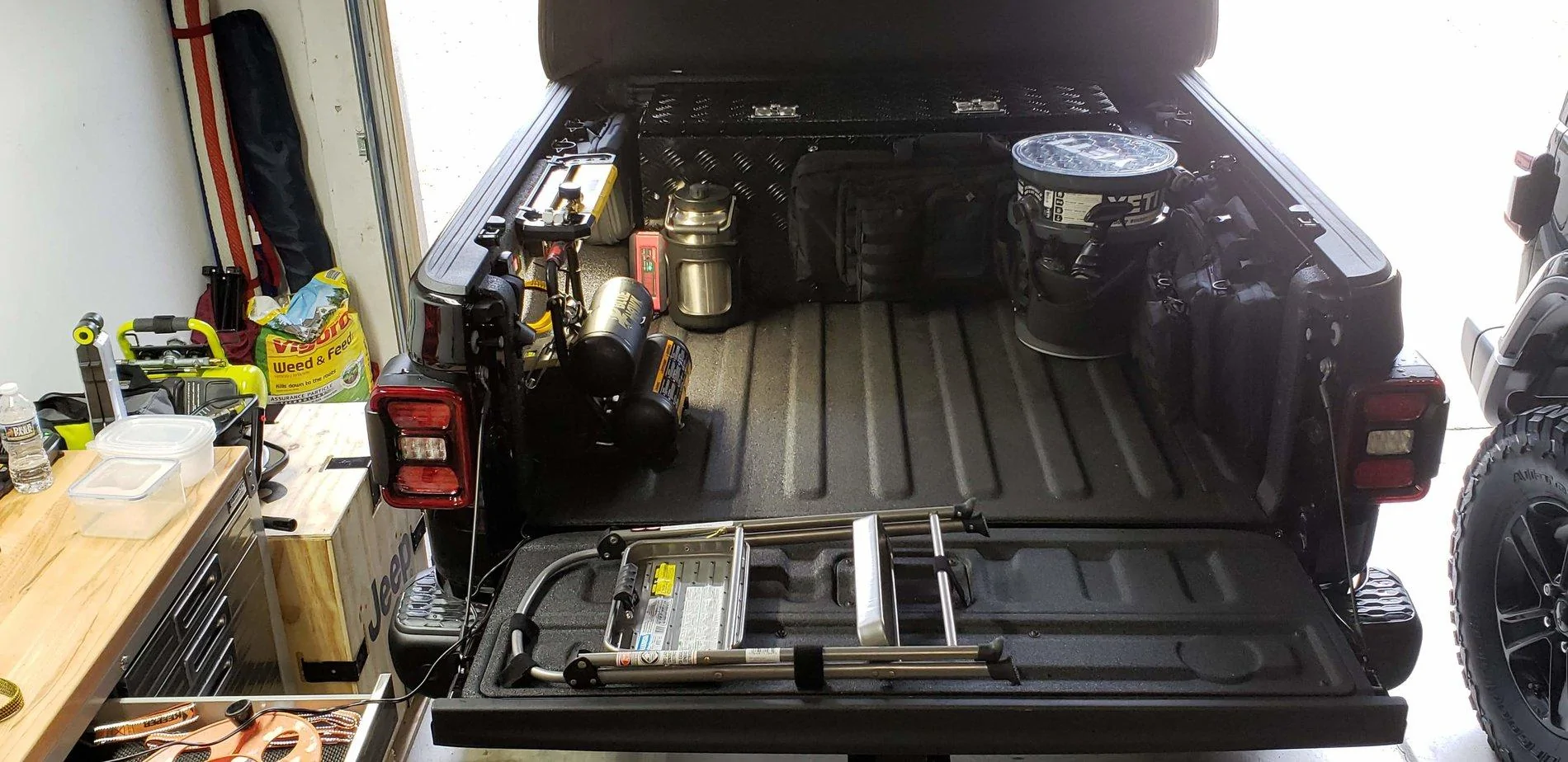

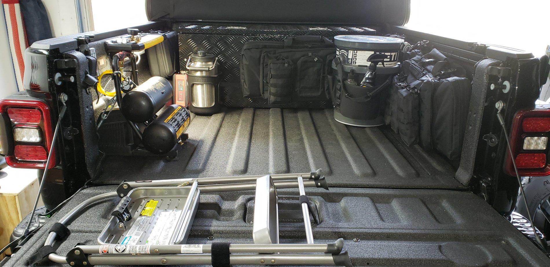

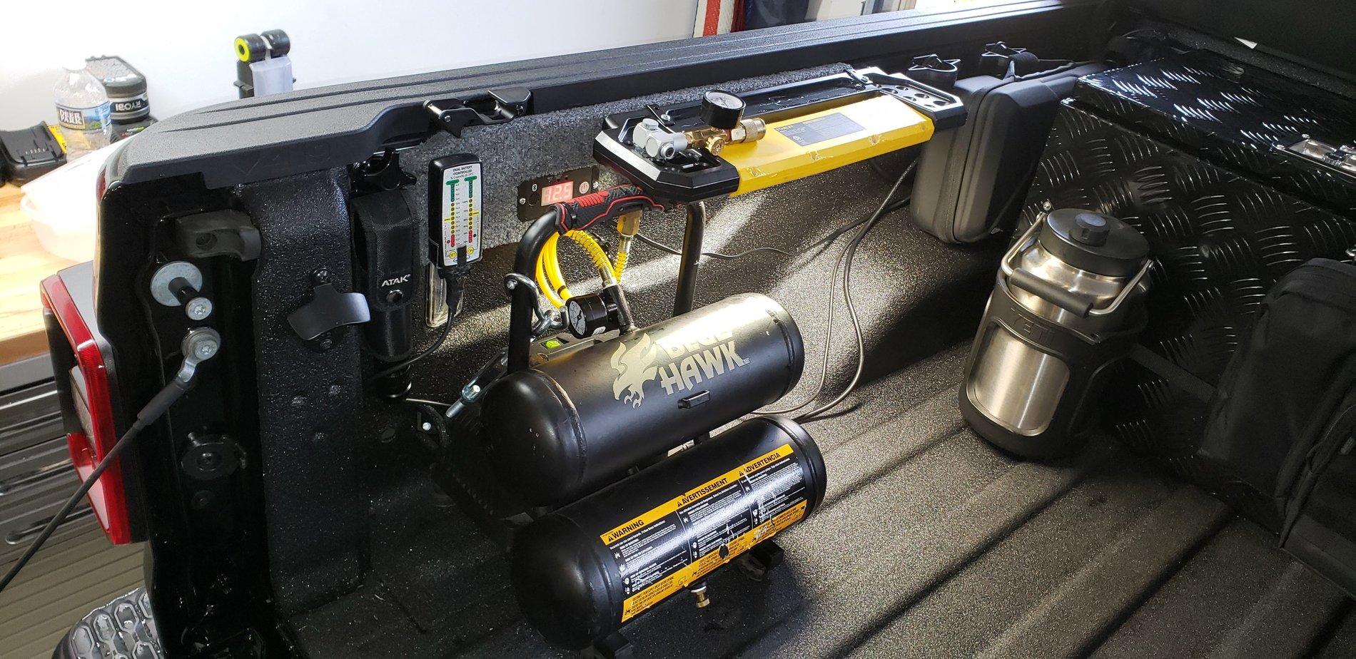

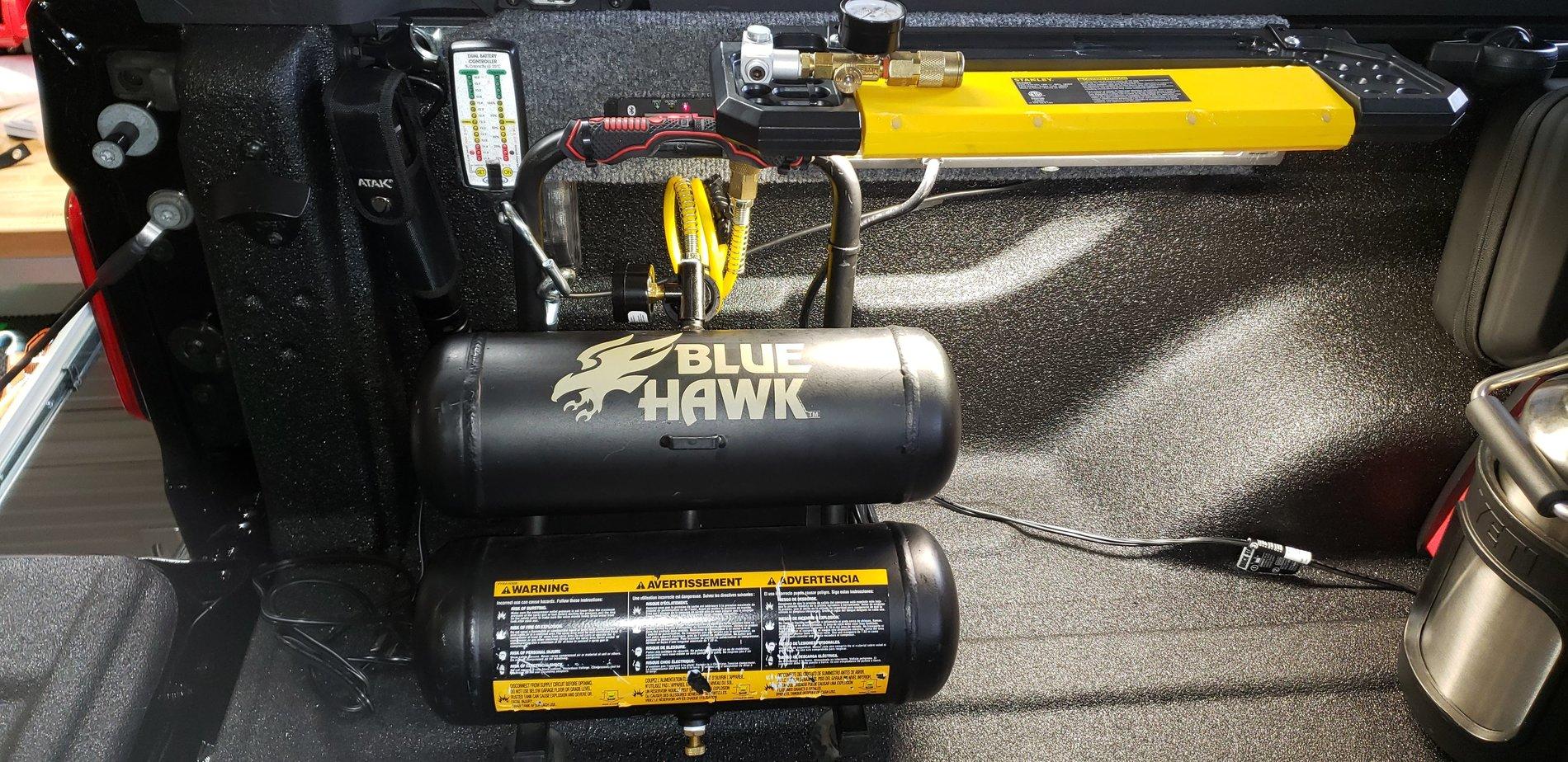

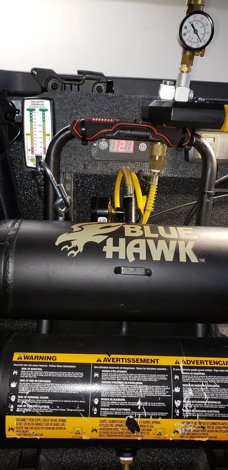

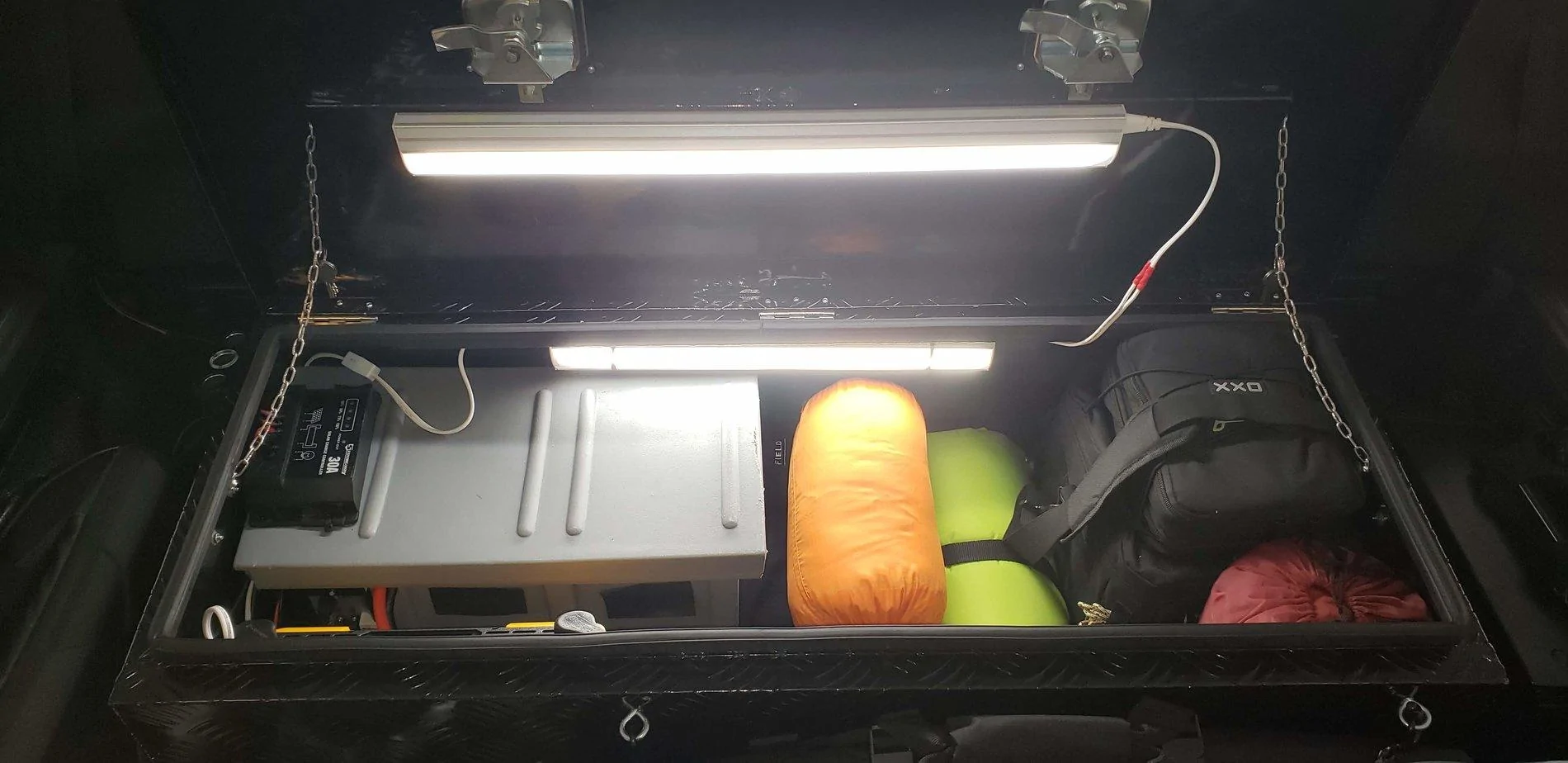

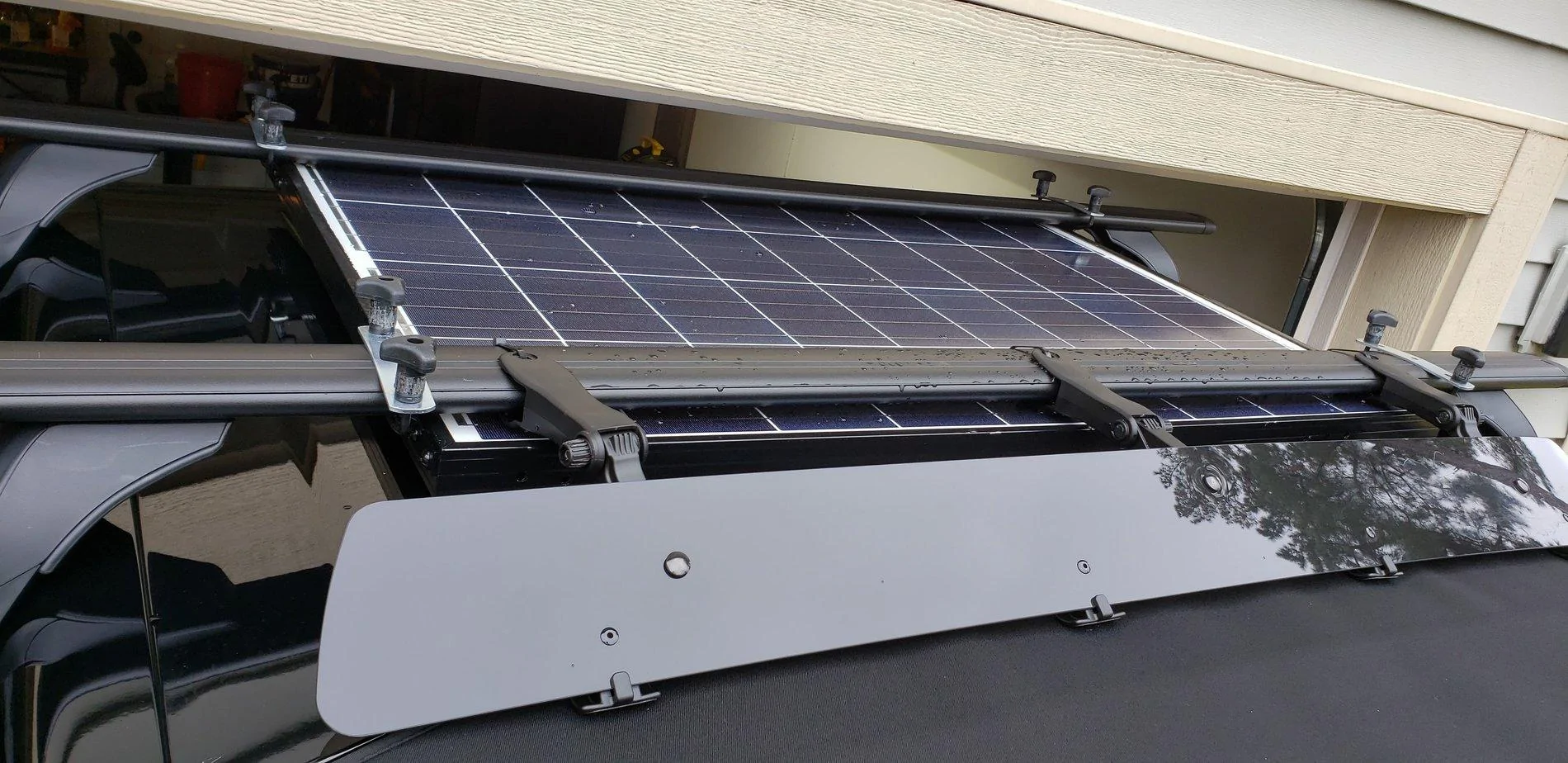

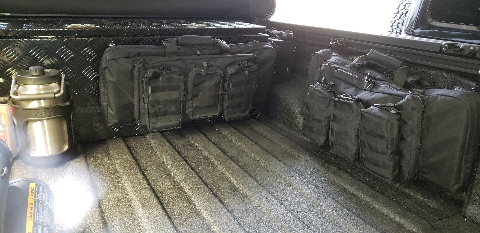

I did a lot of work on the Gladiator this weekend. Here is the list:
  1. I painted the aluminum edges and the bottom of my 100 watt solar panel black and installed it on my roof rack crossbars. I bought this from Sams Club and had it installed previously on the JK that was replace by my JT

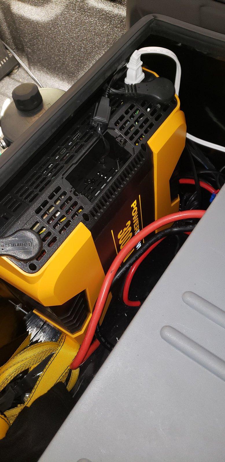

  2. I installed a black aluminum storage box to hold my 2nd battery, 3000 watt inverted, solar panel controller and other gear.42"x18"x16" Aluminum Pickup Truck Bed Trailer Key Lock Storage Tool Box (Black) https://www.walmart.com/ip/42-x18-x...ler-Key-Lock-Storage-Tool-Box-Black/693103375 Dual Battery Kit https://www.equipt1.com/products/portable-power-pack?_pos=6&_sid=1d379866f&_ss=r, Dual Battery Controller https://www.equipt1.com/products/dual-battery-controller?_pos=2&_sid=1d379866f&_ss=r, 3000 watt inverter https://www.amazon.com/gp/product/B00VPYV78E/ref=ppx_yo_dt_b_asin_title_o02_s00?ie=UTF8&psc=1

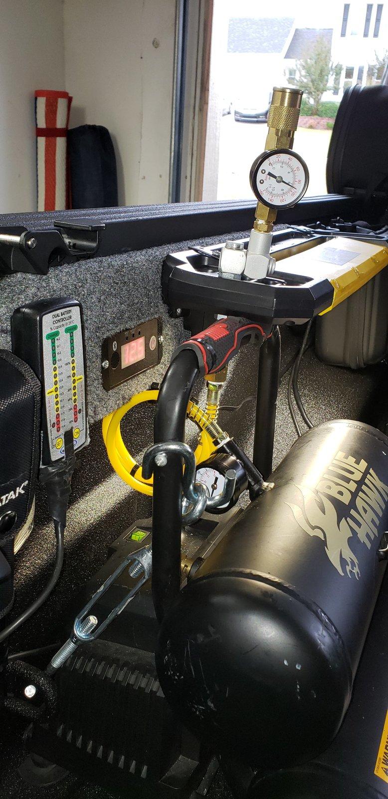

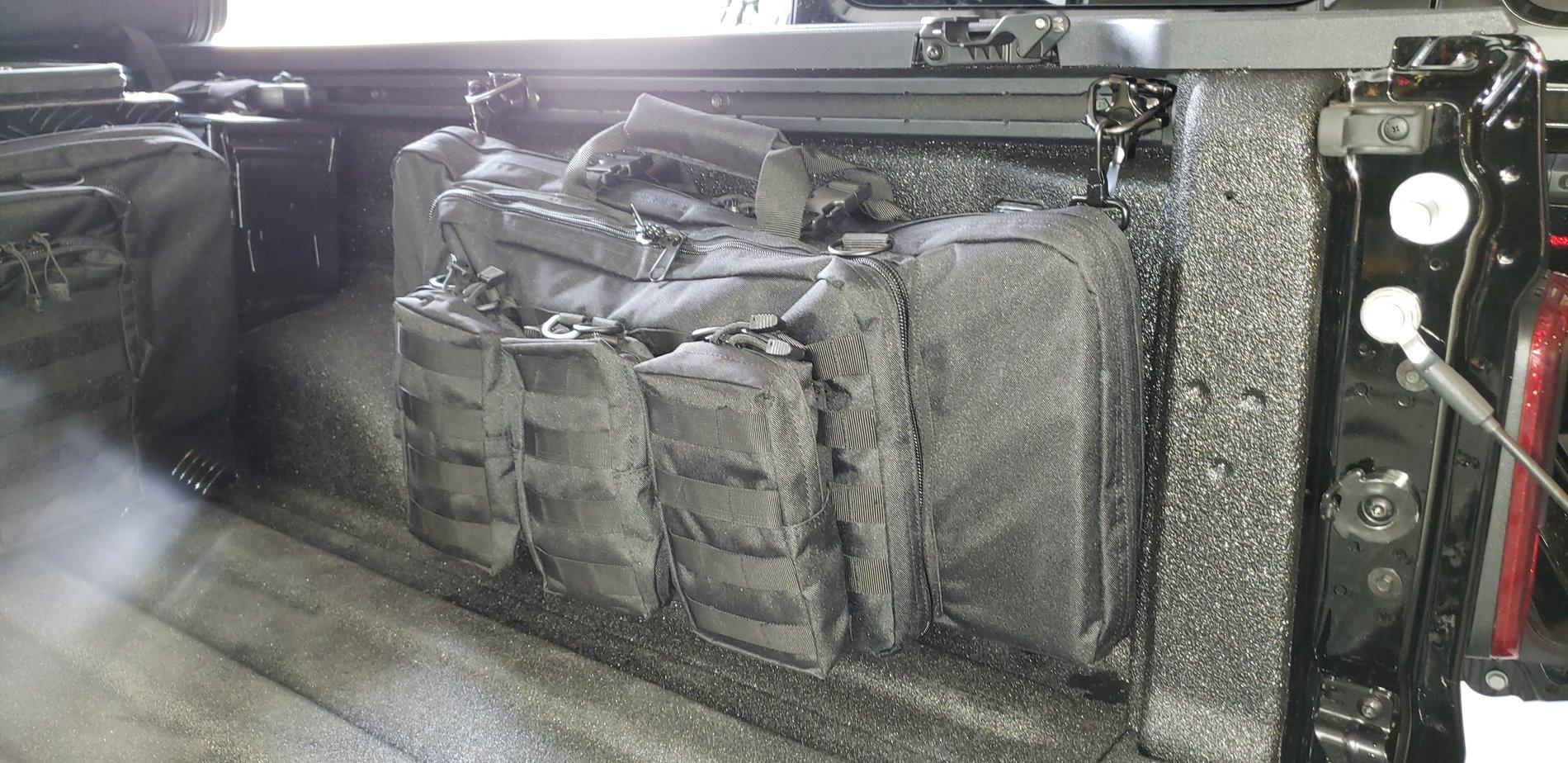

  3. I mounted the my air compressor, Yeti Gallon jug, https://www.amazon.com/YETI-Mountin...gallon+jug&qid=1571707522&s=automotive&sr=1-1 , https://www.amazon.com/YETI-COOLERS...7C2WKKK3443&psc=1&refRID=XDMJR82S07C2WKKK3443, tool box (Black Ammo can) and my 4000 amp Lithium Ion jumper. https://www.amazon.com/NOCO-GB150-U...8BTKP0MDY5Z&psc=1&refRID=3T2Y5DC5V8BTKP0MDY5Z,
  4. I also Mounted by Yeti bucket.

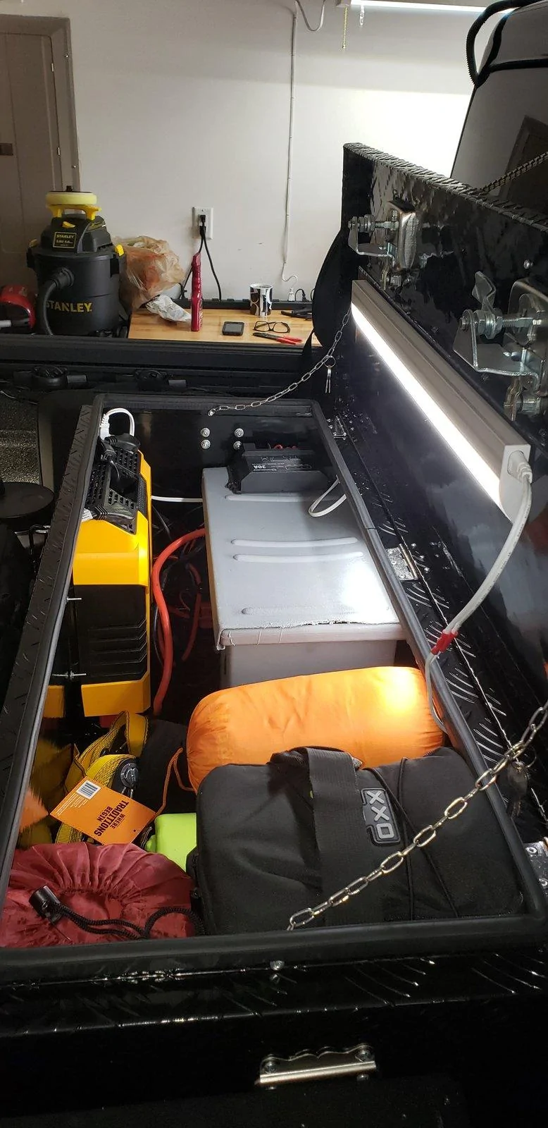

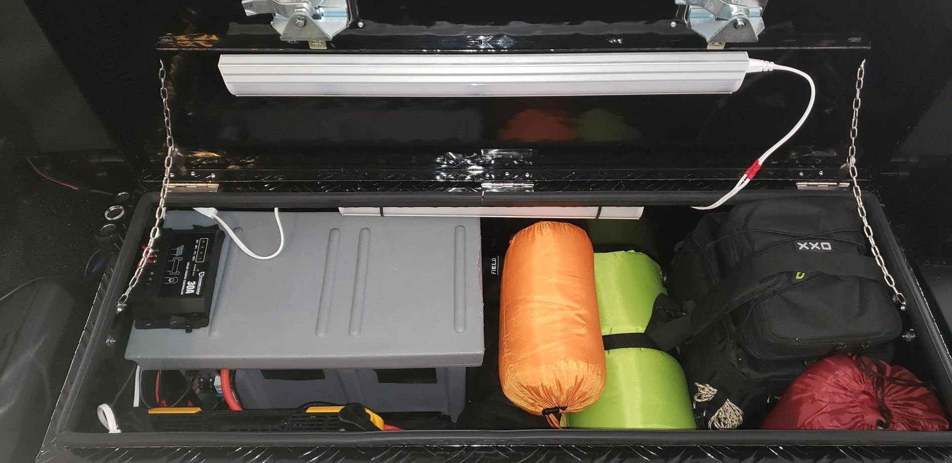

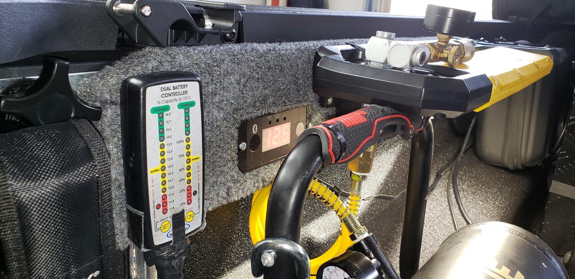

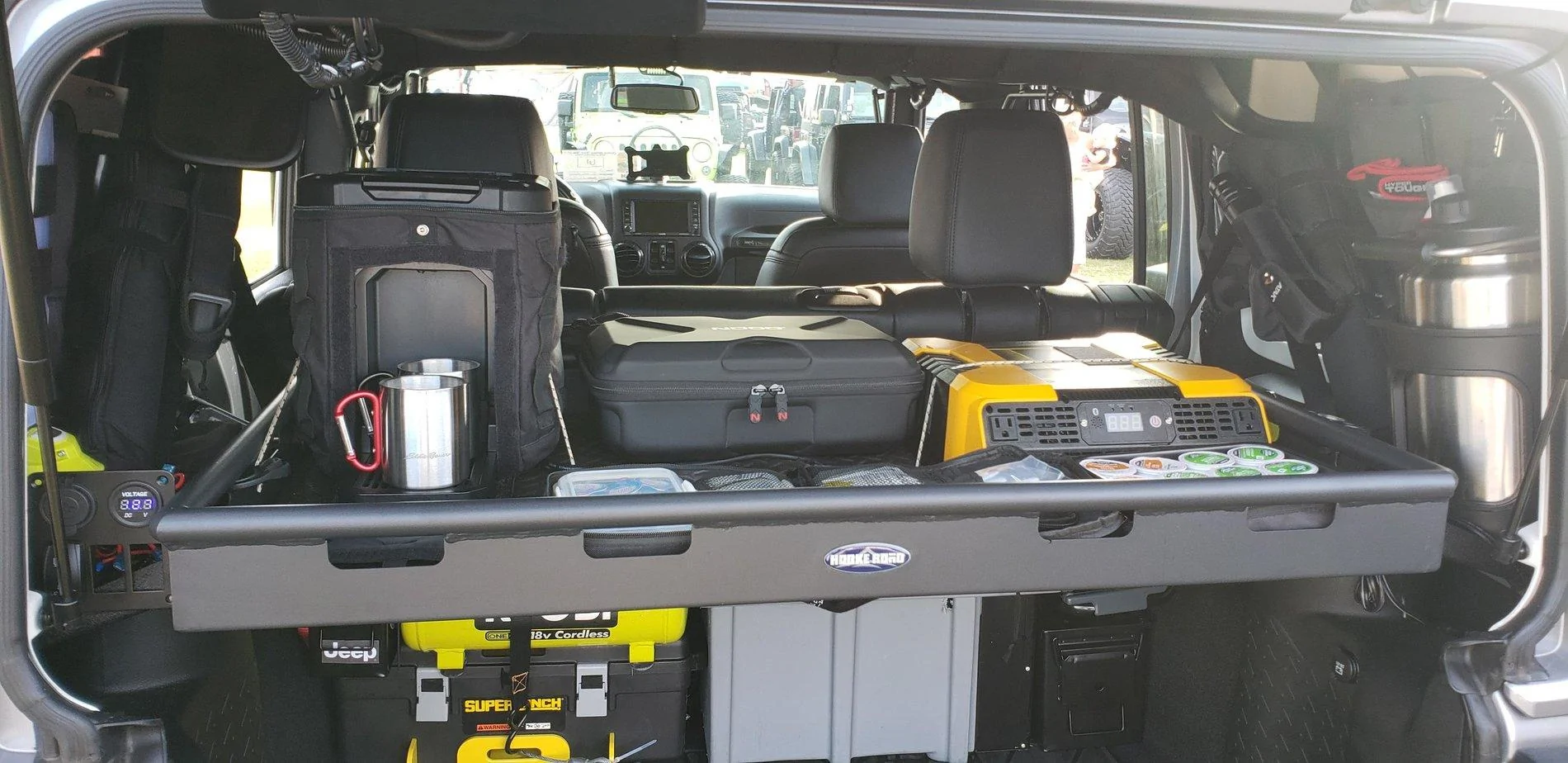

Sure Here is my Dual Battery Setup.
Portable Battery Box with built in controller : https://www.equipt1.com/products/portable-power-pack?_pos=6&_sid=1d379866f&_ss=r
Dual Battery controller remote: https://www.equipt1.com/products/dual-battery-controller?_pos=2&_sid=1d379866f&_ss=r
Marine AGM Deep cycle battery: https://www.samsclub.com/p/duracell...nd-rv-battery-group-size-31dtmagm/prod3590232
100watt solar panel: https://www.samsclub.com/p/100-watt-solar-panel-gs-star-100w/prod21250405?xid=plp_product_1_1
30 AMP solar controller:https://www.northerntool.com/shop/tools/product_200660264_200660264
On board battery charger: https://www.amazon.com/Schumacher-S...argid=aud-799727667774:pla-570643182189&psc=1
3000 watts inverter: https://www.amazon.com/gp/product/B00VPYV78E/ref=ppx_yo_dt_b_asin_title_o02_s00?ie=UTF8&psc=1
My 2nd battery charges 3 ways: Alternator when vehicle is running, Solar when sunny and plugged in at the house. I had this system in my Lexus LX470 during the hurricane last year and I ran my house, 4 rooms of lights, 2 refrigerators, 2 TVs, 2 Fans, and Wireless router all for 20 hours straight on a 1/2 tank of gas and brewed coffee on my portable rugged keurig which is also installed in my JT: https://www.homedepot.com/p/OXX-COFFEEBOXX-Black-Single-Serve-Coffee-Maker-CBK250B/301313771
This is it when it was in my JK its all now in the JT Black Box

Thanks! Why such a high power charger with two batteries ( or did you already have this)?
Tell me about the wiring - did you run both hot and ground from the engine compartment? What gauge wire did you use? And lastly how did you get the wire into the bed?
I’m sure I’ll have a few more questions for you - I appreciate your information for sure

The kit came with 20 feet of 4 gauge black and red wiring with 100 amp fuse and Anderson plug to connect to the battery controller check the links they have all the details. I ran it under the JT and there is a hole with a plug in the lower right and left bottom of the rear wall of the truck bed. I choose a large controller for expand-ability, additional panels if needed, fridge etc...

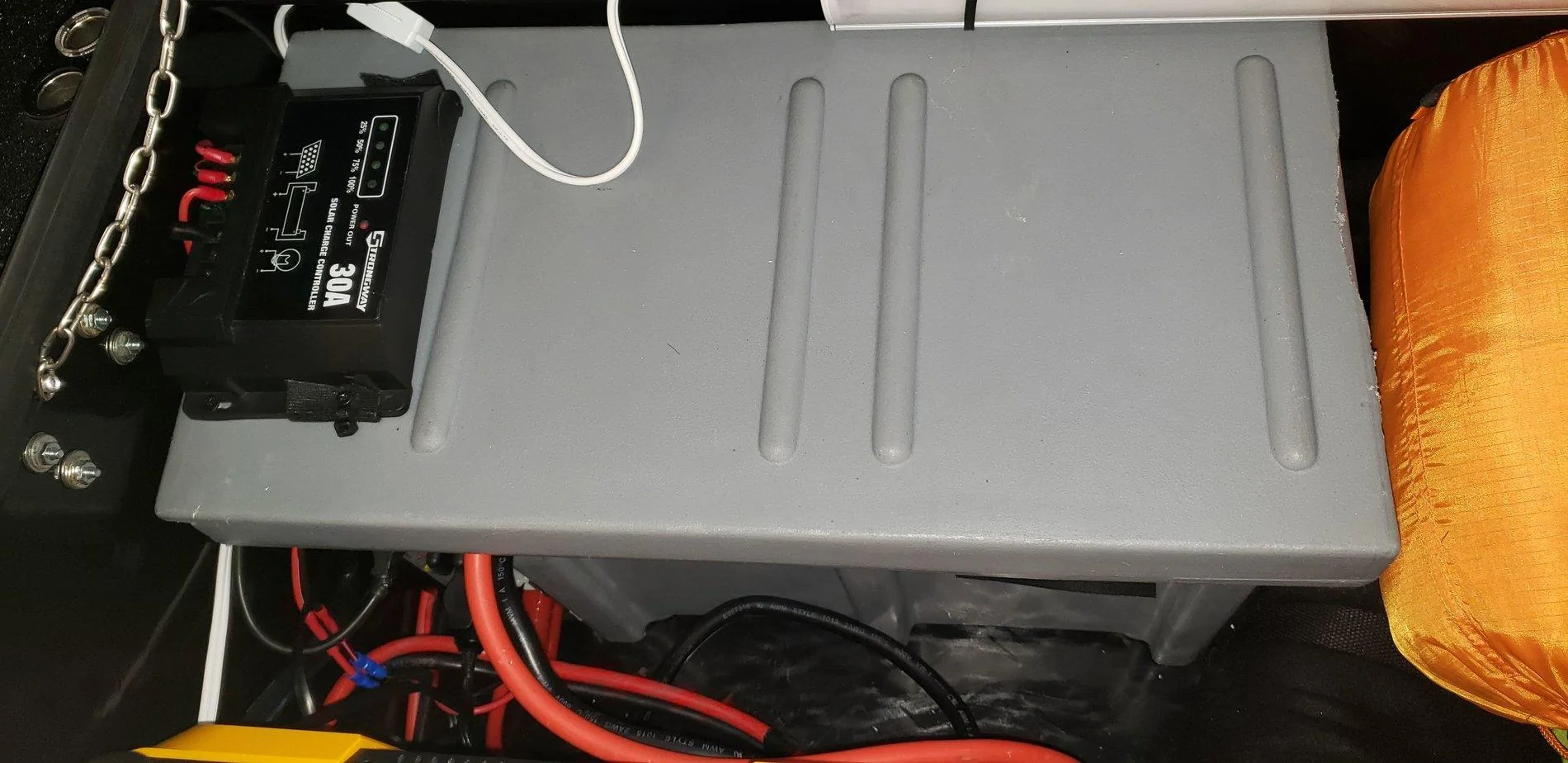

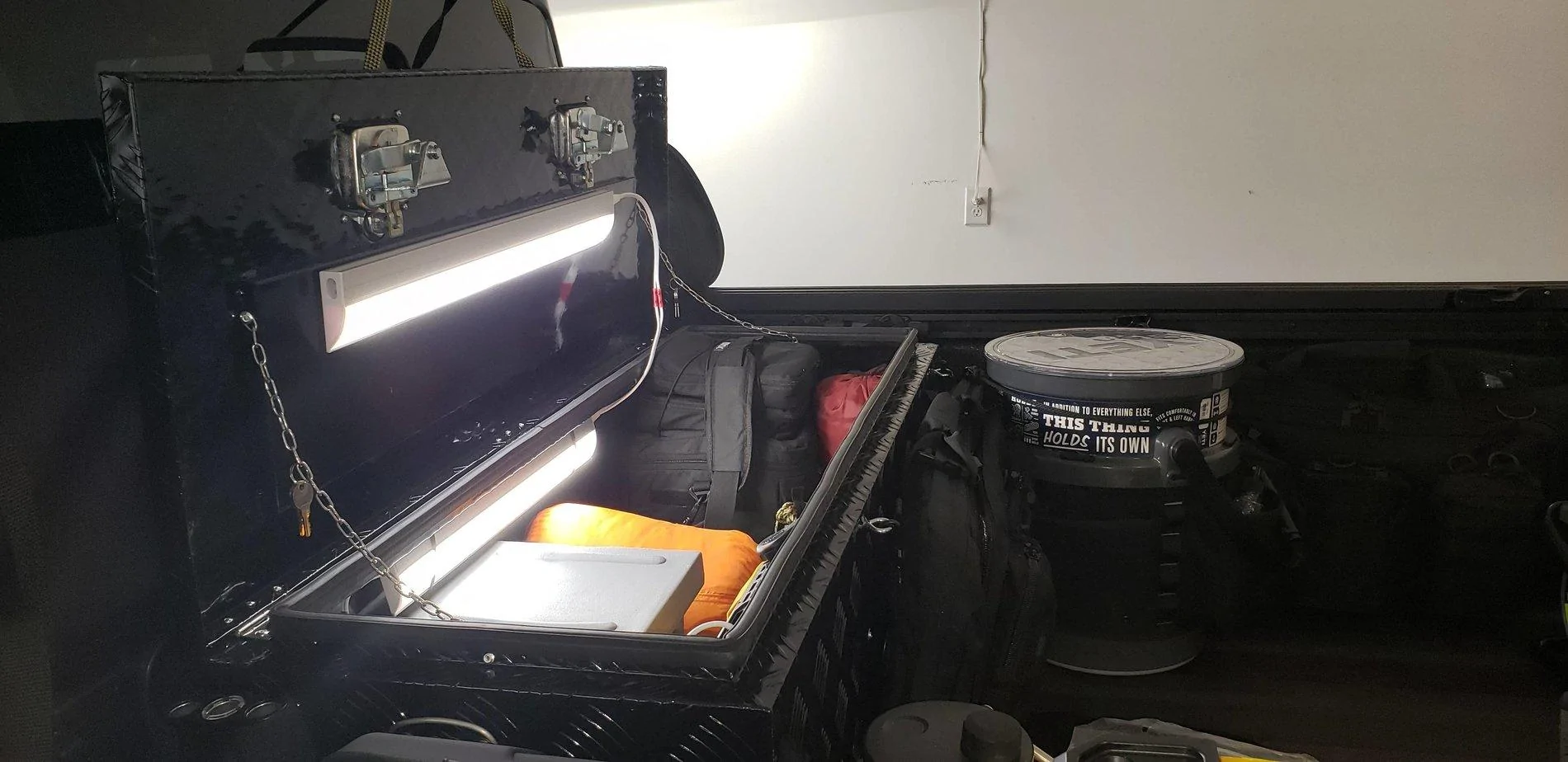

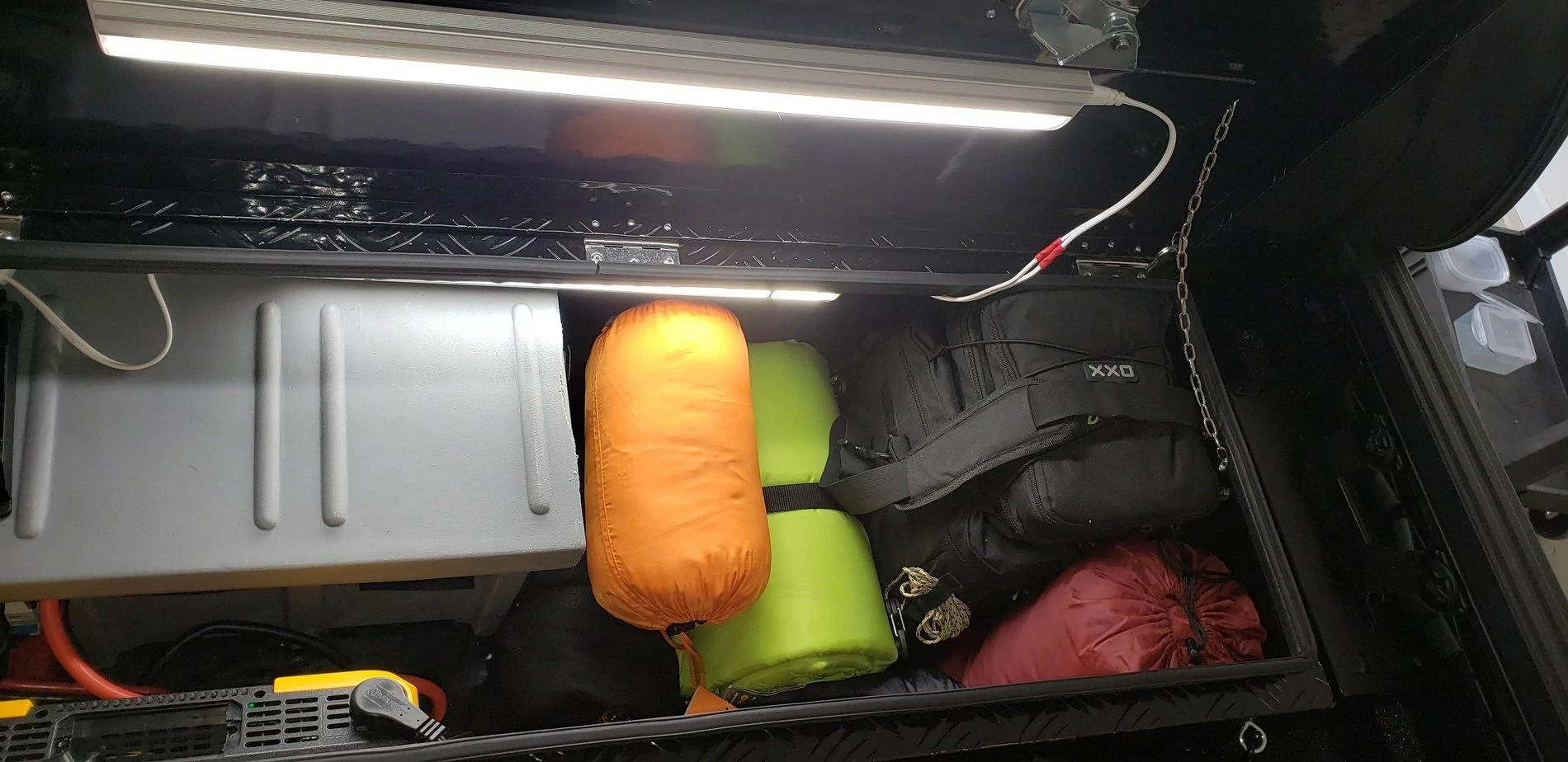

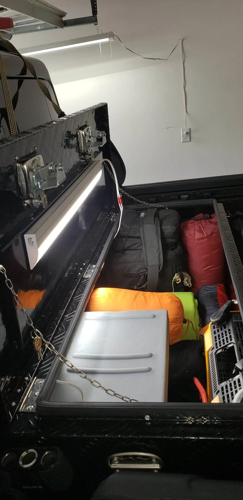

Here is a look inside HOOAH's "BLACKBOX" After all we have all wondered whats really inside the black box.
Jeep Gladiator Gladiator Launch Edition build 20191022_123855
Jeep Gladiator Gladiator Launch Edition build 20191022_123907
Jeep Gladiator Gladiator Launch Edition build 20191022_123915
Jeep Gladiator Gladiator Launch Edition build 20191022_123927
Jeep Gladiator Gladiator Launch Edition build 20191022_123933
Jeep Gladiator Gladiator Launch Edition build 20191022_124041
Jeep Gladiator Gladiator Launch Edition build 20191022_124049
Jeep Gladiator Gladiator Launch Edition build 20191022_124114

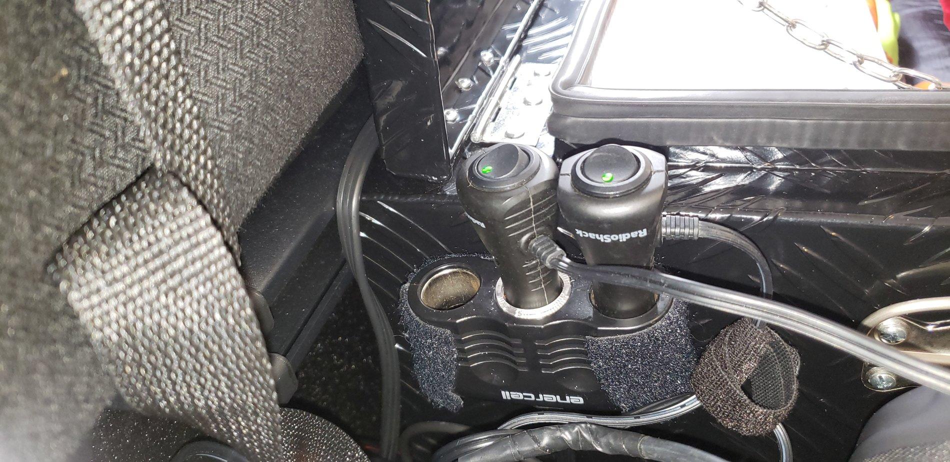

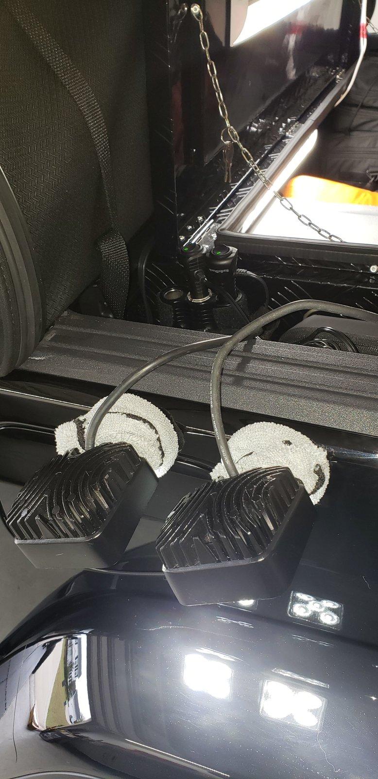

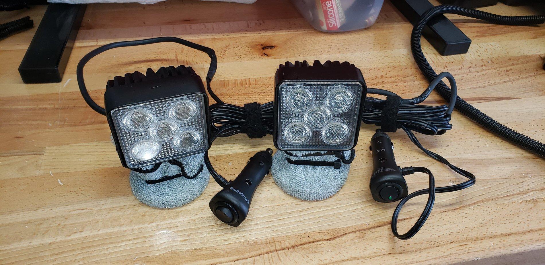

What do you get when you combine a pair of 12 volt work lights from Northern tools, A pair of switched cigarette lighter adapters from Radio Shack, I microfiber tower, a couple of zip ties and a pair of heavy duty magnets from Home Depot? check it out.....
Jeep Gladiator Gladiator Launch Edition build 20191022_125646
Jeep Gladiator Gladiator Launch Edition build 20191022_125423
Jeep Gladiator Gladiator Launch Edition build 20191022_125337
Place anywhere lighting!!!

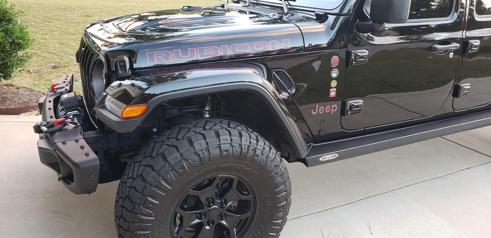

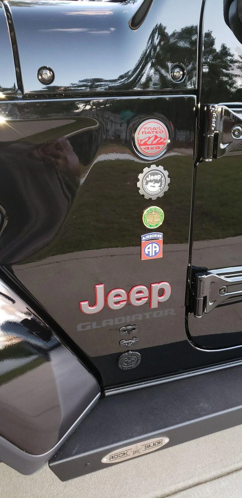

So I decided to go a different route when it comes to badges for my JT. I spent many years in the military doing the craziest shit, stressing my body to earn badges (and the added pay and promotions that go with them of course). To the point that at 54 years old my knees and back remind me daily of the 50 times I jumped out of aircraft with full combat gear or repelled out of helicopters head first or damn near a year in combat with the 82nd Airborne Division and almost 3 years as a Drill Sargent. Along with countless 12 mile road marches and PT in boots. Or a year as the point man for the SRT (Special Reaction Team = Military SWAT Team). Those memories, along with the associated aches and pains, represent the proudest, most demanding yet exhilarating times of my life. So I decided to display those badges. I do hope to hit the trails soon and earn real Jeep badges. Which I will proudly display right along side these. HOOAH!

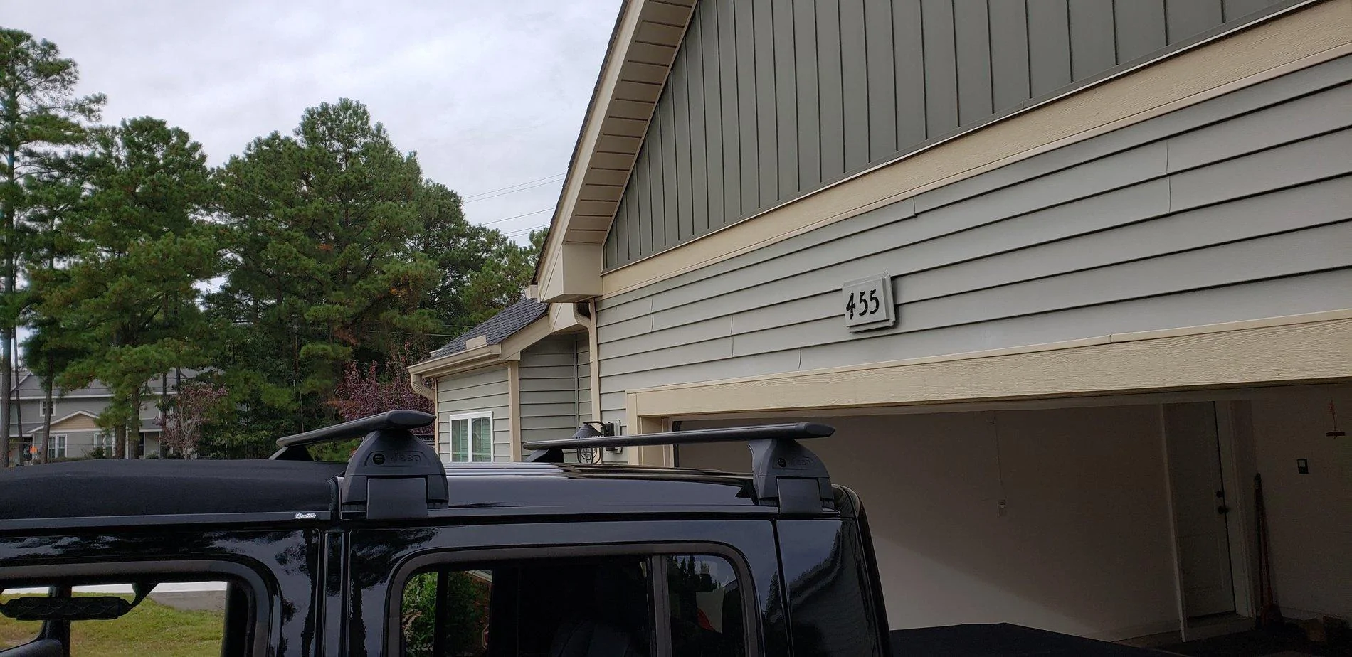

Do you happen to know the centerline distance between your cross rails? I am trying to figure out some solutions to hauling all of my toys... I have cross rails on my GC that I can take off before trading it in, I'd just need to get new attachments. Thinking this could be the best way to haul my SUPs or 10 ft Kayaks if I have the bikes on the back.
Great build - looks awesome! Thanks.

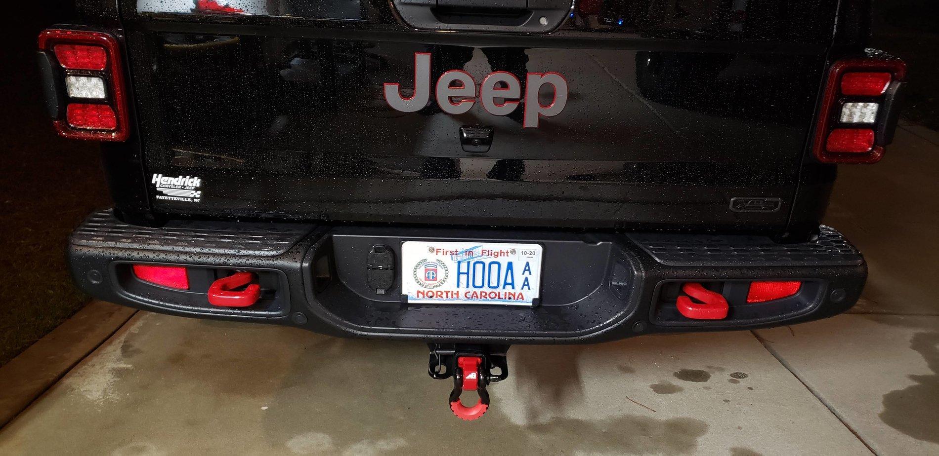

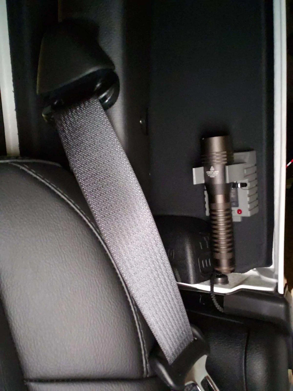

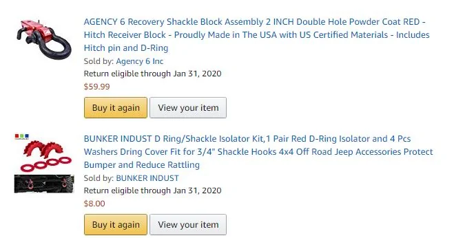

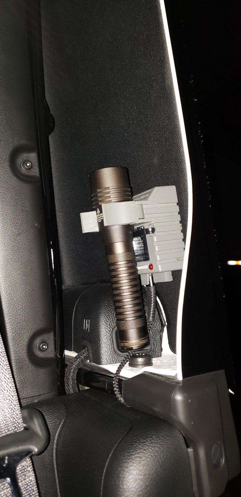

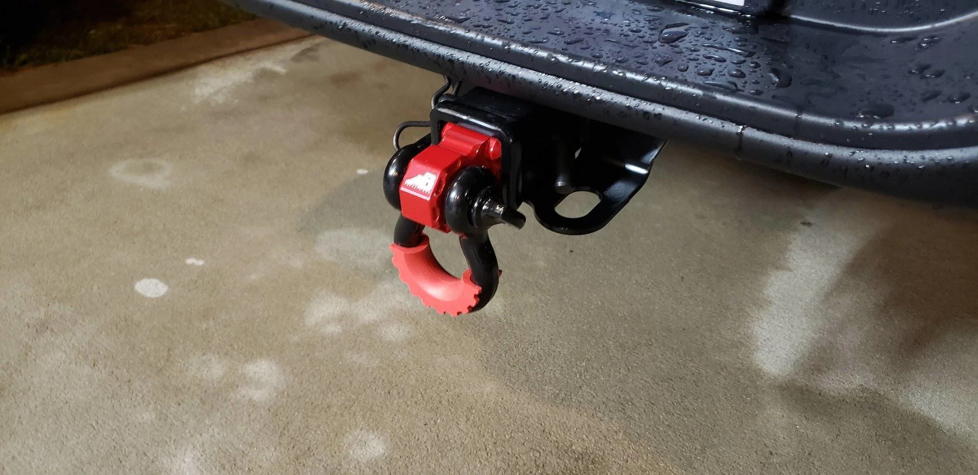

I added a few more small but functional additions.
1) AGENCY 6 Recovery Shackle Block Assembly 2 INCH Double Hole Powder Coat RED - Hitch Receiver Block - Proudly Made in The USA with US Certified Materials - Includes Hitch pin and D-Ring.
https://www.amazon.com/gp/product/B07PPB6QWF/ref=ppx_yo_dt_b_asin_title_o02_s00?ie=UTF8&psc=1
2) BUNKER INDUST D Ring/Shackle Isolator Kit,1 Pair Red D-Ring
https://www.amazon.com/gp/product/B07K84K6DL/ref=ppx_yo_dt_b_asin_title_o02_s00?ie=UTF8&psc=1
3) Streamlight rechargeable flashlight 500 lumens
https://www.amazon.com/Streamlight-...flashlight&qid=1573183804&s=automotive&sr=1-3
Jeep Gladiator Gladiator Launch Edition build 20191107_221541
Jeep Gladiator Gladiator Launch Edition build 20191107_221551
Jeep Gladiator Gladiator Launch Edition build 20191107_221616
Jeep Gladiator Gladiator Launch Edition build 20191107_221638
Jeep Gladiator Gladiator Launch Edition build amazon
