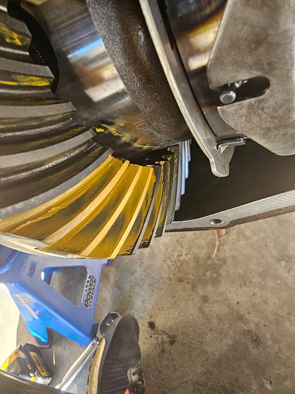

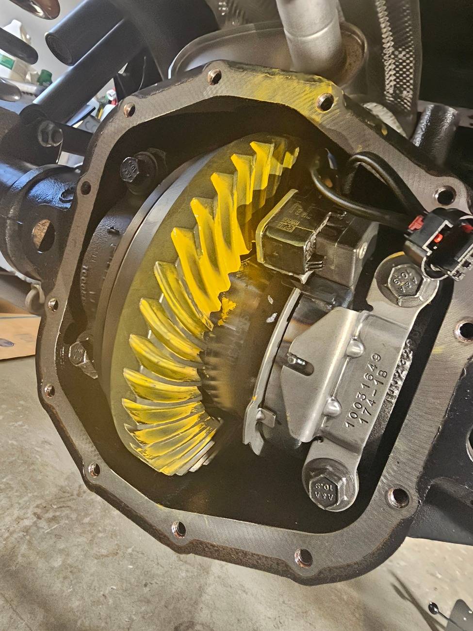

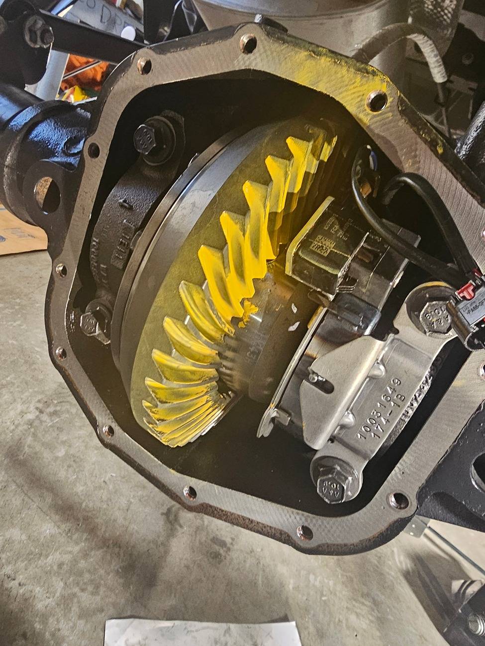

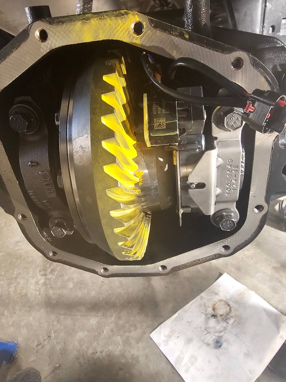

I think it's really close. Hard to tell. Looks like the pinion might need to go deeper on both. Coast pattern looks pretty good.
What's the backlash at? What's the spec?
Also are you loading down the carrier when you spin it for a pattern? It needs to have some pretty stiff resistance to leave a solid pattern. Looks like maybe the backlash is a little loose or you didn't drag the carrier enough when testing.
Greg, It calls for 6-10 backlash with the Yukon gears. I'm at 6. You are correct, I did not put any drag on the carrier.

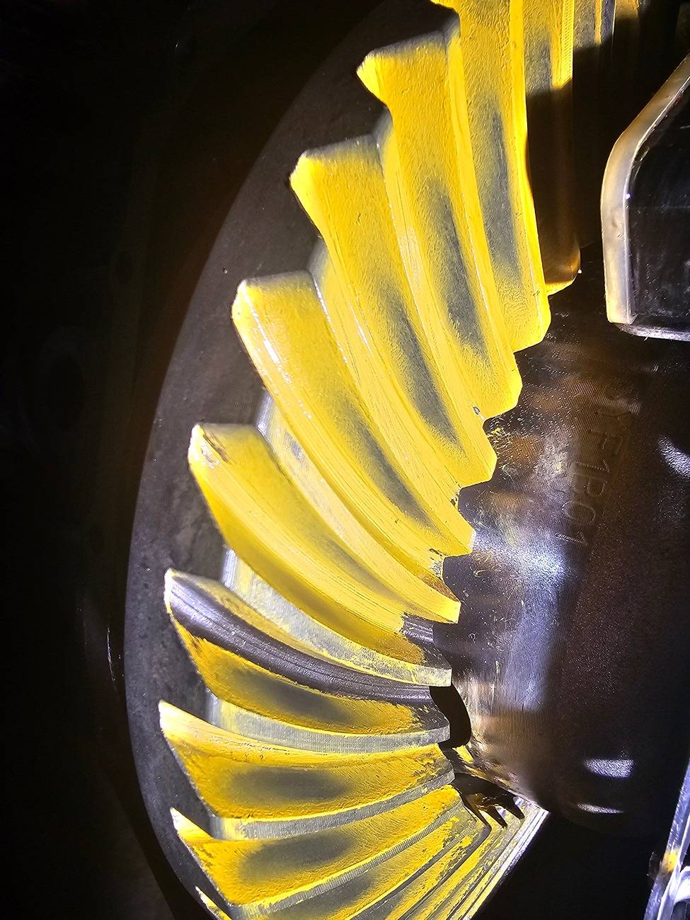

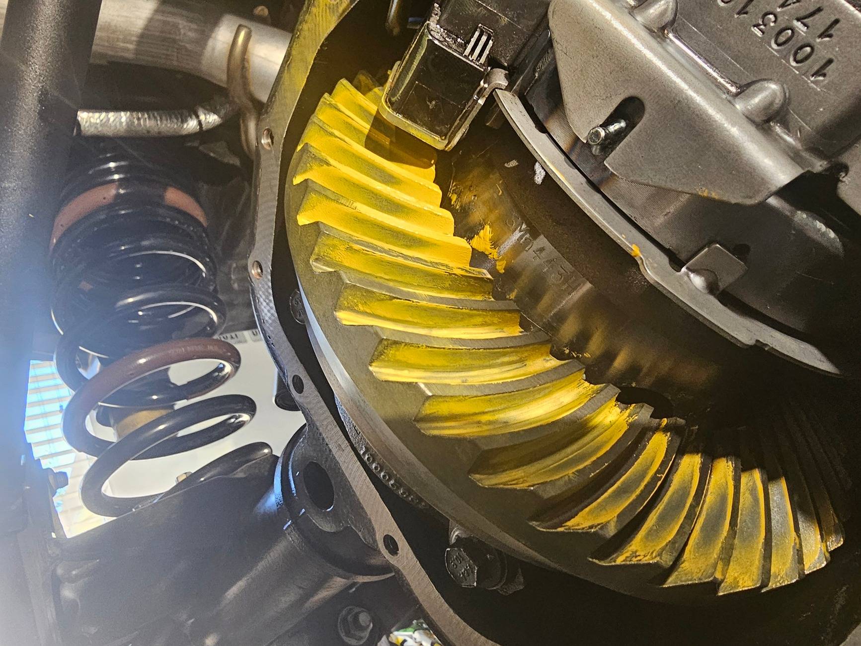

Thanks for your help. Here's a pic with pressure on the carrier applied. Enjoy the remainder of your night.

Well sir I'd say you're damn close and if those were my gears I'd run em. Nice job. That's a pretty solid looking contact pattern.
