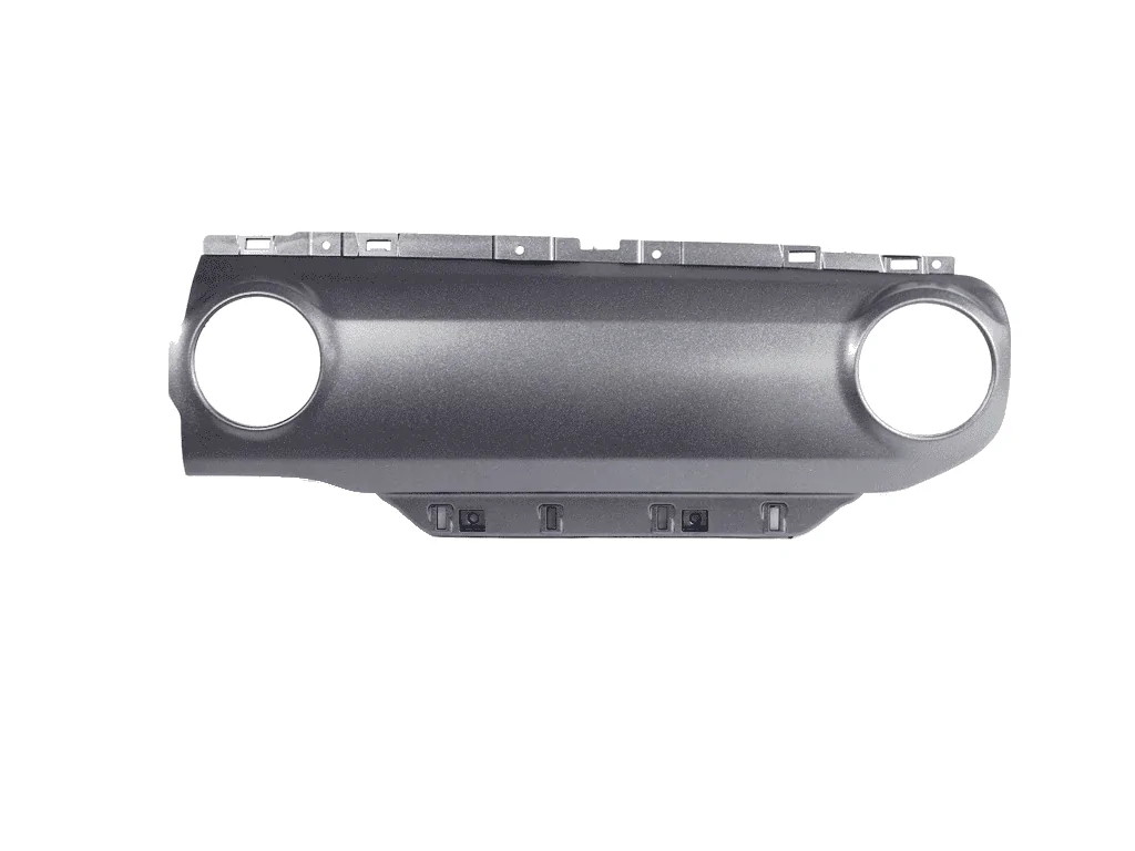

I feel like this has been asked before but I can't find the answer. Are the Grey Dash Panel trim kits from the Mojave available to order? I would like to swap out the red on a Rubicon JL.

Hi Matt,
You can find these here
https://parts.allmoparparts.com/oem-parts/mopar-passenger-air-bag-door-6zq36wayaa
https://parts.allmoparparts.com/oem-parts/mopar-instrument-panel-bezel-6zq37wayaa
We will add them to the first post.
Photo for reference
Jeep Gladiator Gladiator Mojave Part Numbers # List 1675988970590
Please let me know if you have any other questions.

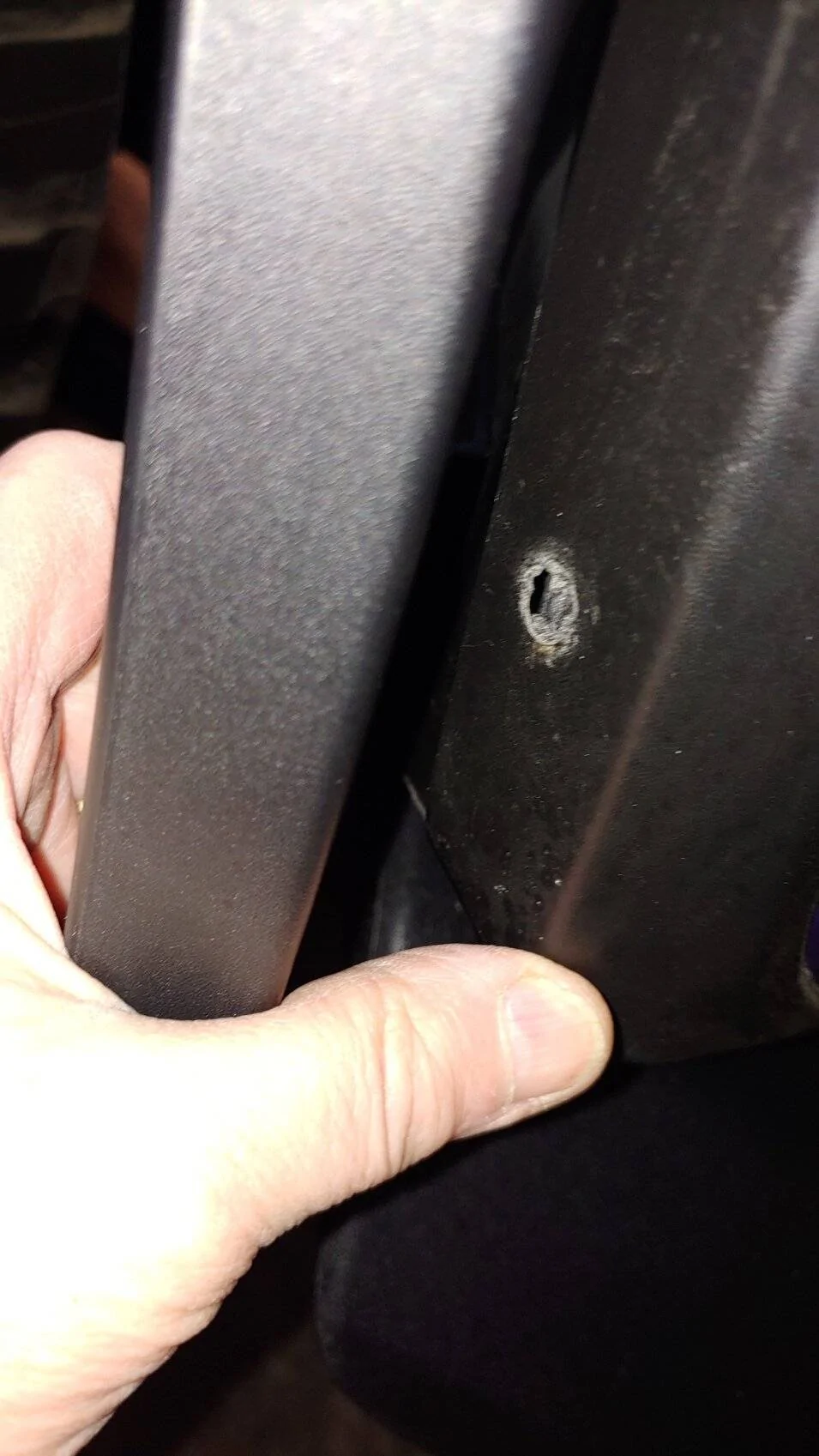

I made a mistake today - I assumed. COLD air coming in as I speak, temps dropping through the day, storm headed in and my wife wants her Jeep for doctors and other stuff tomorrow.
So I bundle up, position her JLU Rubicon 4xe so I can get all the way around it, turn the wheels hard left and proceed to drill out POM rivets and cut the christmastree retainers in preparation for the genuine MOPAR splash guards that came at 7pm last night.
The splash guards are clearly marked PHEV. Cool, then they are absolutely for a PHEV Wrangler.
Nope, they aren't. Not even close.
In fact, the fronts are an exact match to the splash guards on my JT Overland! I held them up and yup.
I told my wife, sorry, honey, they aren't even close, can't even make them fit, no way at all. They are WAAAY off. I told her the fronts were a match to my JT and she asked if I had good ones on my truck - yeah, sorry, it's had them on since about 2 hours after bringing it home.
Crap, so I open the rear ones and hold them up - same thing, not even close.
And it's not a matter of steps, rock rails, or any other accessory - the shape is just all wrong. Glad I didn't pull the rear wheels off and start taking that apart.
So I wonder - was there a change for the 2023 model to make it more like the non-PHEV version?
The fronts are a perfect fit for a Gladiator Overland.

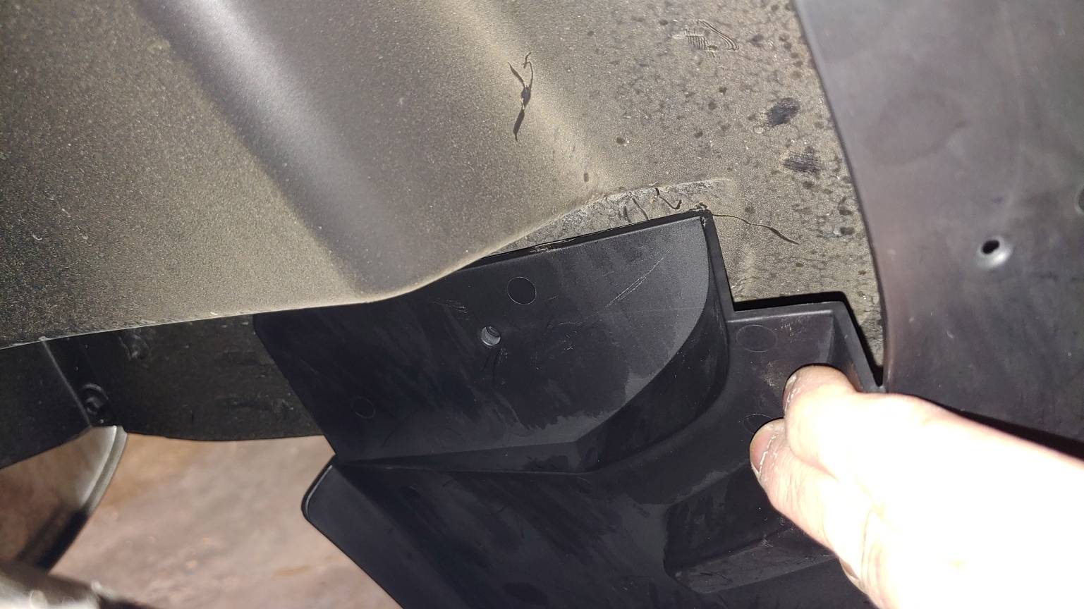

This is with the guard against the brace inside the wheel well as far back as it goes. It's not even close to touching the steps and it is way off from touching the outer part of the fender flare where the rivets go -
Jeep Gladiator Gladiator Mojave Part Numbers # List 20230215_092807
Jeep Gladiator Gladiator Mojave Part Numbers # List 20230215_092818

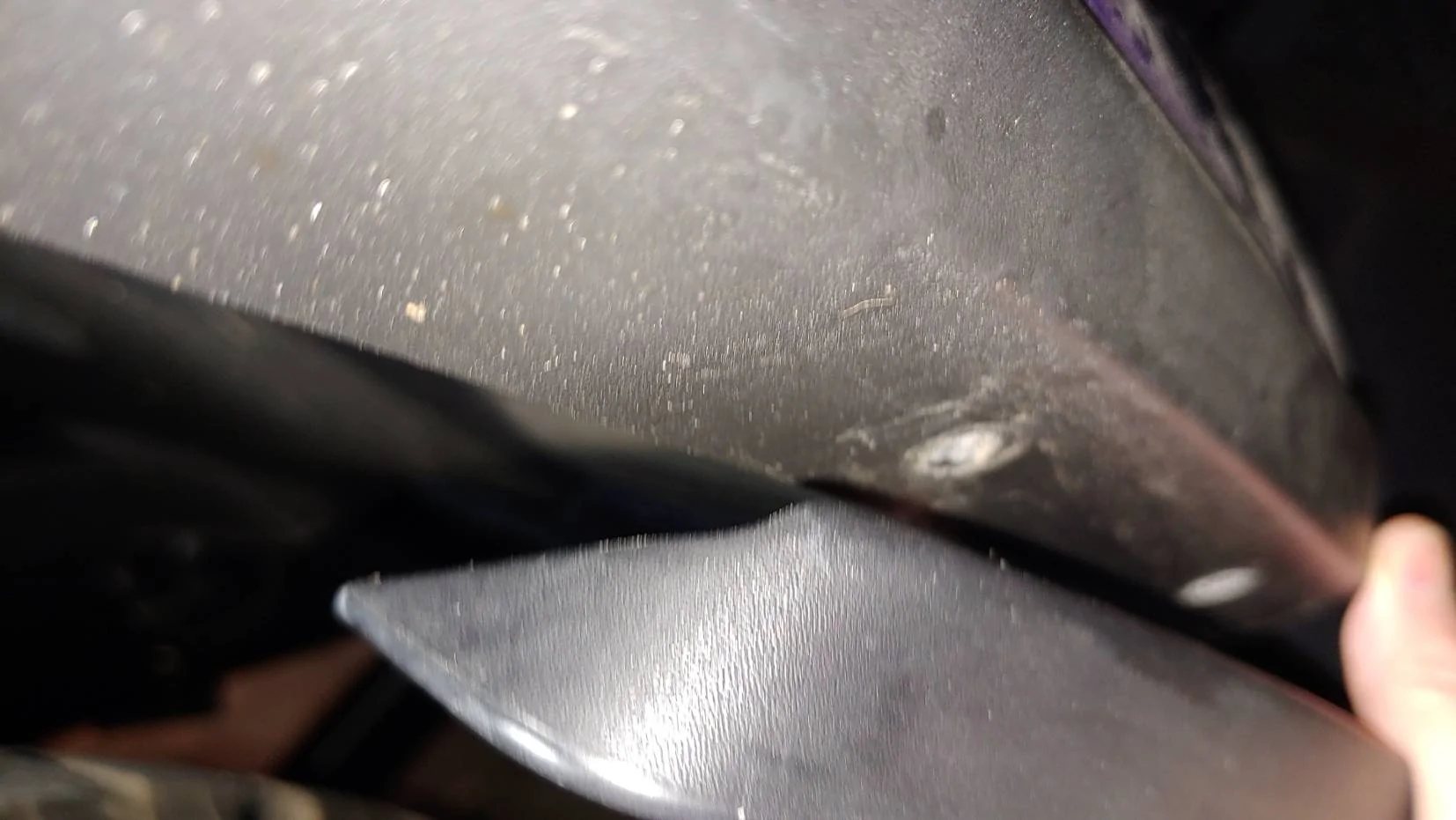

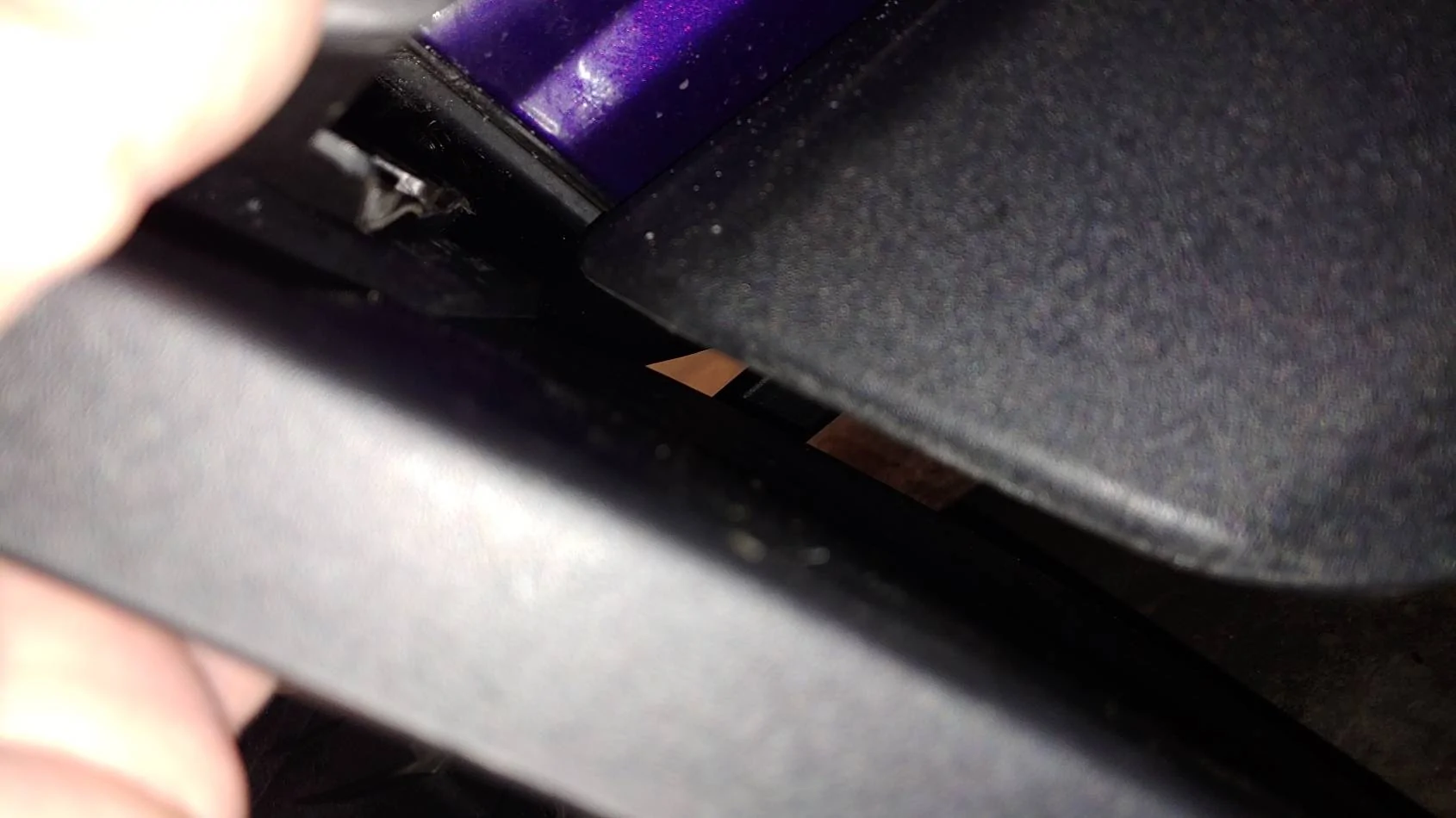

Not even close to touching edge of fender flare and the step is a good 3/4" away.
They are the wrong shape.

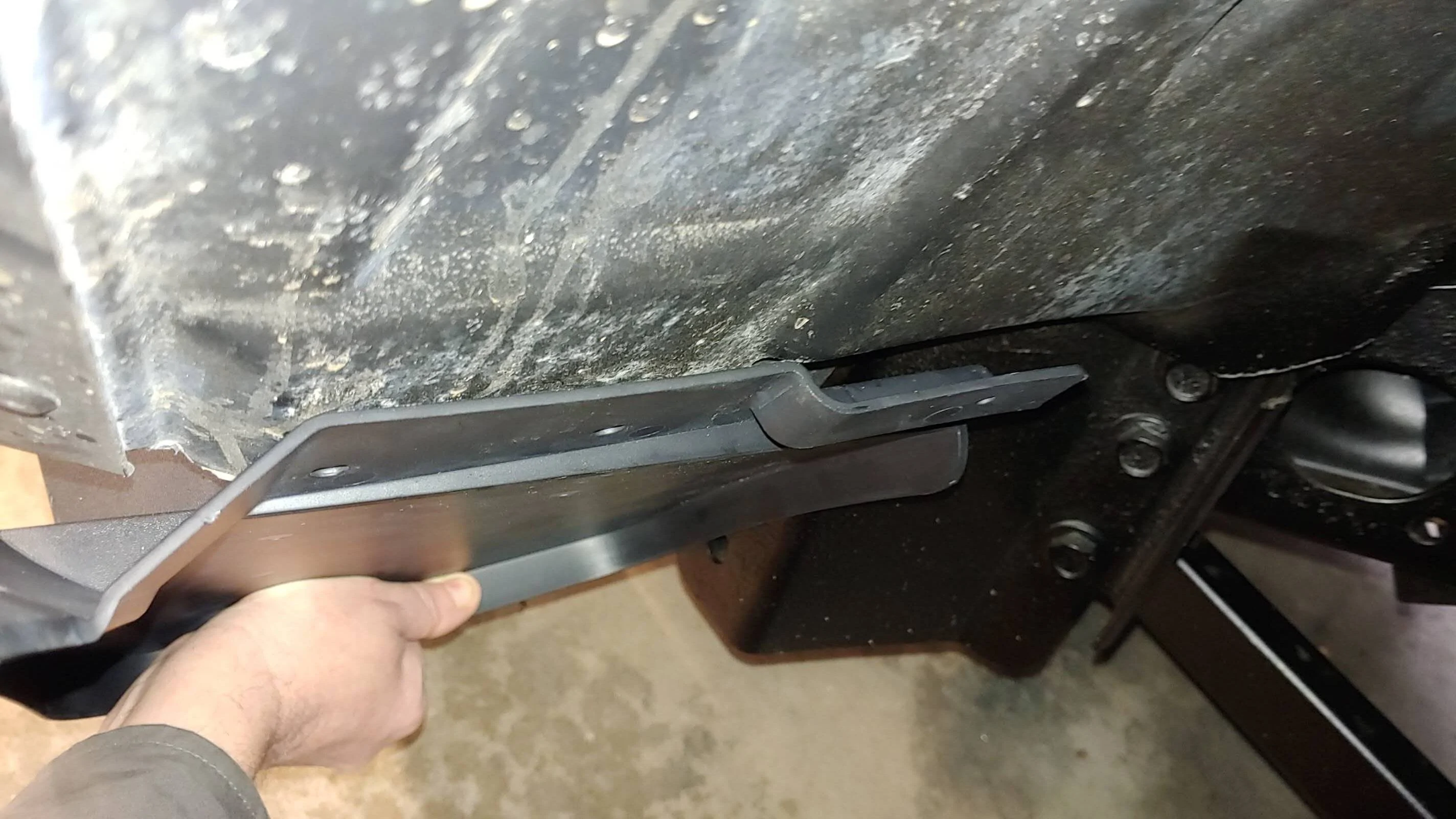

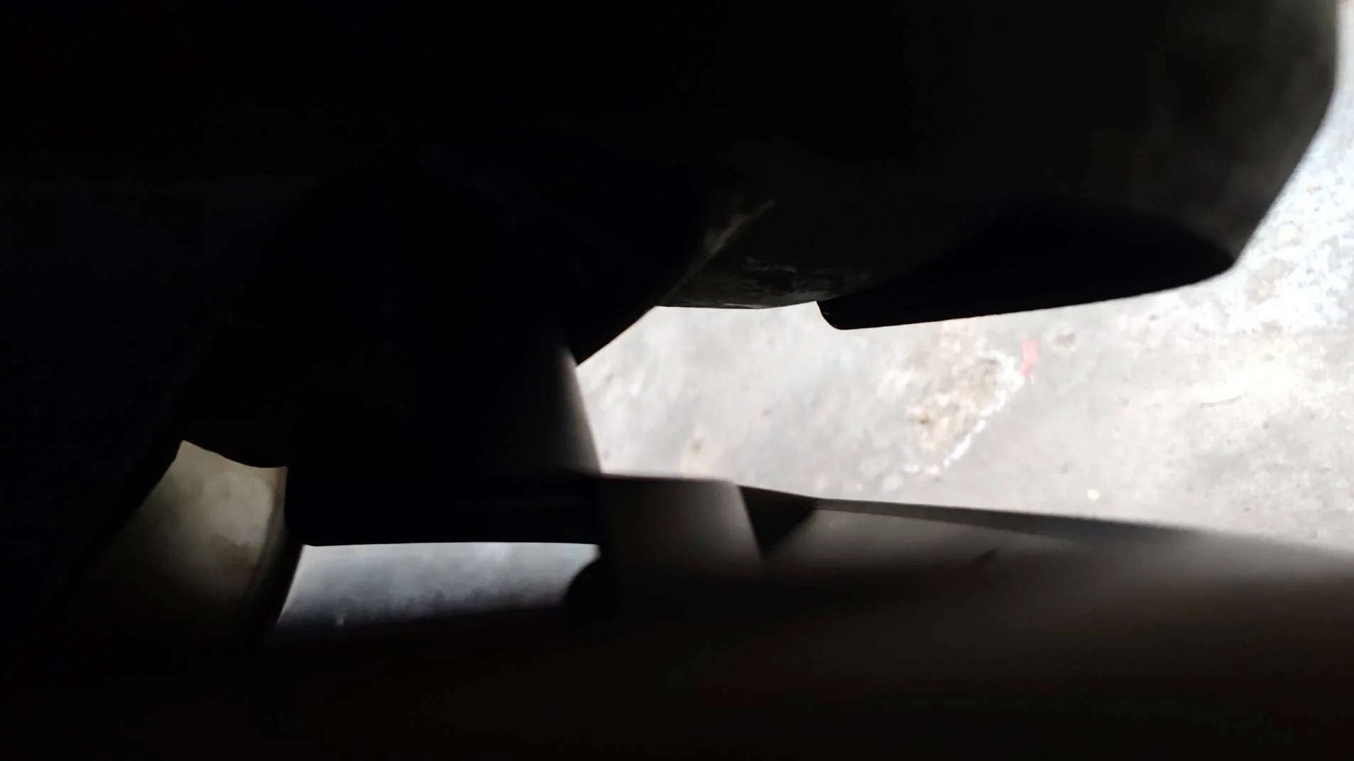

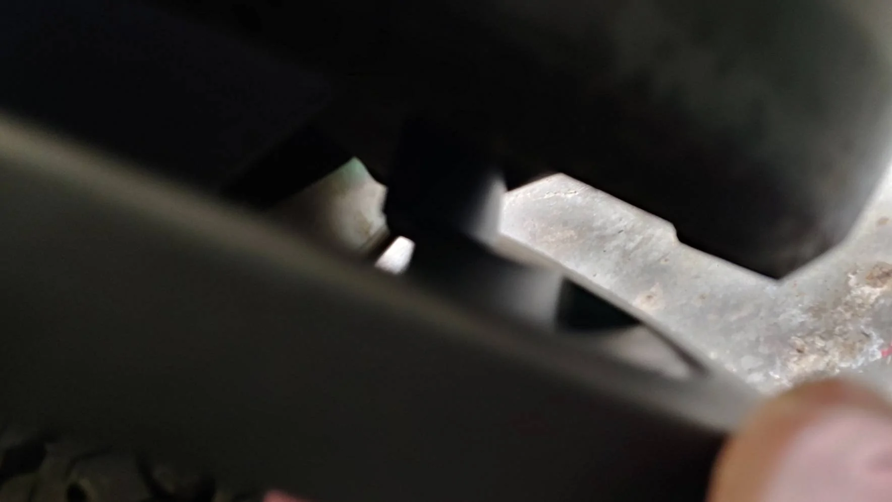

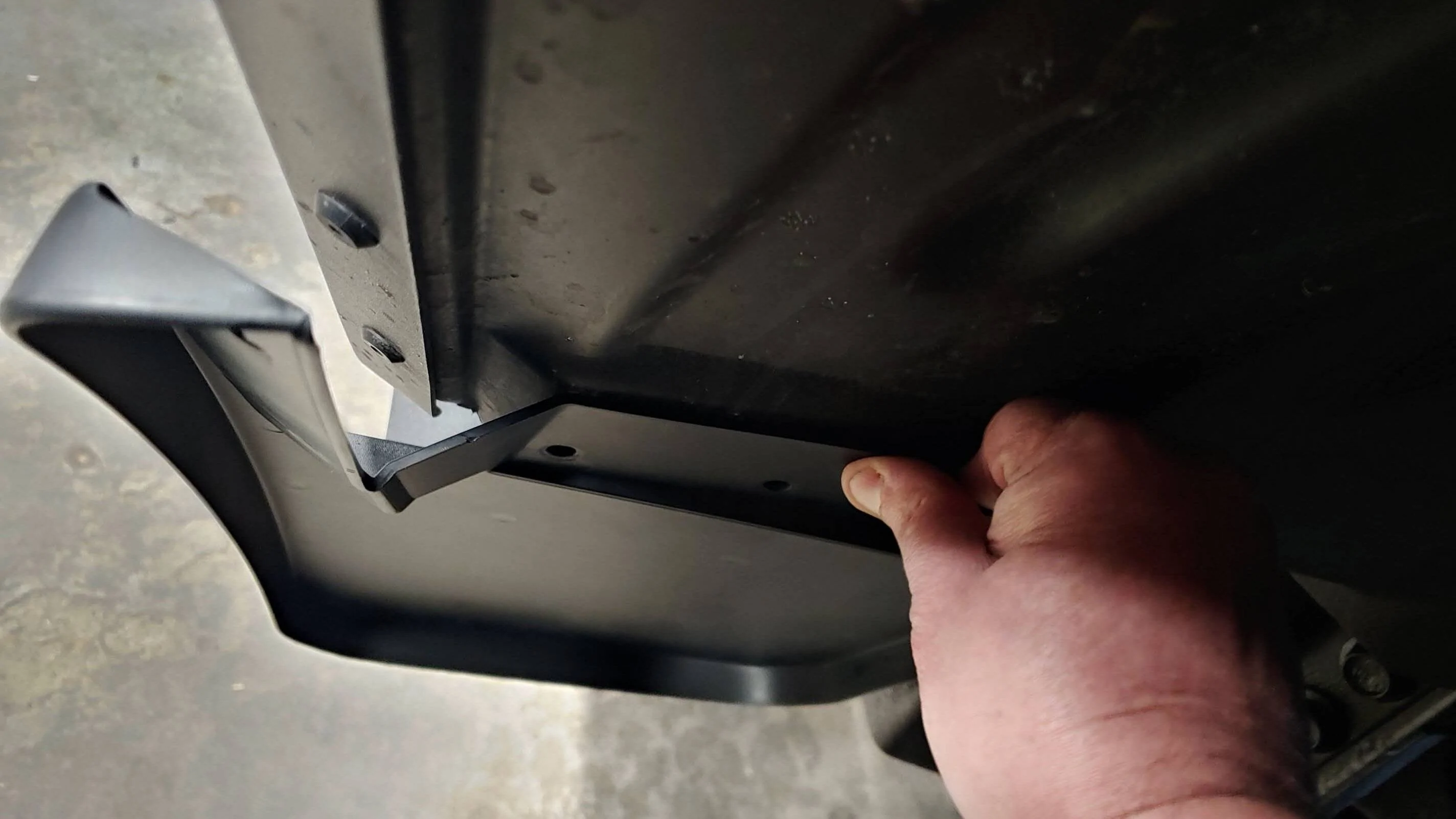

Same for the rear - if the bolt farthest into the wheel opening were installed, this is where the outer part would land -
Jeep Gladiator Gladiator Mojave Part Numbers # List 20230215_093610_HDR
Jeep Gladiator Gladiator Mojave Part Numbers # List 20230215_093635
Jeep Gladiator Gladiator Mojave Part Numbers # List 20230215_093621_HDR

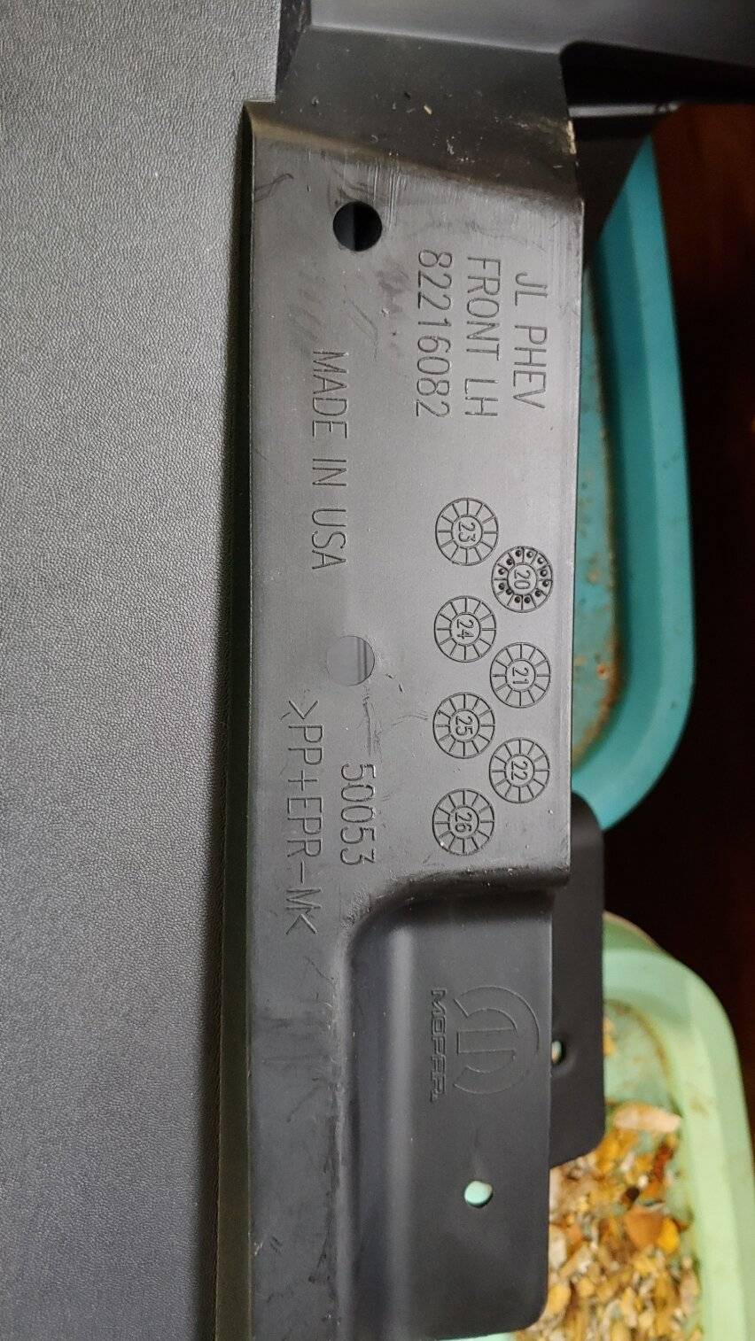

What I have found -
Fronts and rears don't fit - not even close for fronts or rears.
The fronts, 82216082 appear as if they'd be a perfect fit for a Gladiator Overland.

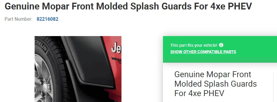

Confusing is the fact that no MOPAR parts seller on line differentiates 4xe save for one - and they give the number I got - and they say they fit ALL 4xe JLs
They say the 82216082 fit as follows -
Jeep Gladiator Gladiator Mojave Part Numbers # List 1676503059160
Jeep Gladiator Gladiator Mojave Part Numbers # List 1676503087378
When I put in 2023 Jeep Wrangler JL - this comes up. There is NO choosing Rubicon, Sahara, etc. -
Jeep Gladiator Gladiator Mojave Part Numbers # List 1676503261964

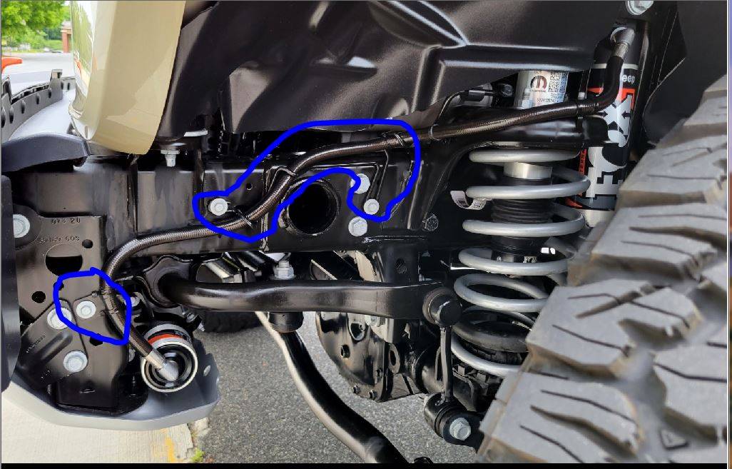

Benny, do you have any info or part numbers for the clamps and retainers for Mojave res shock hoses?
Pic

Hi Bob,
It appears that mopar is selling the shock, reservoir hoses and brackets as one entire assembly. I would try reaching out to Fox directly as this is most likely supplied from their end.
