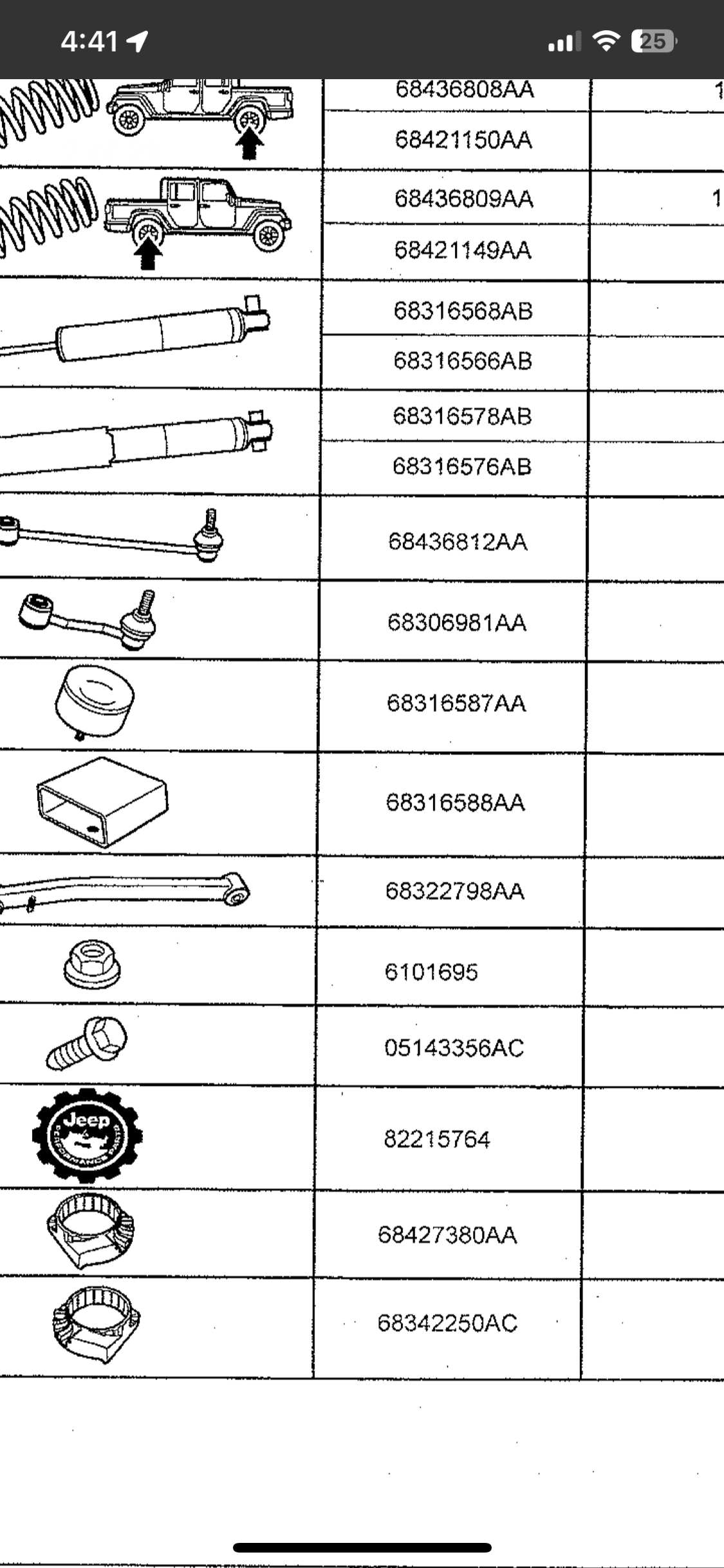

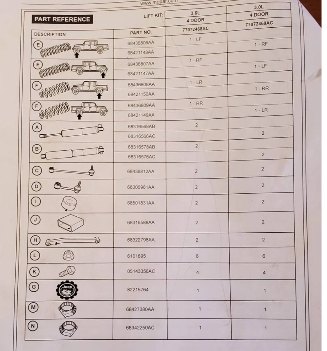

Appreciate the prompt response and information. I don't see those p/ns on my springs on a '21 JT Diesel. For example the front driver is 68421147AA and the rear driver is 68421150AA. Those don't even show on the Fox Mopar kit link. First Jeep owner here and just picked this rig up used so learning. Are these the wrong springs?
Specifically speaking of a Diesel JT we can see the same spring numbers are used across both kits as well, See below
https://www.allmoparparts.com/docs/77072396AH_77072397AH_77072468AF_77072469AF_JTBILSTEIN.pdf
https://www.quadratec.com/sites/default/files/installation_instructions/77072468AB.pdf
- Benny

Appreciate the prompt response. I found the spring part numbers I have on my JTD are from an older kit even though the dealer I just purchased this rig from used installed it recently before I purchased. Bummer it wasn't the newer kit.
P/Ns:
LF 68421147AA
RF 68421148AA
LR 68421150AA
RR 68421149AA
Either way, looks like I should be able to put the new Bilsteins to be the same as this new kit on from your analysis. Just need the Bilstein part numbers and front remote reservoir mount p/n.

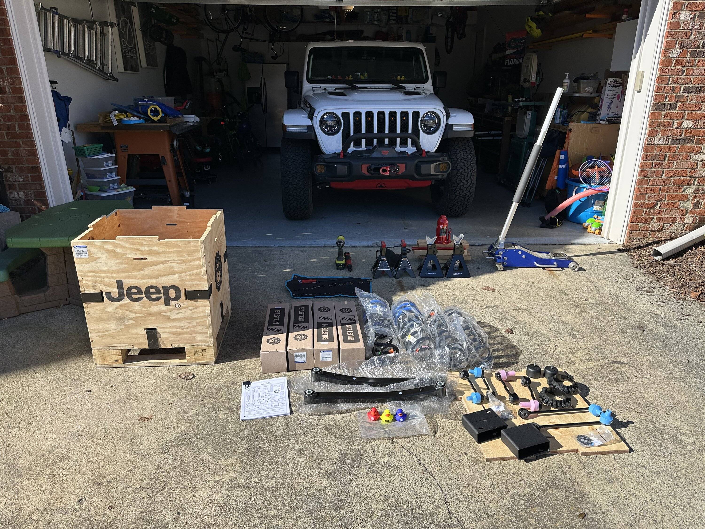

Ordered this kit from AllMoparParts for my JTR, will post pics during the installation.
