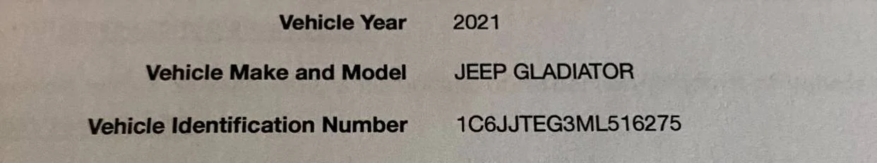

Im still not sure what transmission you have, Send me your VIN and lets start there

Thanks Mike, The tools are listed there as well. All dealers are sent these tools before a vehicle is launched but I suppose they could have been lost.

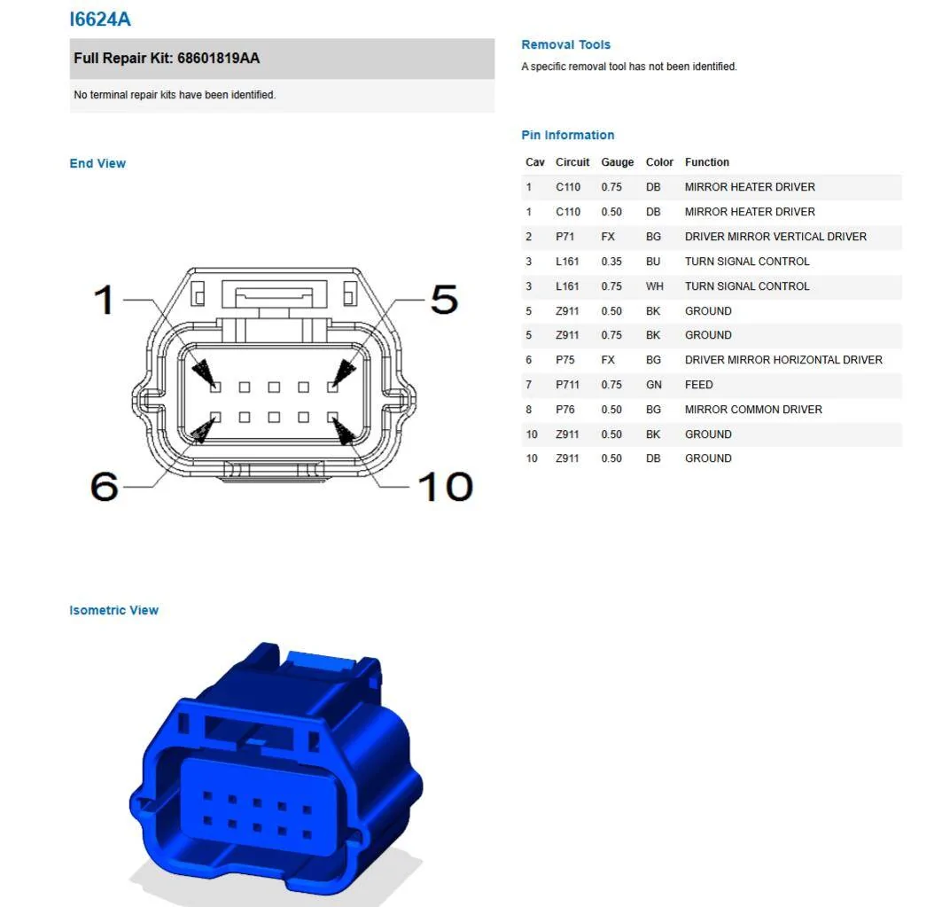

So I have installed the Boost Auto Trailer mirrors. Left mirror went well. Right Mirror not so much. While disconnecting the connector at the mirror the retaining clip that holds the connector tight broke. If I can find the part number for the connector housing only I believe I can do a pin by pin swap. Would anyone happen to know the connector housing part number for the mirror connector. This is the connector for the wire bundle that runs inside the door, and connects to the mirror assembly.
As an FYI I have Blind Spot Detection, Power Mirror, Defrost within that mirror.
Thanks in advance.
