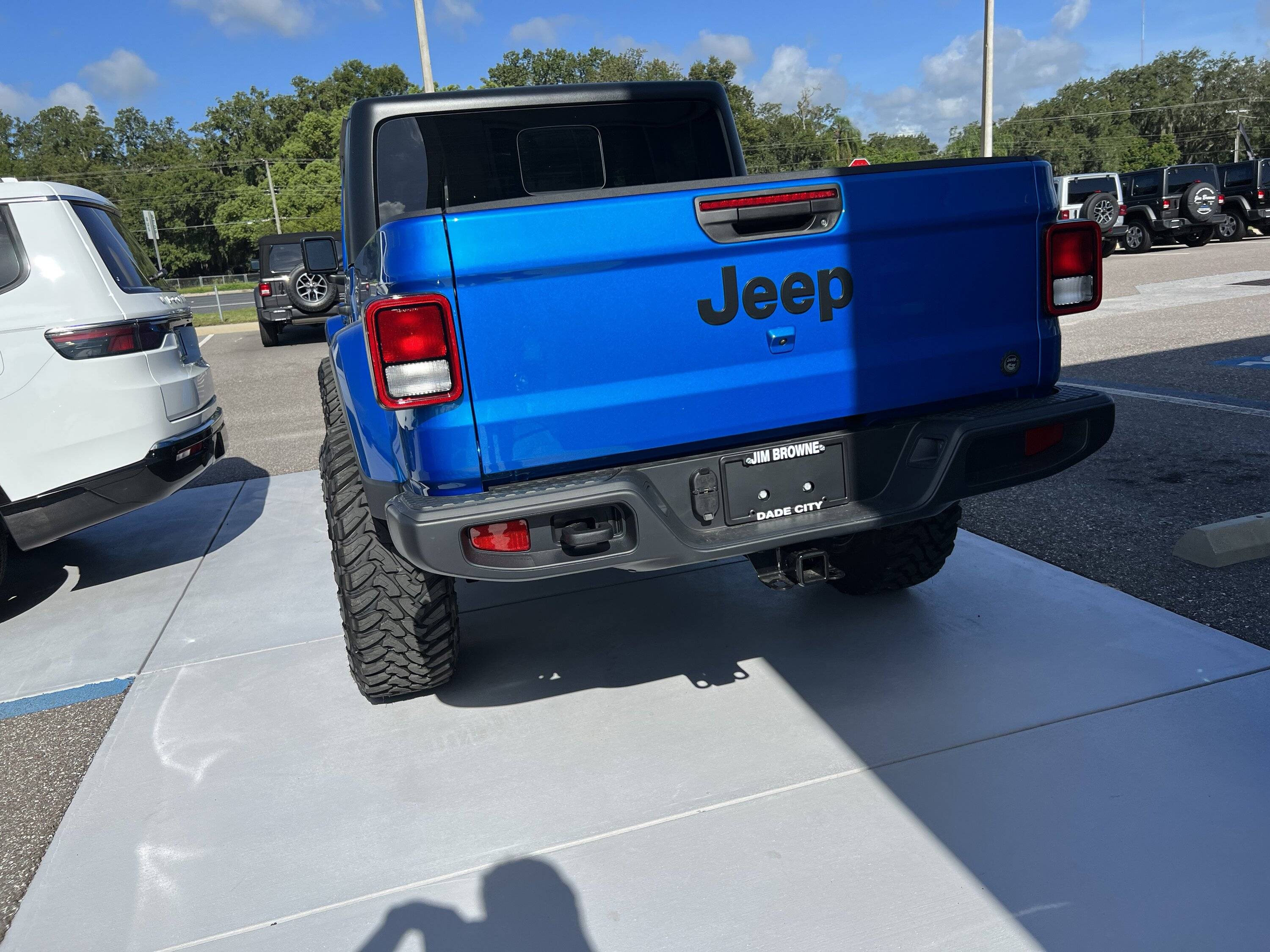

Went to the dealer to have my parking brake adjusted (6MT) and they had this Sport sitting out front. They are charging $10,000 for the upgrades, which include new Mopar lift, wheels/tires, bumper, fog lights, and winch.

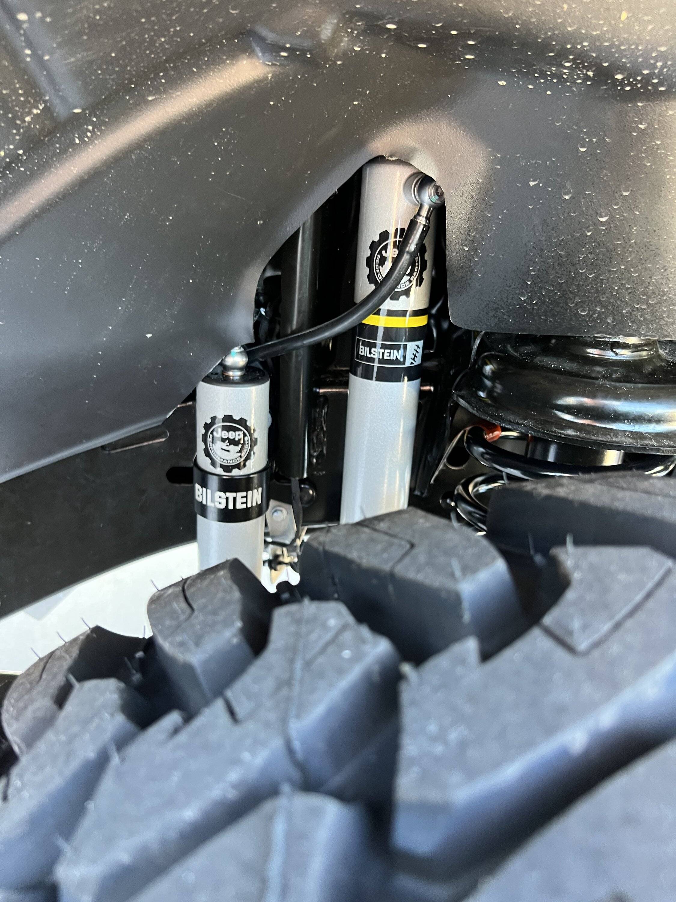

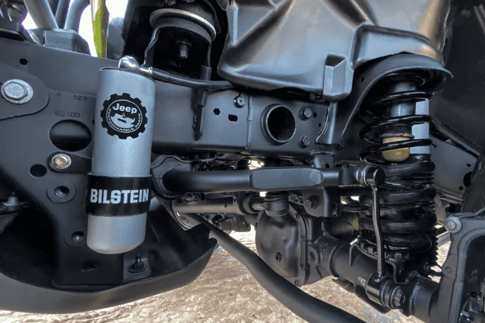

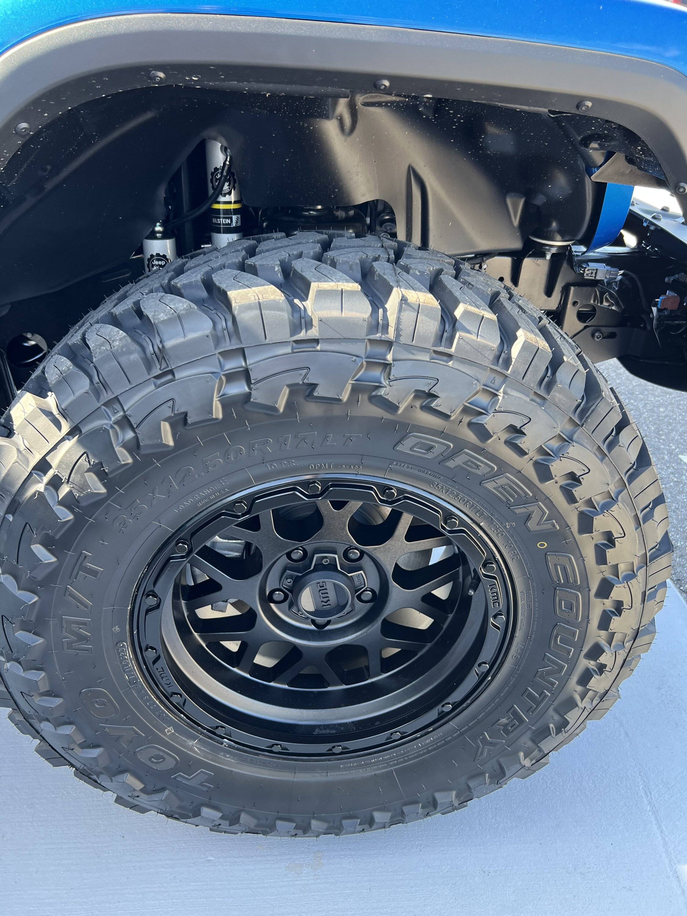

So does the reservoir mount up front or by the shock?
Does that say $52k suggested retail price before $11k in addons... for a sport?

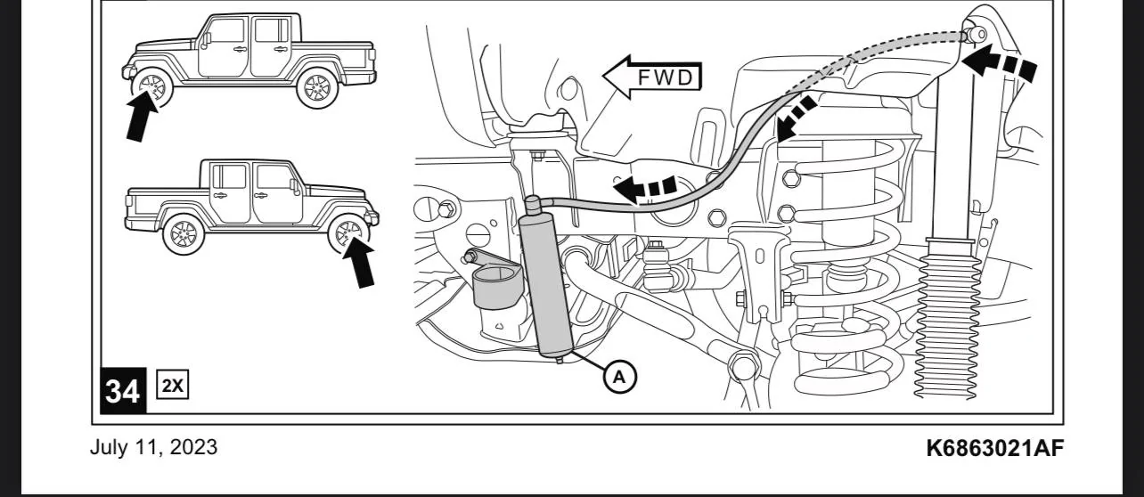

According to the Mopar Install sheet the fronts are mounted further forward as shown in your first pic, The rears are mounted on the rear shocks.
https://www.allmoparparts.com/docs/77072396AH_77072397AH_77072468AF_77072469AF_JTBILSTEIN.pdf

That was my understanding also. Curious why in the second pic it’s mounted so close to the shock since this one was installed by a dealership and then not to mentioned marked up to a ridiculous amount. Shame on this dealer.

Yeah I was confused looking at them too. I would not fault the dealer just yet, These kits are new and there perhaps may have been a change made to the install sheet. The one we reference is dated July 2023 so we would like to think its accurate and up to date.
Based on the length of the reservoir hose shown, visually, it doesn’t look like mounting them much further forward was an option.
In the instructions it certainly appears to show a much longer hose between the res and body.
Yeah perhaps something was revised along the way, The hose in our/mopars photo does look ample but on the dealer install its obviously not.
