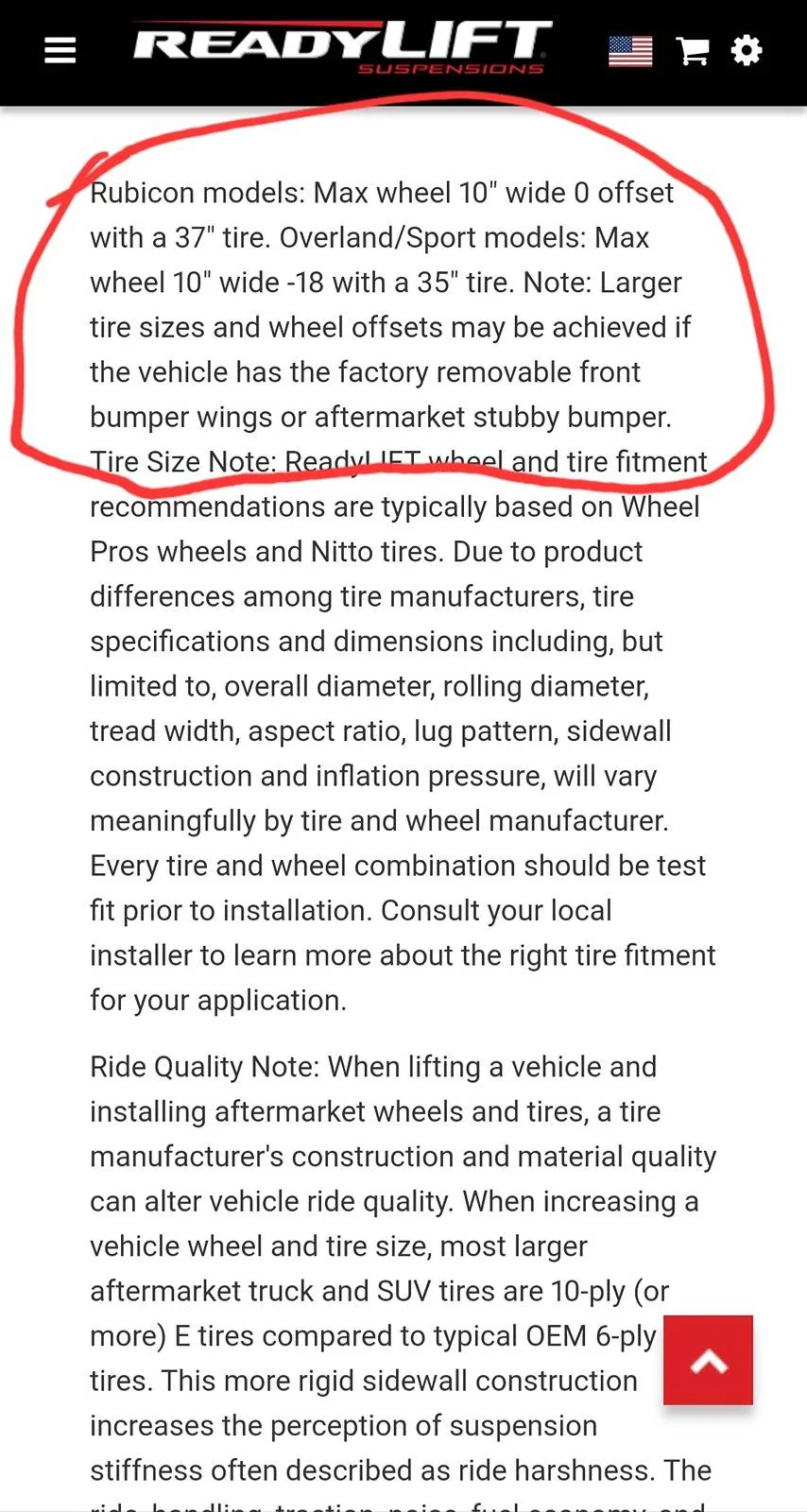

Gladiator rubicon 4" readylift with 37" 20x12 question

I run the same tire on 20 x 12 with -12 off set. Rides excellent and it’s on the Mopar 2” lift. I’d be careful with that much negative off-set, my jeep didn’t like 3/4” wheel spacers which is probably close to the -44.
